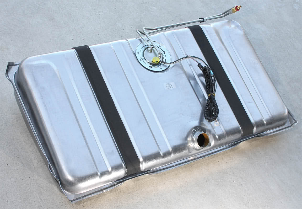

      So that sump is deep enough so hard cornering with 1/8-1/4 tank will not starve the engine? Or am I asking too much?
      Scott from NJ.
      You're asking too much...
      I'm sure there's a math equation to figure that out. I guess I will find out durring testing. Once I get the tank apart I will let you know how deep it seems.
      I'm sure part of it relates to how much gas is in the tank.

      Quote Originally Posted by MuscleRodz View Post
      The hole is how the tank self levels when not in use. The return line pumps unused fuel back into the well, and forces the excess fuel to run over the top of the well. No chance of starving the pump unless you run out of fuel. When you shut the car down, if the fuel in the well is higher than the tank, it will gradually self level with the rest of the tank.
      Thanks Mike. How/where does fuel enter the sump? I'm missing something from the pictures.
      Also, if the pump and sender assembly go into what I'm assuming is the sump area, and recirculated fuel is intended to overflow the sump during normal operation, wouldn't it give eroneous fuel level readings? OE fuel buckets have the sending unit attached outside of the bucket.

      Quote Originally Posted by CarlC View Post
      When not in use fuel enters through the weep hole you see in the bottom. Sending unit sits outside the well. Only eroneous reading you should get is the same as you would with stock tank during accel, decel, or turn

      Quote Originally Posted by BonzoHansen View Post
      Well in fairly deep, and with the fuel being returned to the well, pump should stay sumberged unless tank is nearly empty and in a sustained long corner. Always a scenario where anything is possible.

      I'll be mini-tubbing the car, but only running a 19x10" wheel for now, will this tank work???

      The Tank

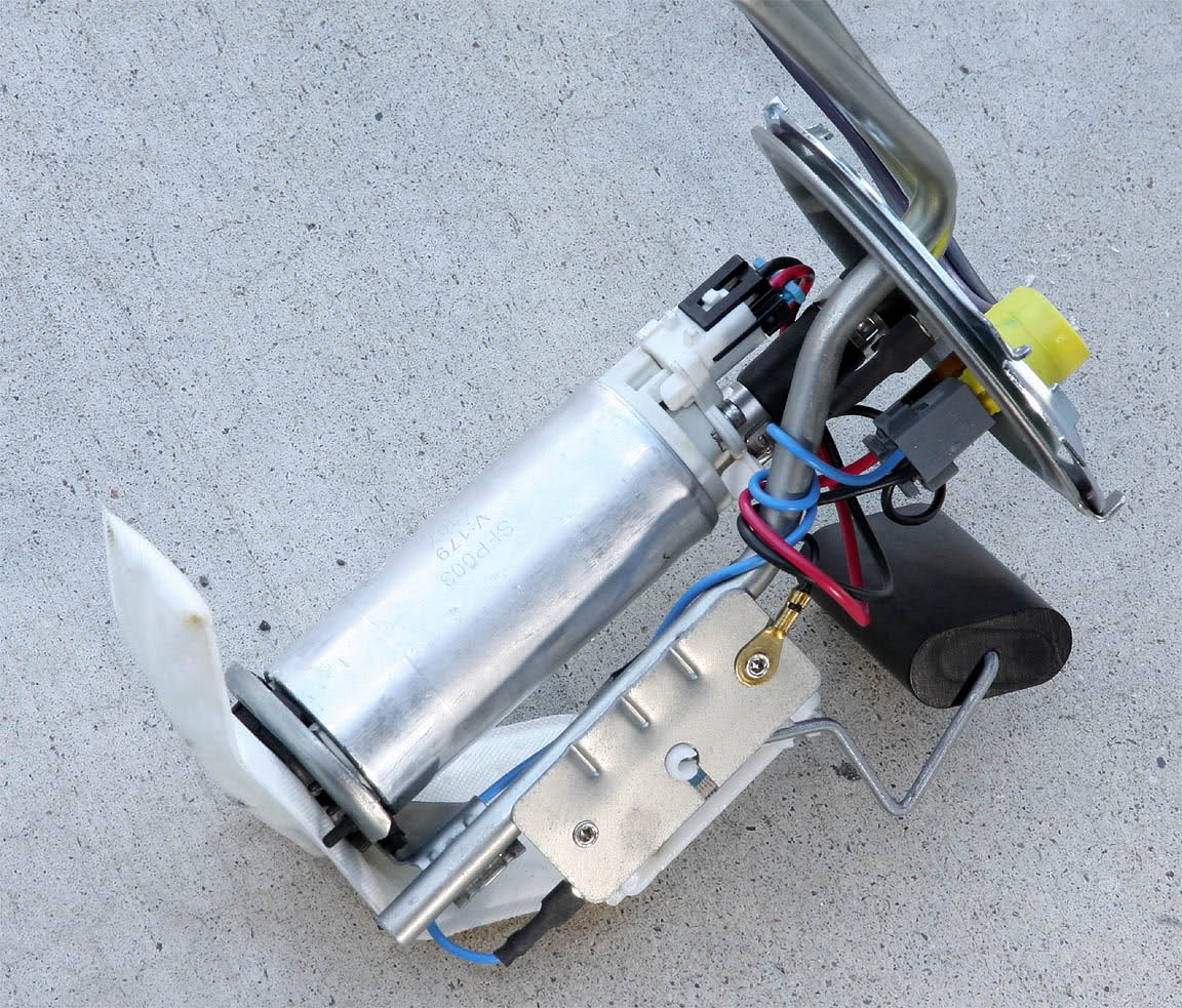

      The pump/sending unit:
      The pump says:
      SFP003
      V:179
      4307

      Nice pictures Steve. I take it that the price included the pump AND the sending unit as one piece? Does the sending unit work with the stock gauge?

      Quote Originally Posted by Rag-Rat View Post
      Includes everything you see.. it's a 0-90ohm sender from what I gather.

      Could this be the pump?
      http://store.getgmparts.com/fe0114.html
      Lots of pumps on this site that look like the one in the tank but I would need to see the markings to tell which one this is.
      Might be possible to swich out the pump for a larger GM one? Just thinking...
      http://store.getgmparts.com/fuel-pumps.html

      I don't see why you couldn't.. I was more curious about the service issue (ie, direct replacement pump) and if there was a cheap GM pump with a higher output.
