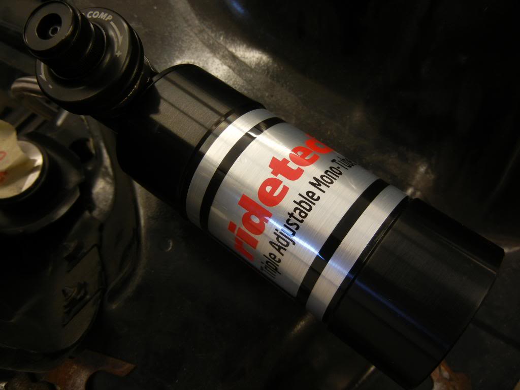

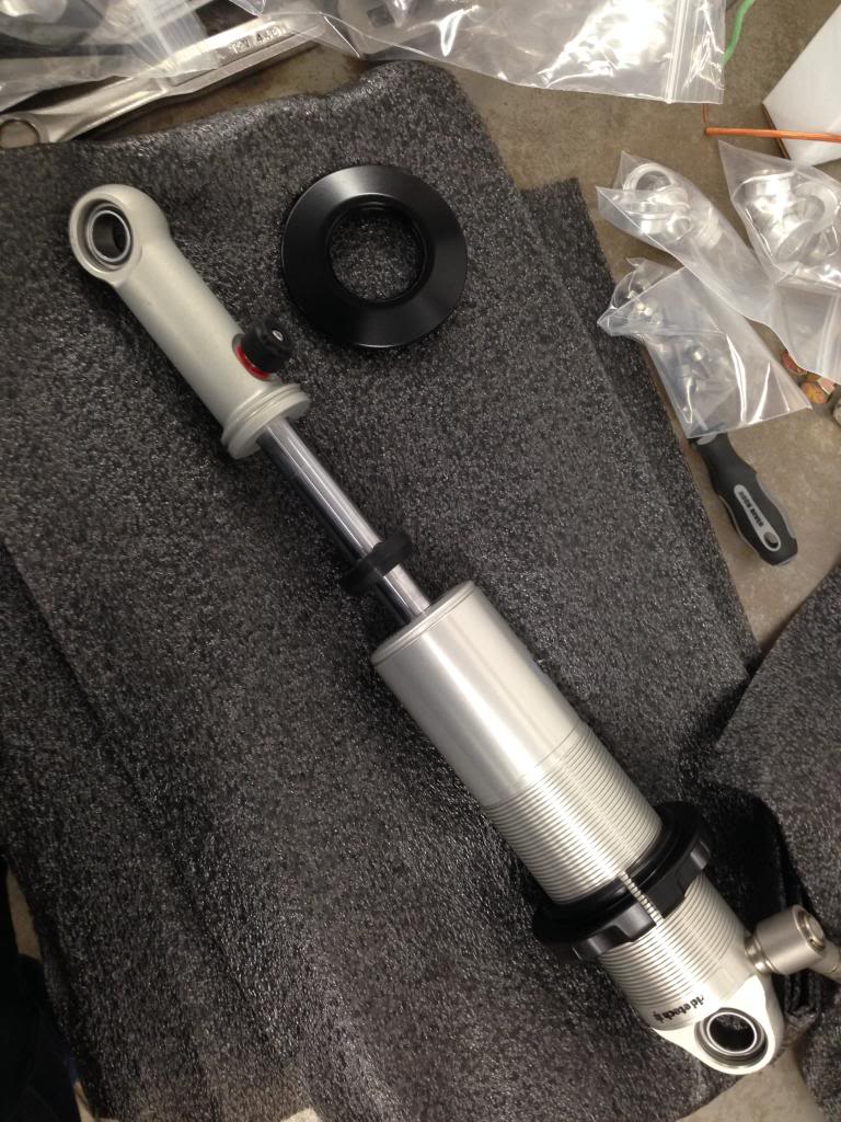

      What sealed the deal though was the addition to Ridetech's offerings of a true 3-way adjustable damper. Developed in partnership with Fox Racing these are truly top notch pieces. In a former career I worked closely with engineers at Fox on development of a number of bicycle suspension dampers and I'm well aware of the depth of their experience, the talent of their engineering staff and the resources they can employ to develop a solution to a unique challenge. If you aren't aware (you probably are) Fox in addition to being a leading supplier of motorcycle, bicycle and snowmobile suspension is among the leaders in developing cutting edge off-road truck dampers as well. With data and creativity coming from those various areas of expertise and the knowledge and resources available I had no doubt that the solution to be co-developed with Fox and Ridetech would be a good one. The results found on James car proved out that assumption and I was sold.

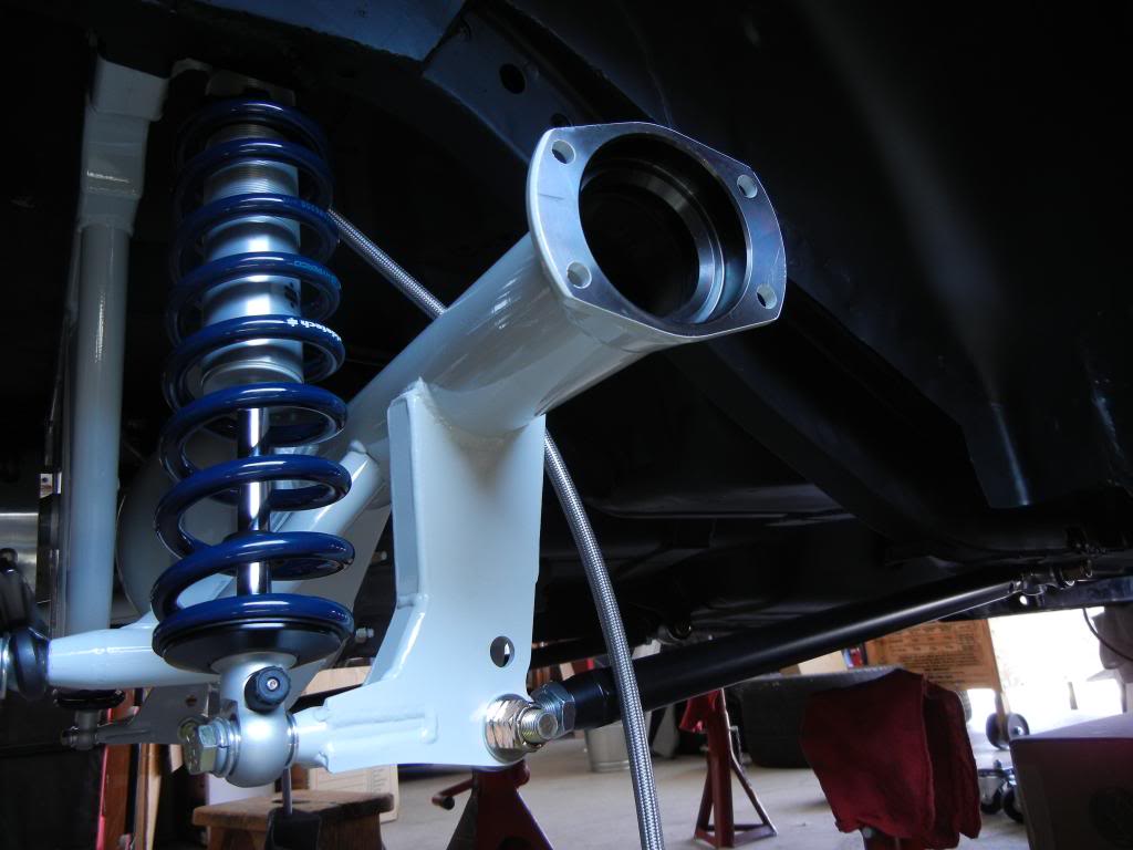

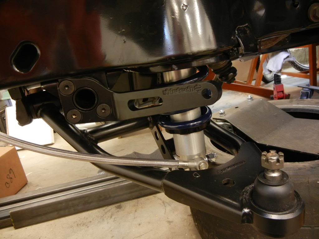

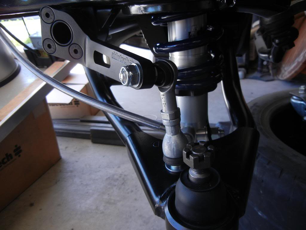

      The Ridetech TruTurn is based on a proprietary spindle that has a built-in drop of (IIRC) 2" and is modified in terms of the height of the spindle as well. It does however use a factory pattern hub and brake mounting matching that of a '68 Camaro disk brake spindle so any brake bracket or hub that would work on a factory spindle will work on the RT spindle but you get the improved geometry.
      Further, the RT system employs a custom steering arm and drag link offset bracket that the corrects for the steering geometry which is altered by the steering arm. If you look closely at the system and the changes made by David to James' car you will see the similarities in how the two solutions were arrived at.
      All the above is designed to work with RT's control arms.
      The first thing I noticed upon opening the massive pile of boxes was how well the stuff is packaged. The Samsonite gorilla (some of you are too young to know what I'm talking about here, youtube it) couldn't have hurt the contents of those boxes. I filled two entire trash cans with the styrofoam packing material used to protect the parts.
      The second thing that struck me was how bloody nice the machining and fitment of the parts was.

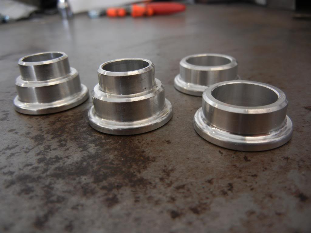

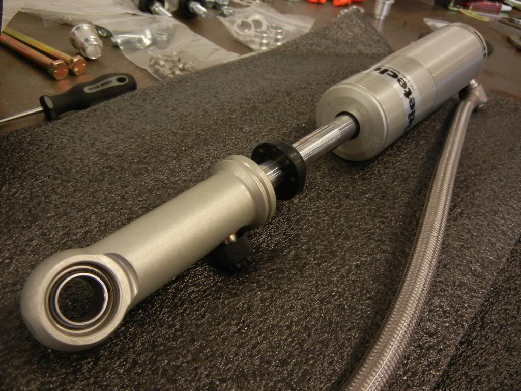

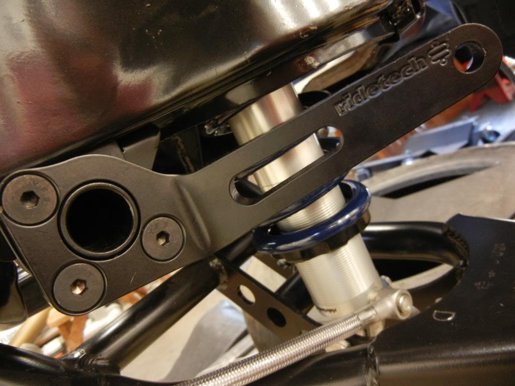

      The attention to detail on this stuff is apparent. The install kit for the shocks comes with a variety of bushings that will allow fitment to darn near any application.
      ....darn near. Because the Chicane coilover mount has one shock mount stub permanently affixed I had to machine my own bushing for one side. The means of doing so violated every safety discussion my HS shop teacher ever had and I shant disclose it here. It wasn't particularly difficult....it was just unsafe. It'd have been easier, and safer, with a proper lathe or mill...but I have neither. At any rate between RT's supplied parts and a bit of ingenuity (cough) I made it work.

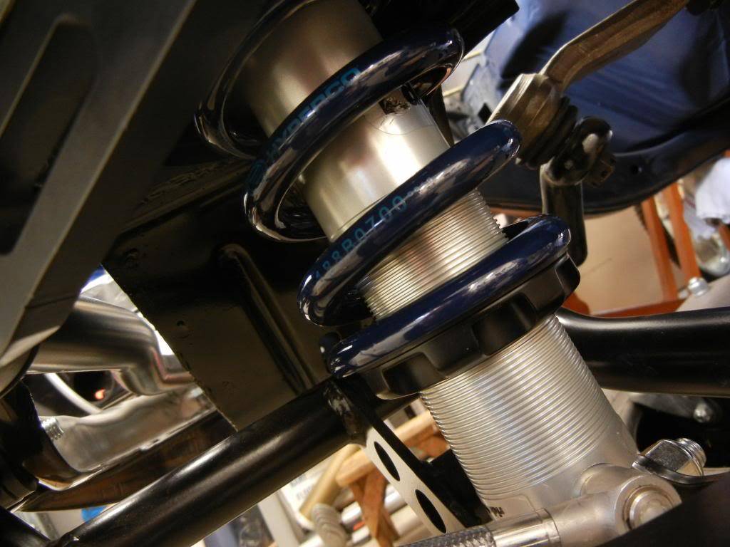

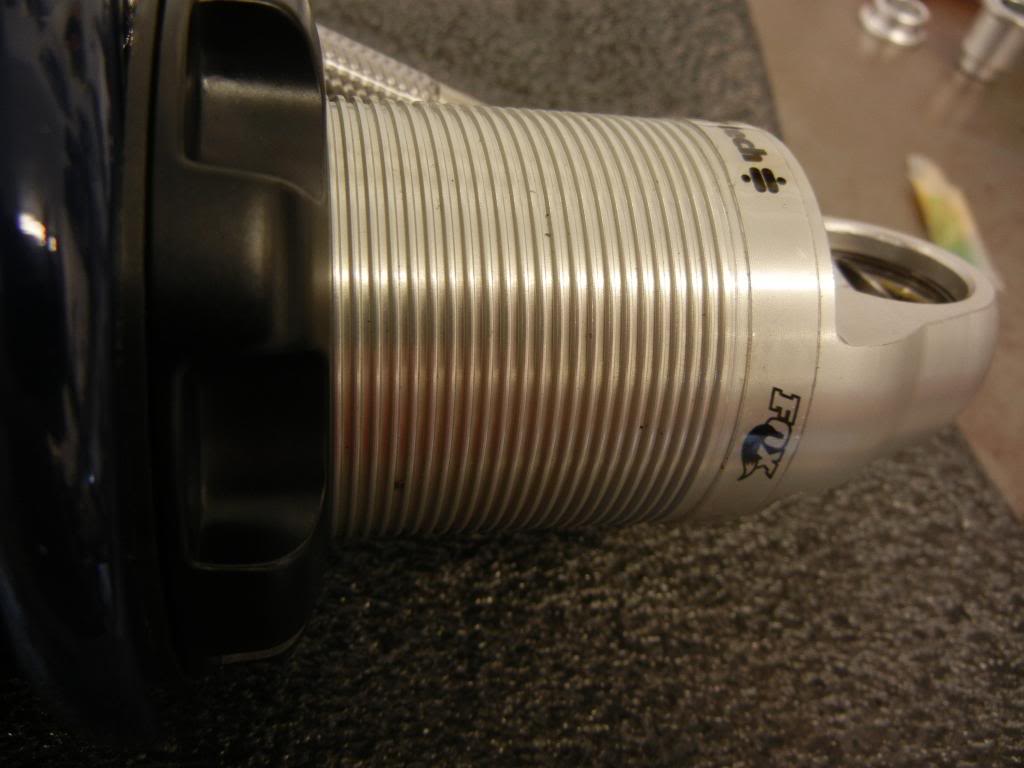

      The spring perch and pre-load collars fit perfectly and adjustments are buttery smooth given the precision machining of the shock bodies.
      ...and the shocks come with top notch springs from Hyperco. Tough to beat those. I'm starting with baseline rates of 700 front and 300 rear and as I'm sure you noticed in previous posts, I used the RT shocks in the rear as well....
      Next item up was RT's front sway bar assembly. Again, really superb machining and excellent fit of all the parts. Absolutely no effort on my part required to get stuff to fit. Everything went in just right, the first time w/o any form of modification needed. Given the variations in production tolerances on 40+ year old cars this is kinda astonishing.

      As you can probably tell, I'm really excited about the shocks. Having Fox practically in my back yard (35min drive) is a nice bonus as well. And again, the fit and finish of the parts was top notch, service from RT before and after the sale has been stellar. I couldn't be happier at this point and I'm really looking forward to developing this solution to work in harmony with the Lateral Dynamics 3-link.

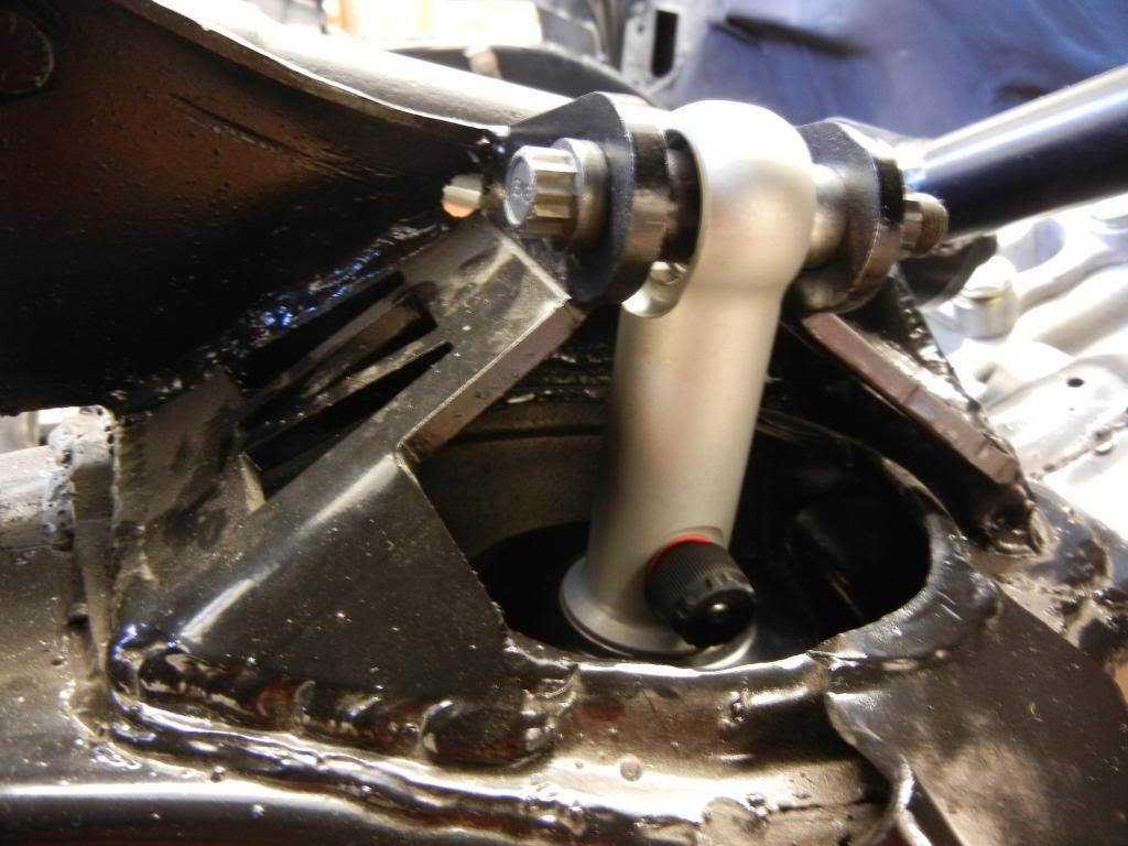

      Can you reach the front rebound adjusters OK?
      Check the rear shock eye bushing inserts for binding. I had to cut a little metal off the shoulders of them on OLC. It depends on upper shock location front to rear. Biggest chance of binding is at full droop. We used the 16" extended length Ride Tech shocks.
      Another note. The shock eye aluminum inserts can fall out fairly easily. It's tempting to put Loctite on them to keep them in place. Don't do that on the small end of the shock. They need to come out when you change springs or do shock valving.
      Your spring rates are perfect.

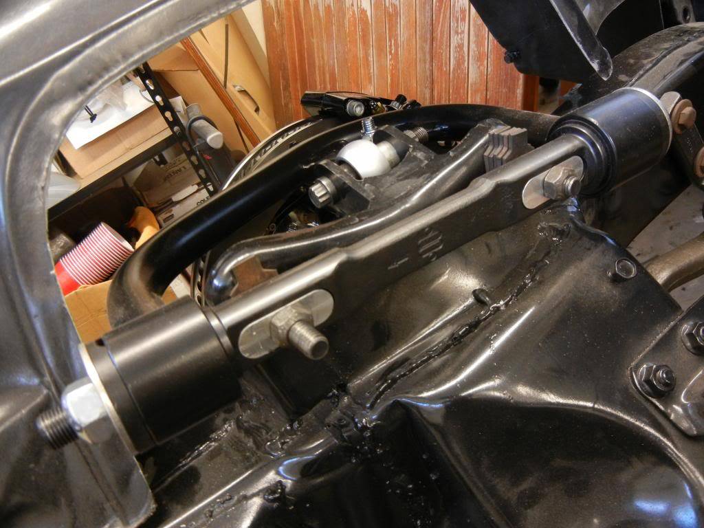

      What are you doing for a rear bar? I think the Ride Tech bar is pretty stiff so you will need a matching rear bar.

      Adjusters - it's tight in there, but yes. I have kinda small hands. If I had big old meathooks it might be tough.
      Bushings - I ran the rear through its range using the jack. Didn't see any evidence of binding, but I'll keep an eye on it.
      Inserts - Mine are dry
      Spring rates - I got the rates from you. I'd expect nothing less than perfect.
      Rear bar - I have the one you built for me. The modified 2nd Gen bar. We will see if it's enough. IIRC you went bigger still on OLC after that.
