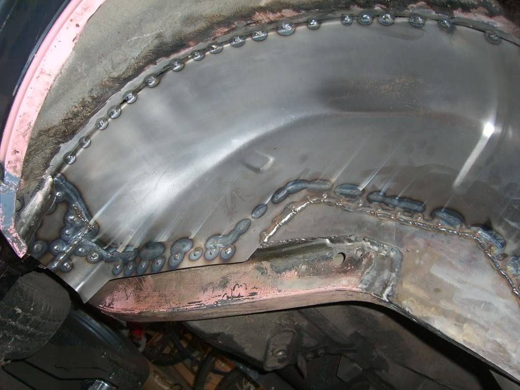

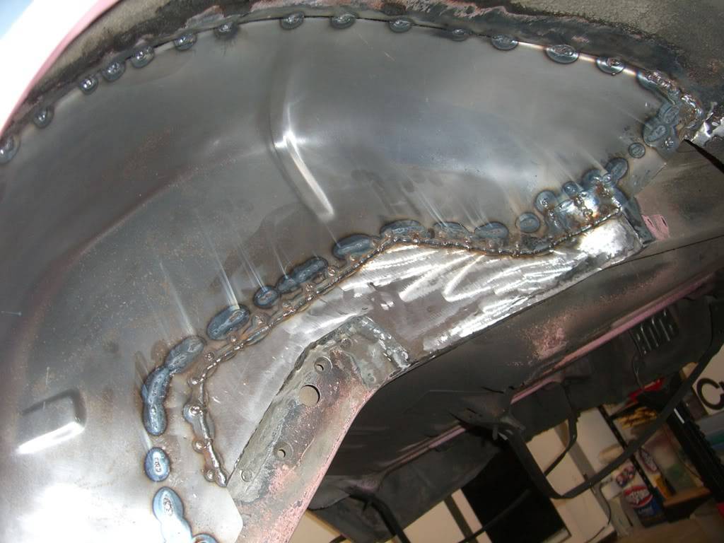

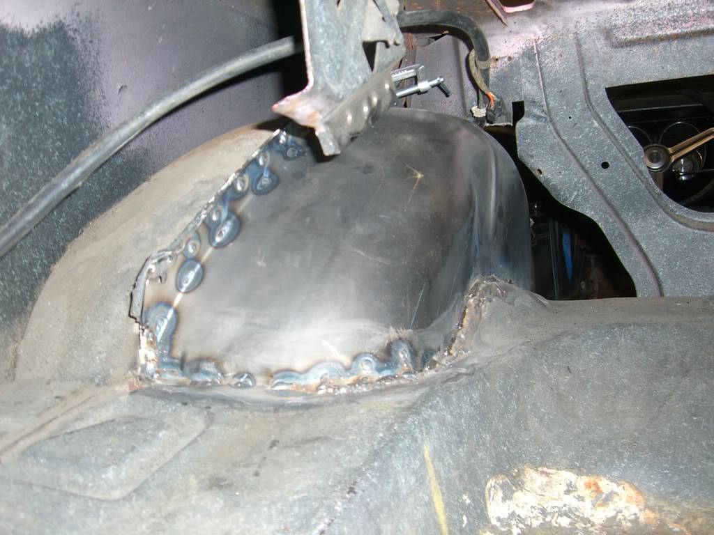

      I have the fill plates on the drivers side complete.
      Still working on the passenger side. Nothing happened tonight. I decided to make a really nice lobster/scallop risotto for my wife tonight. BTW, Girgich Cellars Chardonnay.....get some.

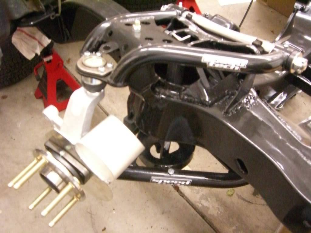

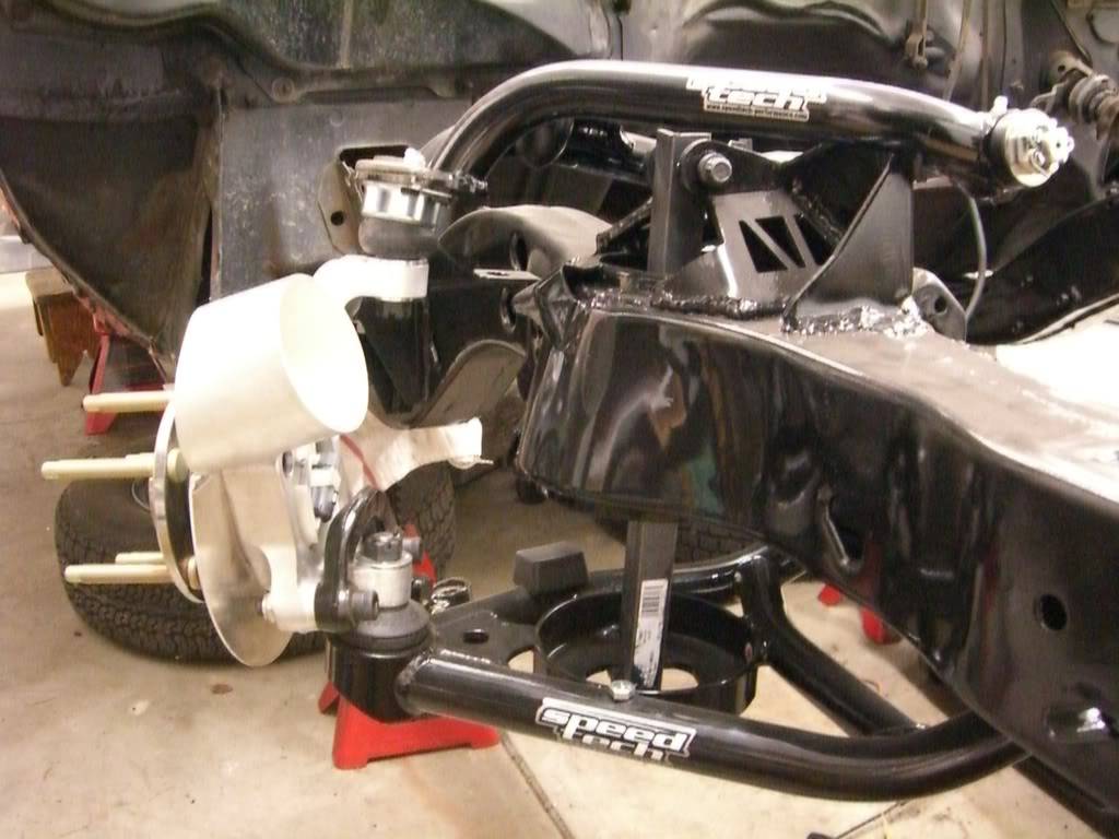

      Front suspension coming together....
      ATS spindle
      Speed-Tech Upper/Lower Control Arms
      LG Motorsports brake backing plate
      $2.00 worth of angle iron from Lowes pretending to be a shock absorber

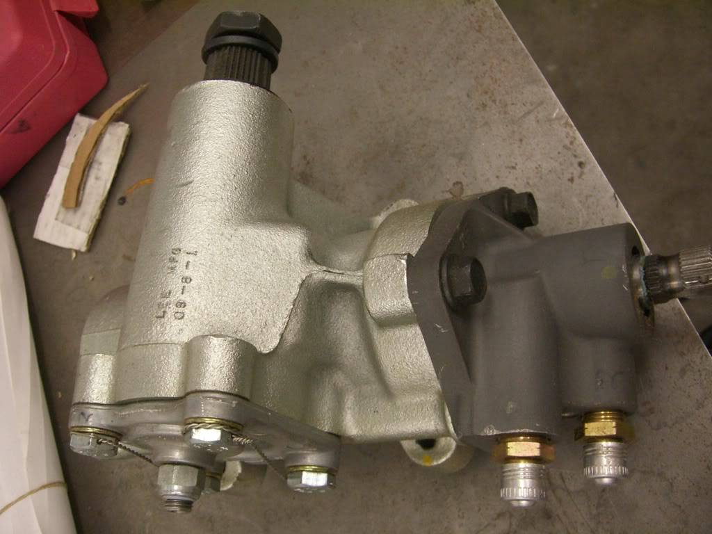

      ATS/Lee Manufacturing Steering gear:
      I know, I know...the nice cad plating.....CA EPA said Lee can't use the stuff anymore.....freakin hippies.

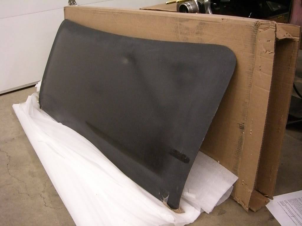

      Something light and itchy and strangely similar to a decklid
      One of my favorites up there on the top shelf......The Twist-Machine / Jakes Rod Shop rear spoiler. That thing makes me tingle in my special place.

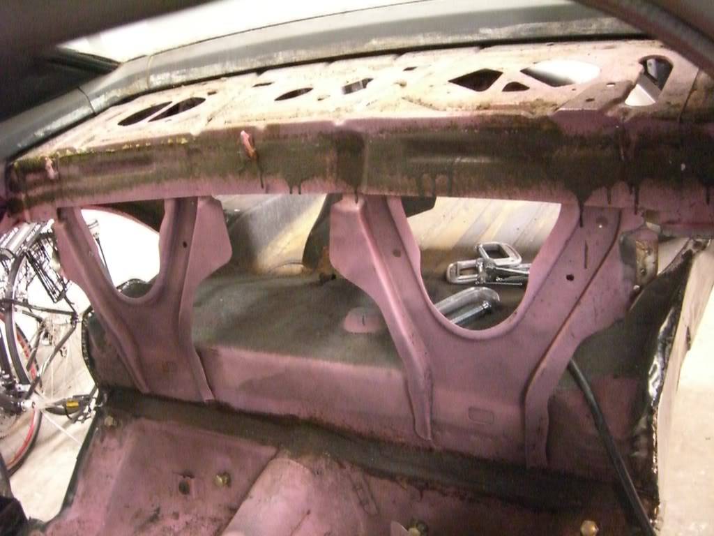

      One of my next projects is to create a bulkhead out of all of these holes. Haven't decided if I want to weld a bit of metal into each of those openings, or just cover the whole thing up with a couple of sheets bent to fit. Suggestions?
      I wondered why mine came without the Cad finish, though I assumed it was because mine came from SC&C. Guess not. You're right, Damn hippies.
      I know....I thought maybe I'd gotten the wrong box until Tyler explained it to me.

      for a rear filler panel to cover the back seat area, I would either do aluminum or do some research on vacuum bagging fiberglass. It's not hard or expensive and it will be very light weight. Hardest part will be making a mold that's strong enough to handle the pressure and not deform. Looking great True. Keep up the good work.

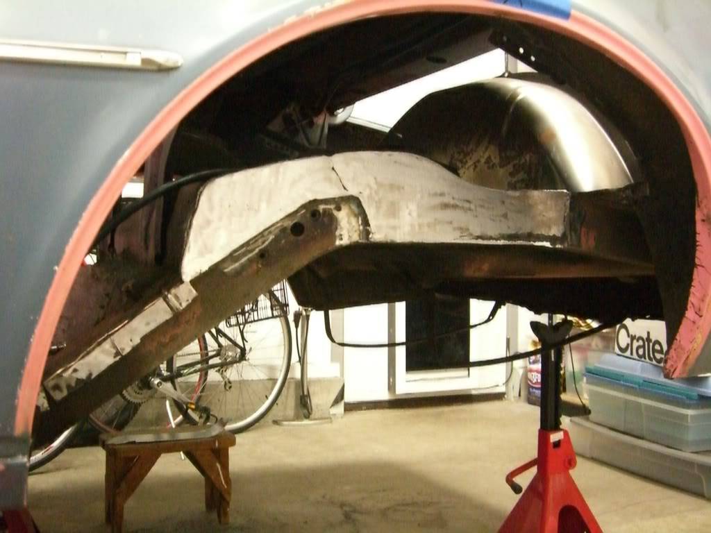

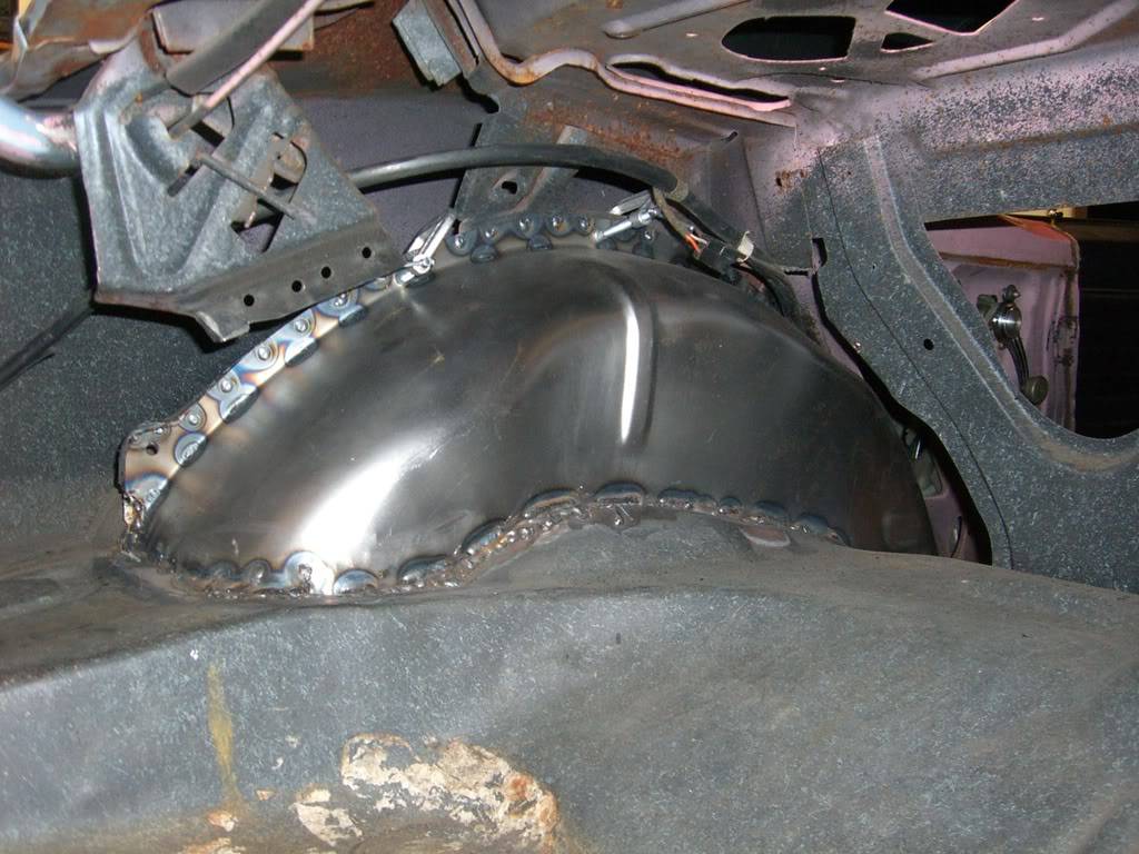

      Got the passenger side fill panels done last night. I'll be starting to fit the drivers side tub tonight.
      Hope it fits.......I'd hate like hell to have to cut all that stuff back out.

      You could easily do a relief or built up part in the center of the mold of a logo if you have one for the car or a bow tie, "chevrolet", "camaro", or even "1/2 Trak". Once the glass is laid on top and molded to it, you'll have a nice logo in the panel that also acts as structure to keep the panel from bending and flexing.

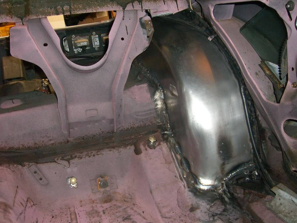

      Well the drivers side tub is all but finished. Just need to grind the welds down a bit, close over that flap on the lower forward bit and hit it with the seam sealer.
      I have a quart of seam sealer from Eastwood, but I'm wondering if it might be better to use a different product that is more of a caulk type. Any thoughts?

      I used the 3m Fast and Firm seam sealer on the all the joints with great results. I then used a spray on type rubberized undercoating inside the whole tub instead of paint. This I like b/c it is can deflect objects like rocks with out chips and acts like a damper to help control the noise.
      3M Link
      Rubberized undercoating Link

      I used the Eastwood seam sealer was very happy with how it applied and hardened. Not too hard still had some play to it.
