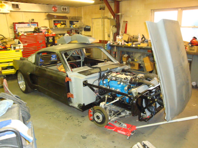

      Getting the brakes and hydraulic clutch up,love the way the fender comes off with just 4 bolts and the hood lifts totally out of the way.
