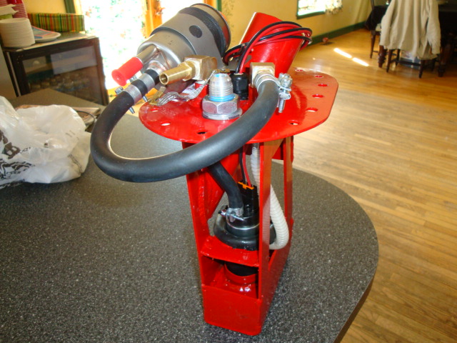

      Down to the last things before fire up,some wiring and this fuel pump that I've been dancing around along time.Finally fabbed it up and powder coated it last night.Used a cheap circle track Jegs cell in the powder coated can with the Ebay Walbro 255 fuel pump.Fabbed a new top with the reservoir,filler, and wiring.The whole set up cost about $375.Pretty tight space wise,should fire it up tonight or tommorrow.Ron
