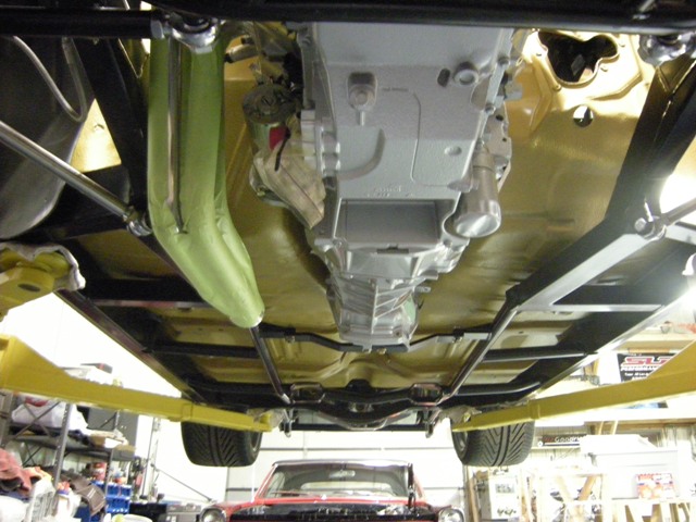

      Here's a couple updated shots.
      Since this car is gonna be driven, the bottom is sprayed with tinted bedliner and the chassis is powdercoated.

      Wow Jeff that looks sweet. How is the texture of the bed liner, is it fairly smooth. How much pressure did you use to spray it with? Did you spray the base pan and trans with something?
    16. #56
      Chicagoland
      957
      I had a specialist do the bedliner. It's smooth enough where you can wipe it with a rag and no lint sticks to it. The whole bottom is that, wheel wells are black, same material.

      He did a nice job . If I could get someone to do mine like that I would use it . Sweet
