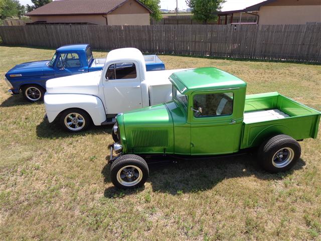

      Wayne, I have a story to tell. In March of 07, the parts to build my 32 Ford pickup began to arrive. My plan was to paint it Ford white with some pin striping and use it as a daily driver. In June, I went to the Pueblo NSRA event. After you had walked around long enough, you used to go into the exhibitors building and find the Rod Doors display and sit on one of their seats. They were all full. There was a very proper lady sitting on a 32 Ford seat. I asked if I could sit and she said that would be fine. I started a conversation and she had told me that this was her 1st as being a car owner. Her husband had built a 37 Chevy pickup. She said " I don't know anything about this but they use outrageous colors on the inside and outside that you would never see in normal life". I thought about that and decided she was correct. I got out the paint book when I got home and that's how the 32 ended up green. I used the white on the firewall and the interior. That color started many conversations with strangers. It opened doors that otherwise I would have never even seen. I never grew tired of it, either. Good luck with your choice.
