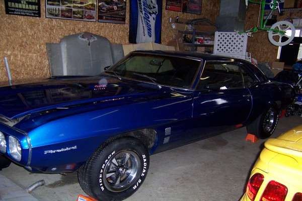

      When did you get that Firebird 400?? Got pix?

      got it not to long after getting back from rtth2 ..got it from a member here..not a bad car..bought it as roller and got a 400/400 im gonna be putting in soon..just gonna make it a decent driver for summer then decide its fate..lol..
