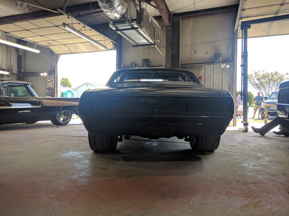

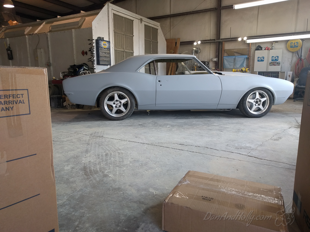

      Fitting the wheels again
      Whew man, I'm tragically bad at keeping this thing up to date... and this build is tragically slow! BUT, we're moving now, so I'll catch this up.
      After having the wheels cut down, I popped them back on the car and they fit!

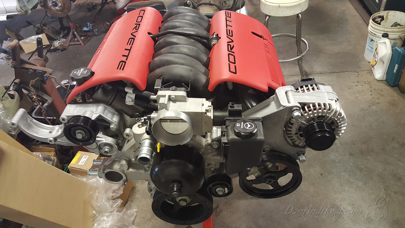

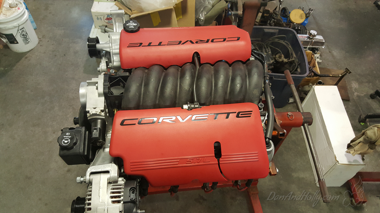

      Finished the engine
      As has been eluded to elsewhere in the thread, the short block was built and then sat for ages. So, I decided to just start all over and had the short block pulled apart and thoroughly cleaned and beefed up a few things along the way just to be extra safe. Afterwards, the motor went back together and is now totally complete.
      Looks like a brand-spanking new LS6 now!

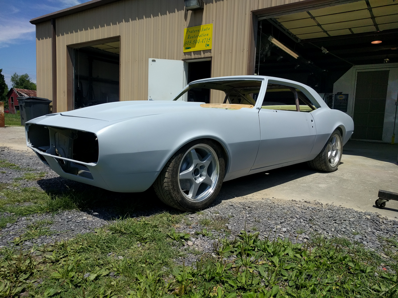

      On to the body work!

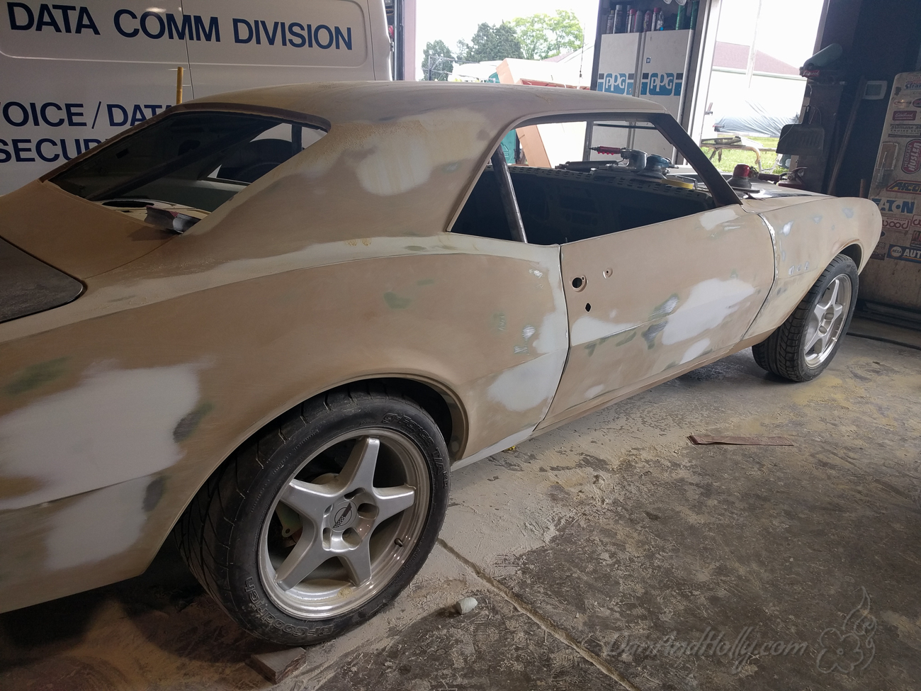

      Once the motor was done the guys started cranking on the body work!
      All body panels on and the thick primer sprayed on

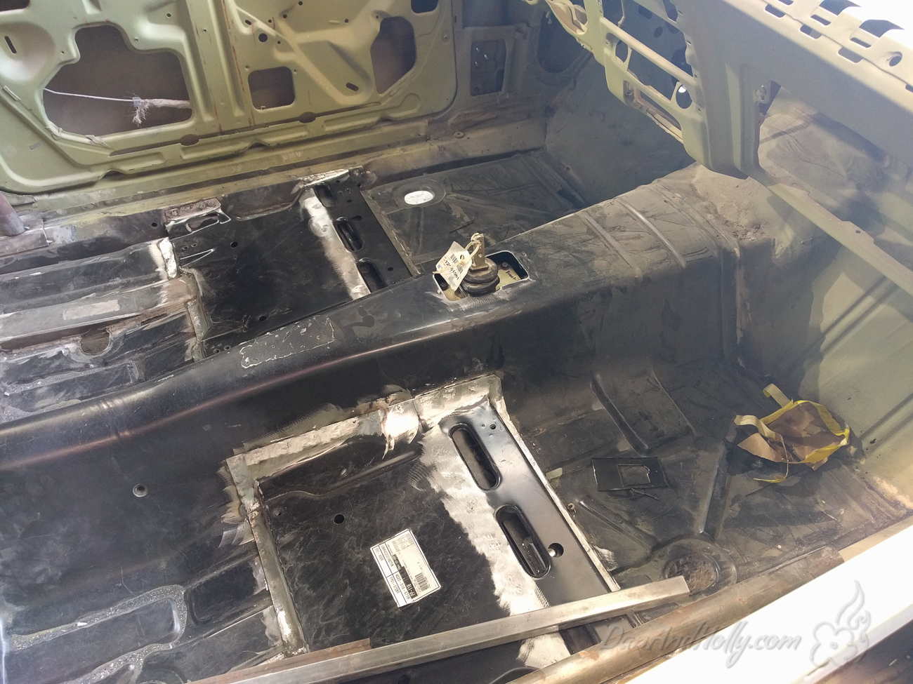

      While we were at it, they also cut the hole in the floor for the stick to come through

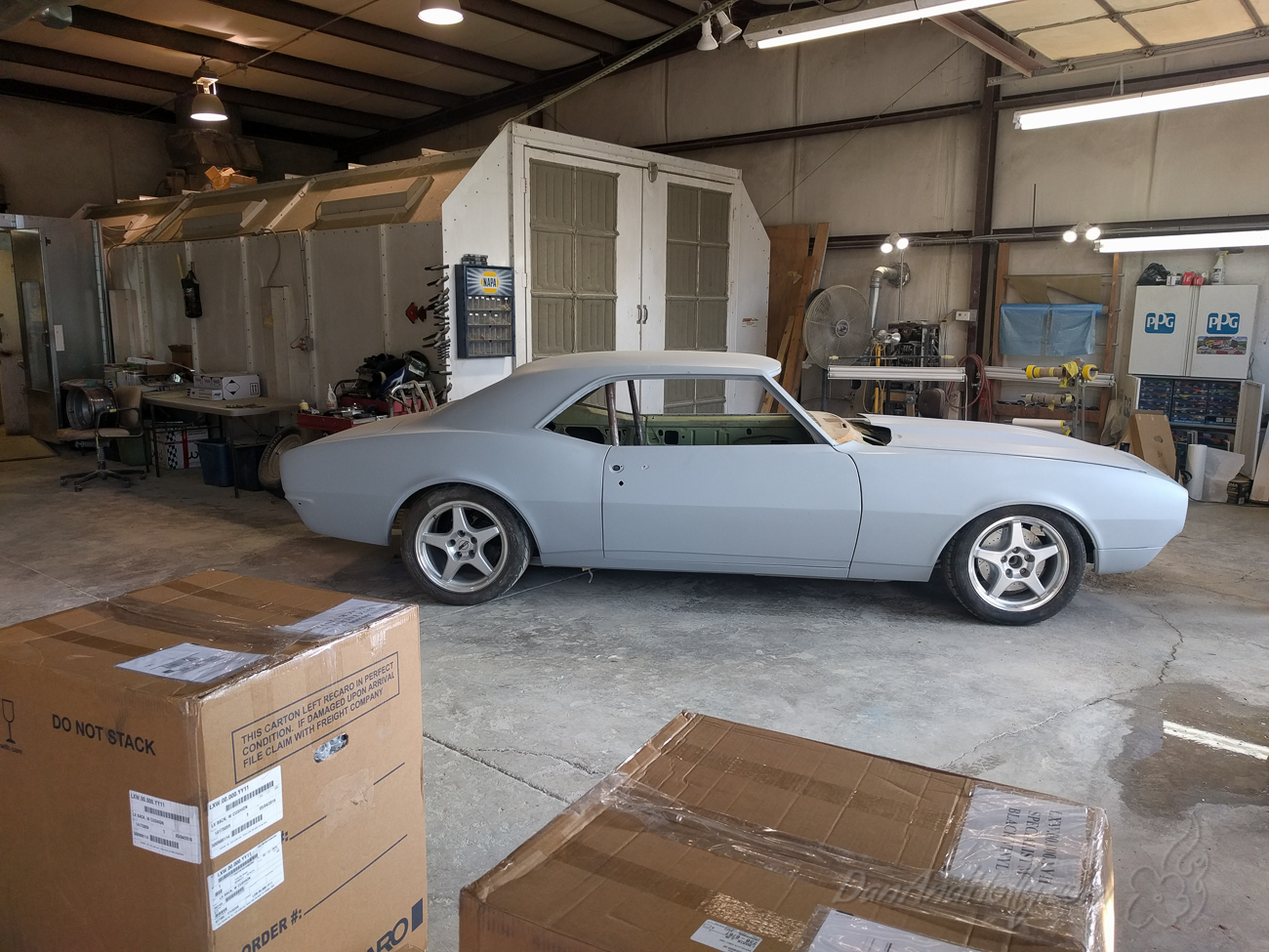

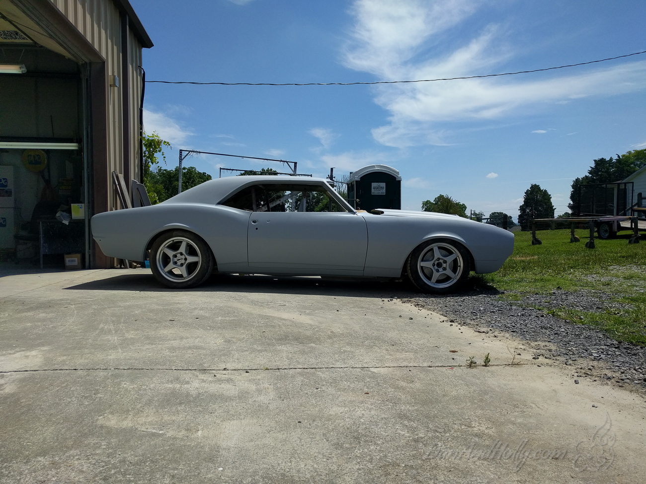

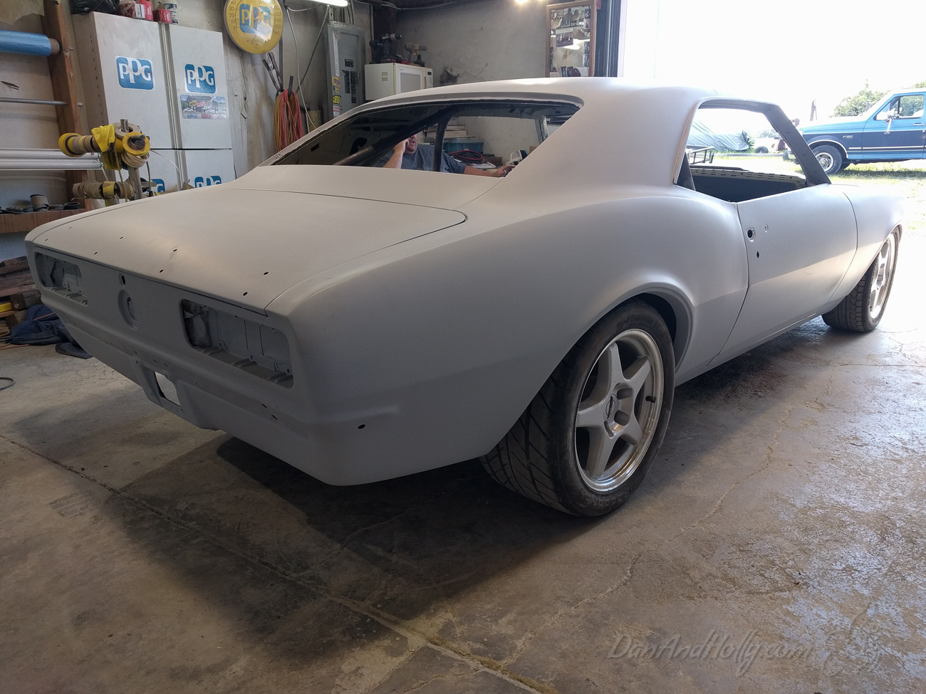

      Setting ride height
      Now the fun part!
      When the guys put the suspension under it, they just put everything in without looking at the height of anything... just to get it under there basically. Now that everything else is done, I wanted to put the motor and trans in the car and get some weight in it to see how it looked. It was WAY too high, so we started working on the ride height.
      We initially had some issues getting it as low as we wanted because spanner nut just couldn't turn anymore without hitting stuff. What the guys ended up doing was trimming some metal off the bottom side of the frame where the old spring bucket was, and this allow the car to come on down another 1.25 inches. It's just about perfect now!
      Now, a couple of problems we need to figure out. One is with the car that low, we've got some rubbing issues. We're going to align the front end and get the camber and caster set and see where all we've got problems officially. Then we may need to do some cutting / massaging. Second problem is the lowest part on the car is the oil pan! Not cool. It sits about 2.5 inches off the ground, and the frame is almost a full inch higher than that. We're going to see if we can't raise the engine and trans up some (we've got plenty of room) to see if we can't narrow that gap a bit. I'd prefer a speed bump not scrub my oil pan if at all possible.
      We're also going to start playing around with some colors as well. Can't wait!

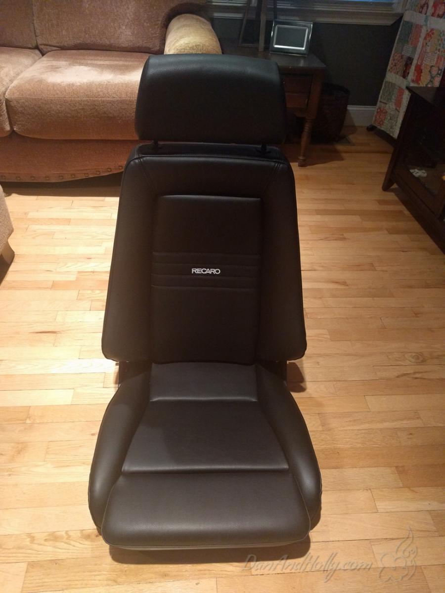

      Well this is awesome, my seats came in this week! Super excited to get these in and finally sit in the car!

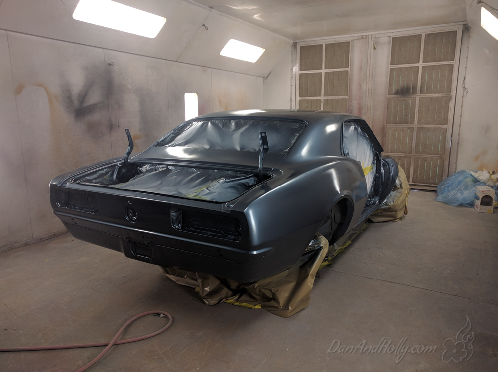

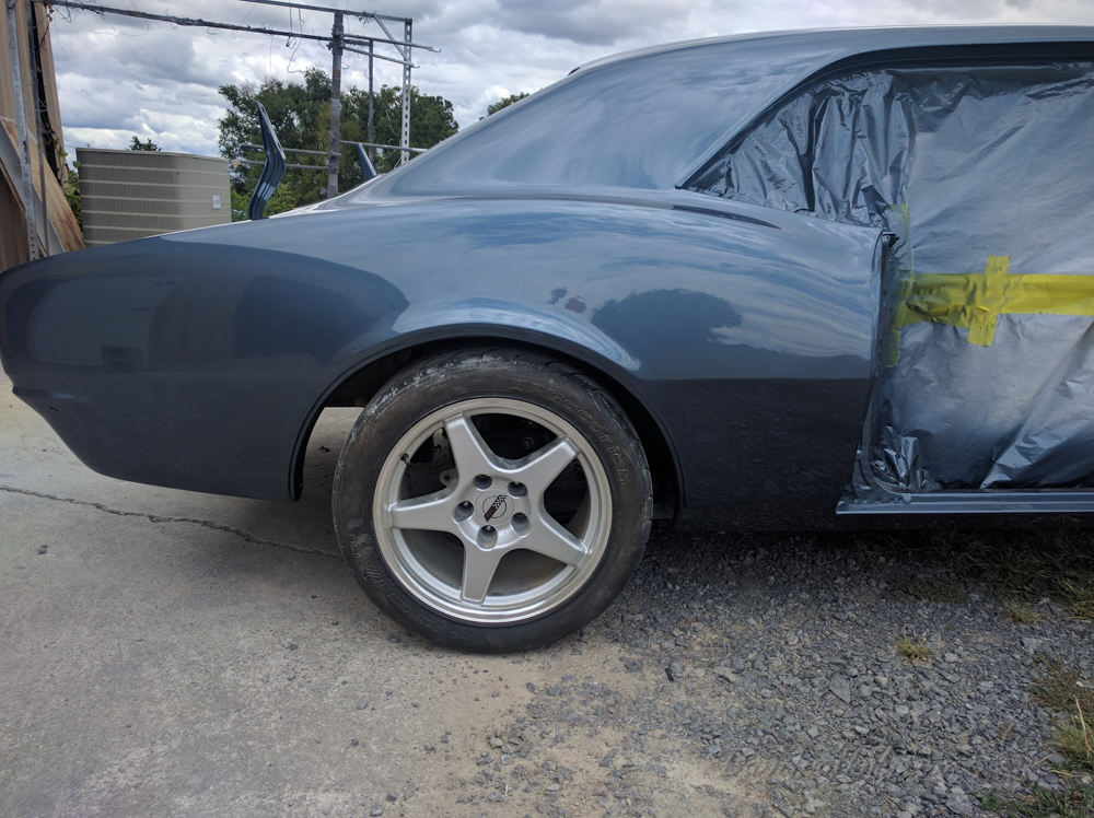

      It's painted!

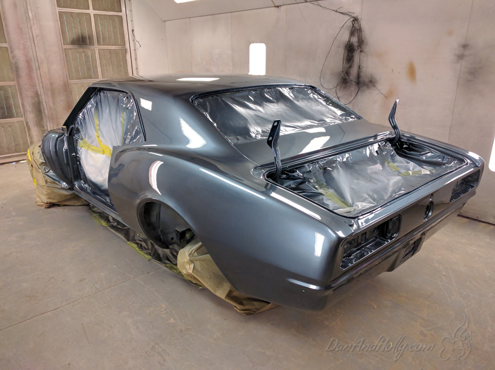

      Whew man, I've been bad about updating this. A lot has happened since I last posted though, which is always good! I finally chose a paint color. After going round and round in my mind about the Chevy color, I decided on Mazda's Reflex Blue. The Chevy color always seemed to look green to me, not matter what light it was in, so I just went another route.
      Body all painted up and sitting outside. These pictures are the truest I could get my cell phone to capture as to what it looks like to my eyes.

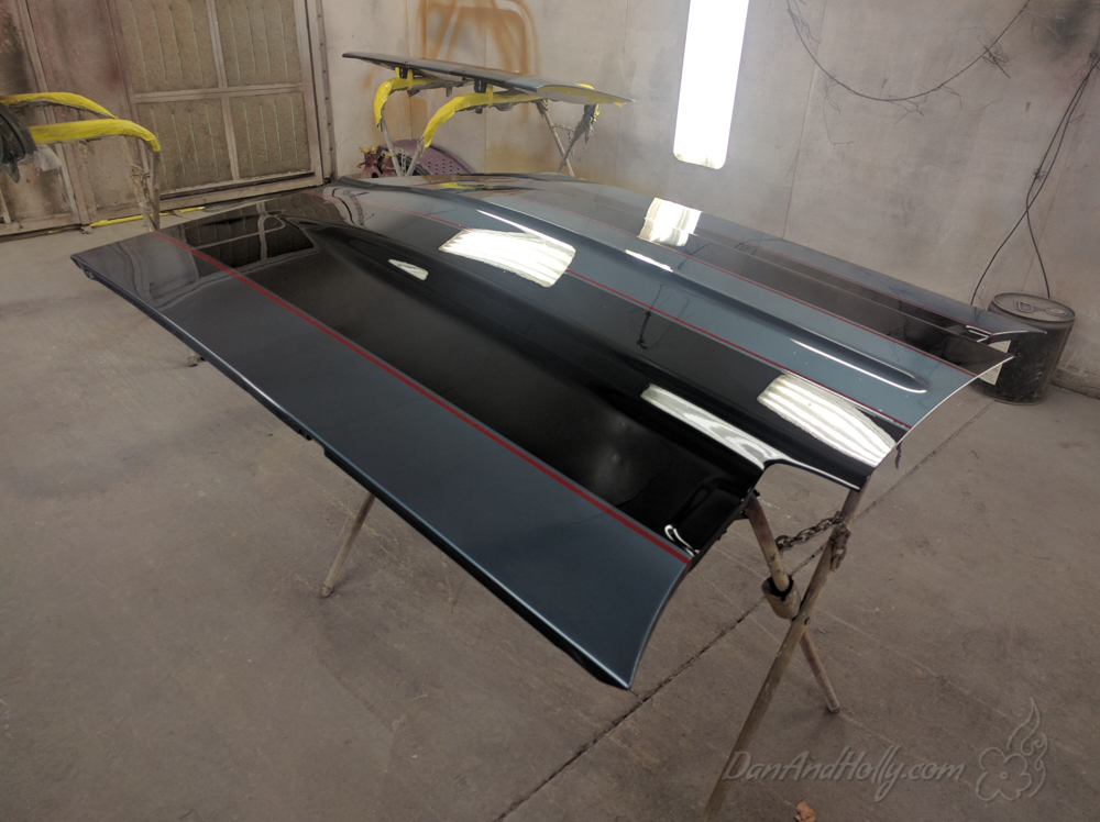

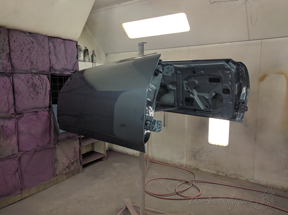

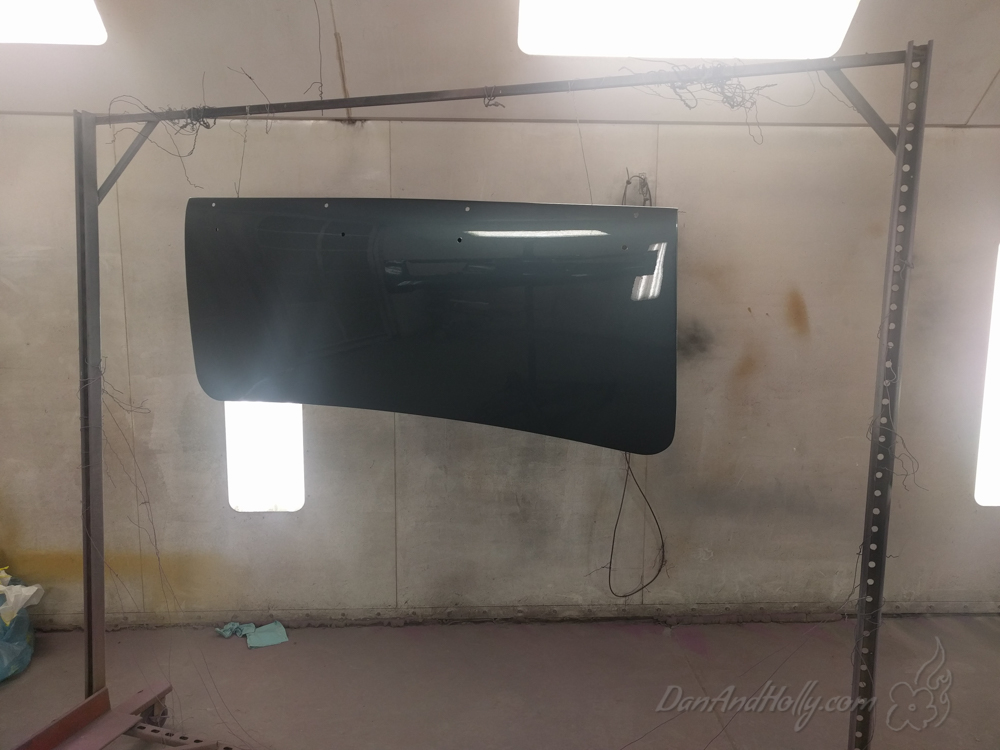

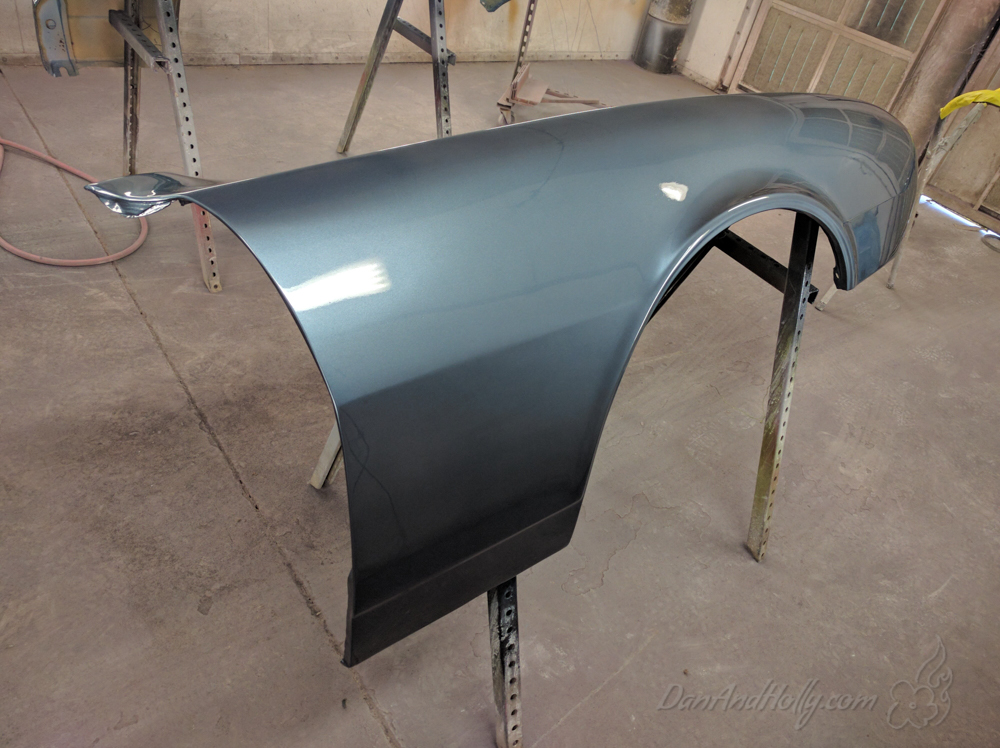

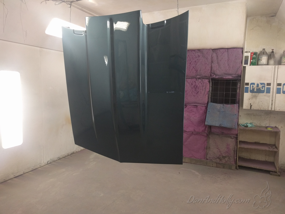

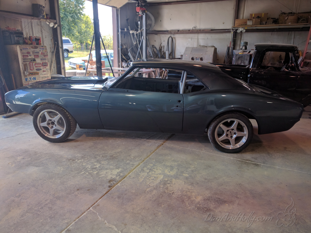

      All the panels painted
      After the body was painted and I was sure I liked it (yeah... the color choice was hard), all the panels got painted up

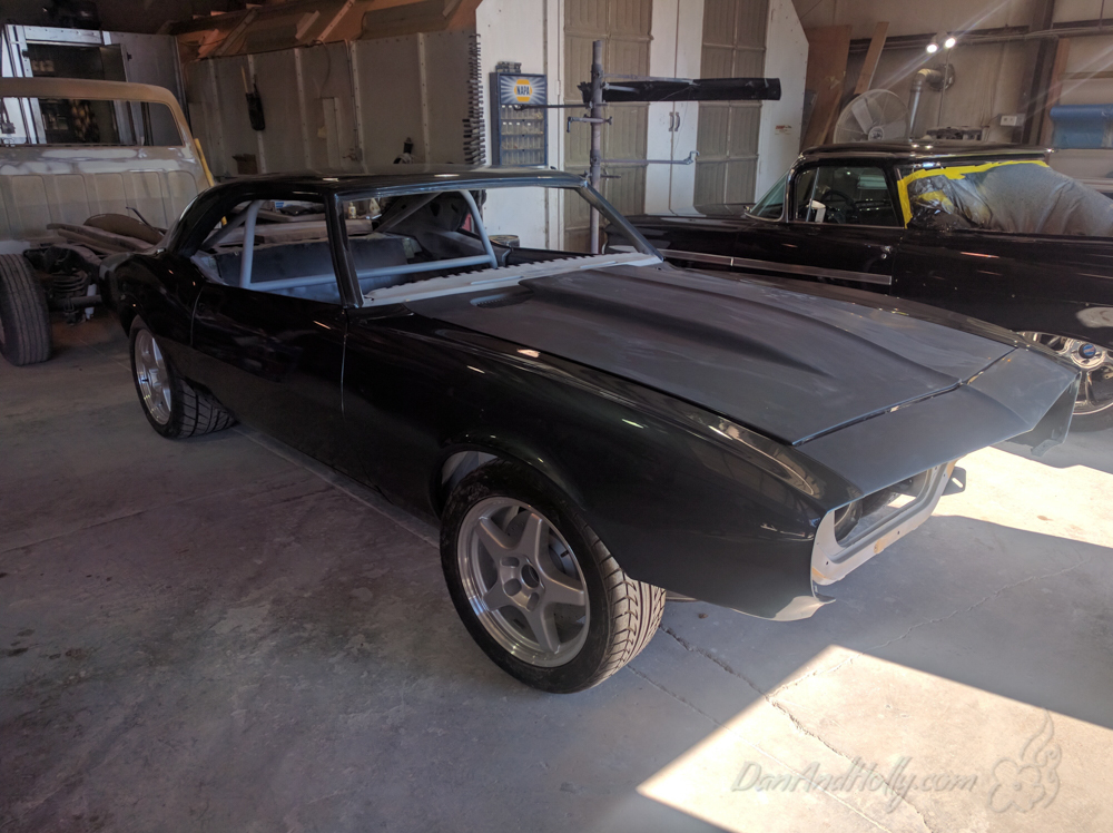

      Here is most of the panels back on the car. The car hasn't been painted and all together since at least 1996. Crazy!
      That booty though! You can't tell much about the color, but I love this view.

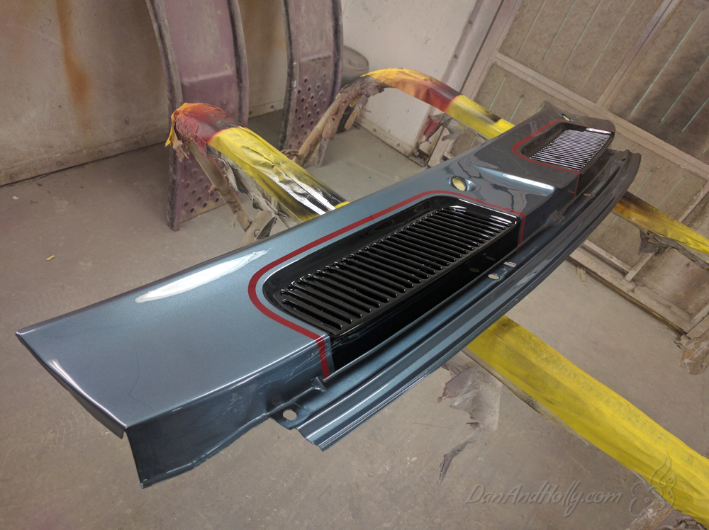

      Stripes!
      All the panels were put on the body ultimately so we could make sure everything was lined up before adding the stripes. Here's the hood all scuffed back up

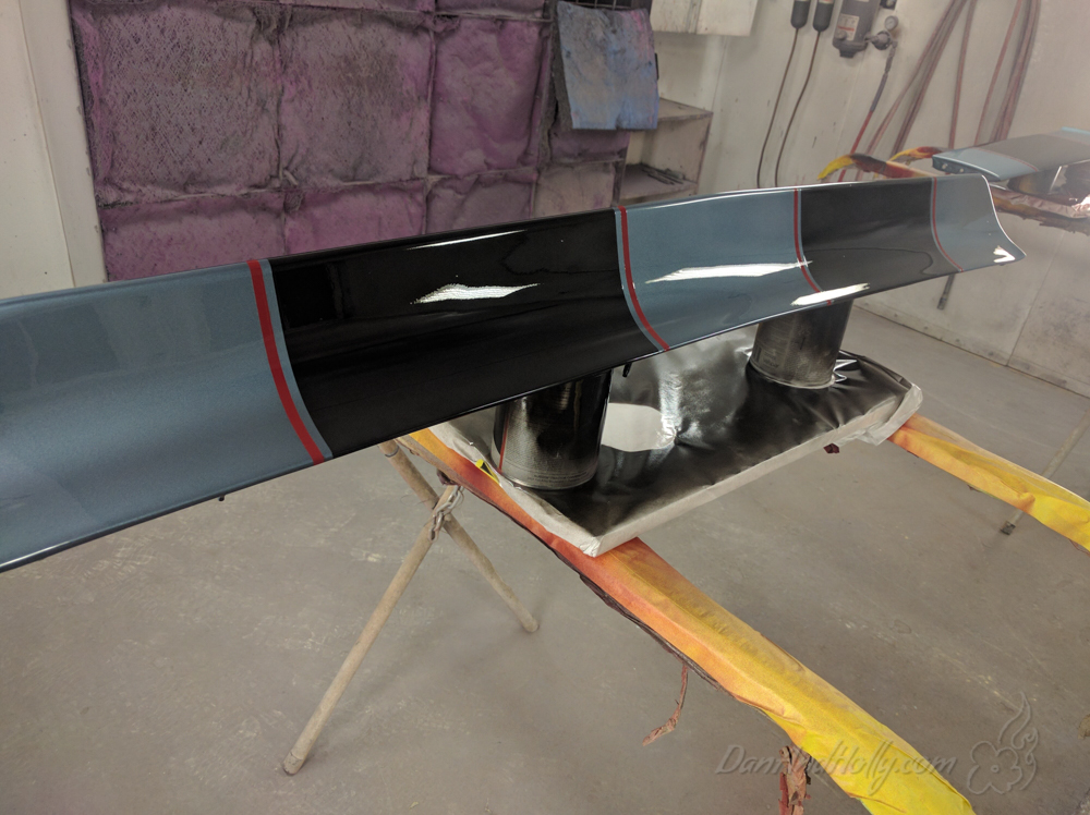

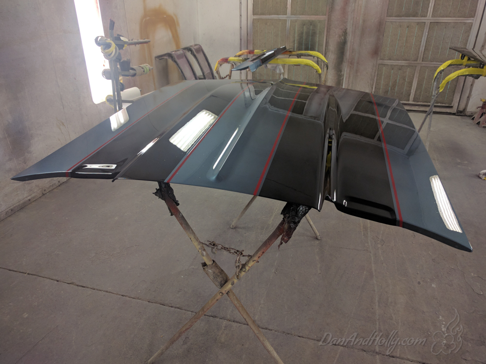

      Aaaand the stripes. I went with a dark red pin stripe just for something different. At the time I thought of this, it wasn't too common... but now it's everywhere. Oh well, I still like it!

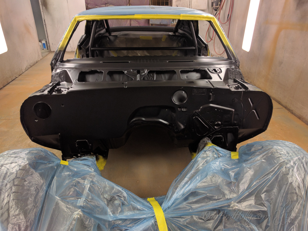

      Interior and engine bay painted
      Last but not least, we got the inside all painted black and the engine bay as well. Now, time to put it all back together!
      The plan now is to get all the remaining parts so that we've got everything all in one place, and my guy can just go to town assembling it all. So far, of the missing pieces I've ordered the fuel tank, pump, filter, lines, etc. I've also ordered the Vintage Air AC stuff (whew MAN that stuff is expensive). The list isn't all that long... but it's all adding up $$$ pretty quickly. My goal is to have the car done in April. We'll see!

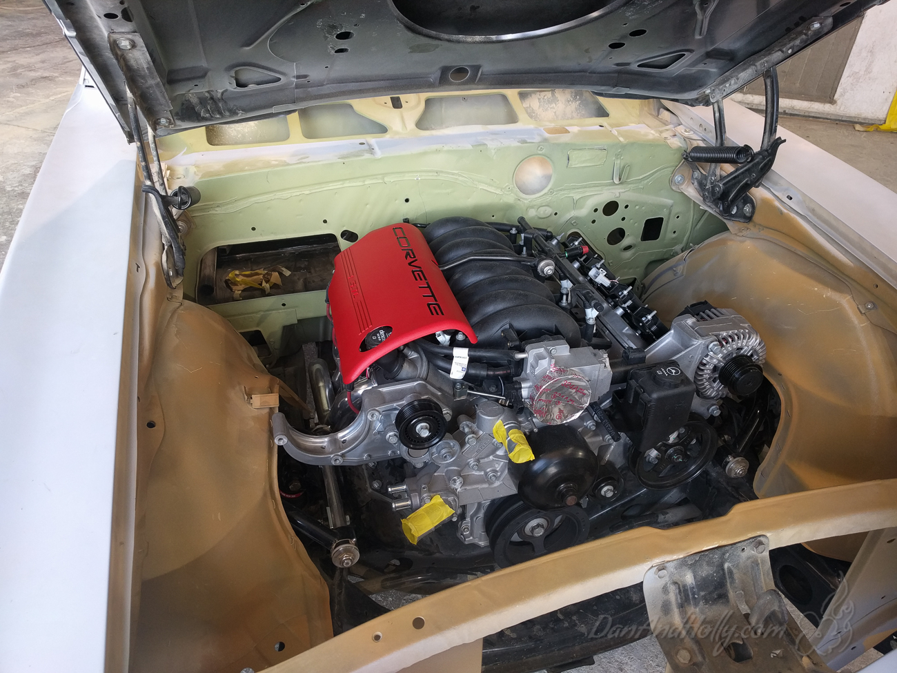

      Oh yeah! I guess you probably noticed that we also smoothed the firewall with DSE's kit since I last updated as well. I've also now managed to fix all the images in earlier posts, so it should be all showing correctly again. Now... back to spending money!
