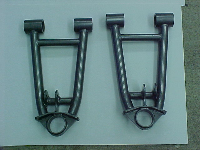

      Last post for today! Can you tell we got a hell ofa lot of work done this weekend?

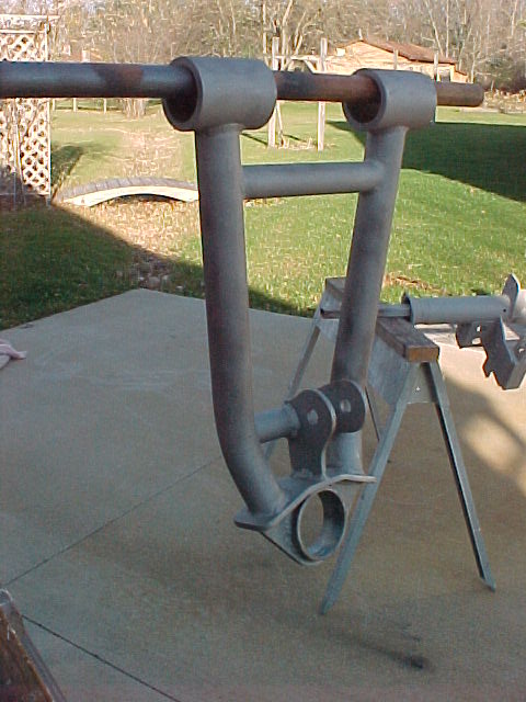

      The upper and lower control arms were run thru the blasting cabinet after I deburred them.
      These are the upper arms... The one on the right had just come out of the cabinet. It was the guy on lefts turn next...
      As the parts came out of the cabinet I would hang them on my trusty step ladder and prime them.
      I got all of the arms primed Saturday afternoon. It sure was a beautiful day for the middle of November!
      Here are both lower arms in their Grey coats
      Both upper arms.

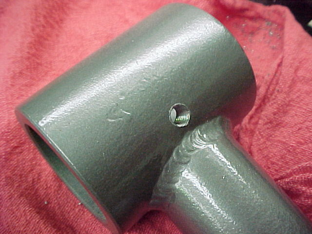

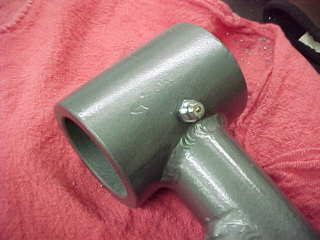

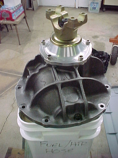

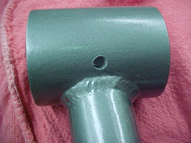

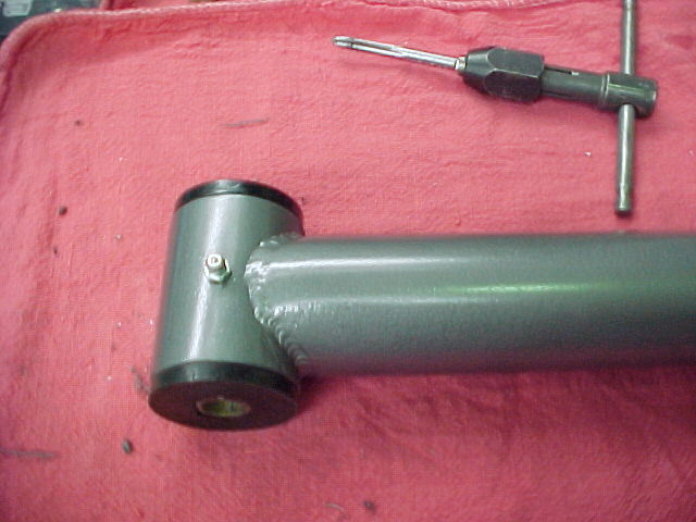

      Been picking away at the details during the week. I get home from Warren around 4pm so I have some time to spend in the shop in the evenings. Last night and tonight I worked on painting the 3rd member and UCA cross shafts and drilling and tapping the suspension bushings (8 of them) for grease zerks.

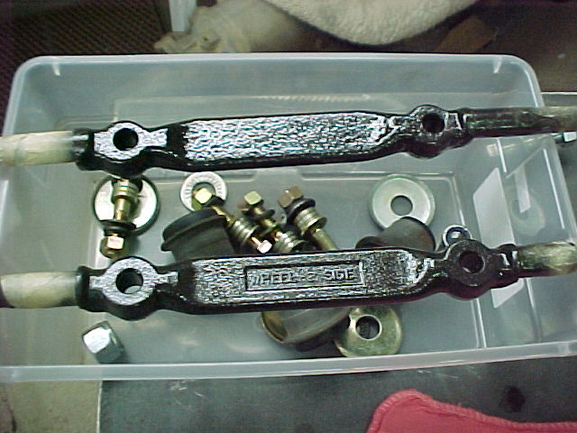

      Here is the 3rd member before paint. I used the same Rustoleum Black "Hammered" that is on the housing.
      and after
      Drilling and tapping the bushing sleeves in the upper control arms.
      After tapping
      and with a zerk installed.
      Same process on the rear link bars.

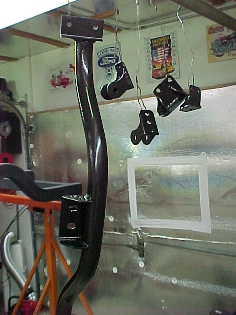

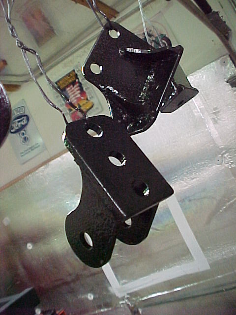

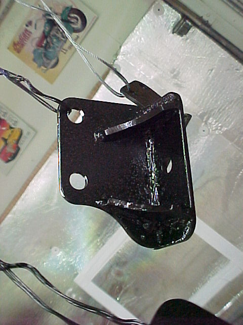

      Got some more details finished up last night. I rolled out the blast cabinet and cleaned up the steering rack brackets, lower shock brackets and the trans crossmember. I shot them all with the "Hammered" black.
      One of the rack brackets.
      A lower shock mount.
      Not a good pic of the Xmbr, but it is done and is off the list!

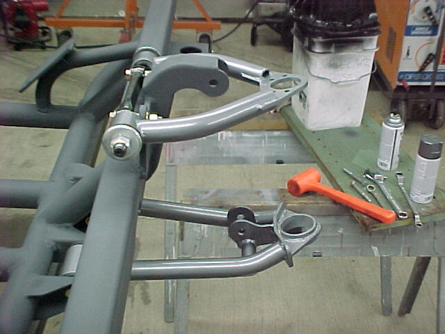

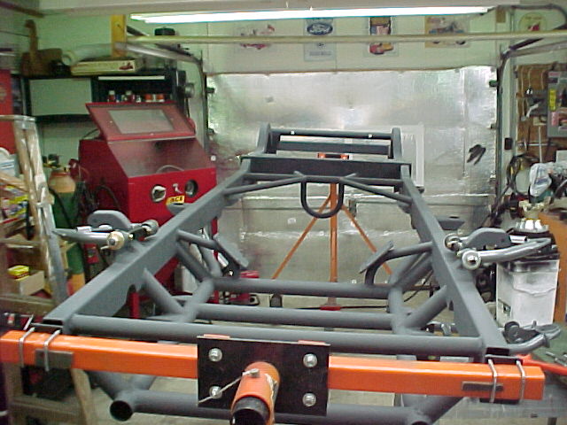

      Here are some shots of suspension mock-ups. Just to see what it will look like. That Rustoleum primer has really gotten gray in the last day or so.

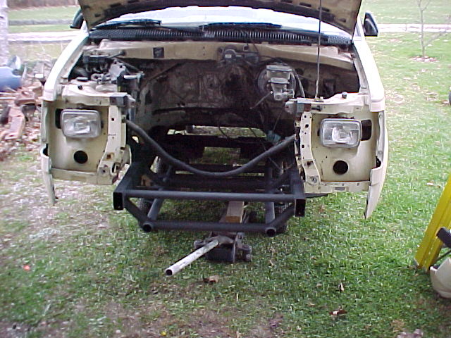

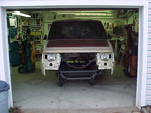

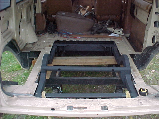

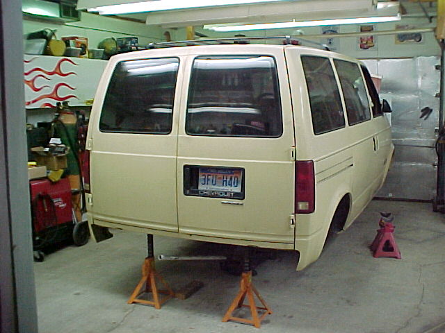

      Got a little bit accomplished today. The goal was to get the body and chassis married and trundled over to the working side of the shop. Got that done along with a few other little things.
      We bolted the frame back in place and set the van back on the body cart.
      After we pushed it outside
      The back half
      LOL. i just start chuckling every time I look at this one...
      Lynette did a good job pulling around back.
      Once we had it on the pavement we unhooked the Cubby and pushed it inside.
      This is where it's going to live for a while. Cage and tinwork are comin up. I have some work to do to get it leveled up and I am going to drop the stand height a bit but this where I will be spending a few hours this winter.
