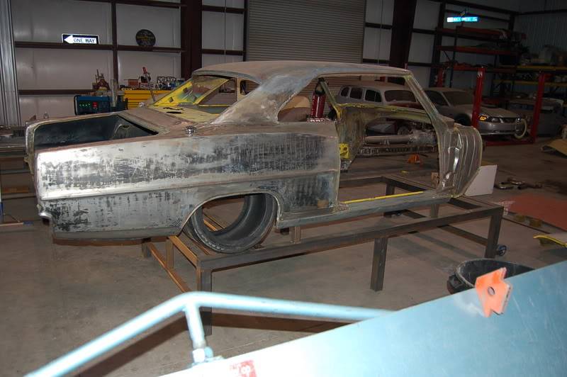

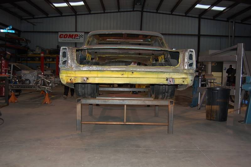

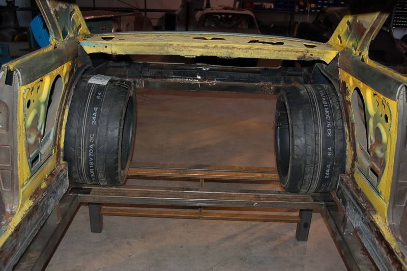

      Finally got this beast in to fab! Couple of photos of the wheel fitment/stance. Wheels in the photo are 18's in the rear 17's in front. Opinions welcome!

      I personally think if you kick the wheel sizes up to 19" rear and 18" front it would give it a little better look. Also any thoughts on using Morrison's GMax chassis with vette front and their new 3-Link in the rear?

      Don't want to get the "Wagon Wheel" effect with such big wheels plus the ratio from front to back would make it harder to engineer the IFS to not hit the fenders, Rack, Rails, etc in terms of turn radius and bump travel in relation to the ride height. I spoke to Craig Morrison a little but I really want to get this thing started and it seems that they are still in the prestages of finishing up their design for the II. I like their Gmax Chassis and we will be doing something similar to it. Front end on this project will be C6 lowers and custom uppers. I'm not sure how AM is going to pull off the C5 'Vette UCA as we haven't been able to make it work for us unless they are going to go with the stock 'vette attach points but then the Roll center is to high. We tried to improve the FVSA so that our RC was better but because of the height of the 'vette spindle the ball joint was binding so we decided to not use the 'vette upper. The rear is going to be C6 IRS. Anyone at AM care to comment on this please do. The shop I am using http://www.ironworksspeedandkustom.com/ is close so I can go in and hound them(Rodger Lee, the owner, is probably cringing)! Check out the '57 truck they are building.
