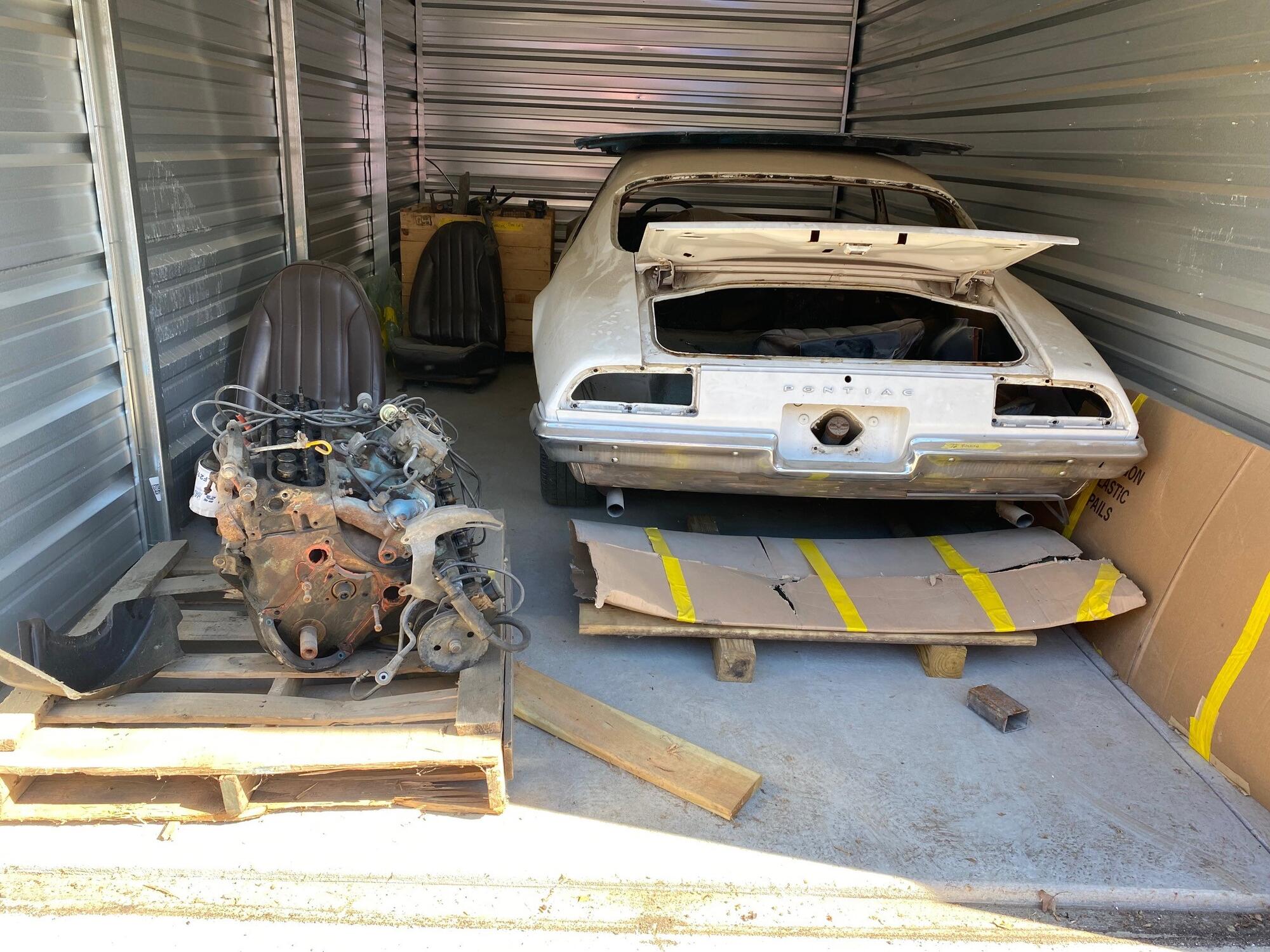

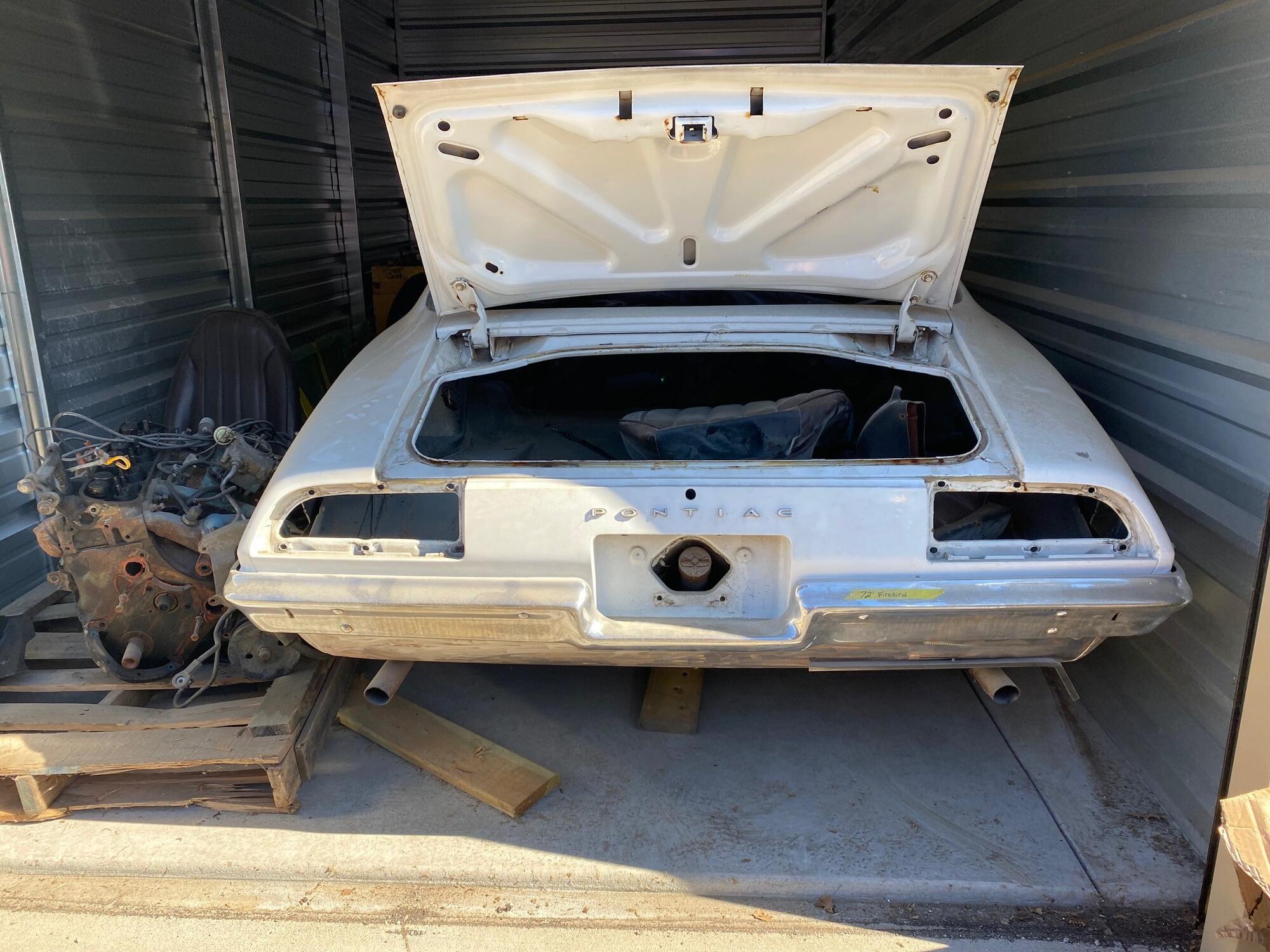

      Storage unit find
      The car was originally a Formula with a 350 cu in. small block, two barrel carb and automatic transmission. A southern car that made its way to the east coast and was a running vehicle until the prior owner started to modify. Due to COVID and other life events, the project was started and the owner started to strip the car and some body modifications were roughed in but was quickly put on hold and never started again. It sat in storage for over six years in Michigan. I purchased the car in August of this year and started the tear down process.
      Name:  Rear with all parts view.jpg
Size:  411.5 KBName:  Rear.jpg
Size:  359.9 KBName:  IMG_7835.jpg
Size:  357.4 KBName:  Front valance full view.jpg
Size:  348.4 KBName:  Engine bay.jpg
Size:  365.5 KBName:  Drivers rear fender.jpg
Size:  283.2 KBName:  IMG_7833.jpg
Size:  373.9 KBName:  IMG_7901.jpg
Size:  604.6 KBName:  IMG_7900.jpg
Size:  521.7 KBName:  IMG_7902.jpg
Size:  642.6 KBName:  Interior.jpg

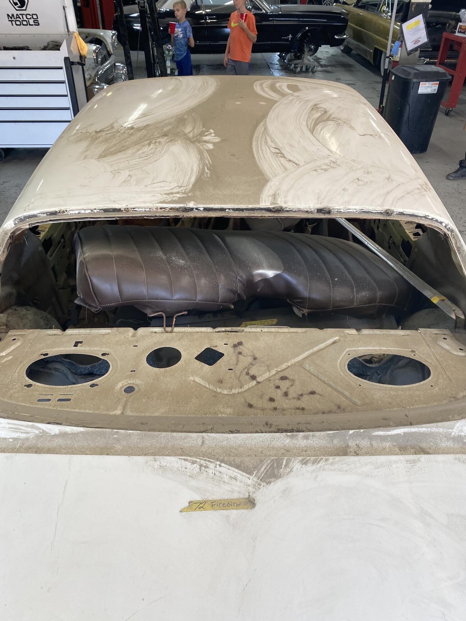

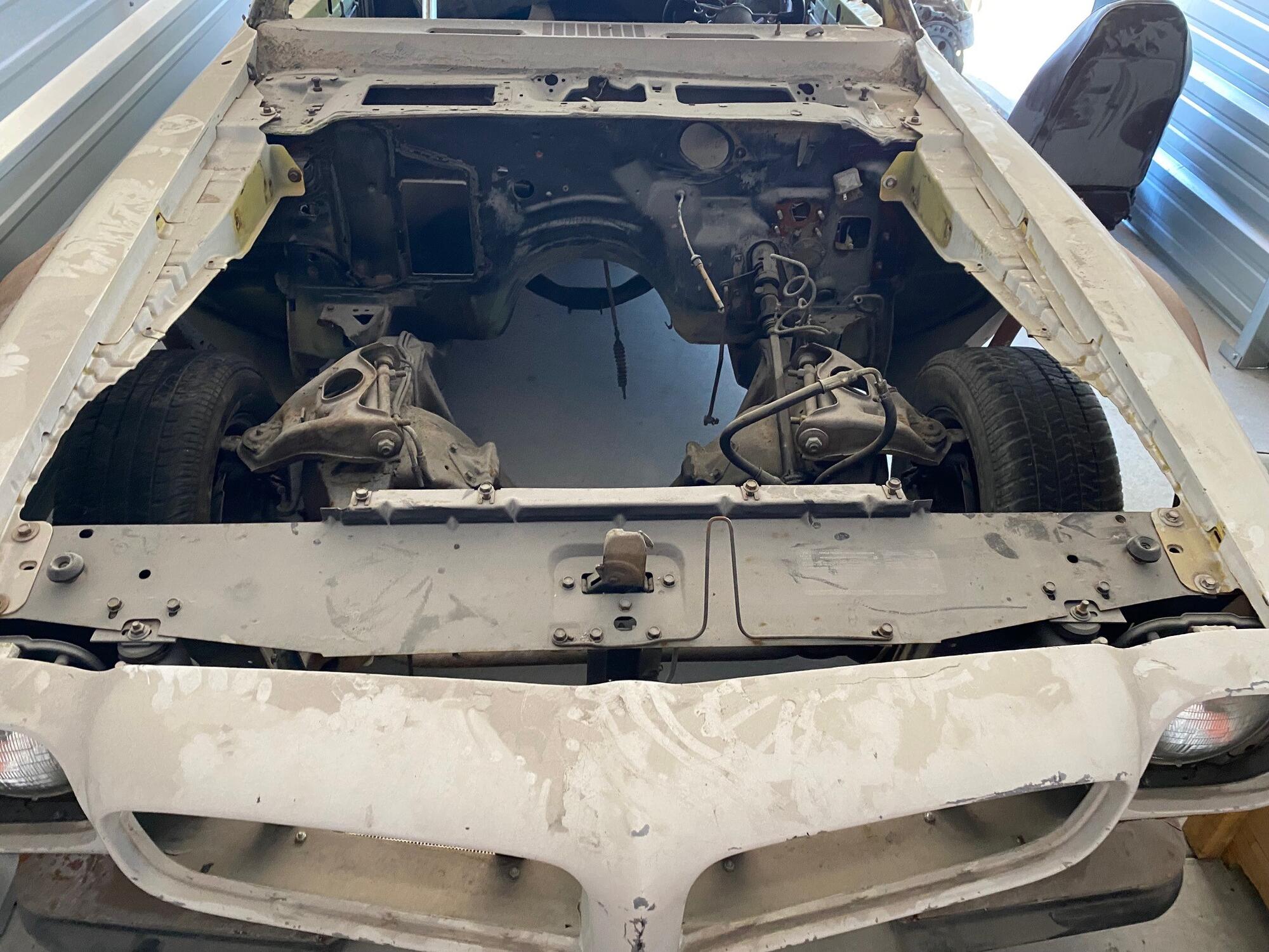

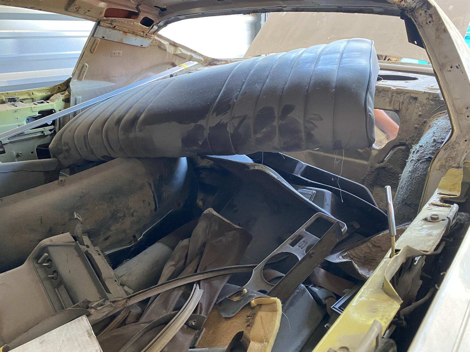

      Working with All Speed Customs to assist with the tear down and stripping to see what we are working with.
Size:  489.5 KBName:  IMG_7914 - Copy.jpg
Size:  415.5 KBName:  IMG_7915 - Copy.jpg
Size:  444.6 KBName:  IMG_7916 - Copy.jpg
Size:  396.5 KBName:  Rear.jpg
Size:  422.0 KBName:  IMG_7918.jpg
Size:  339.7 KBName:  RR quarter.jpg
Size:  463.6 KBName:  Image - Copy.jpg
Size:  498.6 KBName:  Image - Copy.jpg

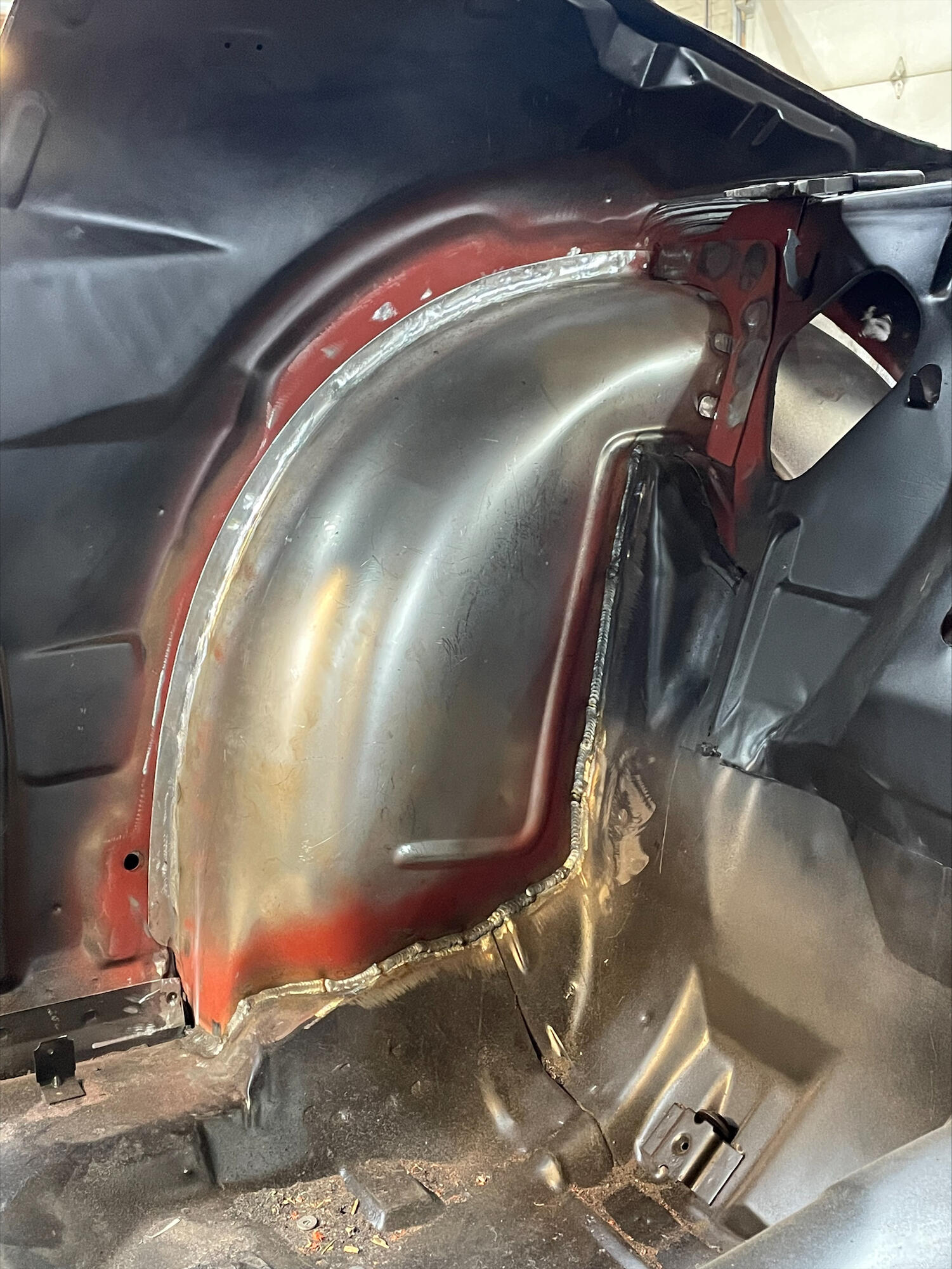

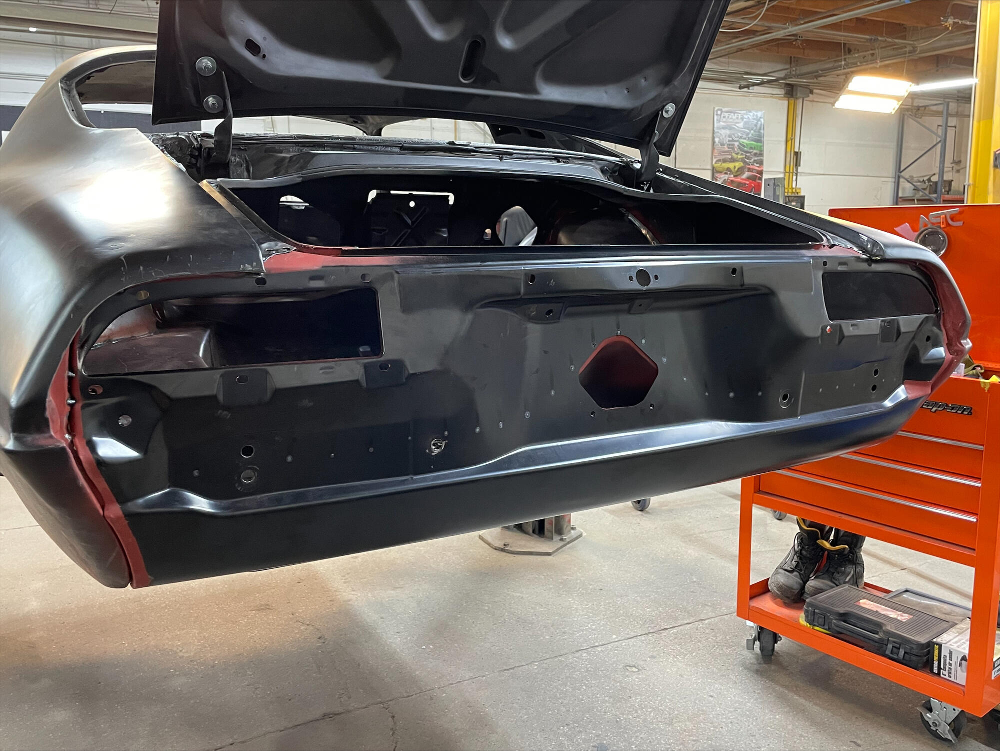

      Jan 2009
      110

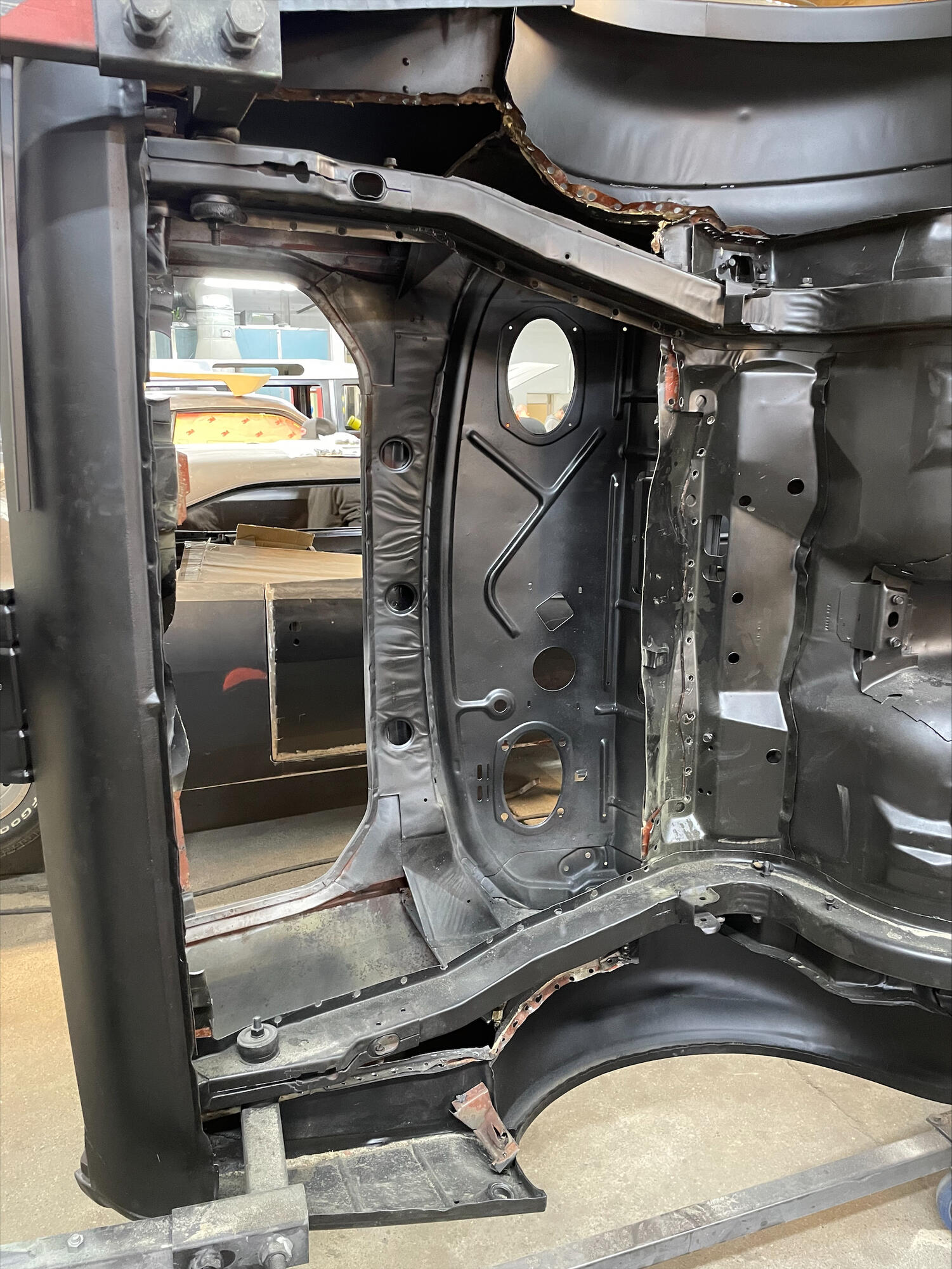

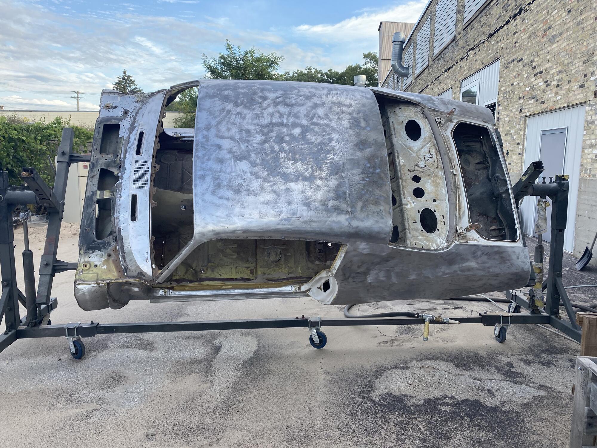

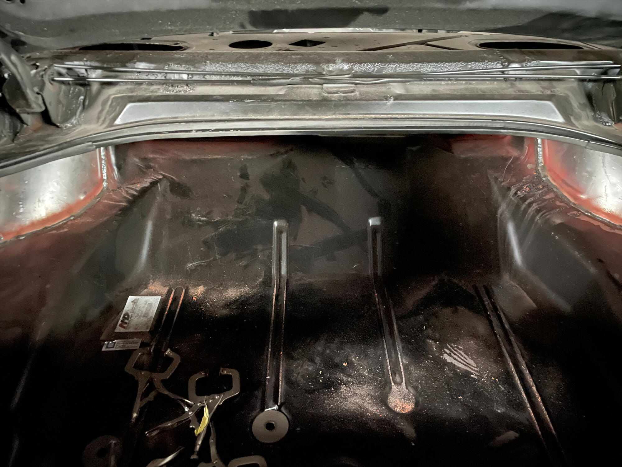

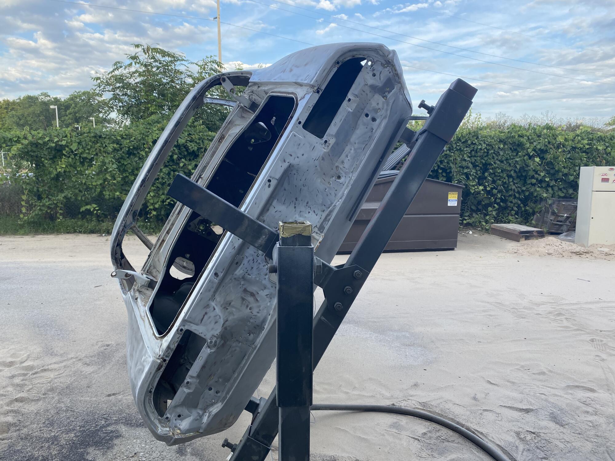

      Media blasting went well. Trunk pan had a few soft spots so we decided to cut it out and replace.
Size:  592.3 KBName:  IMG_8048.jpg
Size:  527.2 KBName:  IMG_8049.jpg
Size:  527.0 KBName:  IMG_8051.jpg
Size:  409.7 KBName:  IMG_8052.jpg

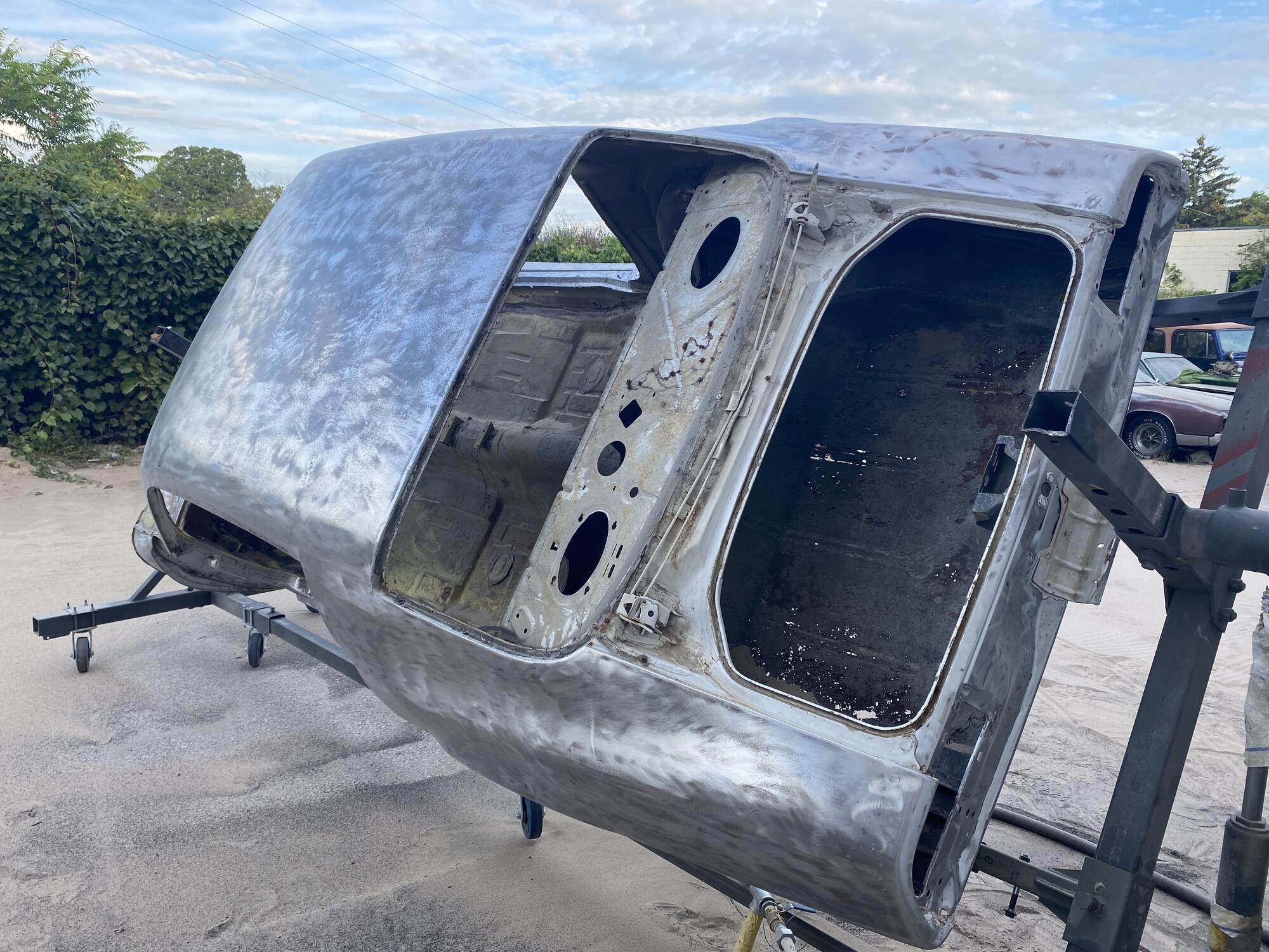

      Following the media blast the body has not been sealed. Trunk pan was removed and replaced and Detroit Speed Mini-Tubs were installed so we can get a large enough shoe under this thing to grip the road when we are all done. Car is back on the original frame and body modifications will start next.
Size:  472.2 KBName:  Hood blasted.jpg
Size:  452.9 KBName:  Image.jpg
Size:  437.9 KBName:  Mini tub FR.jpg
Size:  416.3 KBName:  Mini tub RL.jpg
Size:  368.3 KBName:  Mini tub rough in 2.jpg
Size:  407.6 KBName:  Mini tub rough in.jpg
Size:  368.7 KBName:  Mini tub RR rough in.jpg
Size:  359.7 KBName:  New trunk pan.jpg
Size:  410.2 KBName:  Rear panel install.jpg
Size:  401.0 KBName:  Rear view mini tubs.jpg
Size:  419.5 KBName:  Trunk pan rough in.jpg
Size:  378.8 KBName:  Body on hoist.jpg
Size:  478.6 KBName:  Body on hoist.jpg

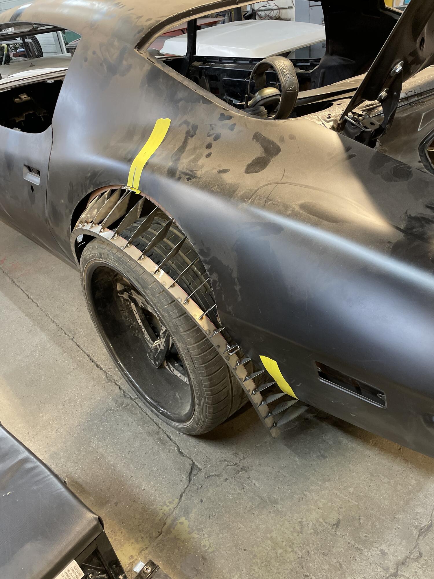

      Jan 2009
      110

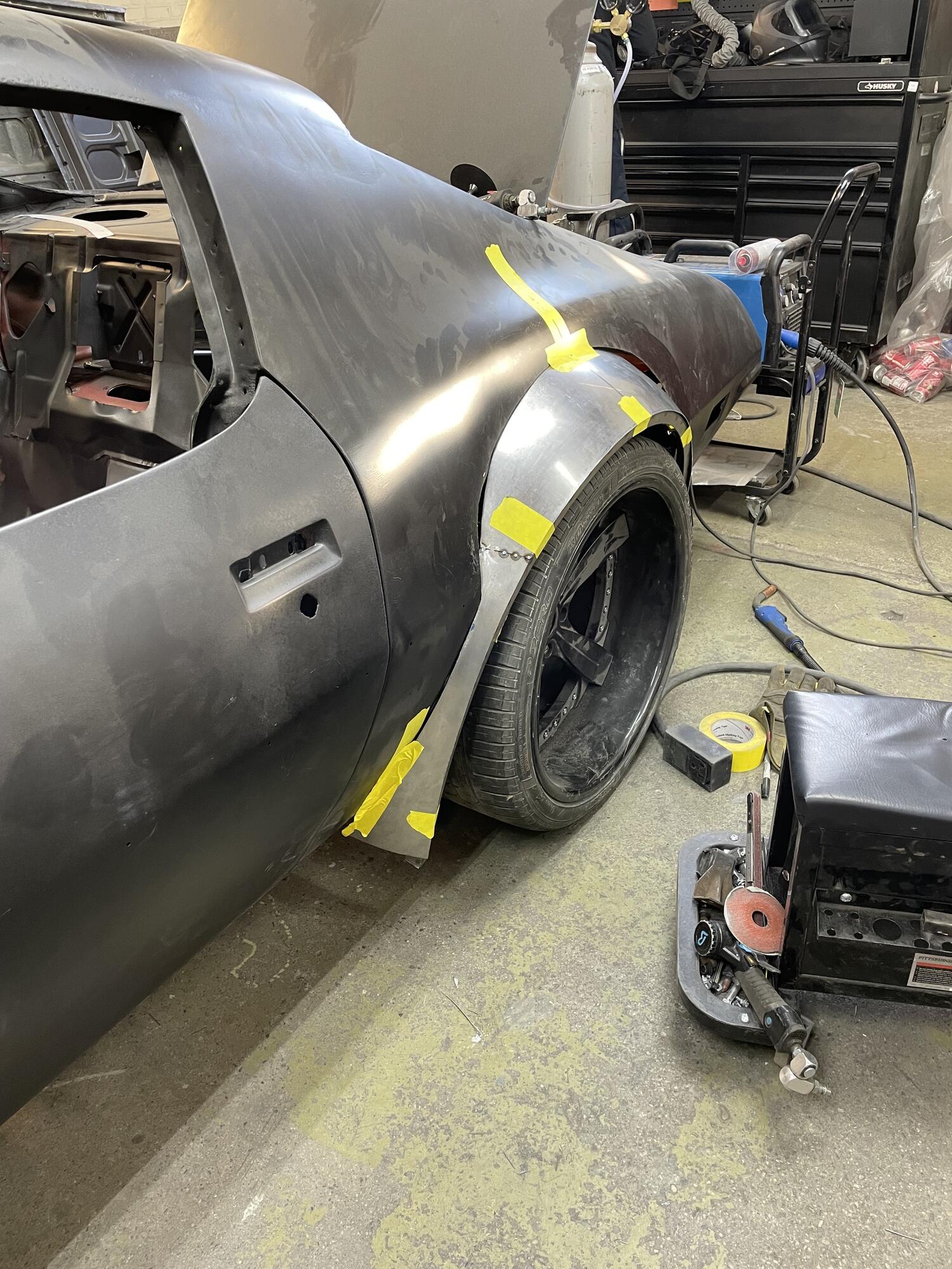

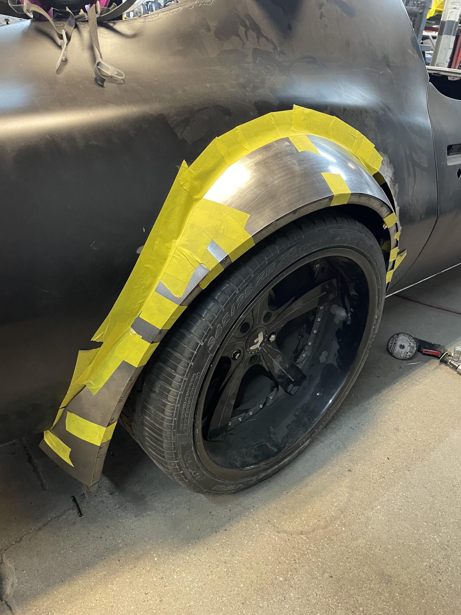

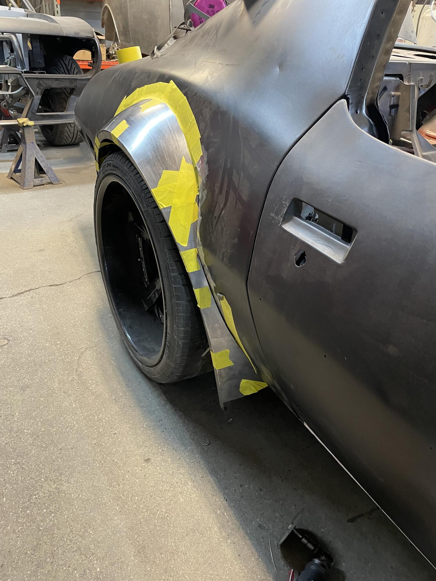

      Working through the updated fender flares for a 20/345 rear tire and 20/285 front tire. Once we complete we will finish the rocker skirting and plumb in the rear brake air scoop.
Size:  322.0 KBName:  68867598008__DE39F8EA-3F49-419F-A5D3-714F7C576A8E.jpg
Size:  319.9 KBName:  IMG_1020.jpg
Size:  387.6 KBName:  IMG_1021.jpg
Size:  379.7 KBName:  IMG_1025.jpg

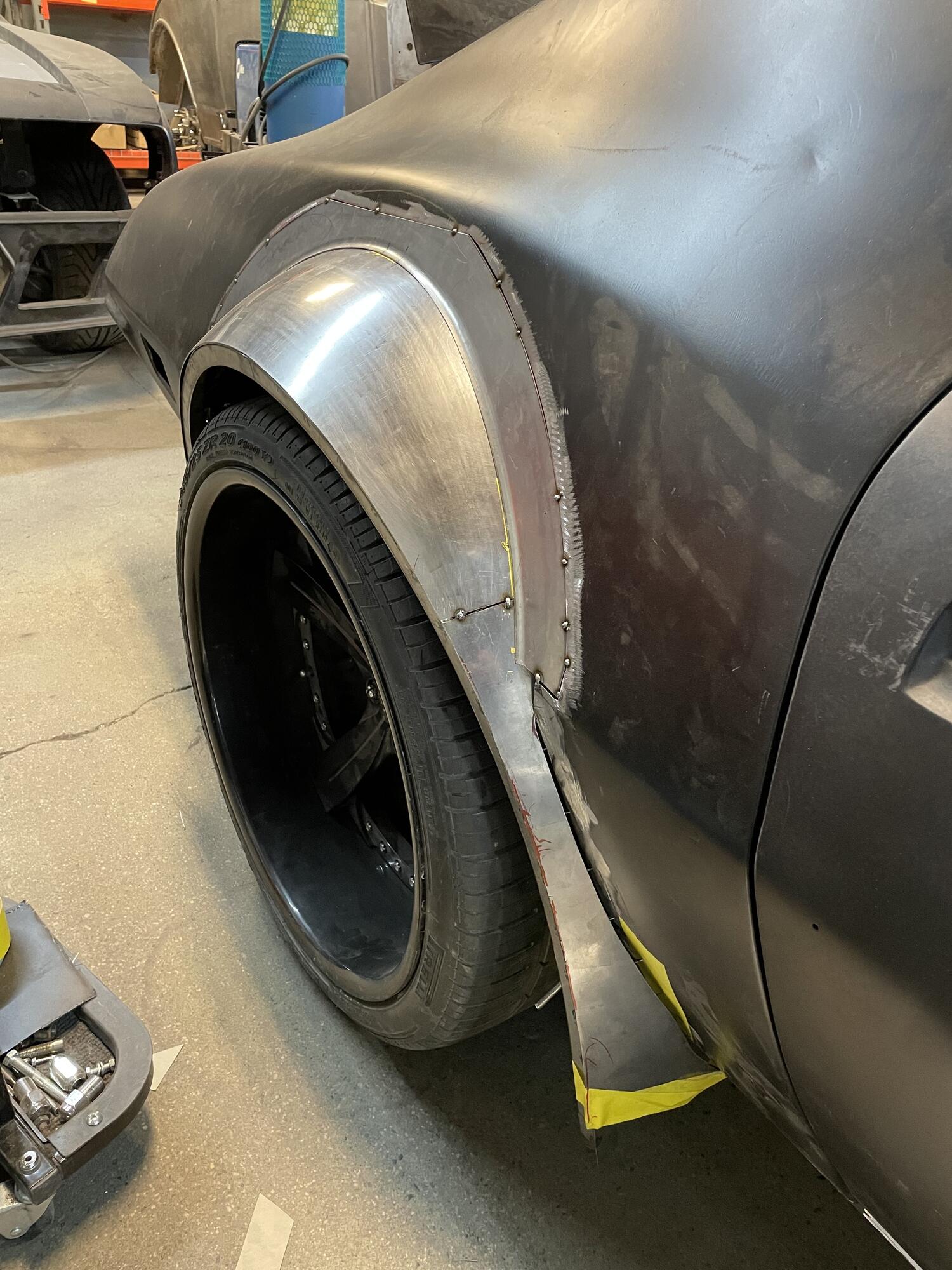

      Jan 2009
      110

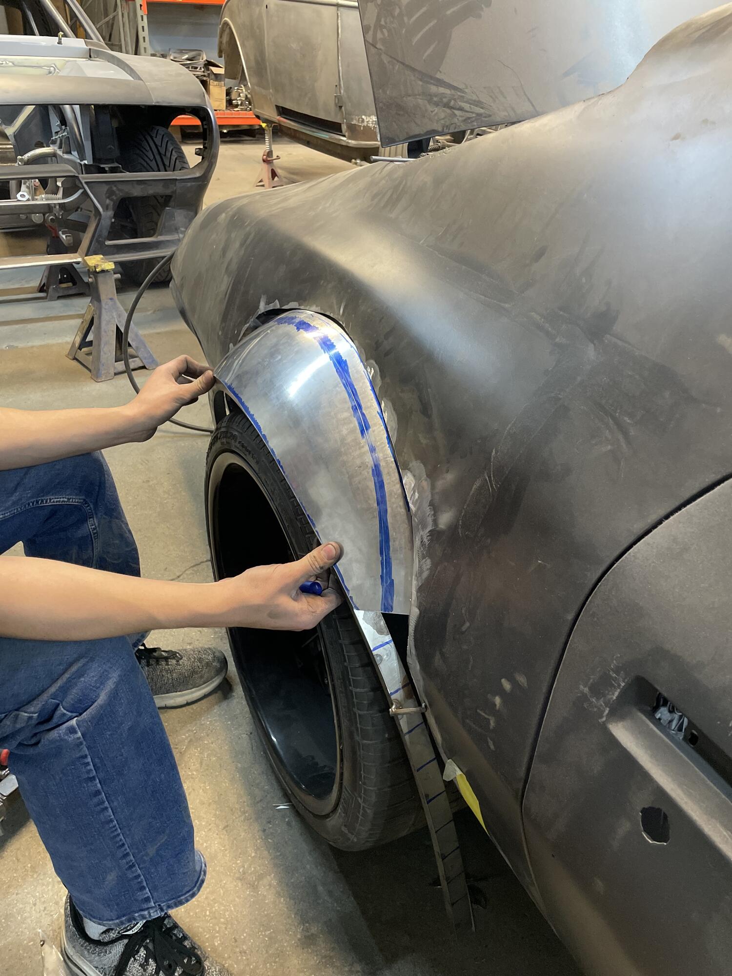

      We wrapped up the structure and sheeting for the right rear wheel flares. On to the front this week!
Size:  381.6 KBName:  68928235864__1B2B7E92-D302-4E1C-9D93-4C1EFA676A00.jpg
Size:  376.2 KBName:  IMG_1047.jpg
Size:  316.1 KBName:  IMG_1057.jpg
Size:  461.8 KBName:  IMG_1062.jpg

      16,129
      Nice work on the flares!
      Dec 2008
      Detroit
      2,665
      Kris does amazing design work! I'm sure All Speed will deliver as planned!...

      May 2020
      25
      Wow, that's some crazy flare job, the final product looks pretty good. Are the ends gonna be contoured or end flat at the bottoms? It almost looks like they have built-in mud flaps.
