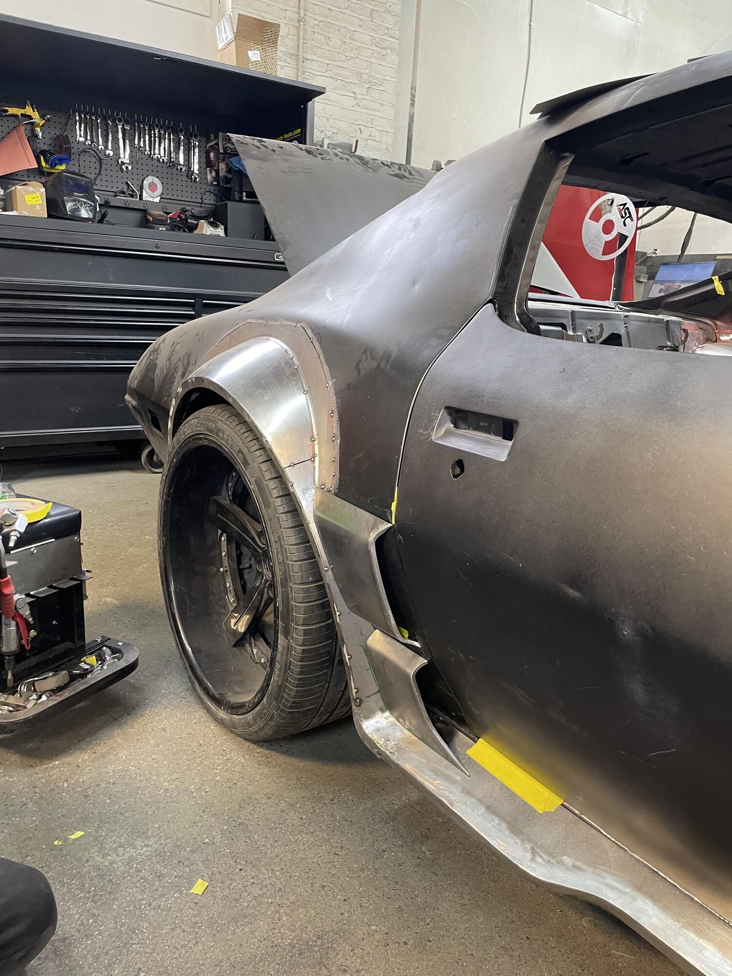

      Flares are complete and we are now working through the rocker skirting. Name:  IMG_1057.jpg

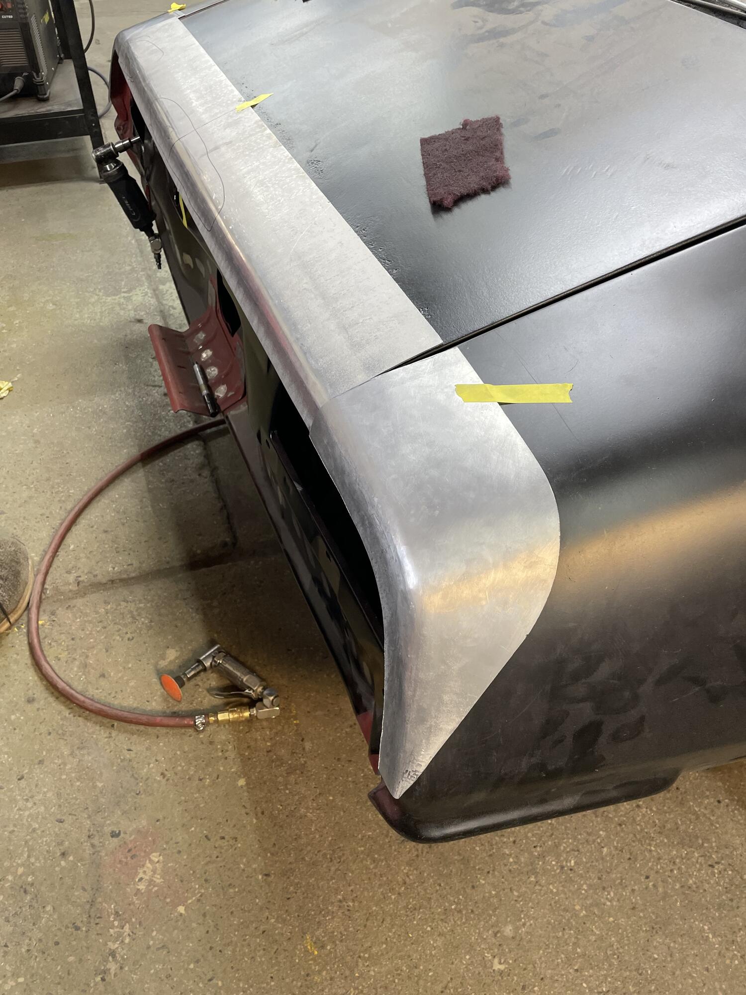

      Finished the rough in of the rear brake vent scoops and will plumb in the collector tube and box to feed air around the inside of the tire. We will use some paint detail to set these off.

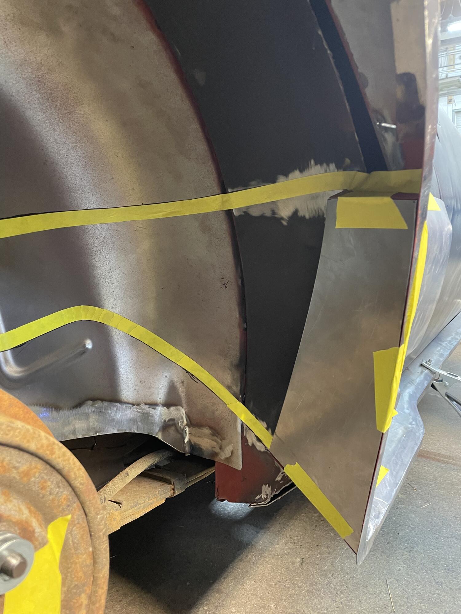

      Plumbing in the rear brake air duct. We will fab an air routing box and tube to drive air to the back side of the rotor. All Speed used their 3D printer to create an insert in the rear air collectors that reflects the old honeycomb style of the front Formula grills. We will use this pattern as inserts in the hood scoops and grill.

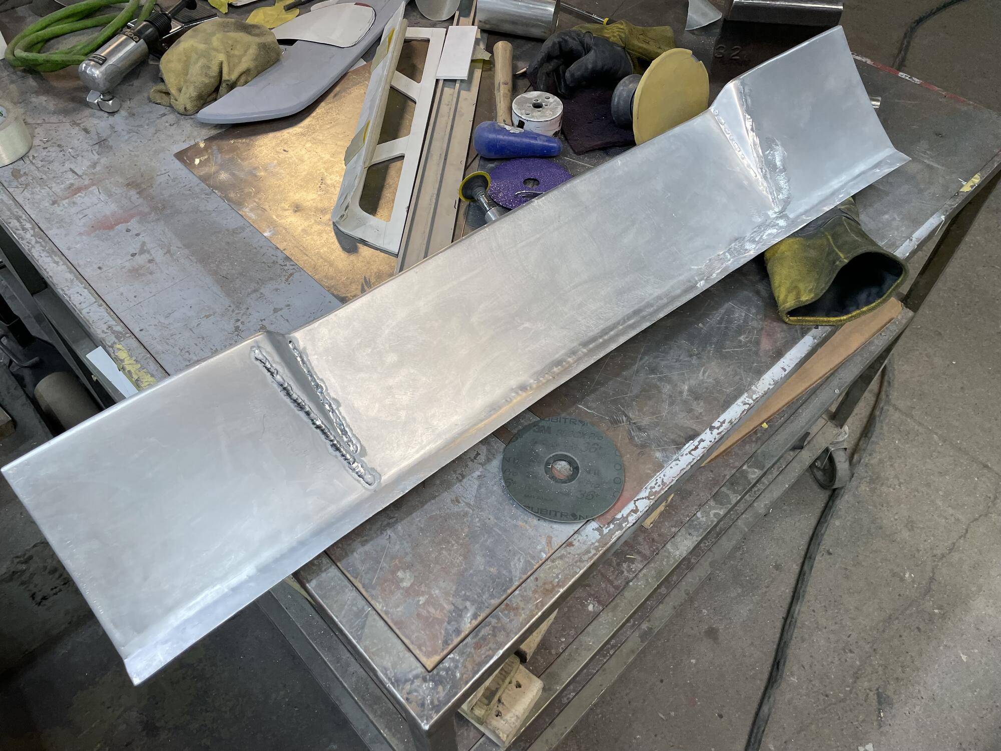

      We are mocking up the rear spoiler that will be made out of aluminum and bolt to the trunk lid. Roadster Shop chassis is just a three months out so we have a ton of work to finish before it arrives. Name:  69533536192__1B0481B3-4332-40F9-BF68-32A14FED65C4.jpg

      This thing is cool! Between that rendering and the stellar work going on it’s going to be excellent.
      How do you plan to attach your brake duct vents? If they’re permanently installed, what’s the plan for paint/sealing underneath them?
