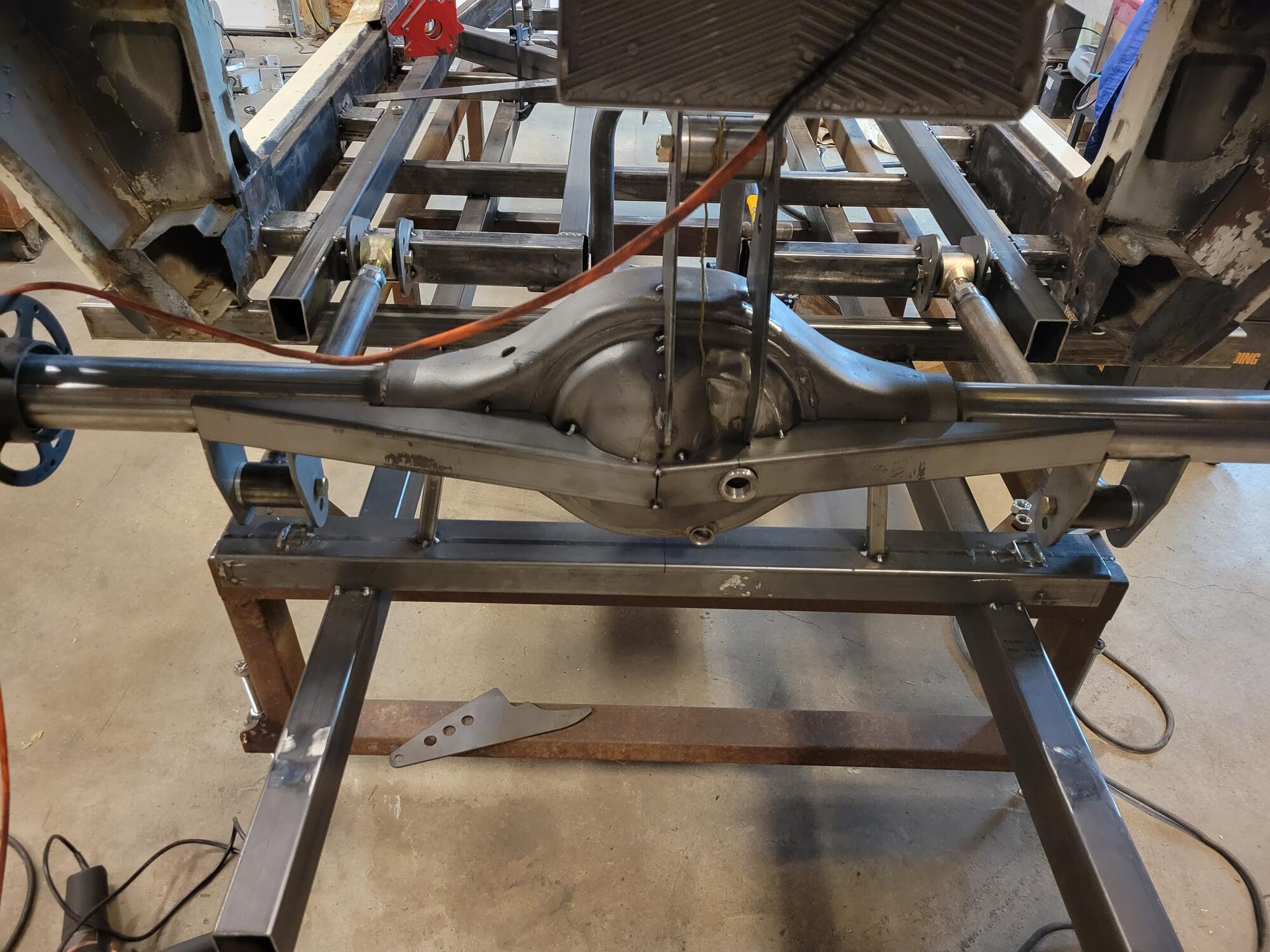

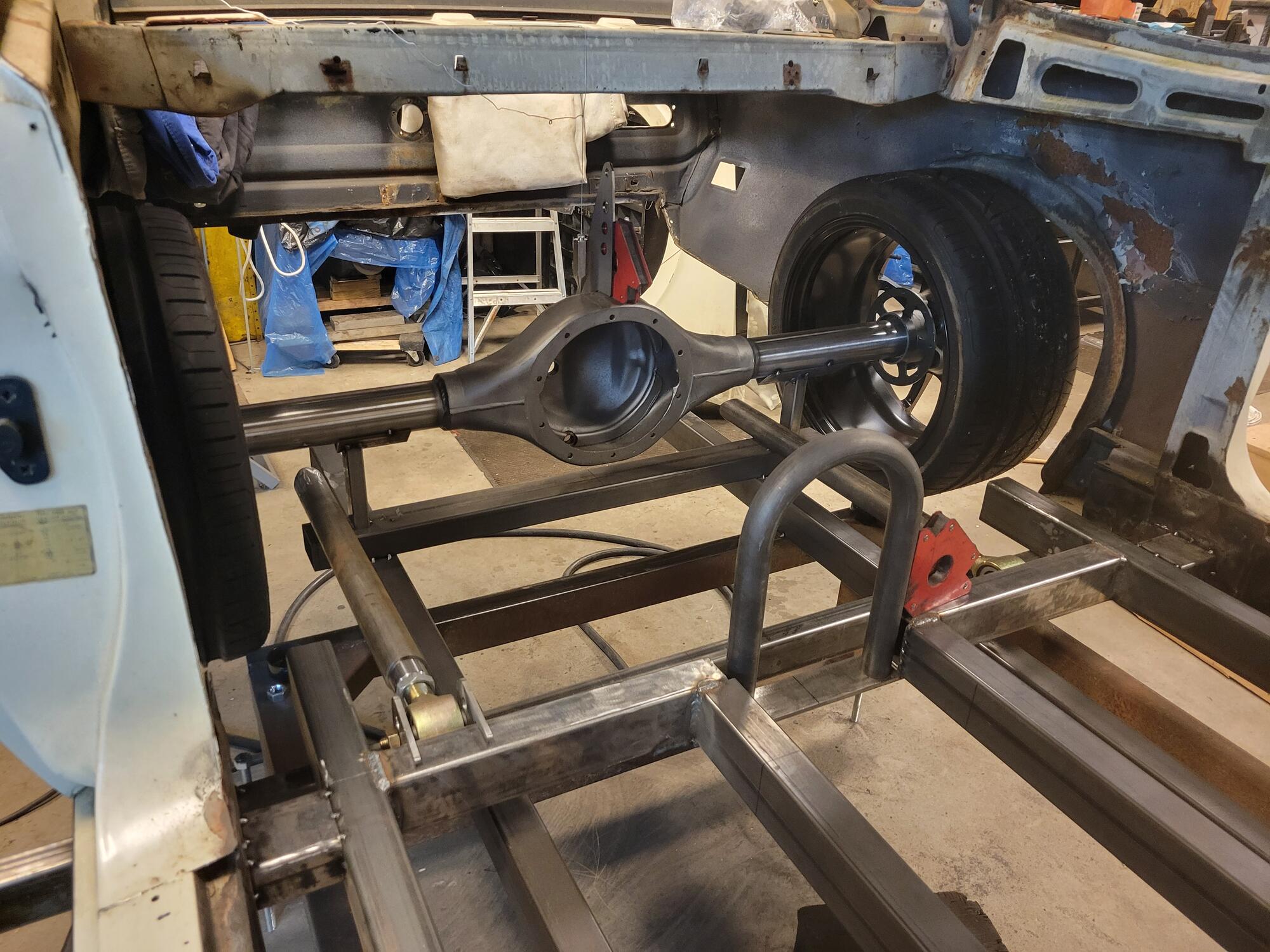

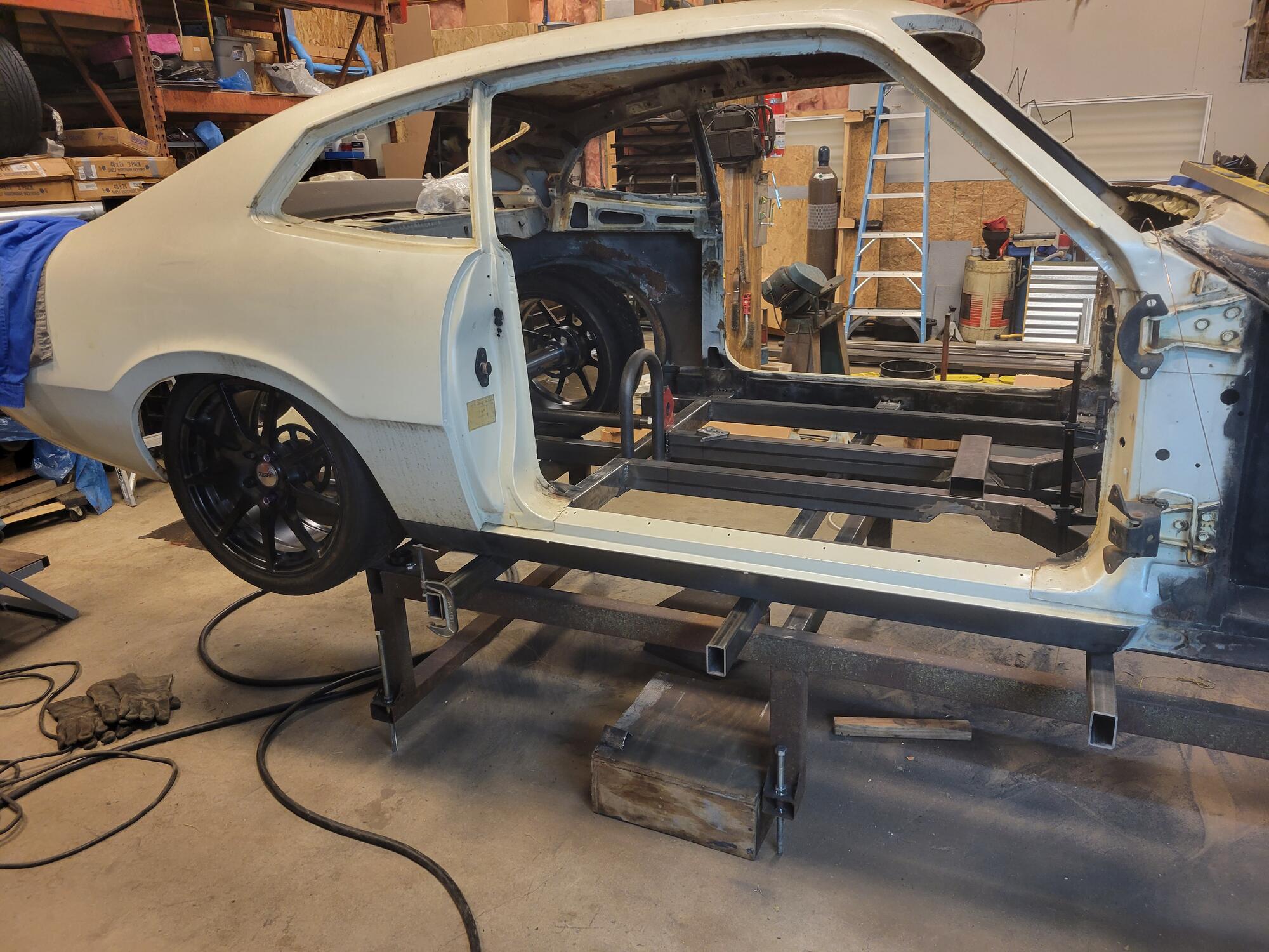

      Finished boxing in the front crossmember LCA mounts and started fitting the supports where the strut rods will mount up. Next part for the front is going to be getting the engine mounted up so I can make sure I can fit the exhaust through and what will have to get modified.
      The rear axle and suspension is mostly tacked in, I'm trying to decide the watts link vs a panhard bar so we will see, got the rear truss mocked up for now depending on which I choose. I got the front and rear seats so I am going to extend the rear frame out now and make sure I can get the clearances I need and still make the rear seats fit. Also have to get shocked picked out so I can get Her off the frame table and sitting on the wheels.

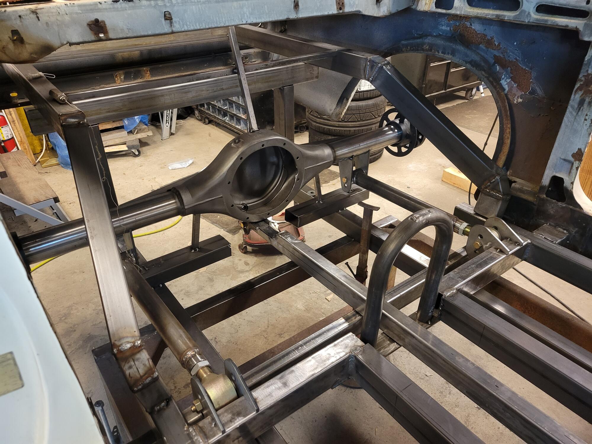

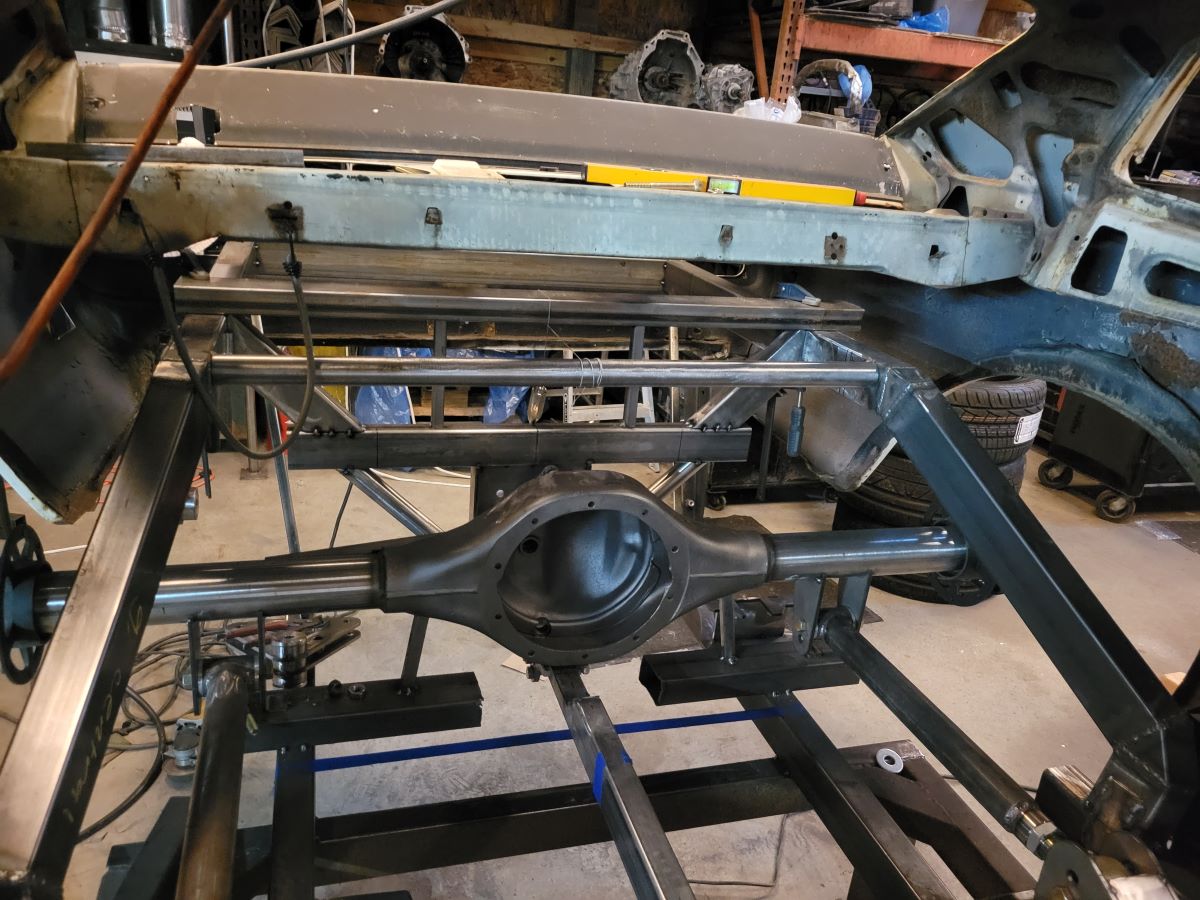

      After several days of wire mockup and test fitting I'm going to be changing the rear suspension up from a torque link upper to a torque arm setup. Reason mainly being packaging and I need a back seat for the kiddos. Really opens up the rear area and I will have plenty of space underneath for the torque arm. I have also Started the final setup of the front suspension, I've remade the front crossmember to fit correctly and almost finished up the mounting of the strut rods.
