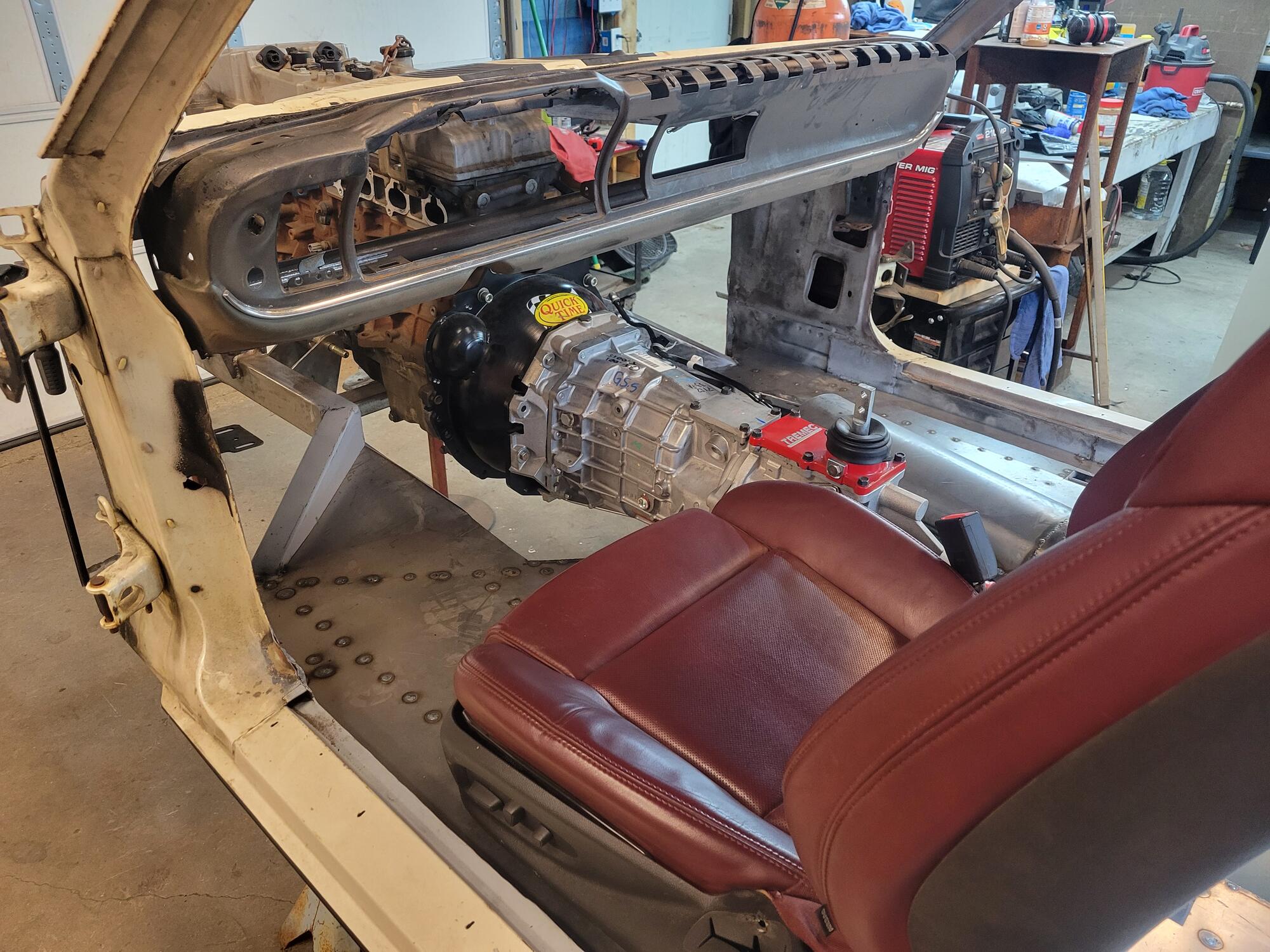

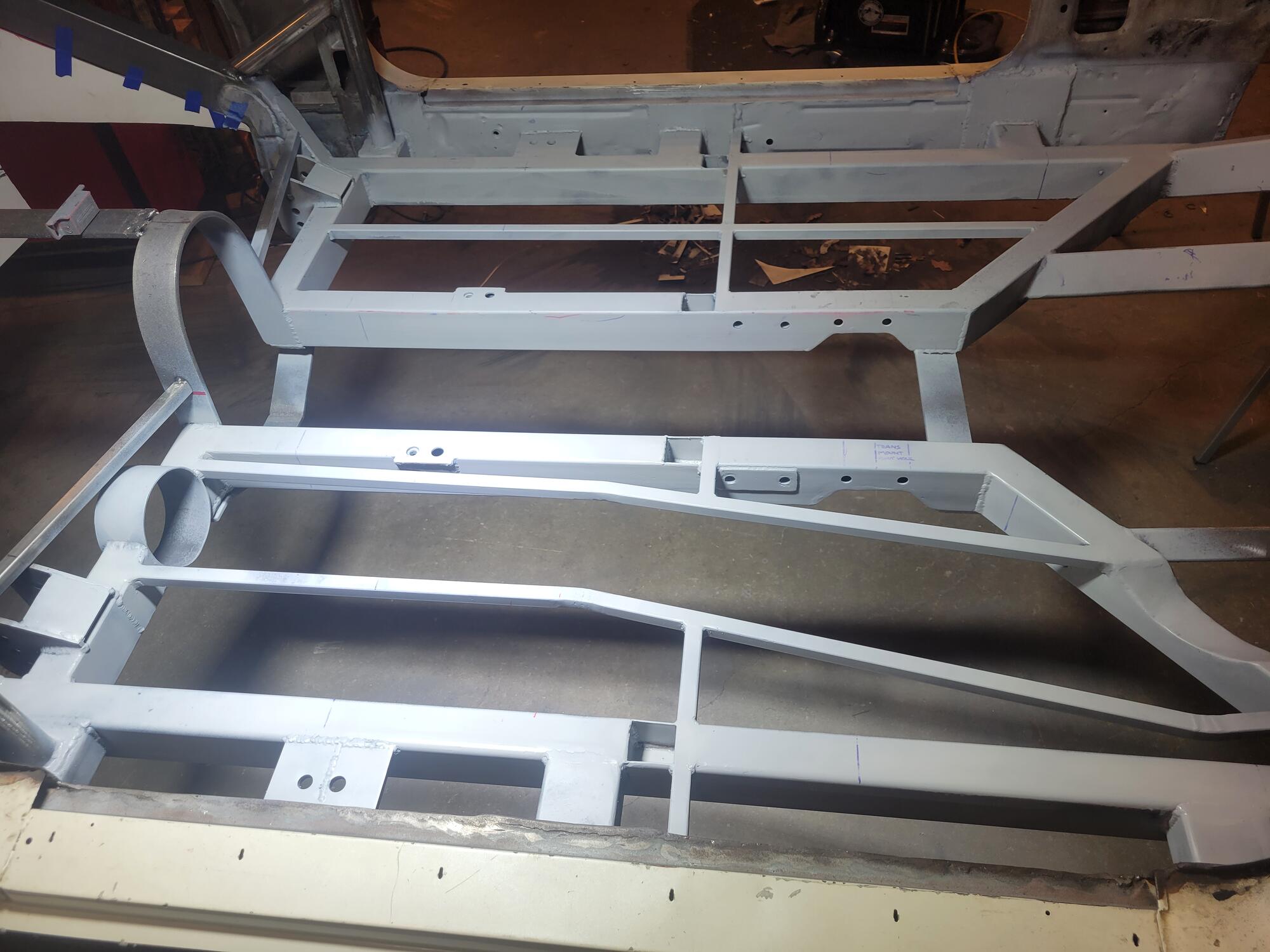

      I'm getting pretty good at taking everything apart, I think this is the 4th maybe 6th time who knows anymore. But this time its all getting ready for paint and primer. Mainly finishing welds, filling holes, and grinding other welds flat for the floors and adding some welded in nuts for mounting points. Picked up the sheet metal to start the firewall, wheel tubs and the floor sections that will be welded in. I also want to add a couple support bars to the main hoop from the rear frame and some low sill bars going to the front to help stiffen things up some. Added a front cross bar and Ended up changing the driveshaft loop from that tube to 1/4 plate loop and I will be adding a removable lower piece as well. Sooo nothing super exciting, mostly spending days doing little things and at the end you feel like you really haven't done much or wonder why that little plate took you 4hours lol.
Size:  416.5 KBName:  20231017_174934.jpg
Size:  422.8 KBName:  20231018_150046.jpg
Size:  317.0 KBName:  20231019_130259.jpg
Size:  460.3 KBName:  20231018_150054.jpg
Size:  396.9 KBName:  20231020_190026.jpg
Size:  408.5 KBName:  20231018_150110.jpg
Size:  396.7 KBName:  20231017_174953.jpg
Size:  472.0 KBName:  20231017_174945.jpg

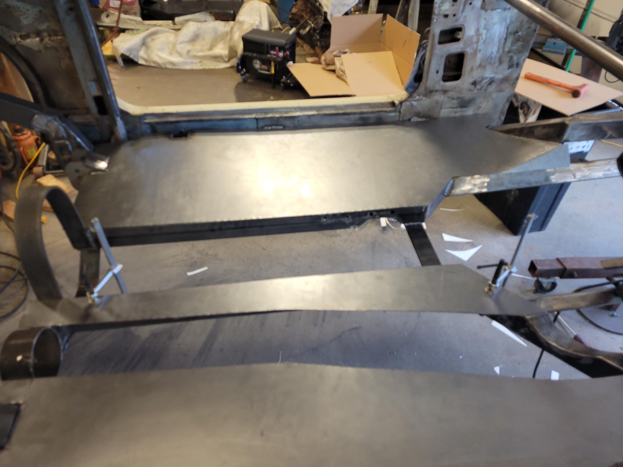

    2. #62
      Jul 2022
      Michigan
      90

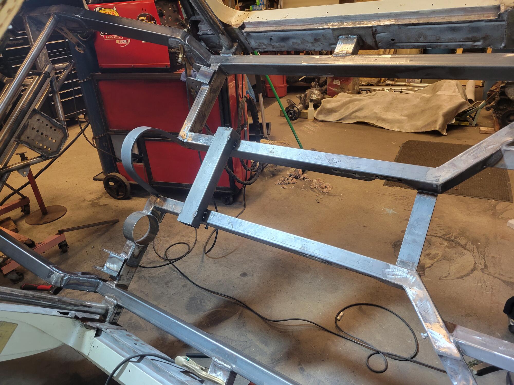

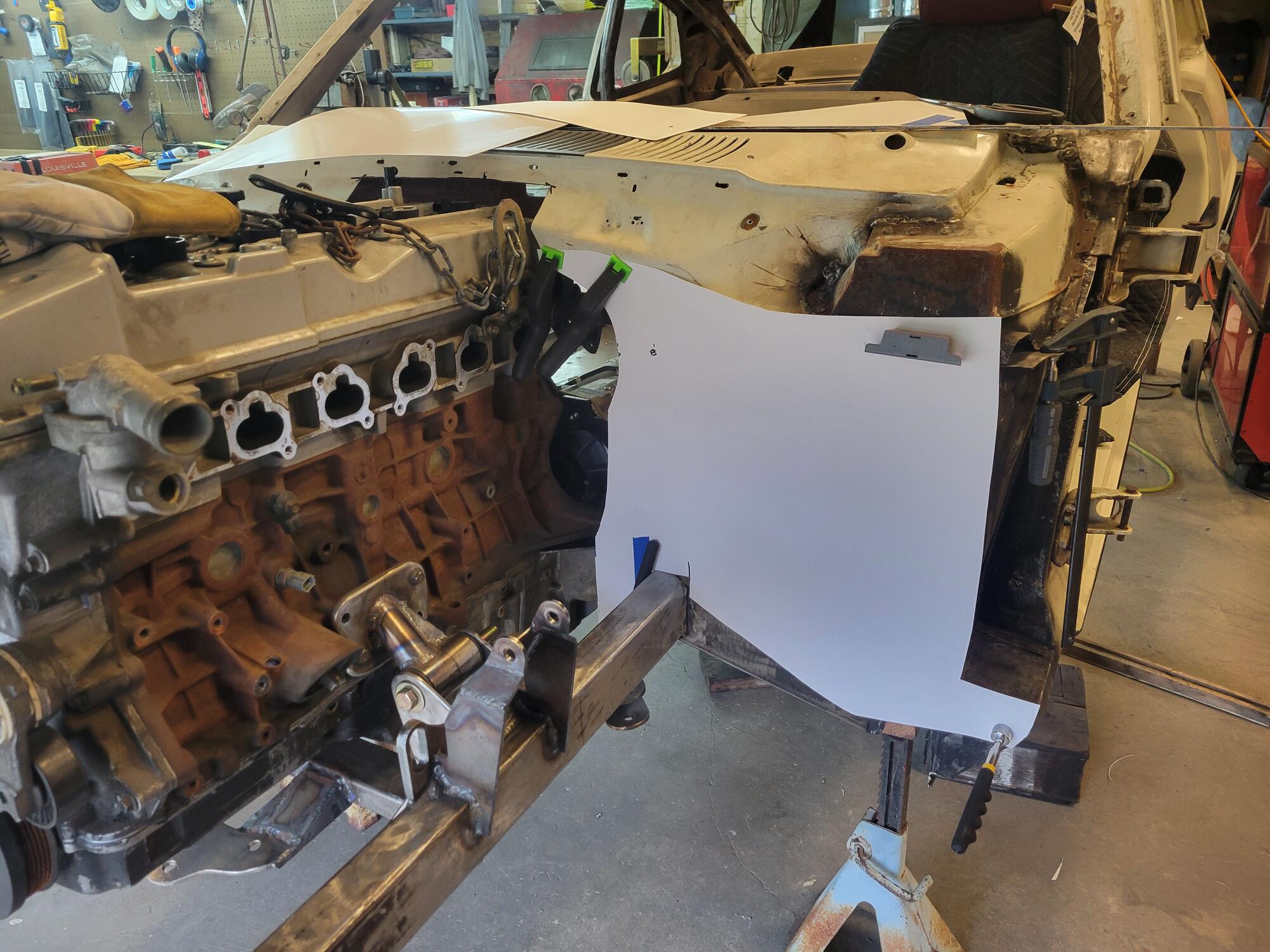

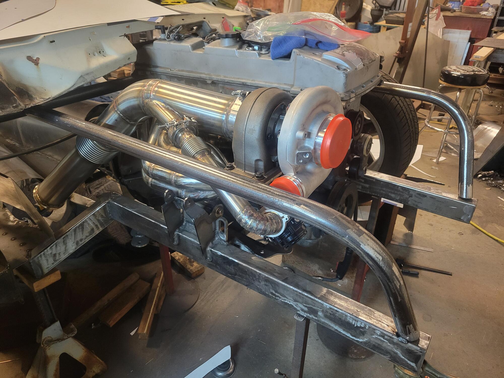

      Started on some of the sheet metal work and got one part of the firewall done and both main sections of the floors I'm still working on forming the exhaust tunnel but rolling it by hand is turning out to be a process. I knew the cowl was bad and I cut out major sections of it when I started the tear down but with it removed even more chunks of bondo came out and found some more rot underneath but that was expected.
Size:  400.6 KBName:  20231101_173508.jpg
Size:  518.0 KBName:  20231031_193641.jpg
Size:  303.2 KBName:  20231028_170748.jpg
Size:  288.5 KBName:  20231104_173133.jpg

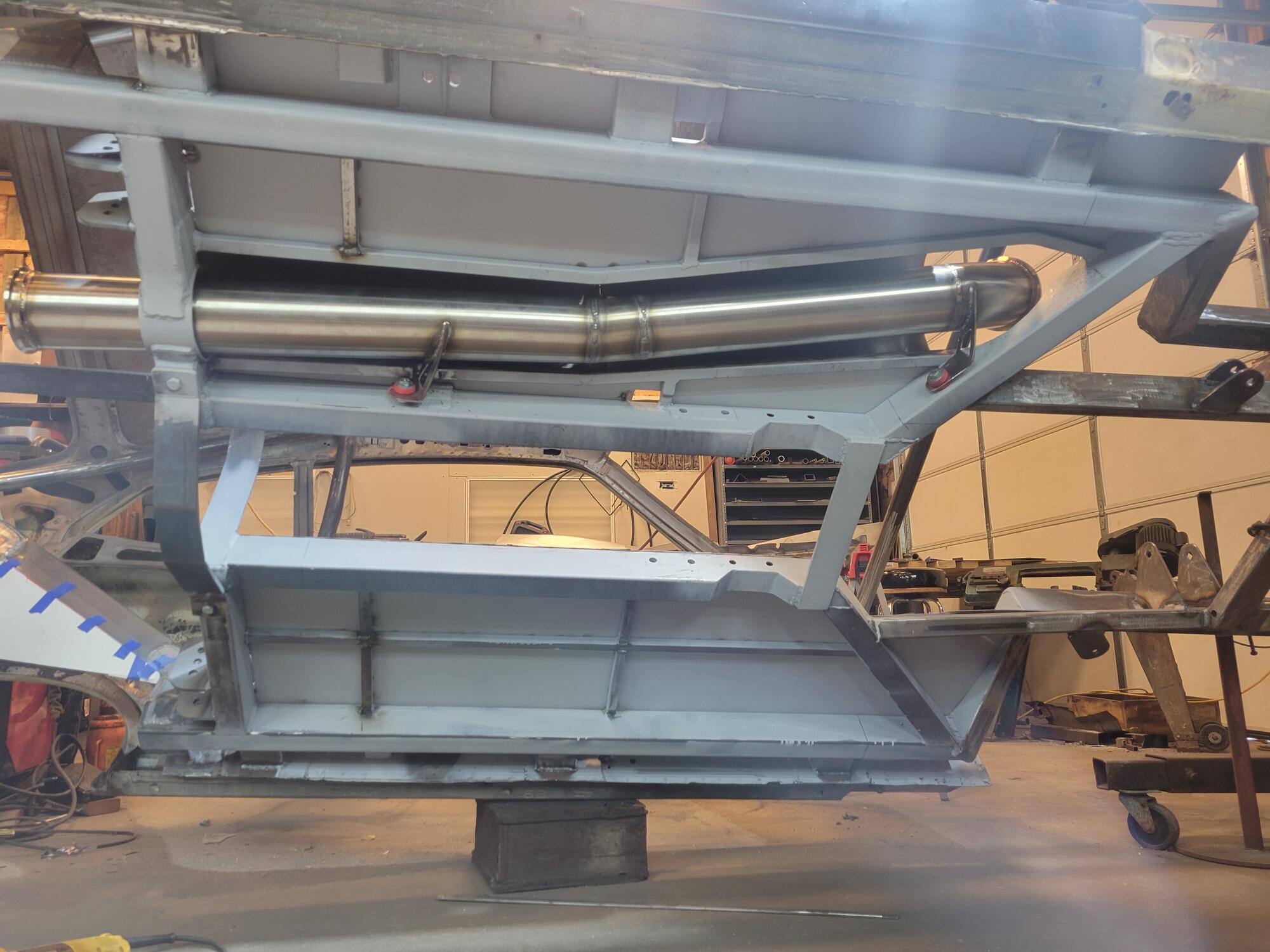

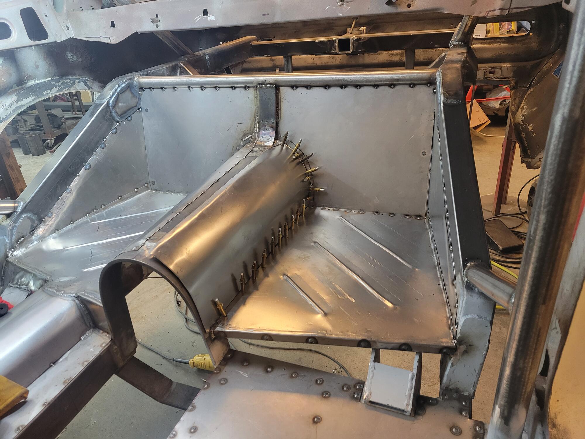

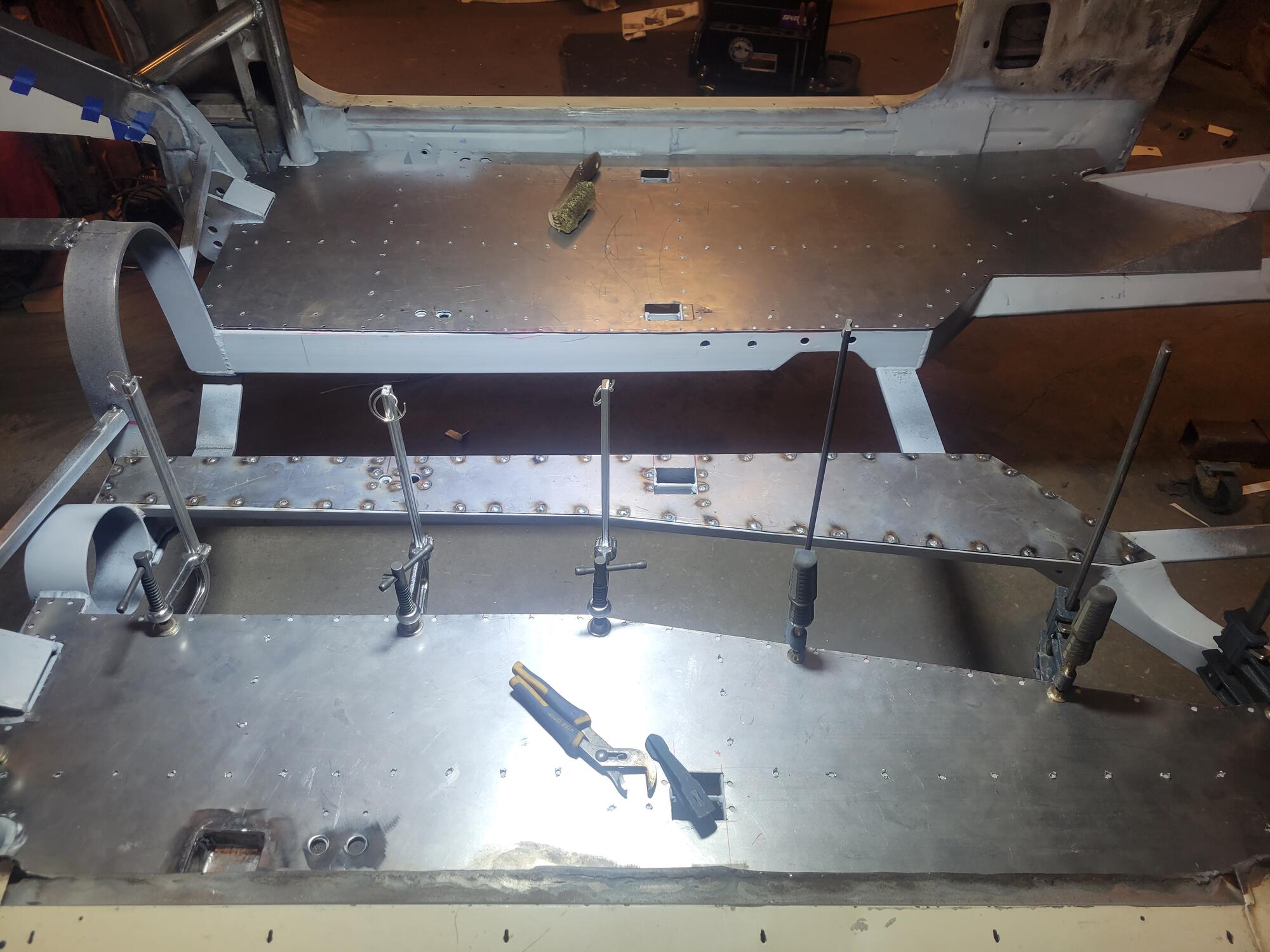

    3. #63
      Jul 2022
      Michigan
      90

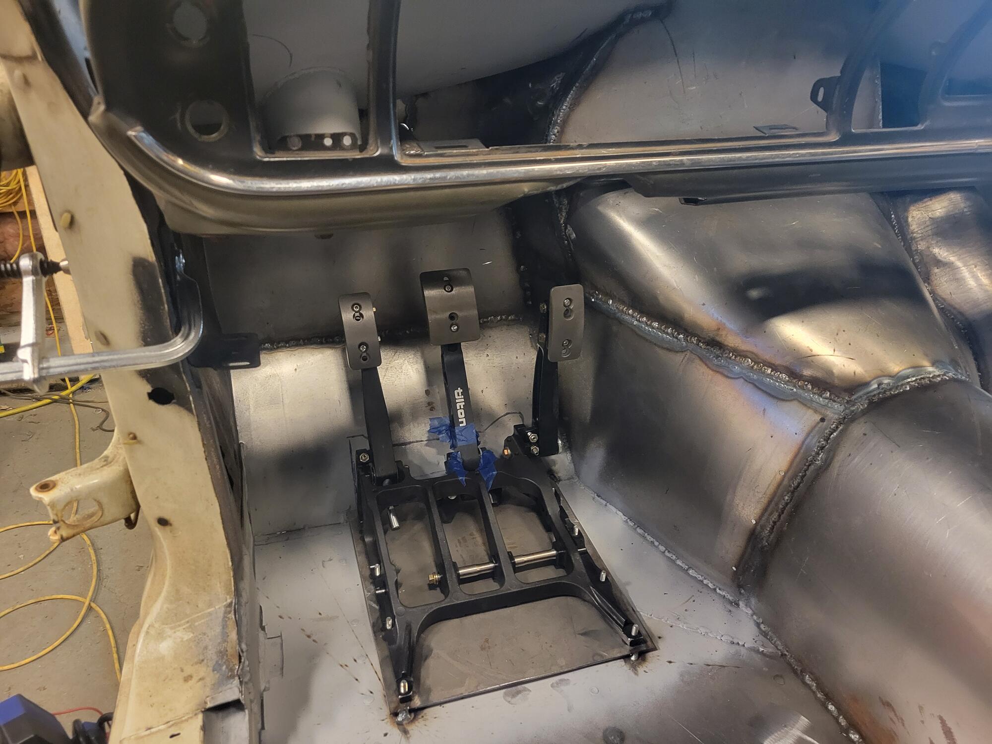

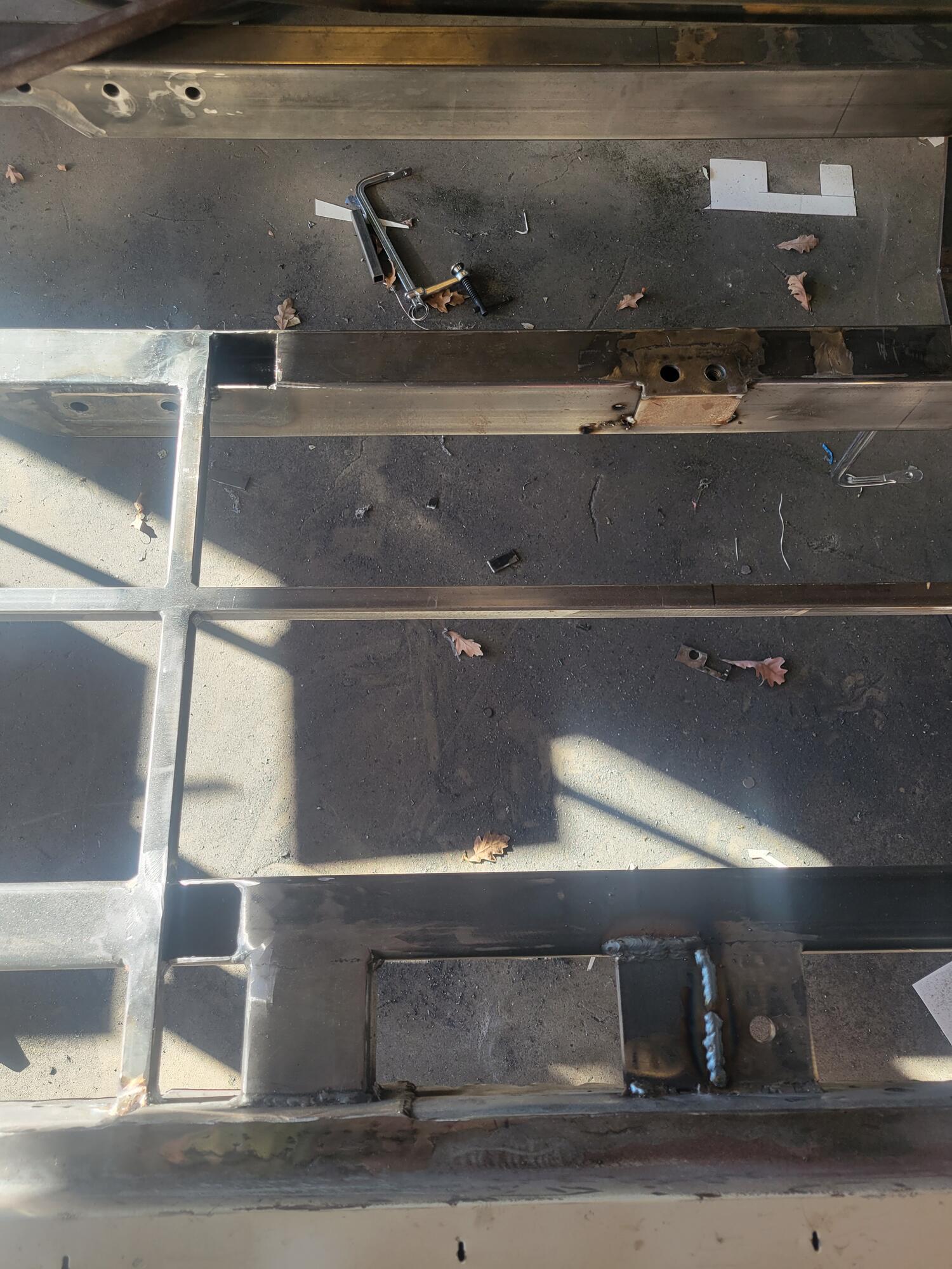

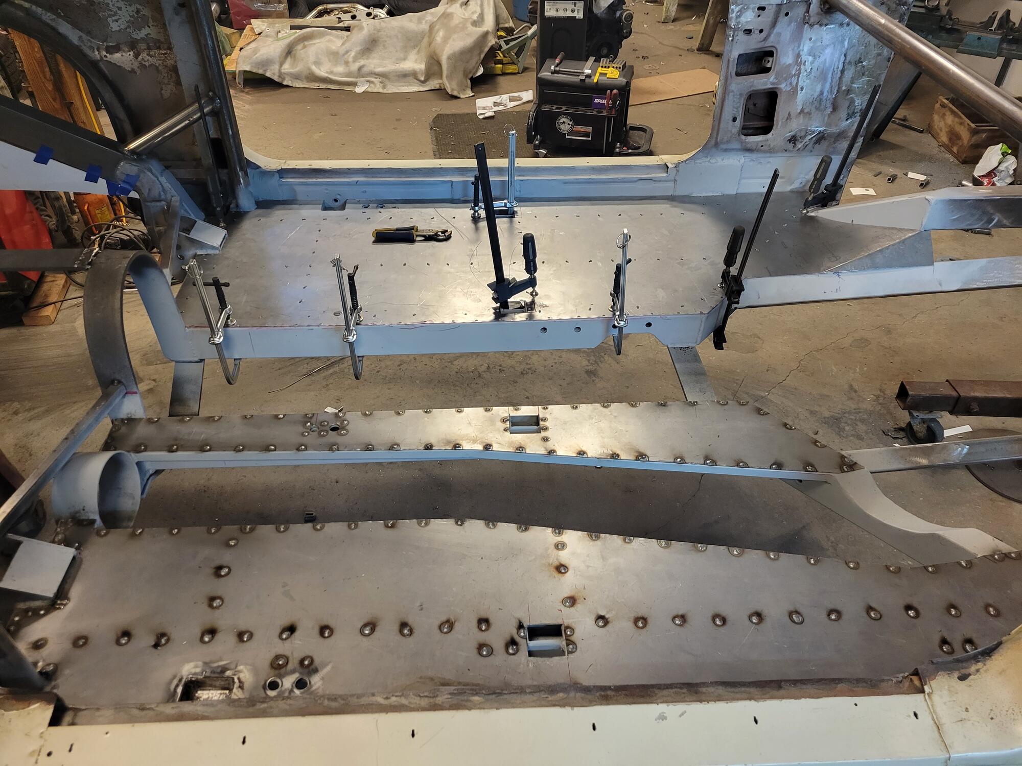

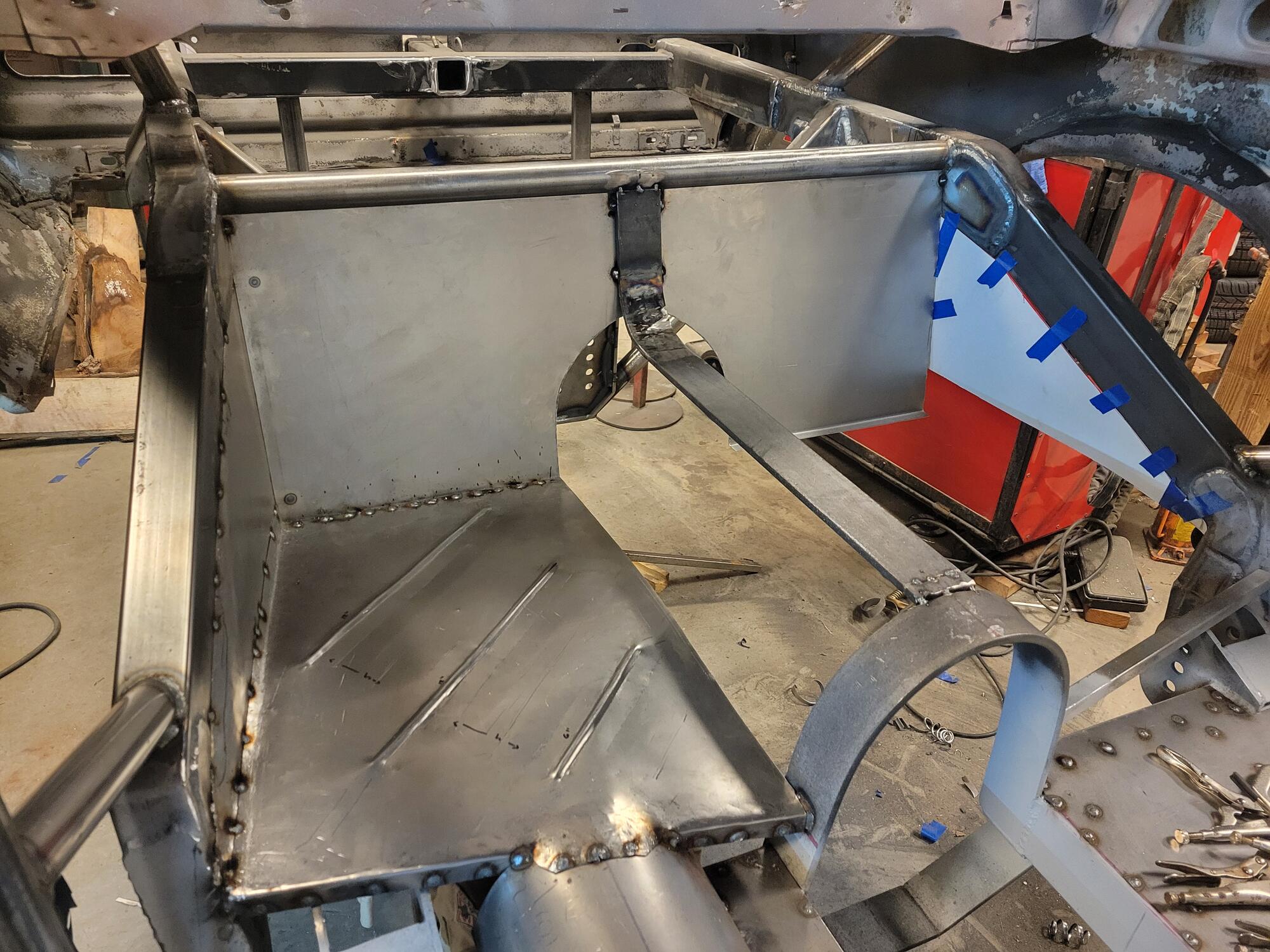

      Got some more work done on the floors. Seat mounts are all done, just by sheer luck the seat mounts lined up with my frame rails so that made mounting them a little difficult. The seats I'm using have the front claw mounts and no way to really change them to bolt in without redoing the tracks. So I cut the frame welding in little pockets and added some support bars throughout and everything got a good coat of weld through primer before getting welded on. Exhaust tunnel will be next then onto the firewall and rebuilding the cowl which I'm kind of putting off I don't know why but I just don't want to do it. Name:  20231110_183834.jpg
Size:  368.2 KBName:  20231119_142234.jpg
Size:  355.1 KBName:  20231125_210619.jpg
Size:  336.0 KBName:  20231201_072646.jpg
Size:  222.4 KBName:  20231104_173137.jpg
Size:  183.7 KBName:  20231201_093724.jpg
Size:  255.0 KBName:  20231203_122336.jpg
Size:  247.3 KBName:  20231203_140007.jpg

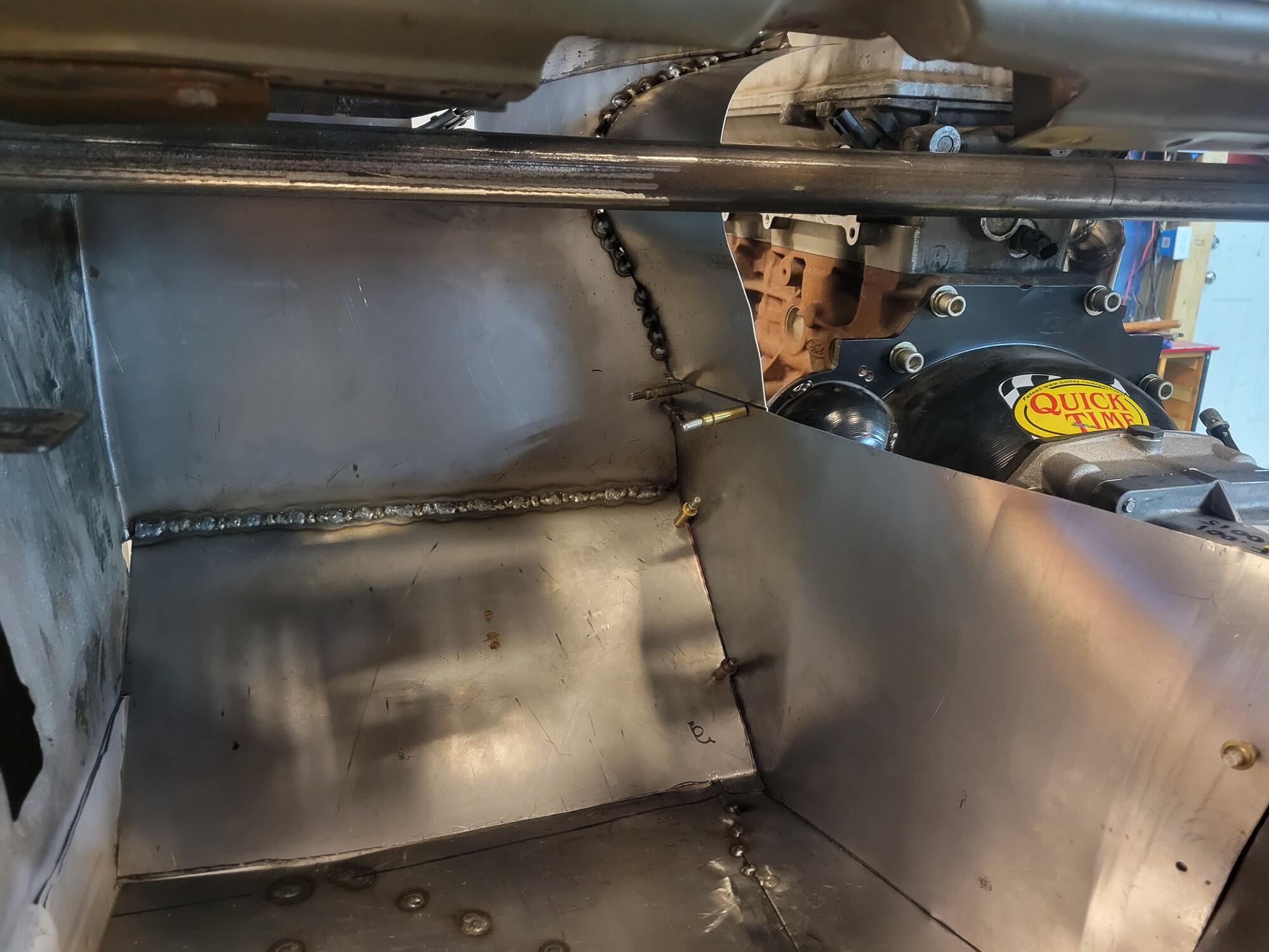

    5. #65
      Jul 2022
      Michigan
      90
      Quote Originally Posted by Threepointtwo View Post
      Looking good!
      Thank You!

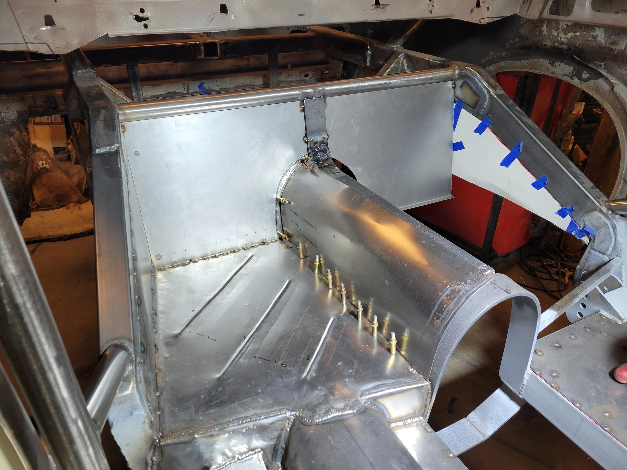

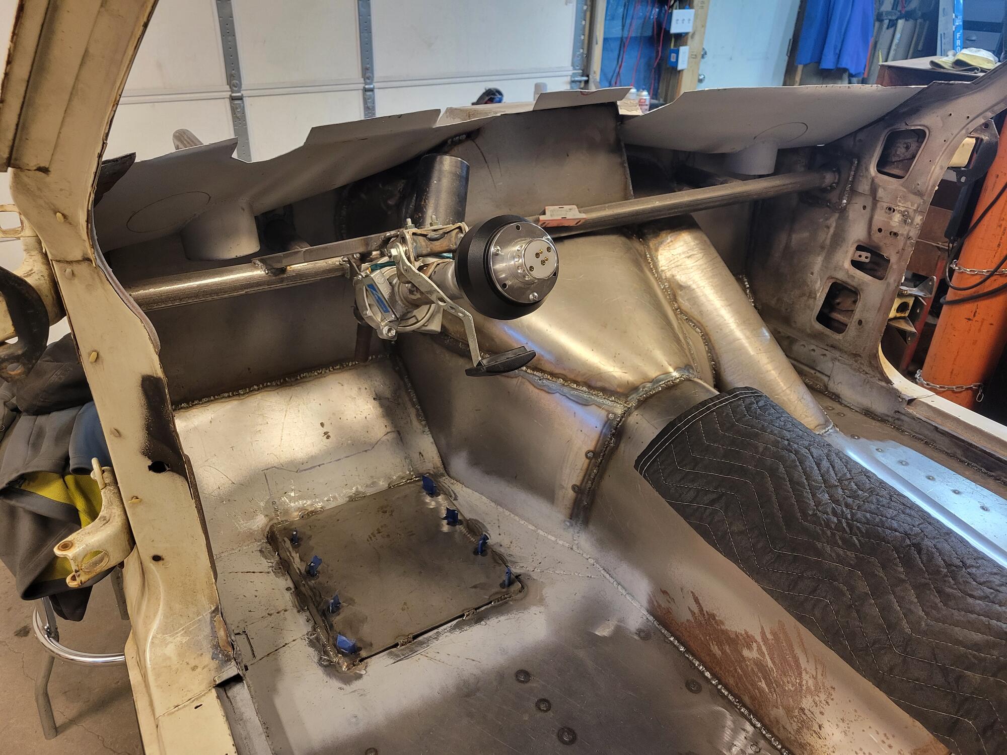

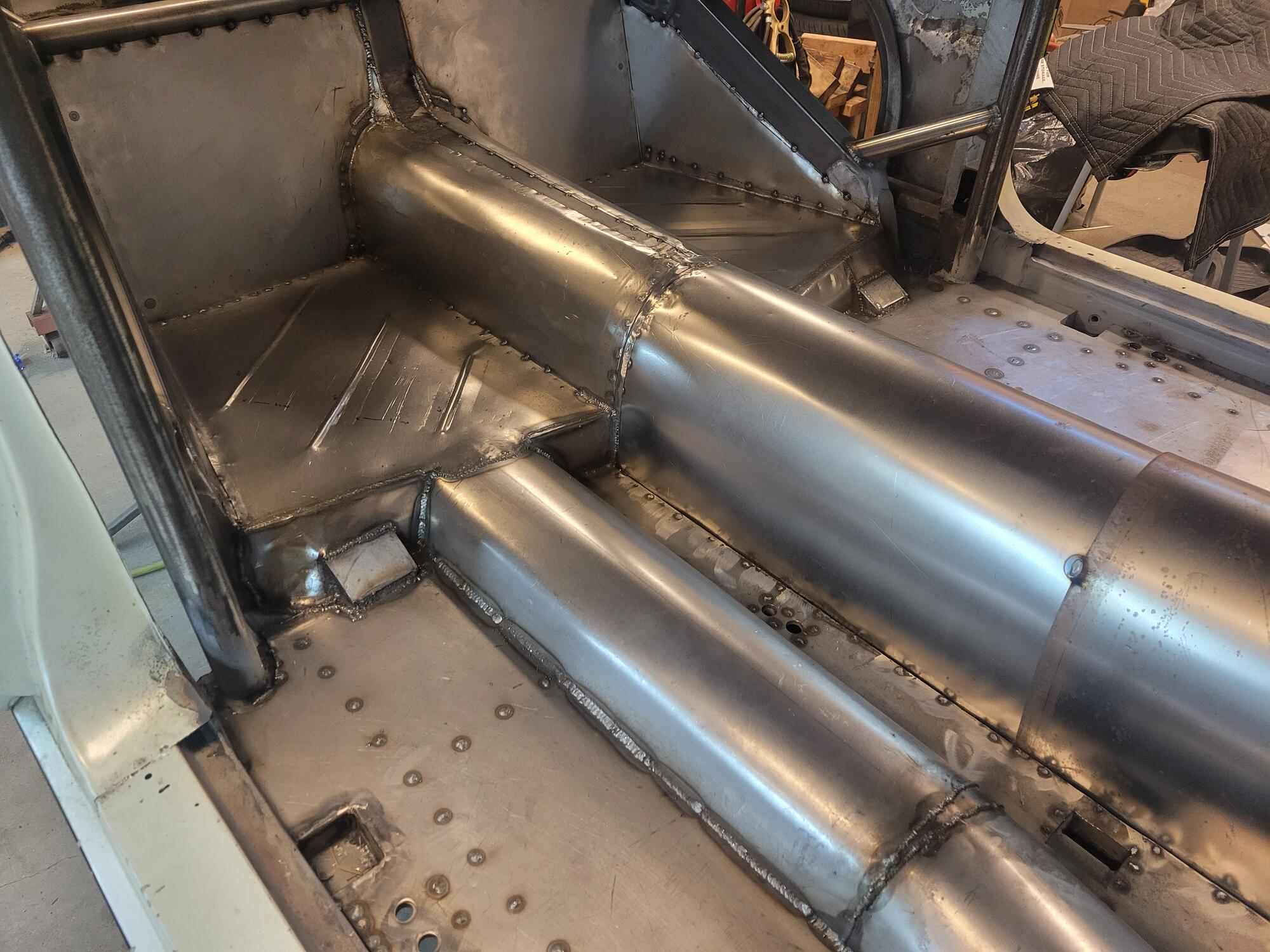

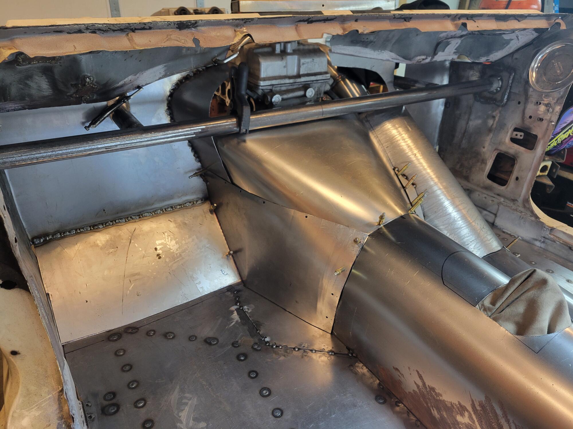

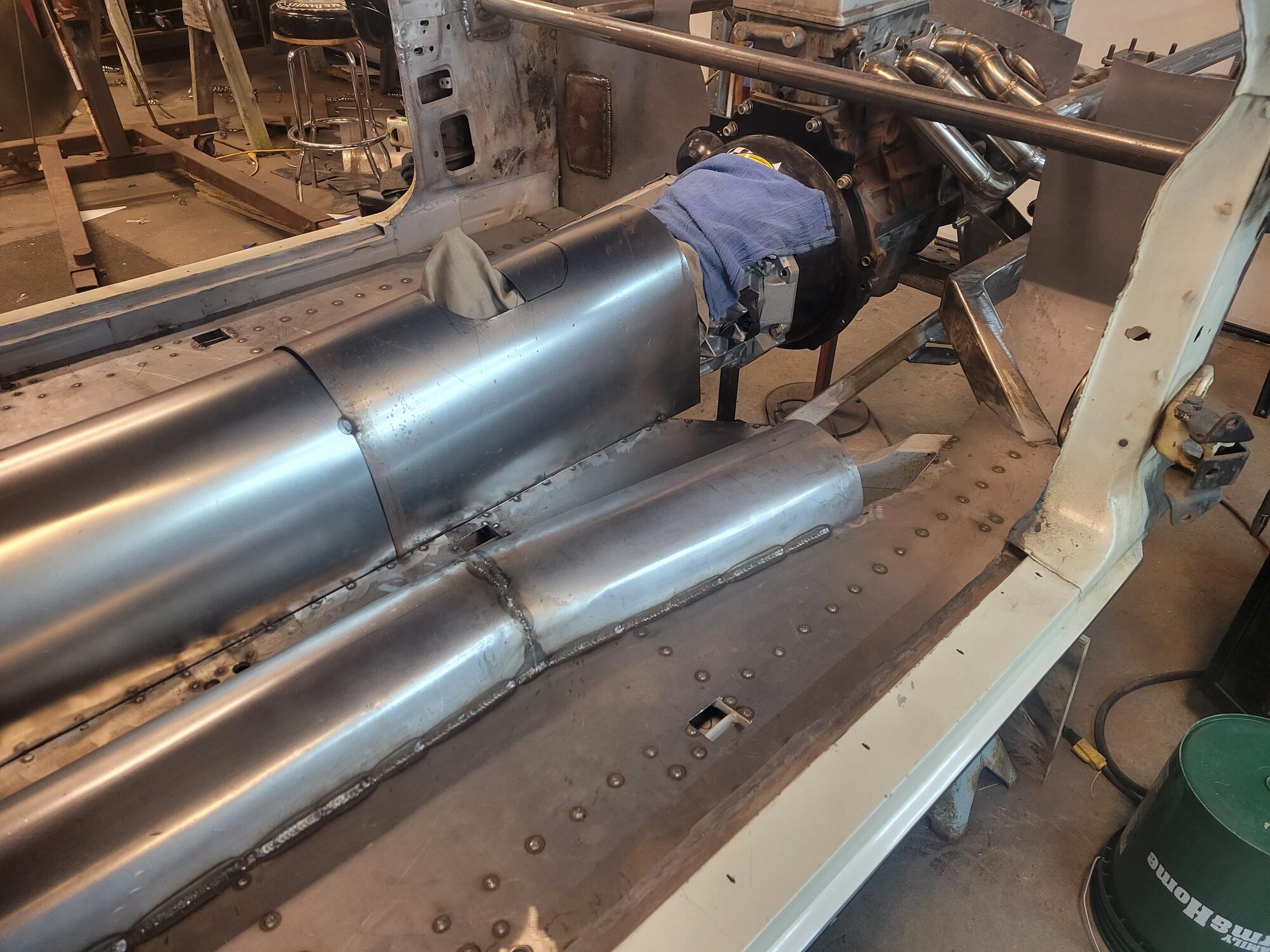

      Got the floor exhaust tunnel in place, turned out pretty good. I don't have a roller so I bent it by hand with a lot of clamps and a couple 5inch steel tubes I had, the same one I put into the frame for the exhaust to pass through, Ended up not lining up perfectly but good enough. I don't want to start on the rest without the firewall pieces in place which forced me to start on the cowl. The cowl looked like it was repaired in the past at some point and they filled it with bondo for some reason which explains why it always leaked. I did not completely split it apart because I was nervous about things not lining back up right or some other issue, so I cut everything out cleaned out all the rust and junk, patched a couple bad rotting areas mainly on the top side areas which seemed a little strange. The cowl had to be custom made as I needed clearance for the engine and I also wanted to add some fresh air floor vents like the older mopars have. I plan on retaining the original wiper setup unless I find something better but so far I got nothing.
Size:  271.6 KBName:  20231101_173508.jpg
Size:  518.0 KBName:  20231219_160322.jpg
Size:  372.8 KBName:  20231219_160326.jpg
Size:  414.2 KBName:  20231220_152118.jpg

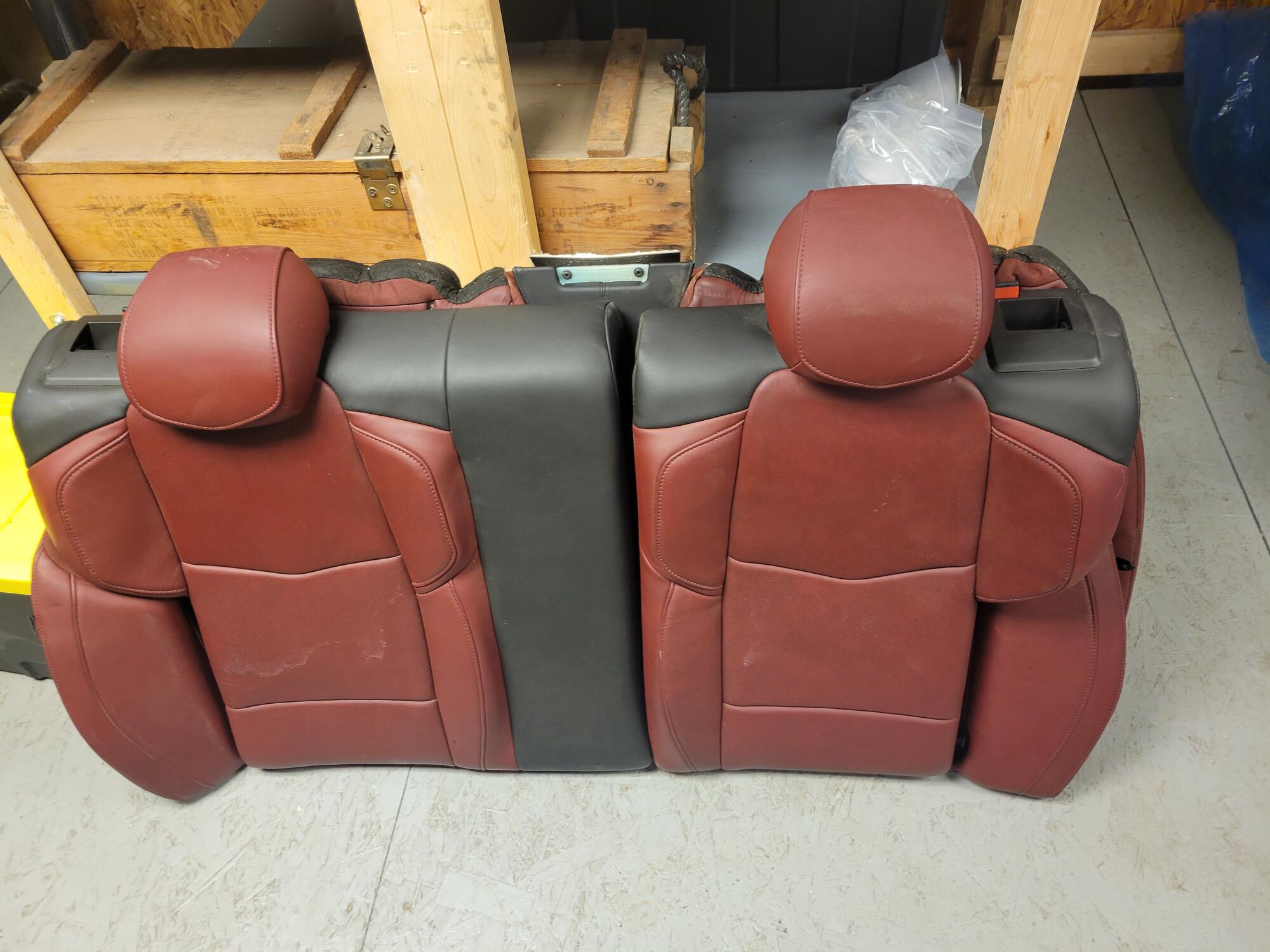

      For the Interior I got a set of Cadillac ATS Seats for a great deal front and rear. Maroon leather wasn't my first choice, but they are full power with heat so couldn't pass them up. The driver seat had the airbag deployed but the local upholstery shop got it all fixed up and removed the back center piece from the rear to make them a set of buckets. The driver seat fits in no issues the passenger will need some clearance underneath because of the exhaust tunnel. The rear seats fit good but have a wire frame built into the bottom foam will have to get cut down.

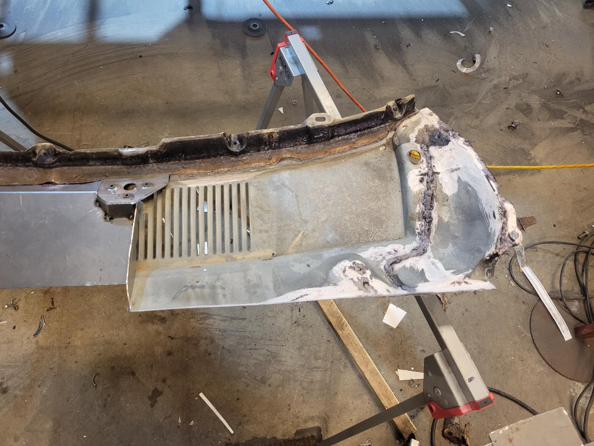

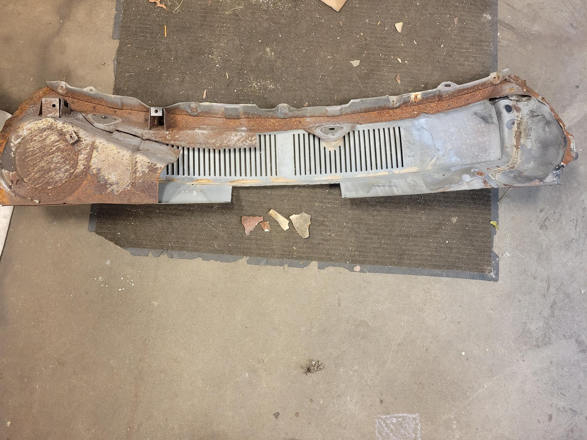

      Got the cowl clamped down to make sure everything lined up good and also gave me a chance to get the dash back in and see how the seats line up. The front bars are mocked up to get cut and make sure everything has enough clearance.
Size:  366.7 KBName:  20240108_125249.jpg
Size:  420.9 KBName:  20240109_110110.jpg
Size:  266.6 KBName:  20240108_150659.jpg
Size:  348.9 KBName:  20240108_150736.jpg
Size:  270.5 KBName:  20240109_115737.jpg
Size:  183.8 KBName:  20240112_144434.jpg
Size:  397.4 KBName:  20240112_180856.jpg
Size:  379.7 KBName:  20240112_180903.jpg

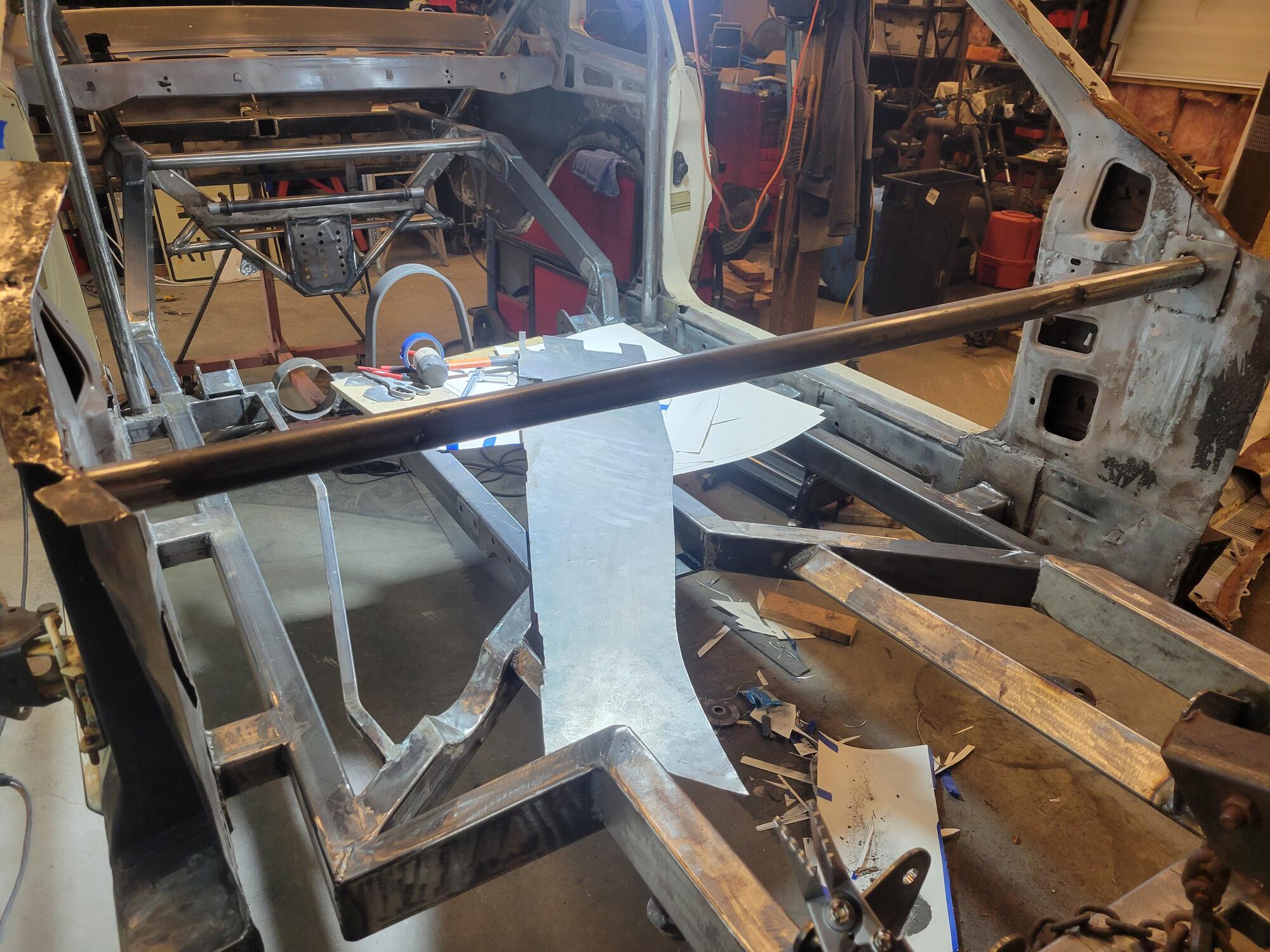

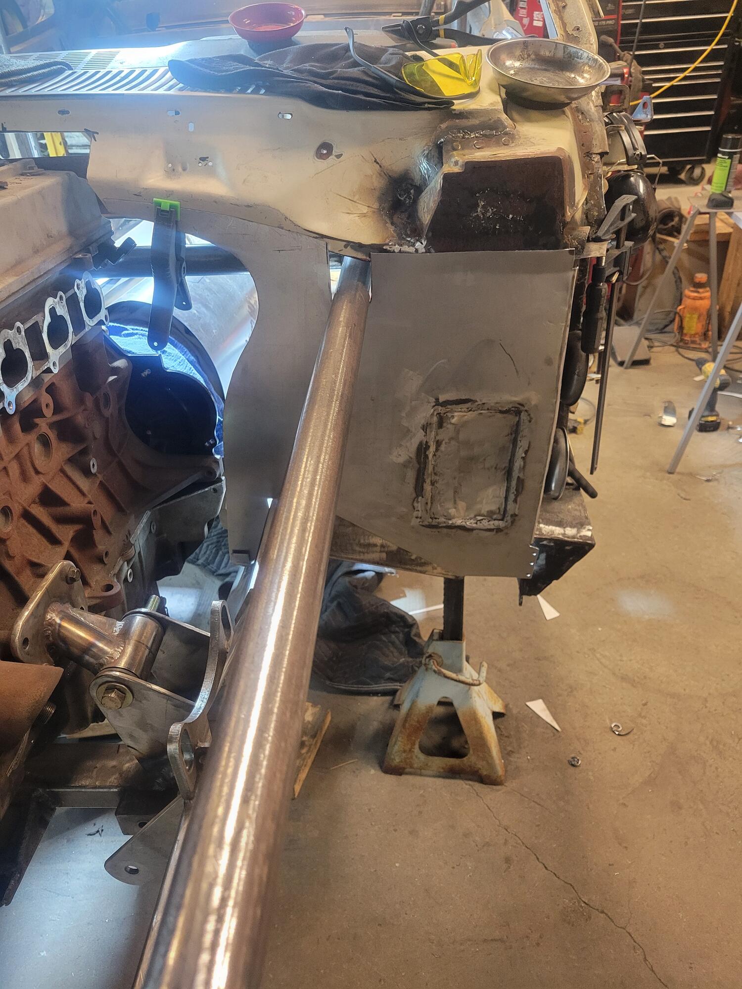

      Ended up remaking the firewall and changing the design. I test fitted the original kick panels and found out that I did not need to have so much room, so learned to not get to far ahead of myself. Made a couple more panels and got the piece for around the intake done.
Size:  190.3 KBName:  20240114_232404.jpg
Size:  295.6 KBName:  20240115_165234.jpg

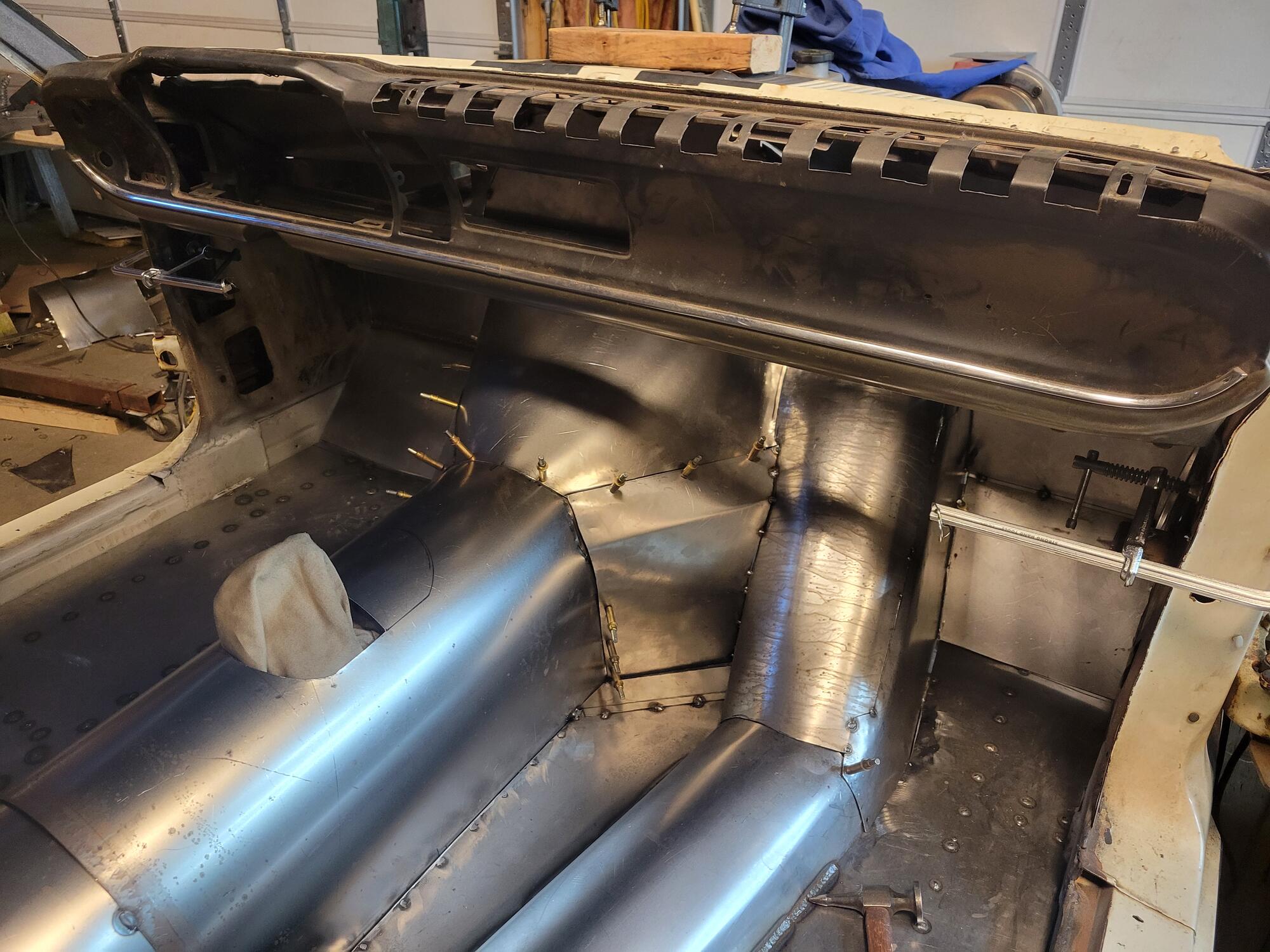

    15. #75
      Jul 2022
      Michigan
      90

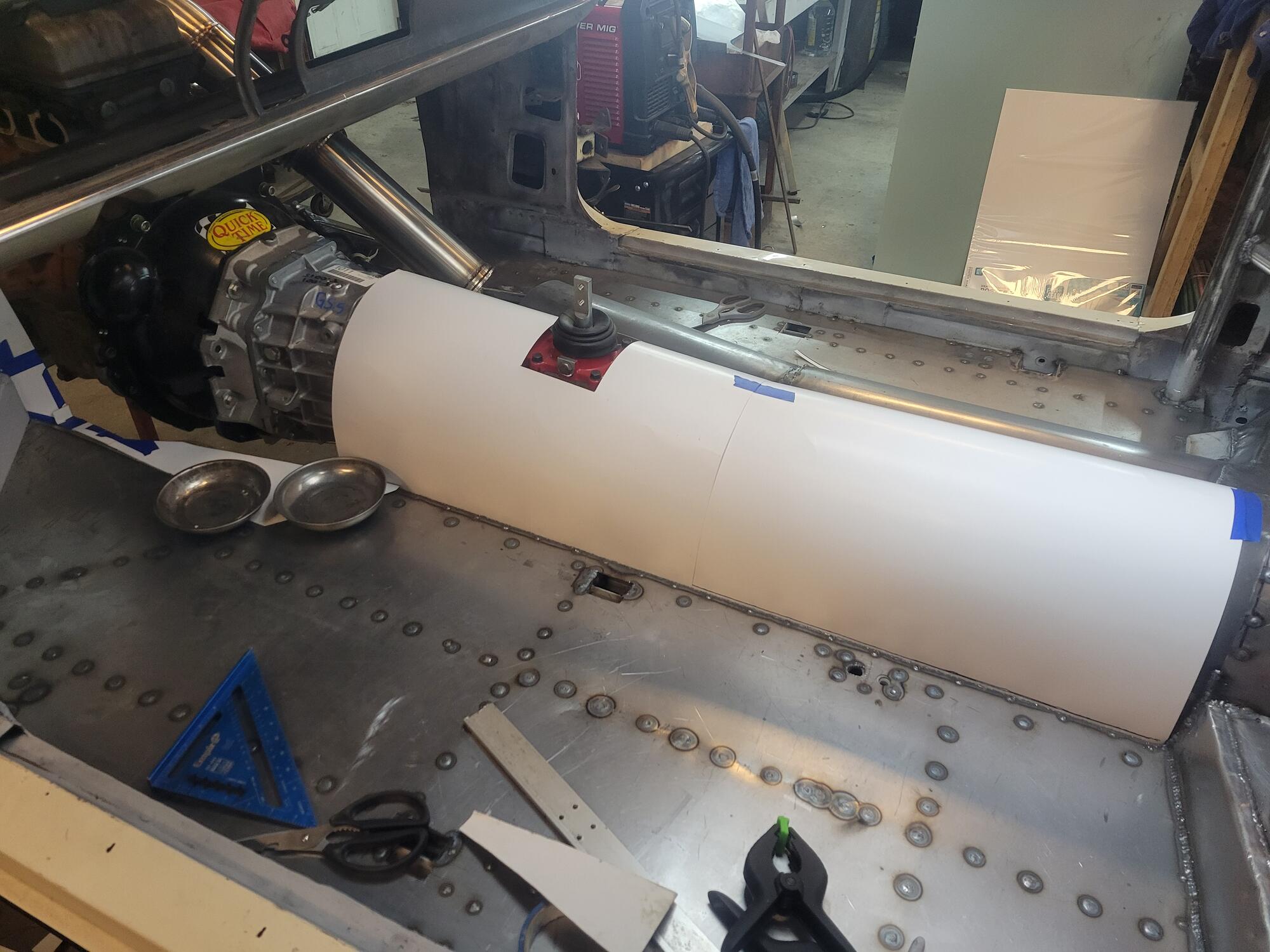

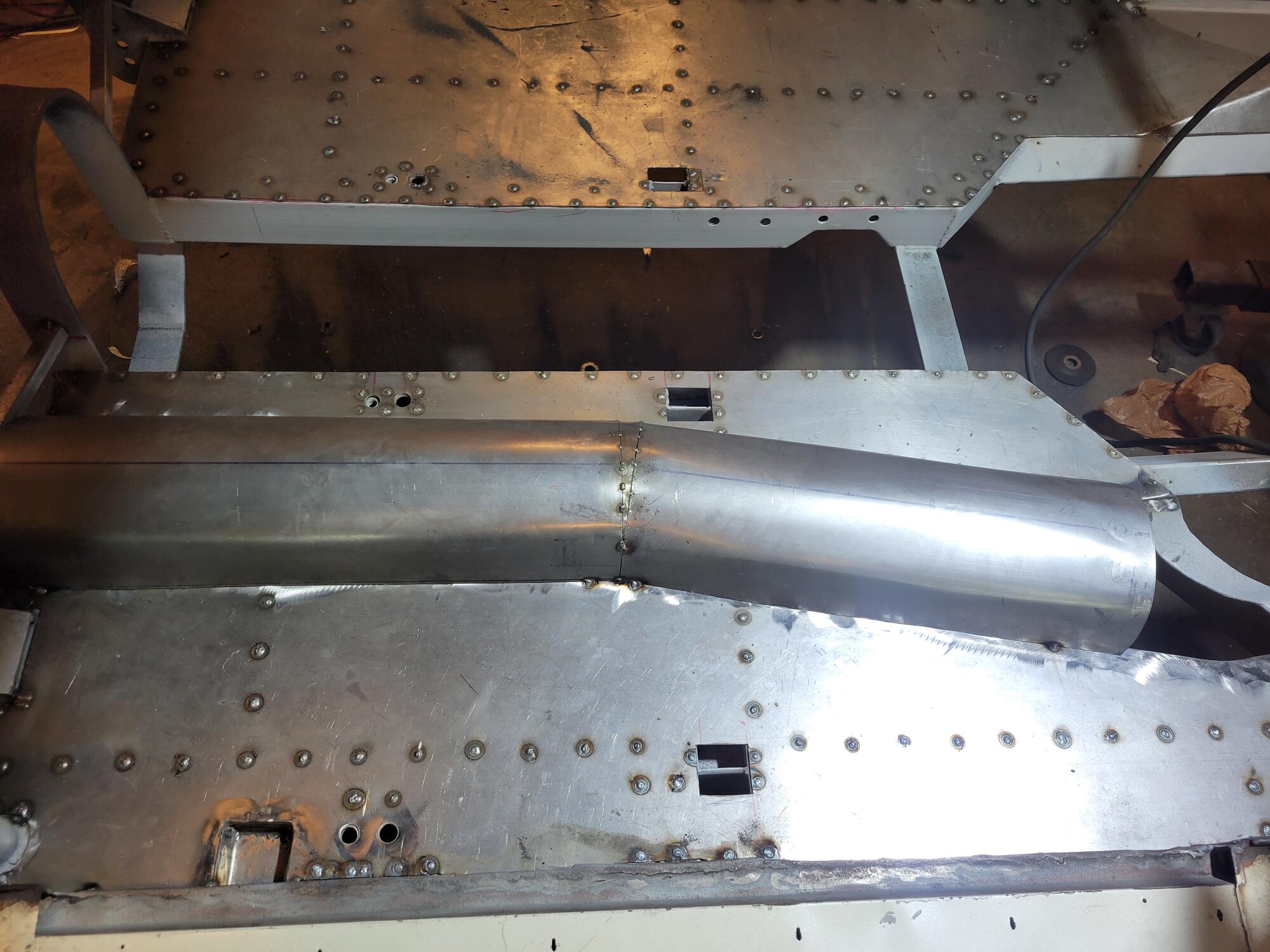

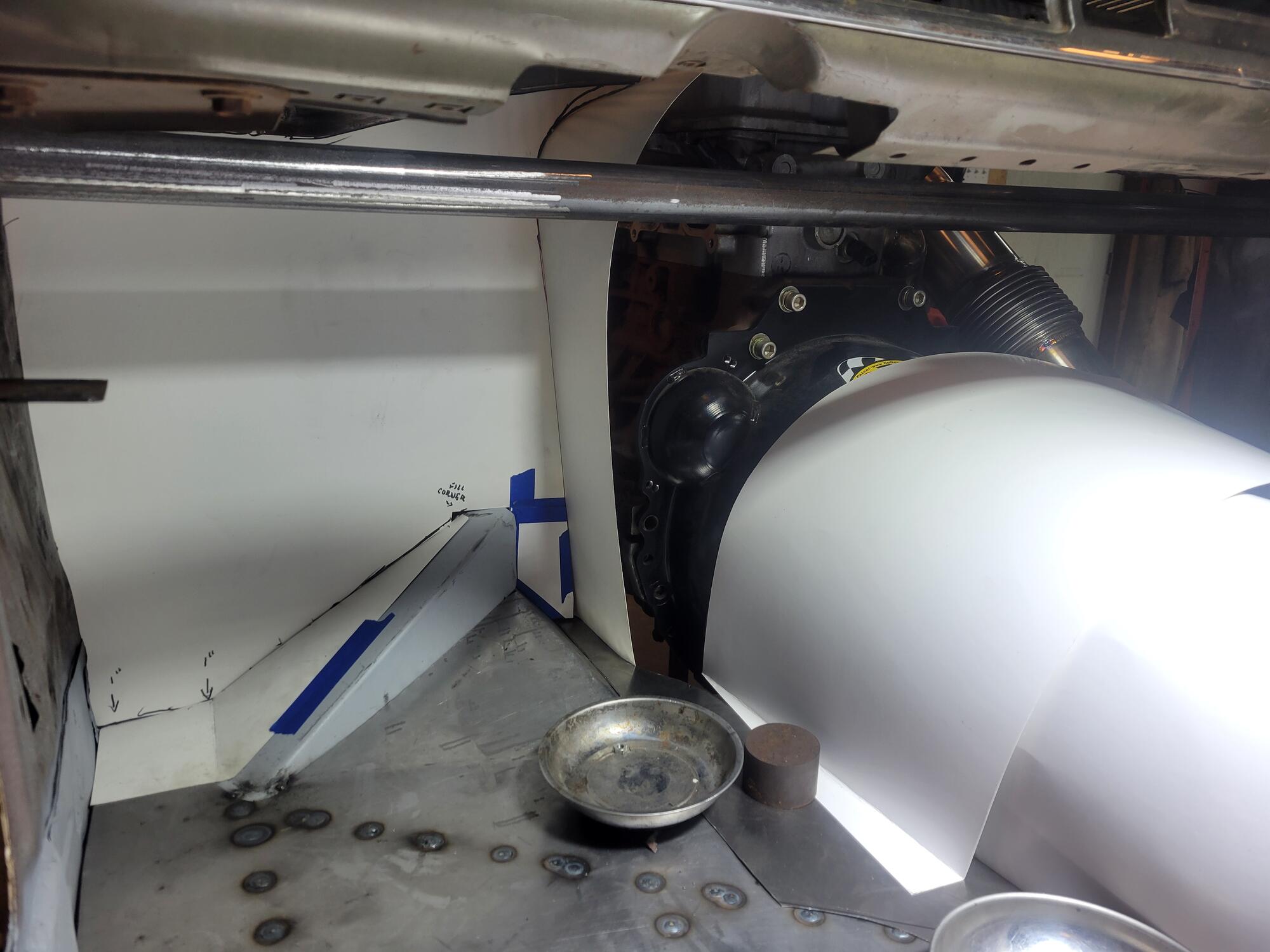

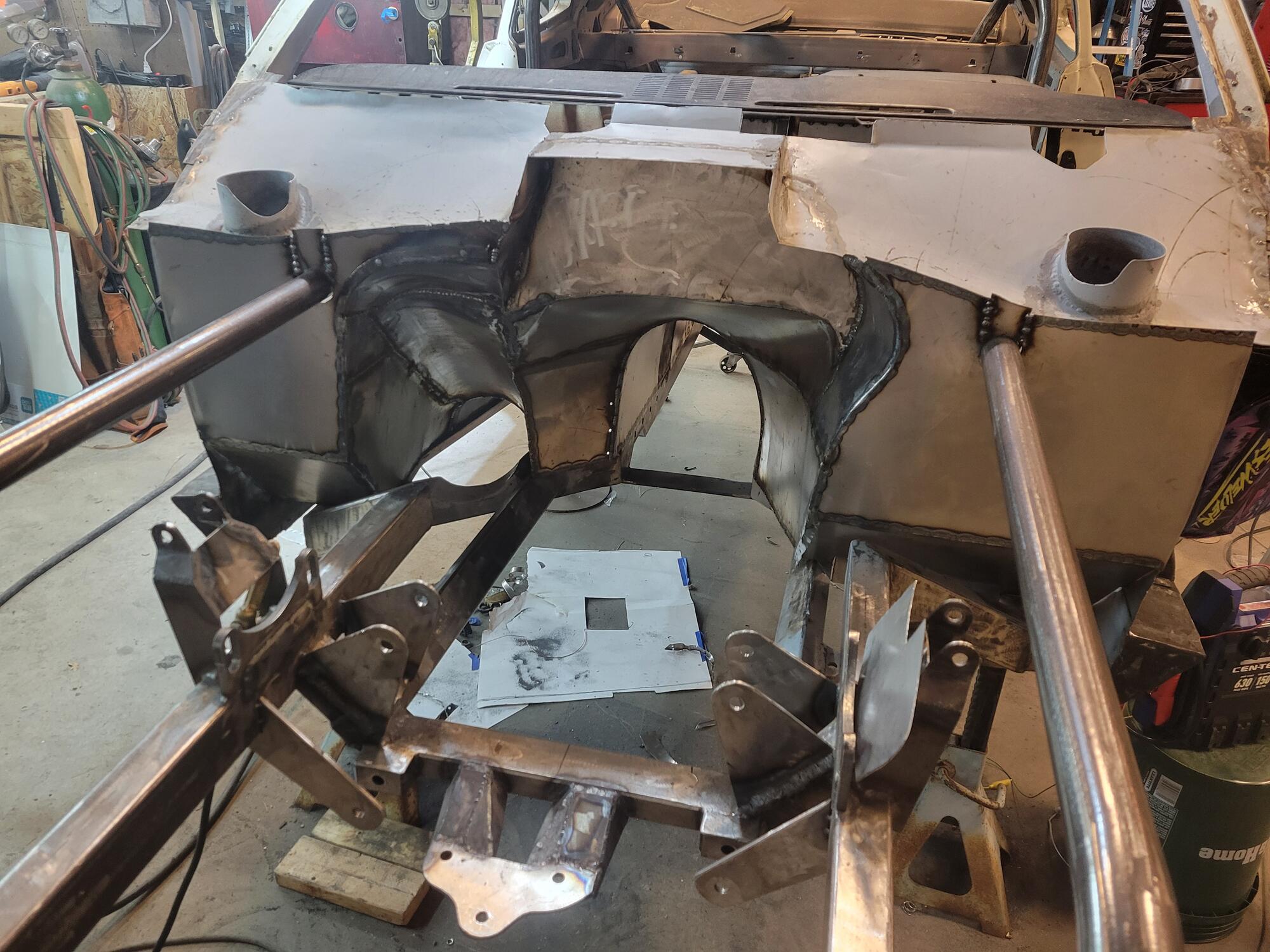

      Finished up the exhaust and transmission tunnel along with the firewall, I still have to do final trimming and welding. I have a good mounting spot for the ECU right behind the head on the flat panel and plenty of space around everything for heat shielding. Next the engine and trans come back out for finishing everything up then I believe paint will be next.
Size:  276.4 KBName:  20240117_162511.jpg
Size:  375.5 KBName:  20240117_175738.jpg
Size:  328.2 KBName:  20240117_175717.jpg
Size:  325.0 KBName:  20240121_161308.jpg
Size:  299.4 KBName:  20240121_162428.jpg
Size:  347.9 KBName:  20240121_162441.jpg

      90
      Firewall is fully welded and the bottom on the cowl is in place. Had to figure out how to make the pedals and the steering column work. The steering column is a Prius for the EPS system. I Cut down the column some to fit the motor, Just Cut an inch out of the outer shell and compressed the column down. To adapt to the Prius column I used a 125H hub and enlarged the taper on the hole and the splines fit good. Pedals gave me some fitment issues, mostly my fault because of where I put the dash bar. Tried a couple different types and ended up going with a floor mounted set. Got a Tilton 800series underfoot #72-856 for a good deal. Made a floor mounting plate with studs to secure it to.
