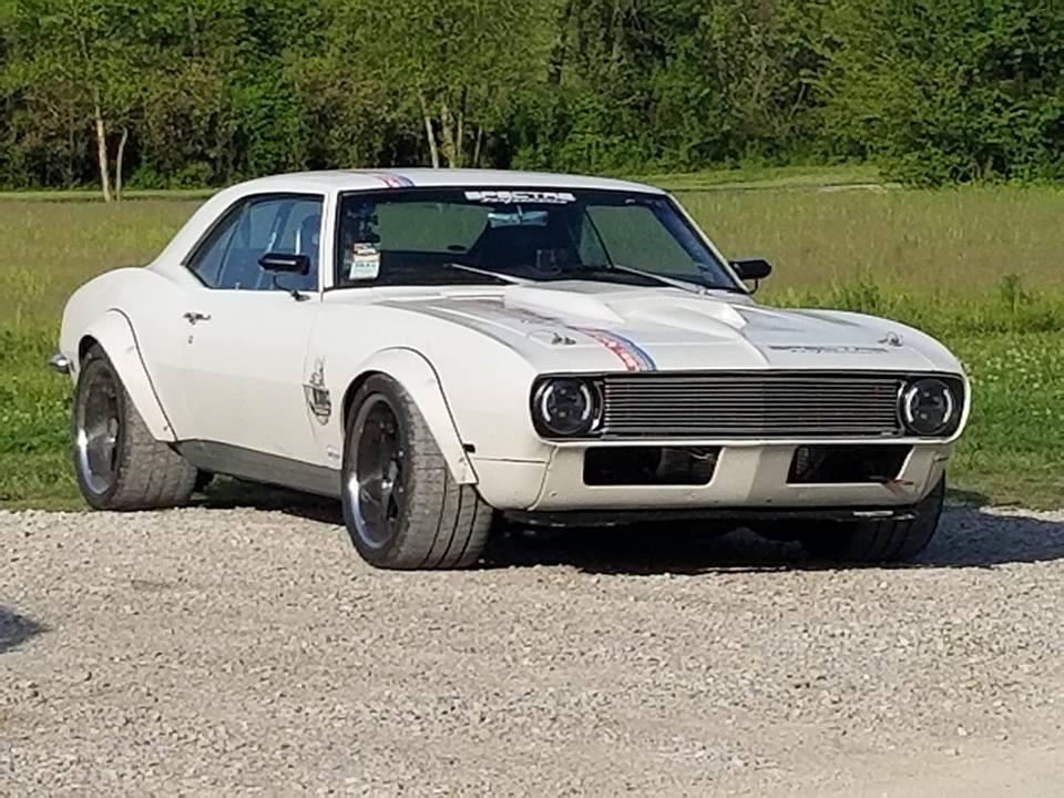

      not sure what holley "stock" is but the holley kit uses a 97 or newer corvette steering pump and inside that there are levels of pumps, I use the lightweight aluminum, 2.8 GPM High Flow, 1350 PSI unit that coupled with a steering cooler and power steering filter, one pump replacement in 8 years.. and I turn a lot or rubber
