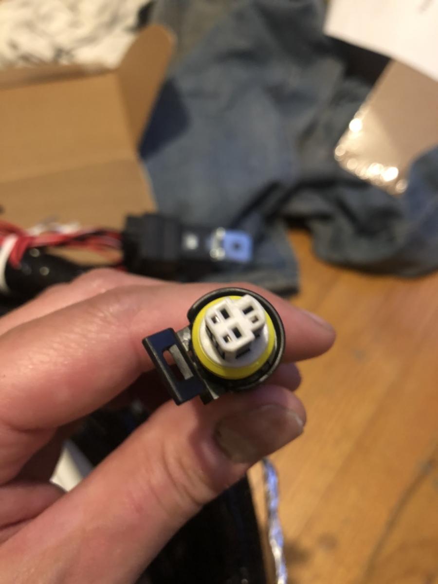

      Thanks andrew yes thats the one that comes stock. This is the oil sensor plug on my terminator

      Quote Originally Posted by Sinnister69 View Post
      That connector fits that sensor.
