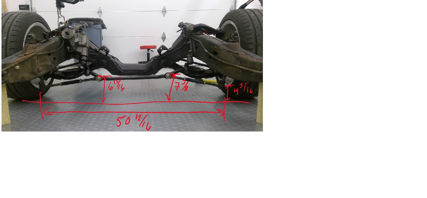

      So let's try another approach on this question... I was initially overwhelmed trying to process the amount of information I need to gather.
      I'm starting out basic by looking at the front and rear roll centers. What stands out to me is that the drag link is not parallel to anything and every suspension model I've seen assumes this.
      As a first step, I can move the idler arm down to make everything parallel.
      Thoughts on this?
      Added the dimensions. The wonders of a surface pro.

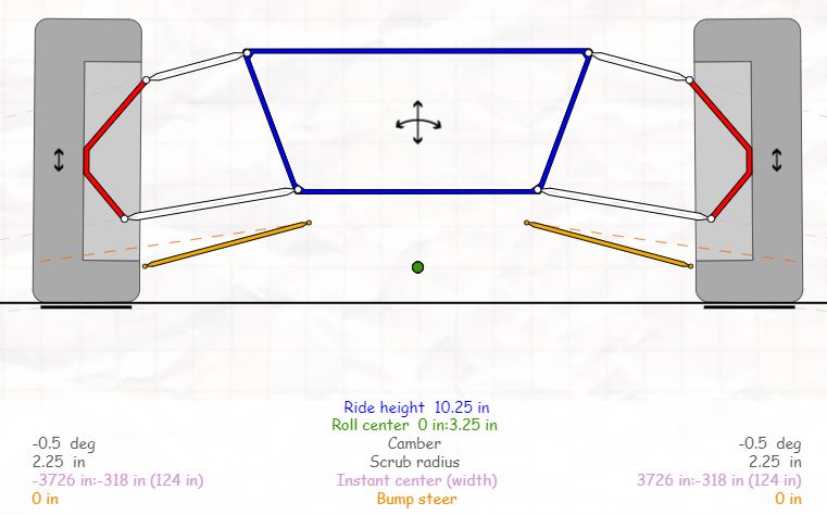

      So I'll keep adding detail until someone can provide some input. Finally got the front mounting points measure well enough that I'm satisfied it matches the CAD model. A 60's GM so there's some bump steer but I have room to move on that. Right now assuming I'll be moving the idler to get the center link parallel.
      Here's the model of how it current is:
      This is basic software but I'm looking at about 0.5" total toe change at 2" of total suspension travel. Toe out under compression and toe in under extension.
      Wheel offset is probably still a bit off but not the most critical thing right now.

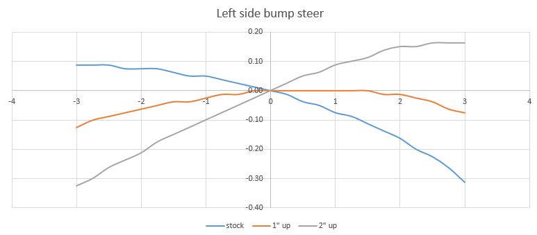

      Ryan - thanks. It is for my 69 Impala. Hard to get off the shelf parts but that's ok for now. Just looking at bump steer, I can get a lot of improvement bringing the outer tie rods up an inch. Problem with that is 2" is more realistic just using a commercially available adjustment kit so I'm looking at custom steering arms. Not that big of a deal, I can have them made here at work. This is a plot of the changes over 6" of total travel at stock, 1", and 2" out tie rod vertical change:

      Sweet car! Your ride height measurements look a little high compared to the B-bodies I've had. The rule of thumb is that the lower A-arm pivot points (bushings and ball joint) should be "level" with the ground, which helps with camber gain. Make sure you have your ride height nailed down before you make any other changes.
      You may also find this tool helpful if you haven't seen it already:
      http://vsusp.com/?tool=2d#0.8%26proj...ll_center.y%7D
      - Ryan

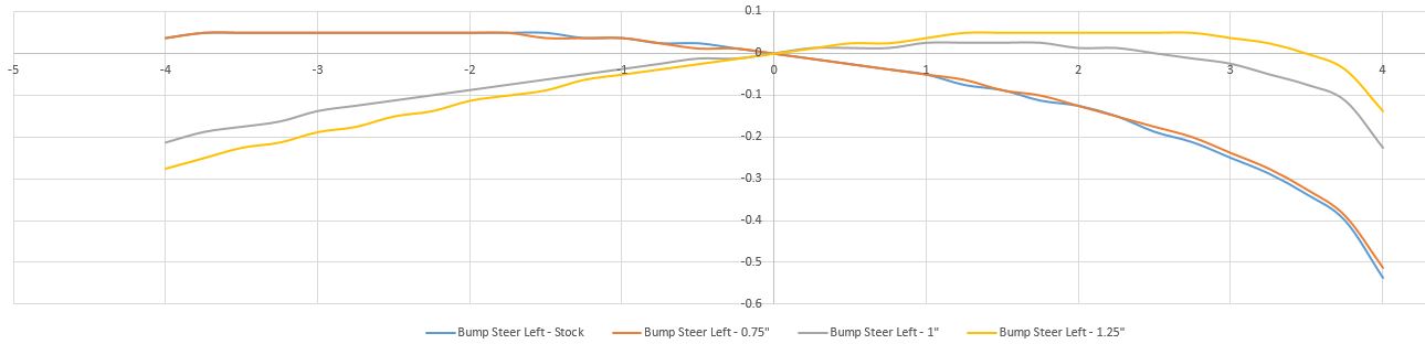

      Little bit of model refinement based on re-checking my measurements, which will probably happen a couple more times... I'm not building a race car here so the end goal is improvement, not perfection. That being said, only leveling the center link might be my best option. Toe change in compression is not terrible.
