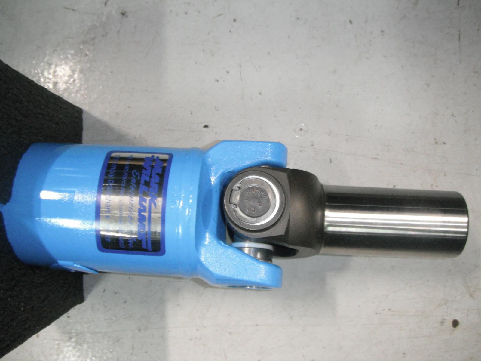

      Another option is to use a driveshaft with CV joints. I have a single CV shaft in my GTO and a dual CV shaft in my Cougar. They are made by The Driveshaft Shop.

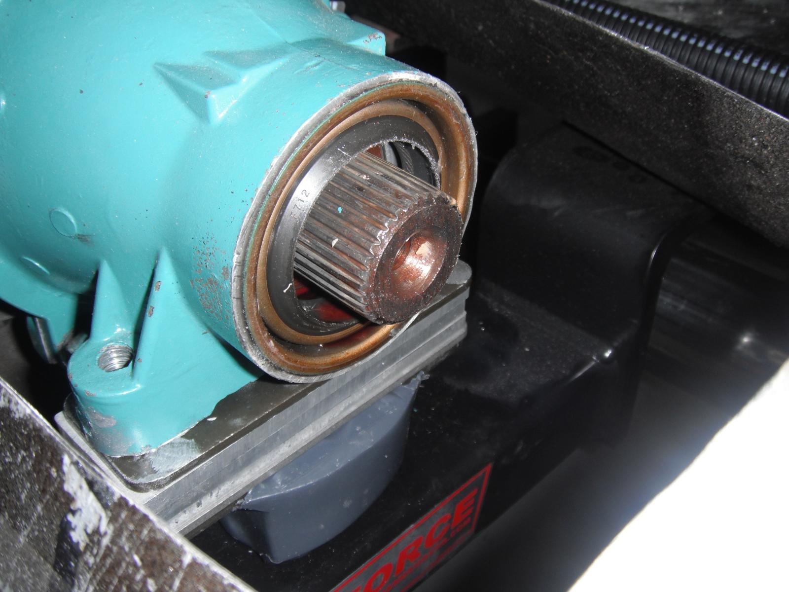

      Cut tunnel, raised the trans by 1.1" using a pile of shims and now have 2.90 degrees downward tilt. This caused my 4" driveshaft to hit the tunnel so I went with a 3.5" MW chromemoly shaft. Now I need to weld-in the Hurst trans tunnel (2 piece) after I fill in the stick shift hole.
