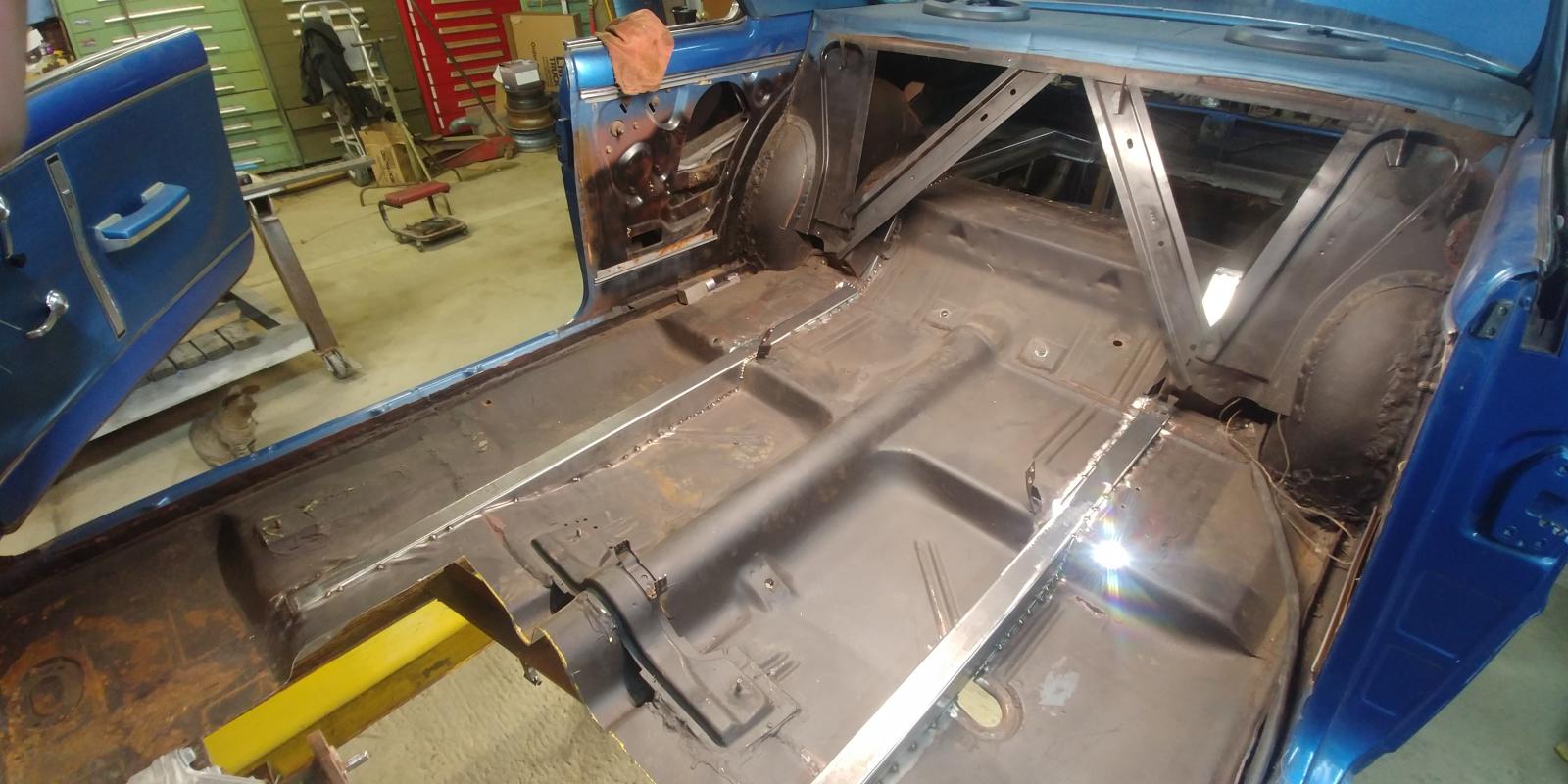

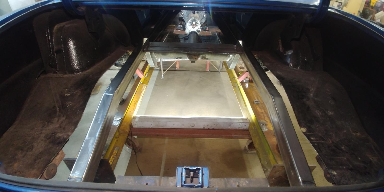

      Rear Frame Rails
      Rear frame rails a tacked in the length of the rail and securely attached to the to the front stub struts.
      Front of frame rails attached to front stub struts, plug welded and perimeter welded:

      Frame rails cabin view:
      Name:  Frame Rails Cabin View.jpg

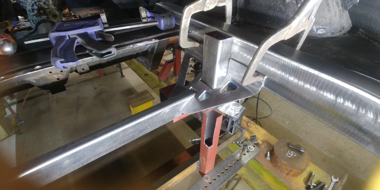

      Rear Ceoss Member and Suspension Mounting Points

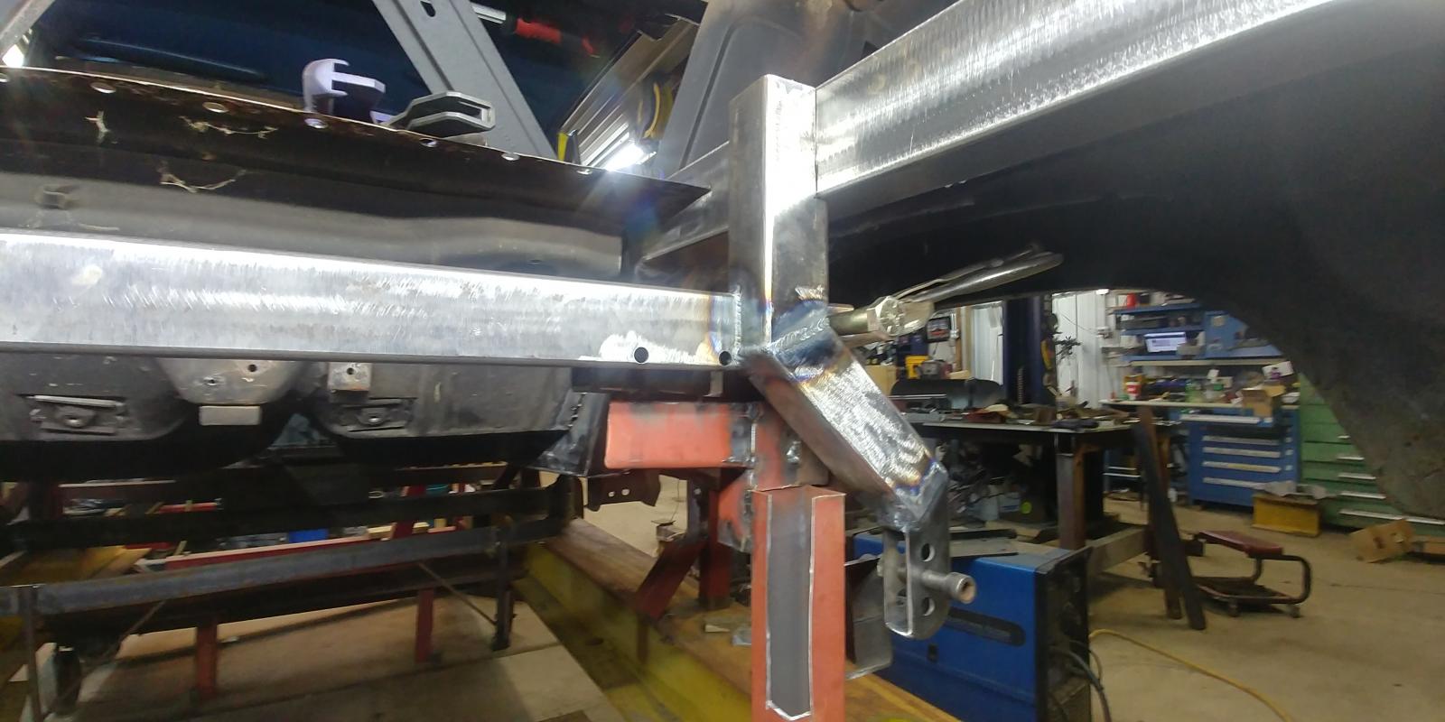

      Progress on the rear cross member and suspension mounting points. Mike in an earlier photo created the jig fixture from which he is now locating the mounting points for the track bar and the coil over shocks upon the fabricated cross member.
      We chose the welded in frame rails and cross member over the bolt in connectors and cross member with the desire to stiffen the chassis up.

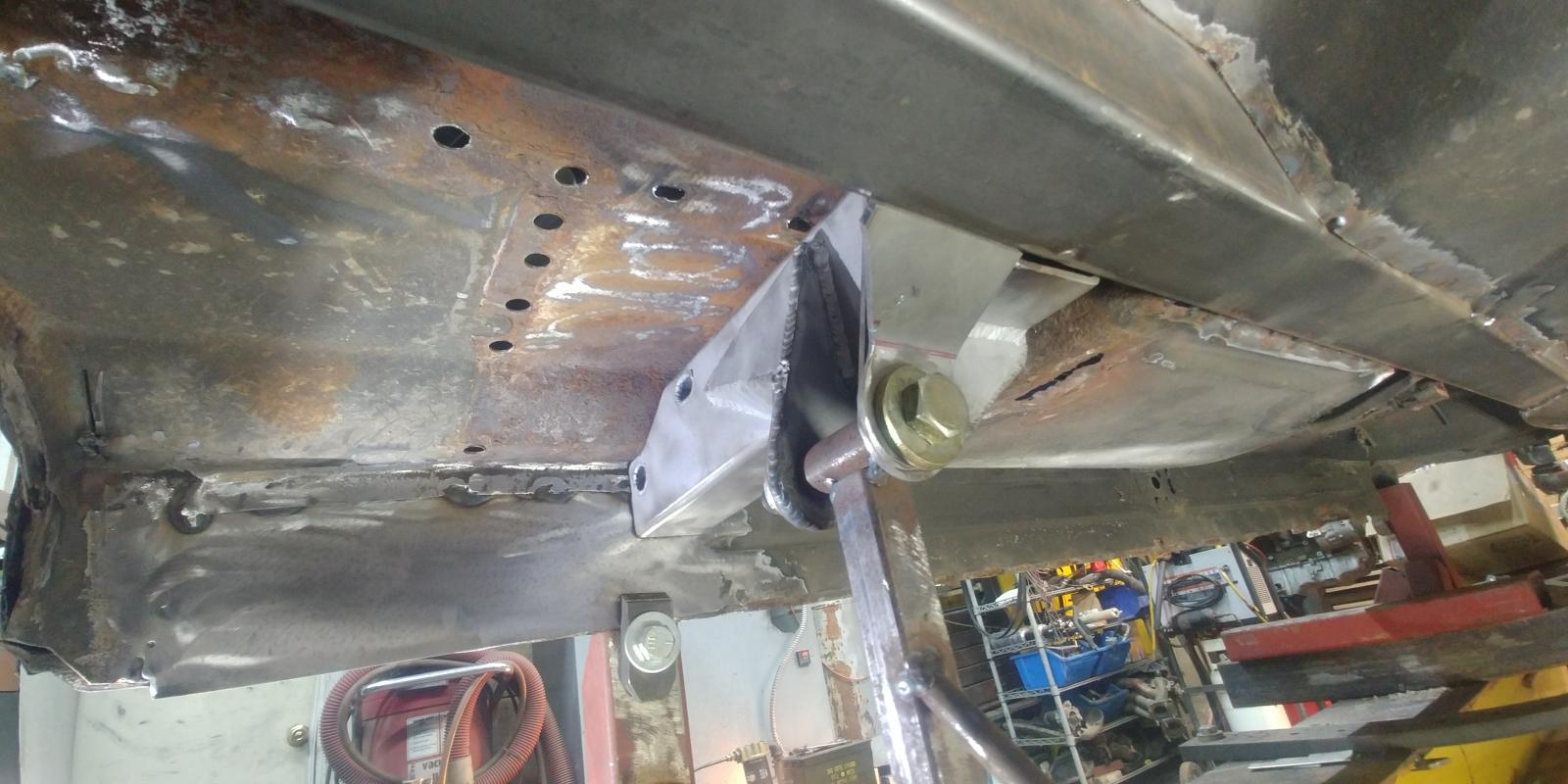

      Name:  Rear Cross Member Track Bar Adjustabilty.jpg

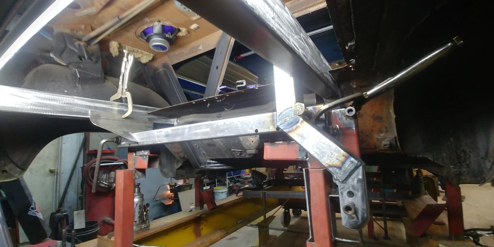

      Rear Ceoss Member and Suspension Mounting Points Tig Welded
      The Cross member shown welded up.
      The starboard side all welded up.
      Name:  Rear Cross Member Starboard Side Bracket Tig Welded up.jpg
      The port side welded up. factory bolt in piece is standing up from floor, end upon the yellow extension cord.

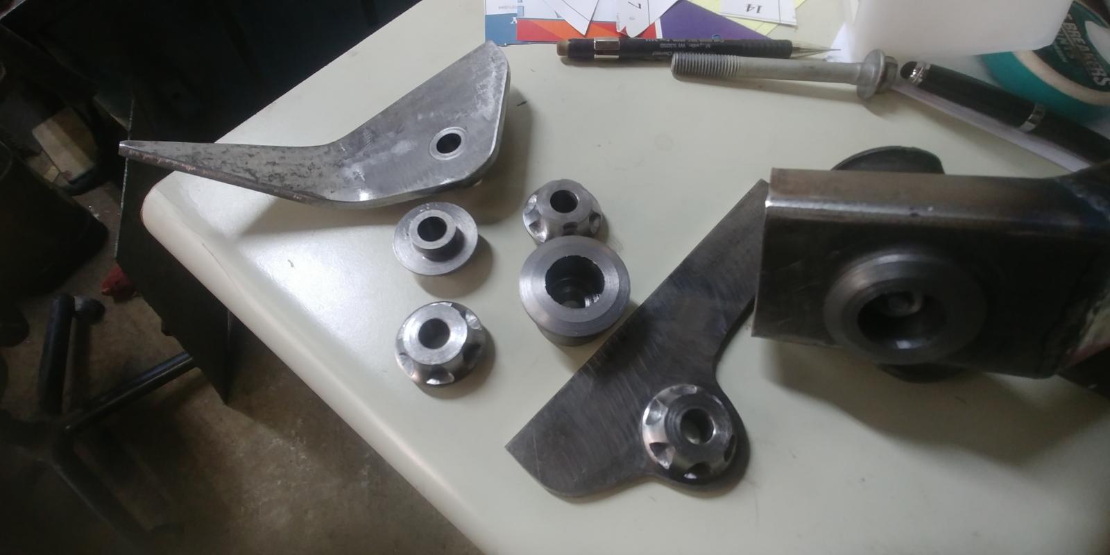

      Motor Mounts Ready For Assembly And Tig Welding
      Mike finished the bushings for a little motor mount bling.
      Name:  Motor Mount Bushings.jpg

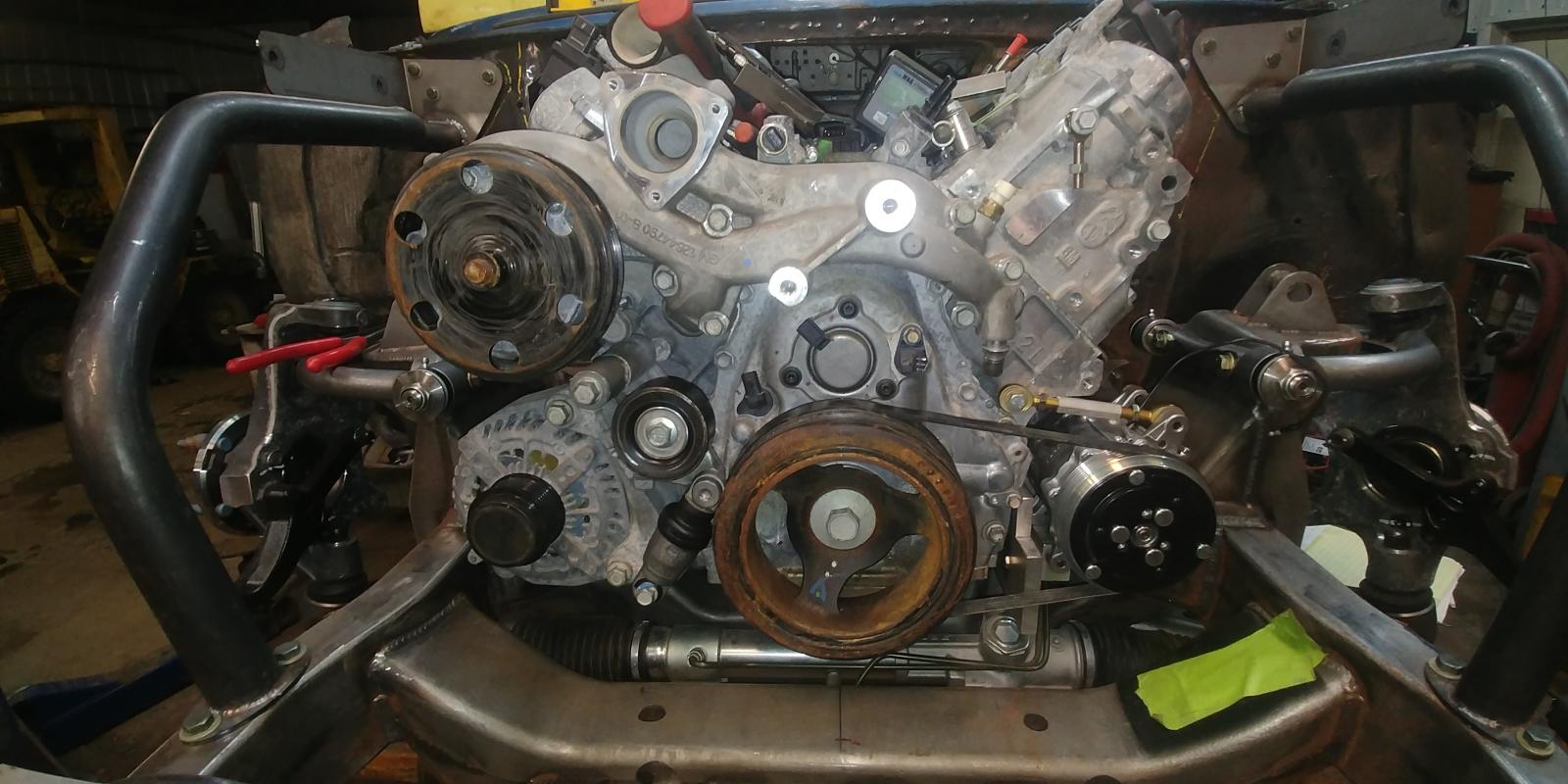

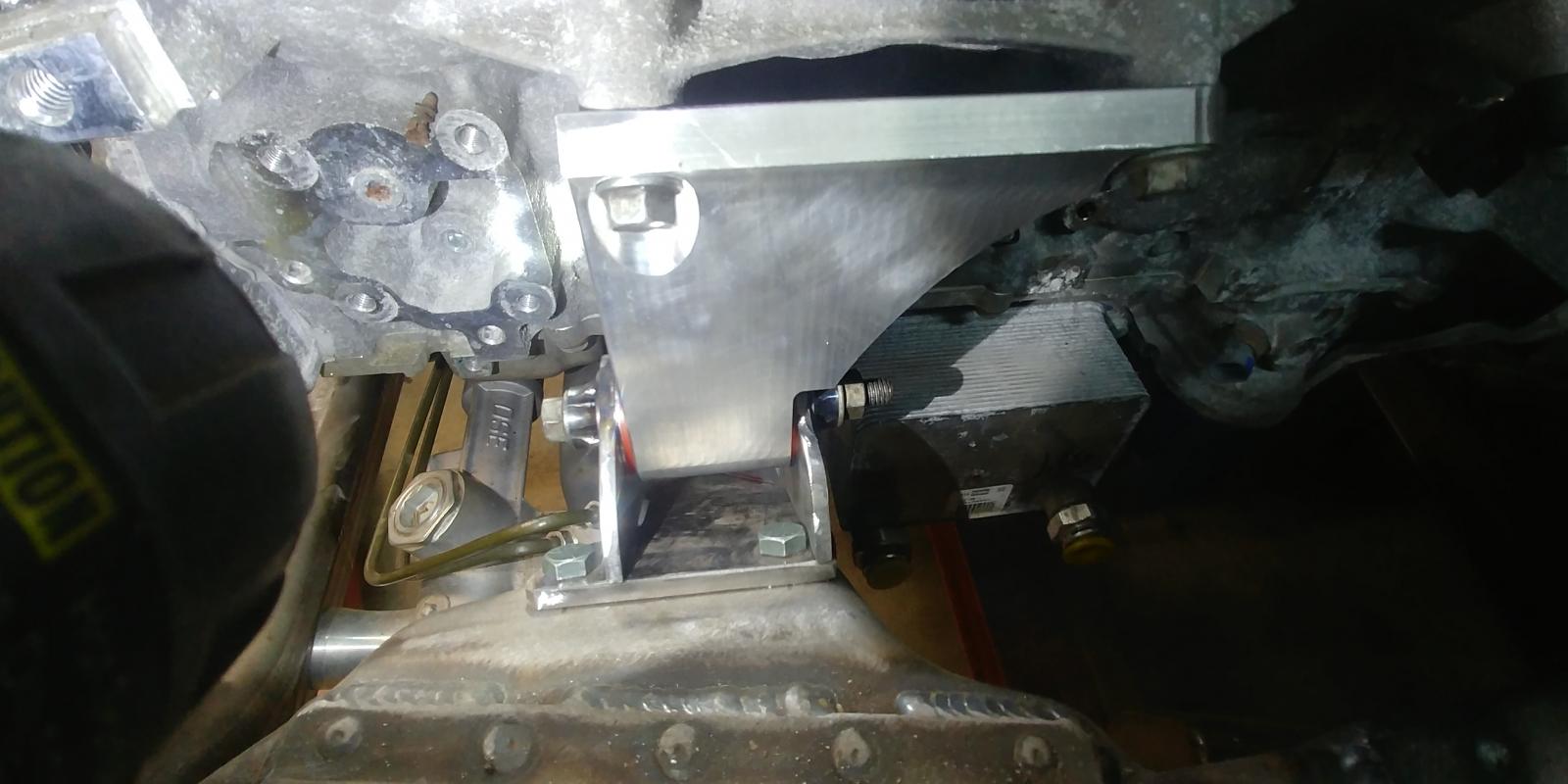

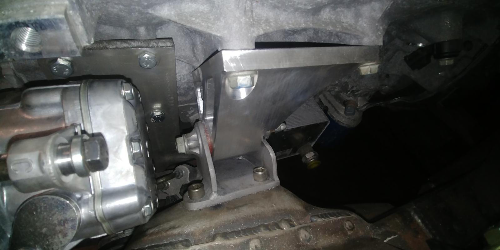

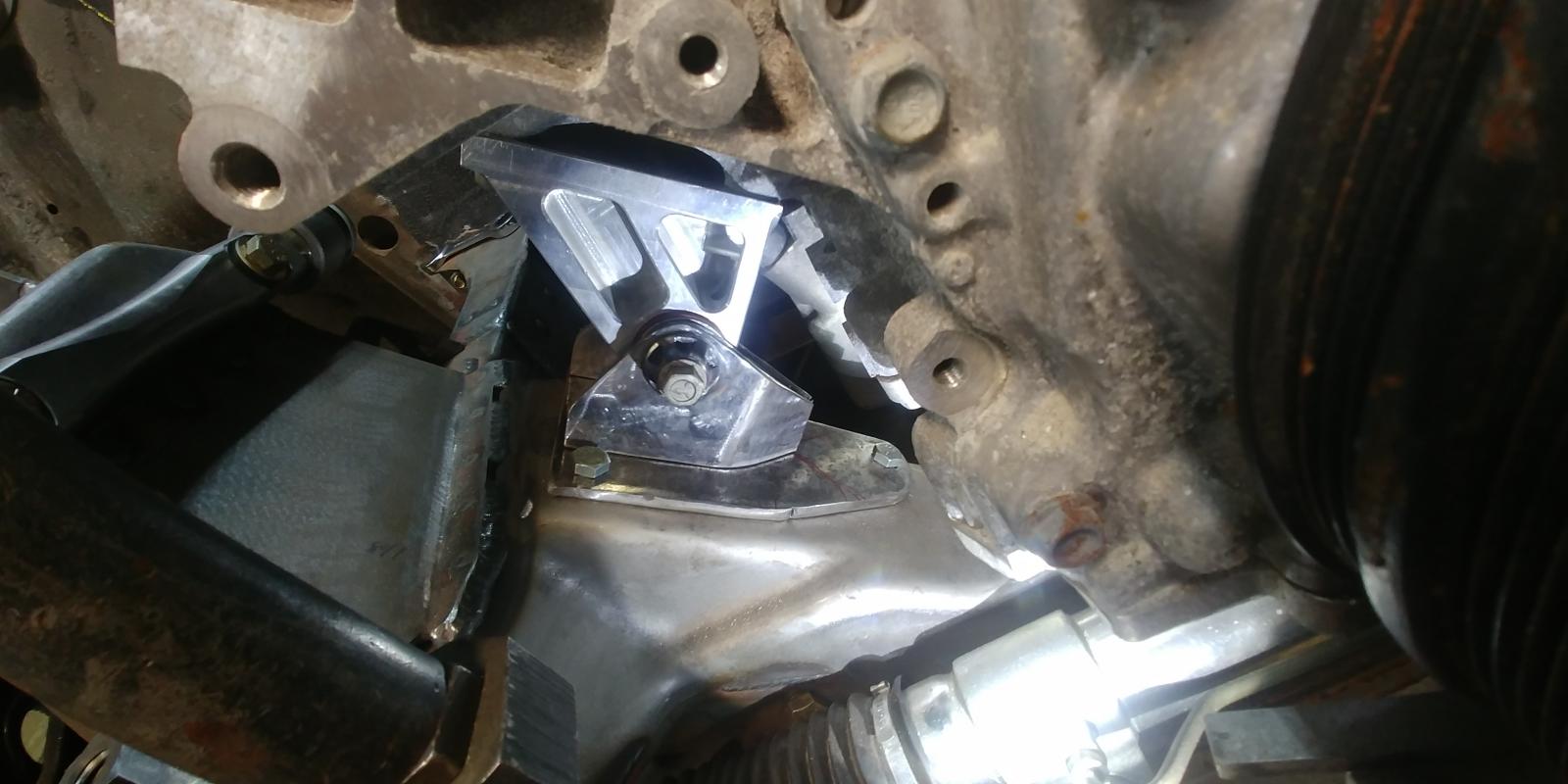

      Welded Motor Mounts and Mocking Up The Accesory Drive
      The Motor mounts are welded up and doing what they do best!
      Name:  welded Motor Mount and AC compressor bracket.jpg
      Mocking up the AC compressor Bracket and thinkulating about the power steering pump and resovoir.
      Name:  Mocking Up Accessory Drive.jpg

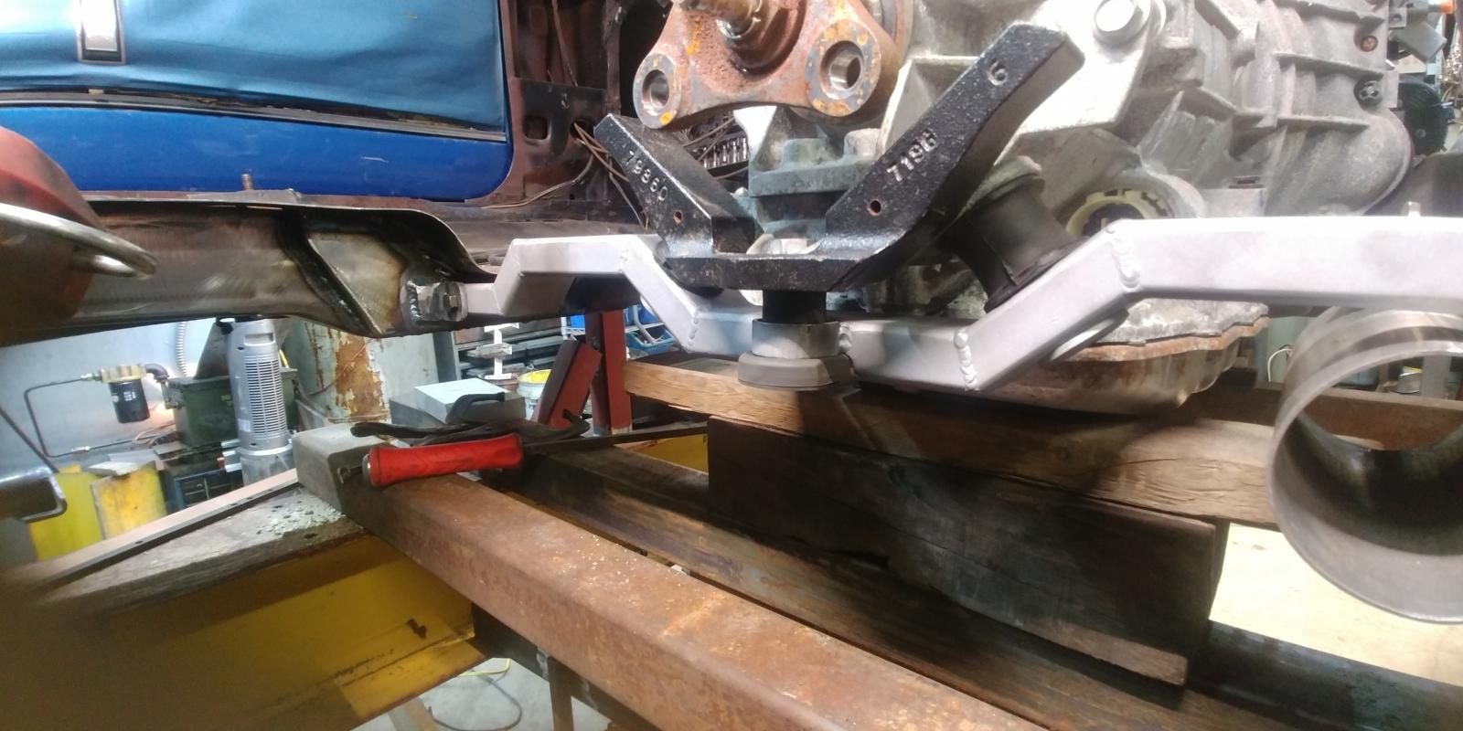

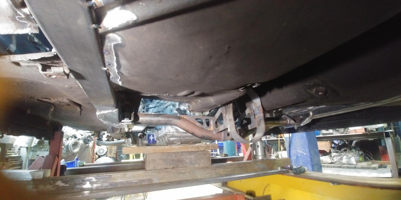

      Transmission Crossmember Completed and Installed
      Transmission cross member and bracket are completed and installed in the frame rails.

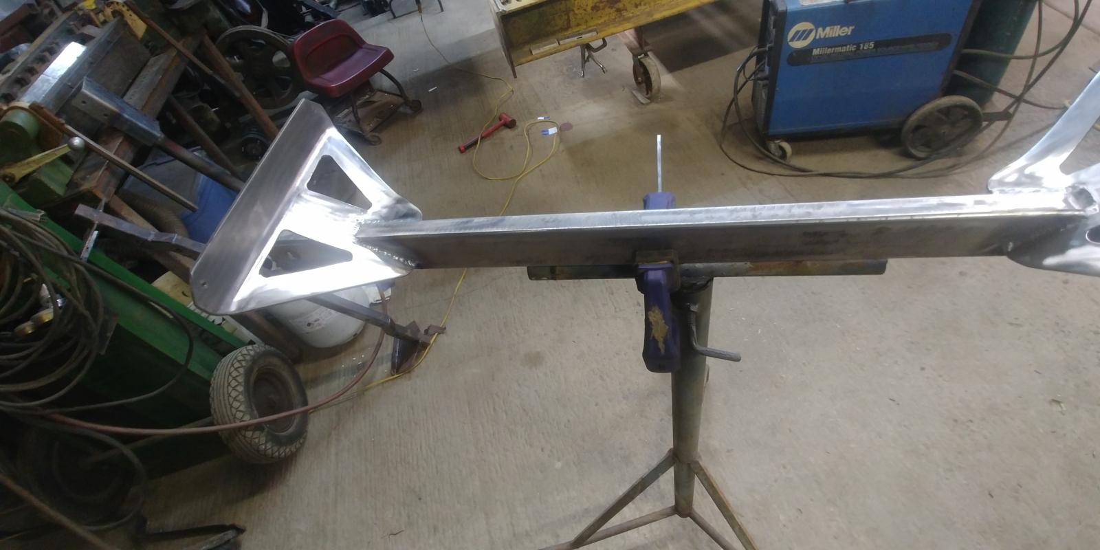

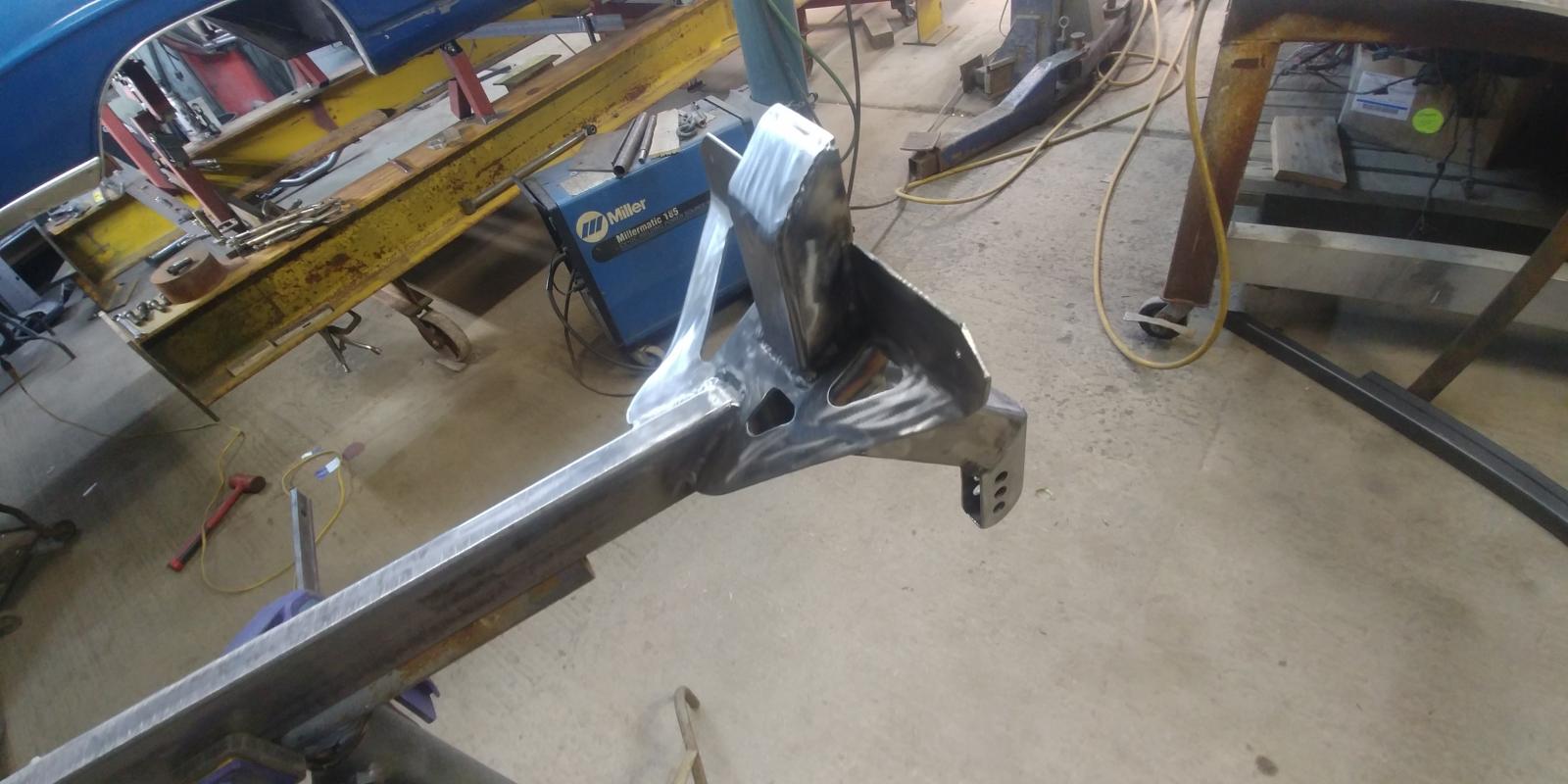

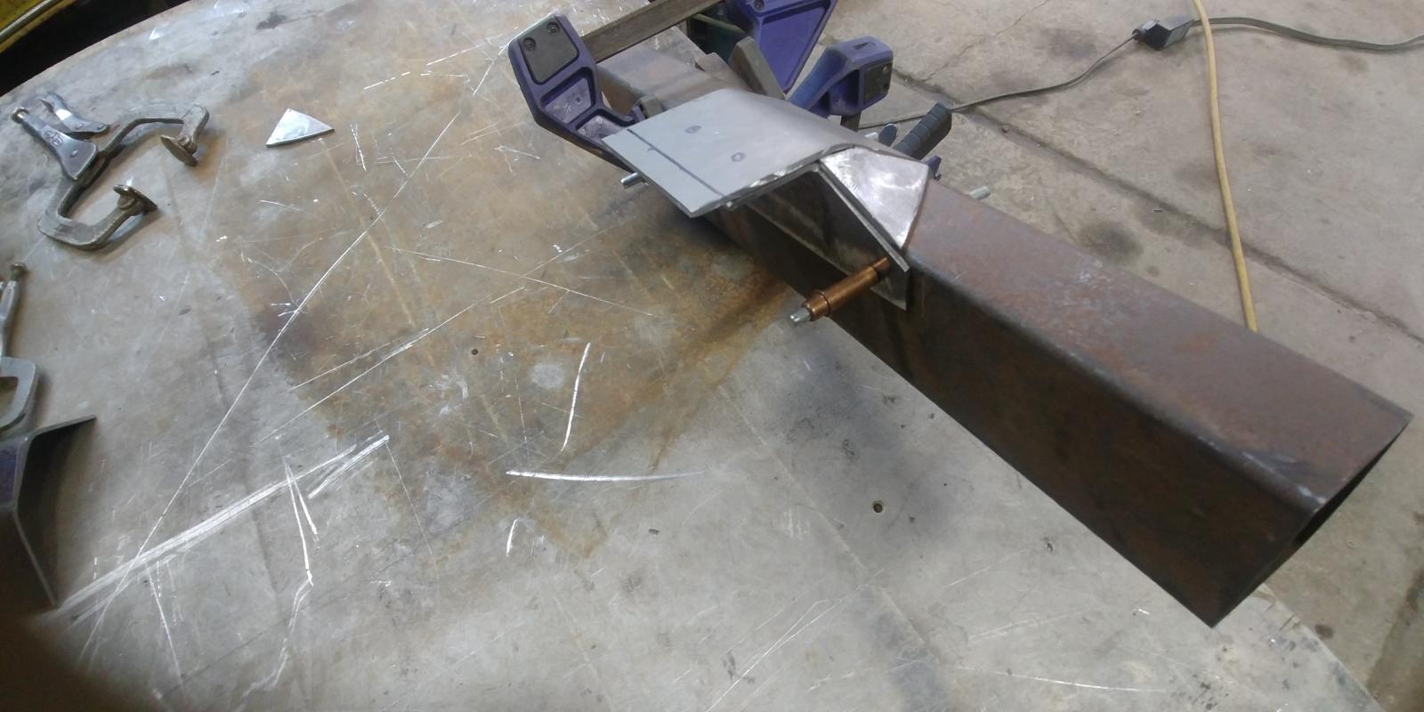

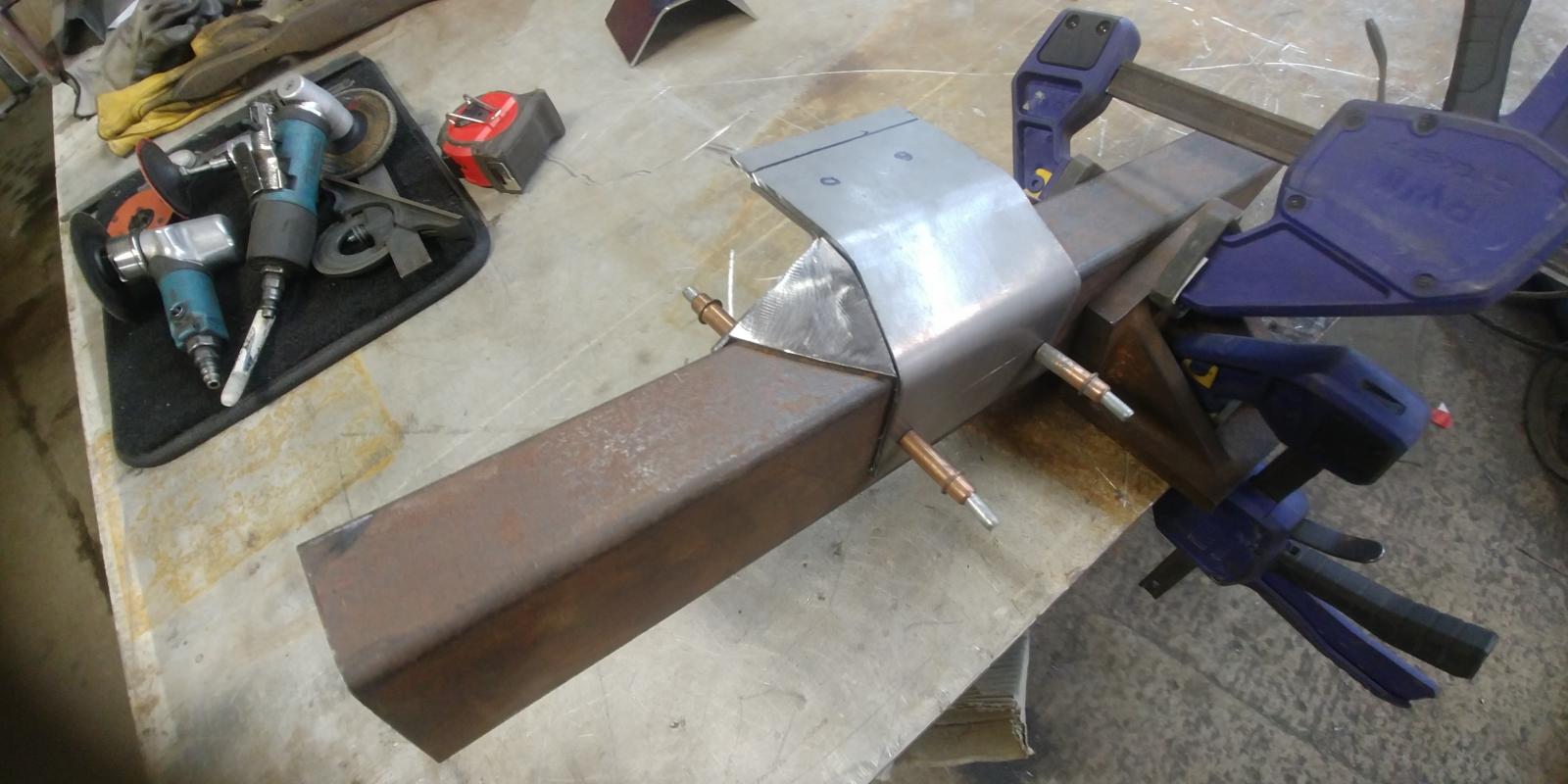

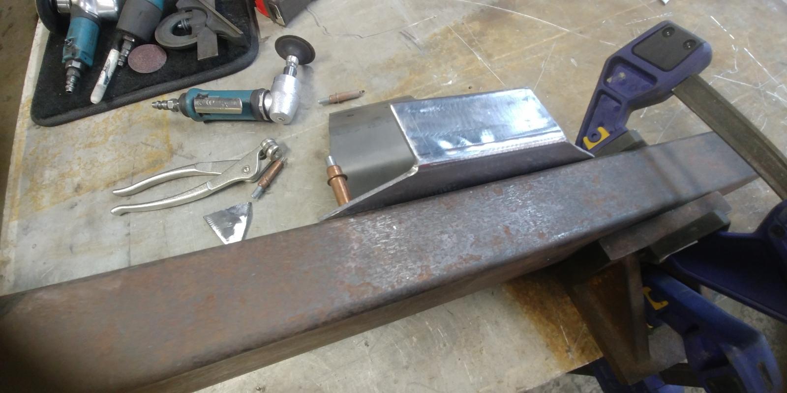

      Brackets For Torque Arm Crossmember
      Mike Said "Here is one side of the torque arm crossmember mounting brackets. I used a piece of tubing on the bench so i didnt have to crawl under the car to do this. They will be welded together here then slipped on the frame rail and welded in place where the jig is at under the car. They might look a little funny but they will get the job done. And then some."
      I think the brackets will look great!
      Name:  Bracket Fabbing.jpg
      Name:  More Bracket Fabbing.jpg
      Name:  Ta Da Bracket Goodness.jpg
      These brackets will hold the bolt in crossmember for the pivot point of the TCI 2 arm torque link suspension. We are going with all weld-in suspension stiffening and hard points from which the TCI bolt in suspension will mount.
      Cheers!

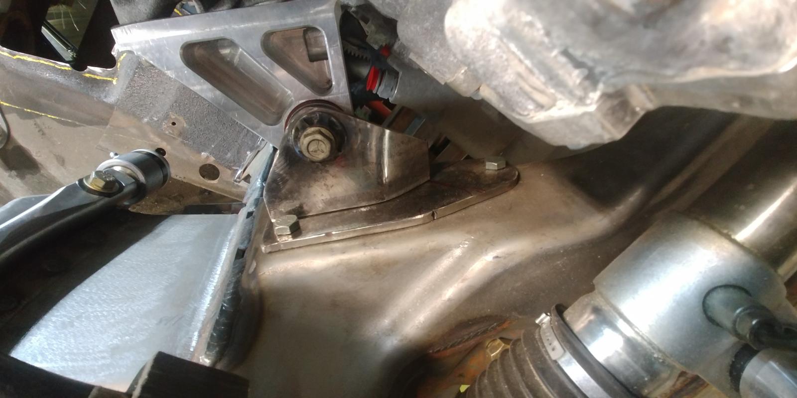

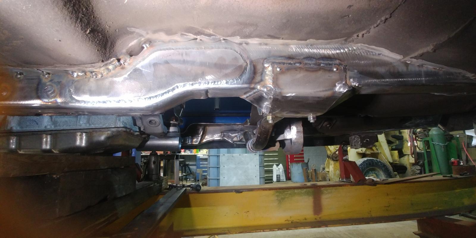

      For Your Viewing Pleasure Brackets Welded in and installed
      TCI Torque Arm Pivot crossmember brackets welded in and installed!
      Name:  Brackets all Welded and Installed.jpg
      Name:  Another Brackets all Welded and Installed.jpg
      Name:  Bracket Installed.jpg
      Ain't it pretty!!
      Floor pans will be addressed when suspension is in place and when we address the tunnel.

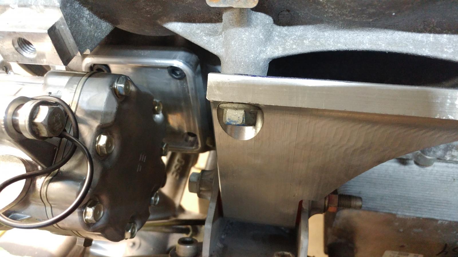

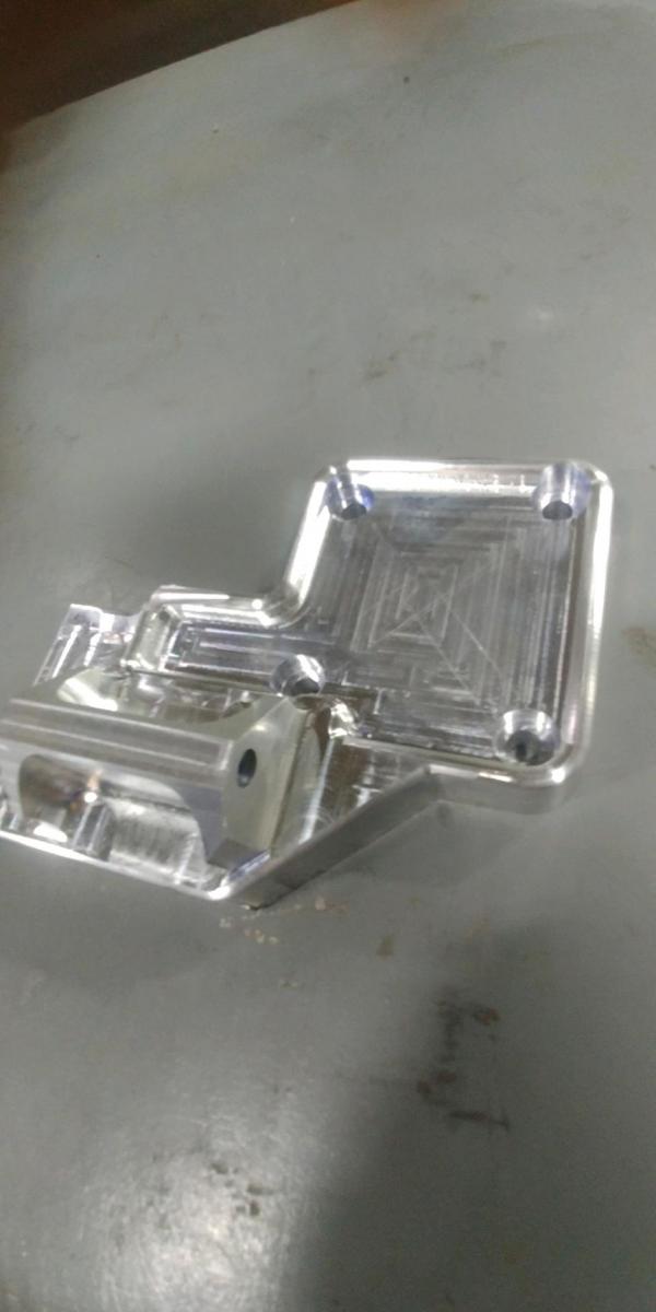

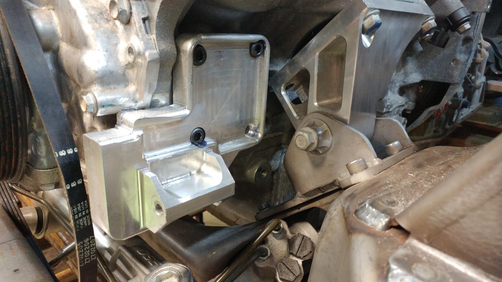

      More Billet Whittlin, The A/C Bracket For The Sanden SD7B10 Mini A/C Compressor
      We will be thinkulating for the top bracket this week end.
      The Bracket:
      Name:  AC Bracket.jpg
      Name:  AC Bracket Mounted on the Engine.jpg
      The Front is unfinished in case we need to mount an idler. The Bracket mounted on the engine:
      Name:  AC Bracket Sanden Compressor Mounted another view.jpg
      The Sanden SD7B10 Mini A/C Compressor mounted on the bracket:
      Name:  AC Bracket Sansem Compreessor Mounted.jpg
      We will be designing the top bracket this weekend.

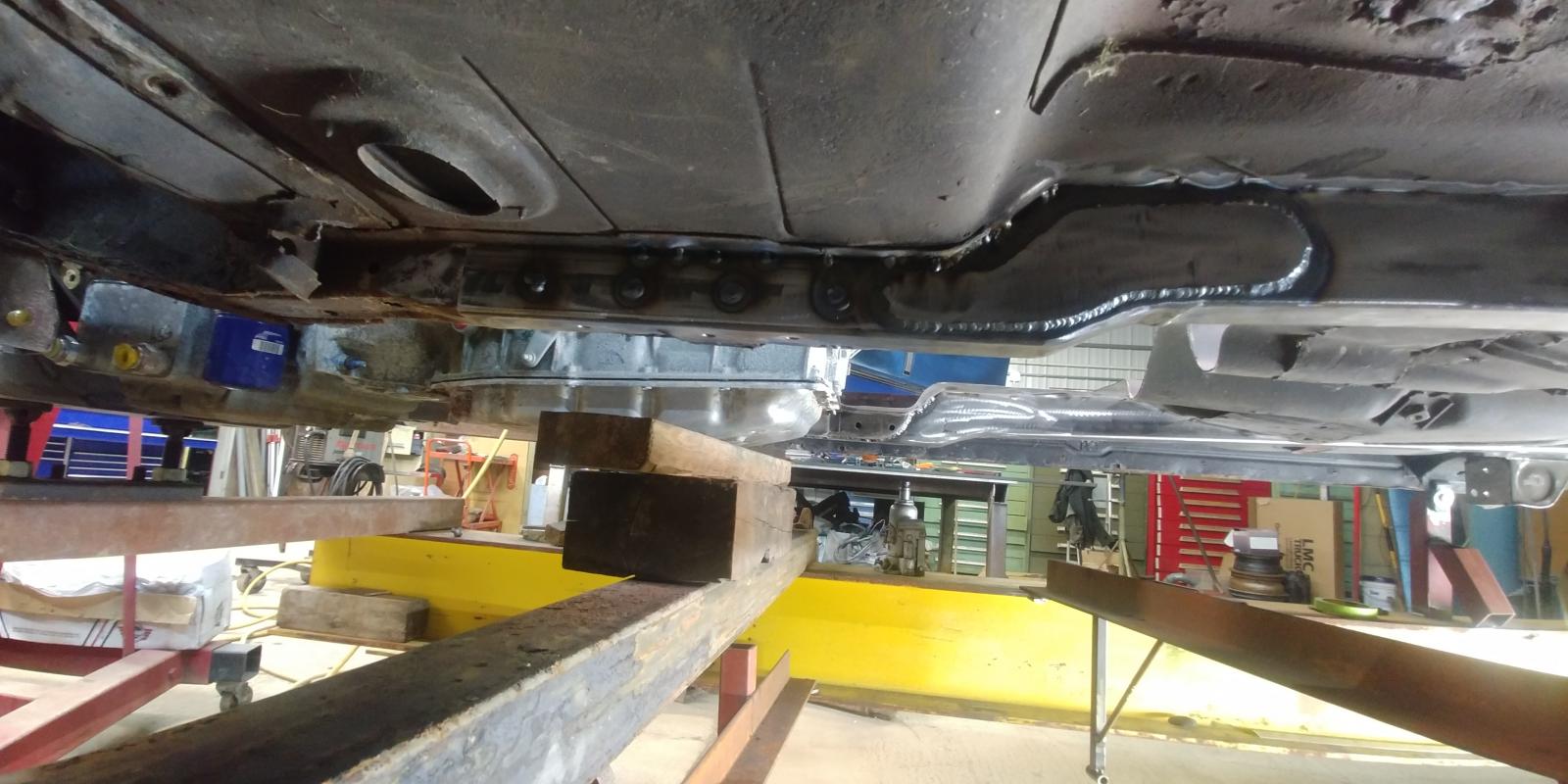

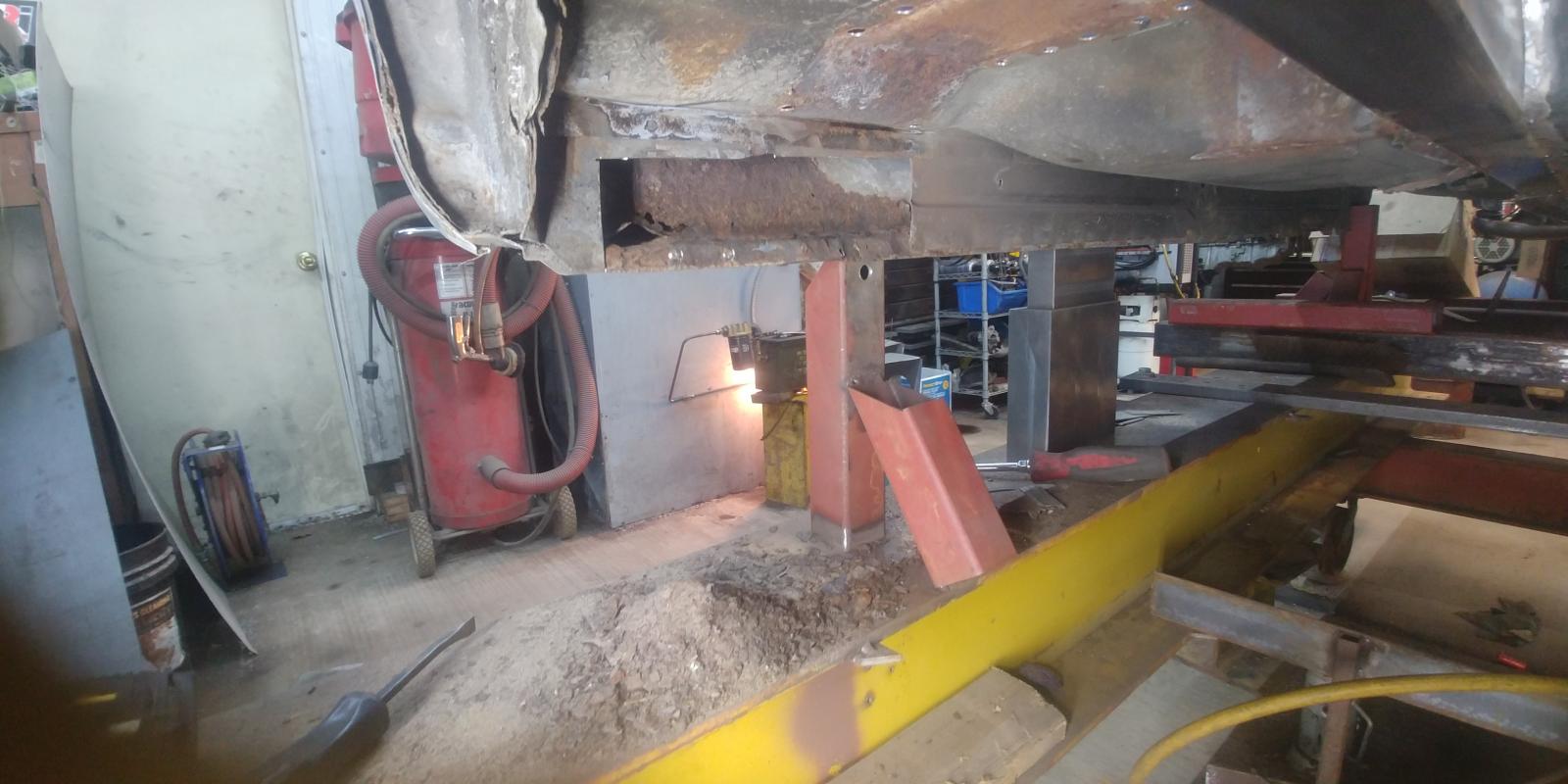

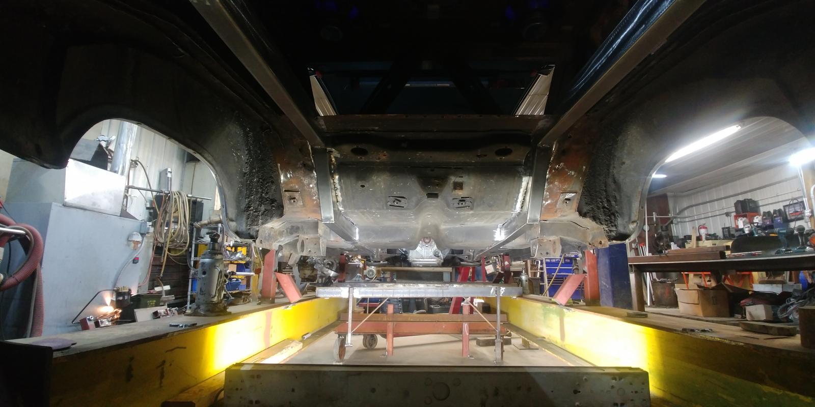

      Hi Folks! Time to update you with progress reports!
      We are working on the rear suspension of NovaSS!
      Mike Said ”Notice all of the rust and sand that is sitting on the frame table. This was all fished out of the rockers. The rocker panels will definately need to be replaced. The area of the inner rocker i am replacing will facilitate forward progress in the chassis fabricating. As discussed, the body work will be addressed in a different stage of your build.
      Below you will see the inner rockers:
      Name:  12-1-19 Port Side Inner Rocker Panel.jpg
Size:  128.2 KBName:  12-1-19 Starboard Side Inner Rocker Panel.jpg
      Mike said “Notice in the 2 bottom pics that the old leaf spring mount that was cut out is sitting on each side of the table under the area that was repaired. Gives you a better idea of the work going into your car, and how much better of a machine it will be when compared to using the old sheetmetal mounts and other things that will get replaced along the way. I should have kept track of the number of spot welds that had let go over time. Imagine how many old cars are on the road that are held together by just a handful of spotwelds!”
      Below You will see the replacement panels for this phase of the build:

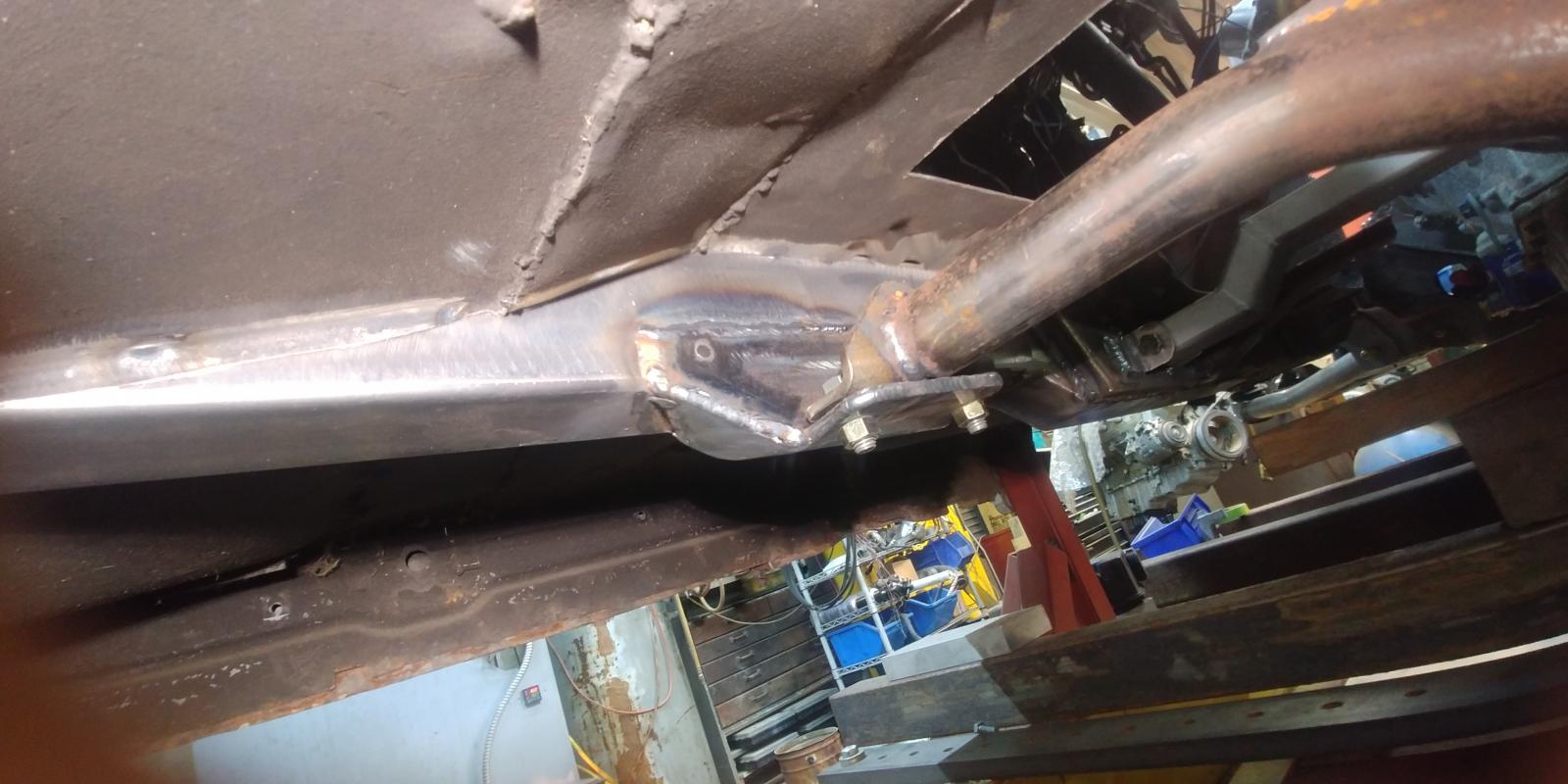

      Mike Said “Last 3 pics notice the small tab/ear that is bolted to the inboard side of the mount. This will get welded to the frame rails after the crossmember gets finish welded in. Should be nice and strong”
