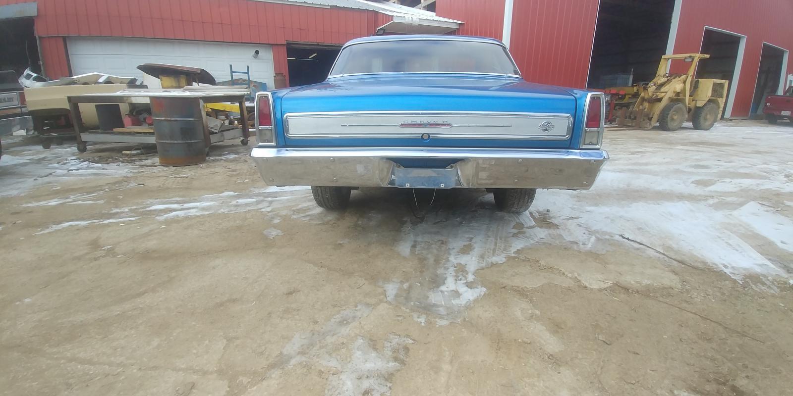

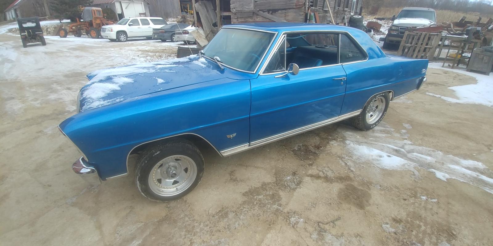

      I saw evldoers nova and wanted his SS. Then I almost bought a real TURD and passed and for 1/2 the money bought this:
      The Victim:
      Name:  The Victim.jpg
      Hindend:
      Name:  Nova Hindend.jpg

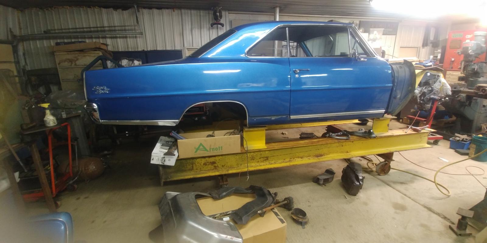

      On the hoist:
      Name:  Nova On Hoist Pre Gutting.jpg

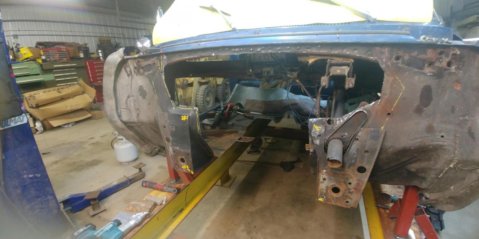

      Gutted and on the table:
      Name:  Nova on the table.jpg
      Another sexy shot:
      Name:  Nova on the table front view.jpg

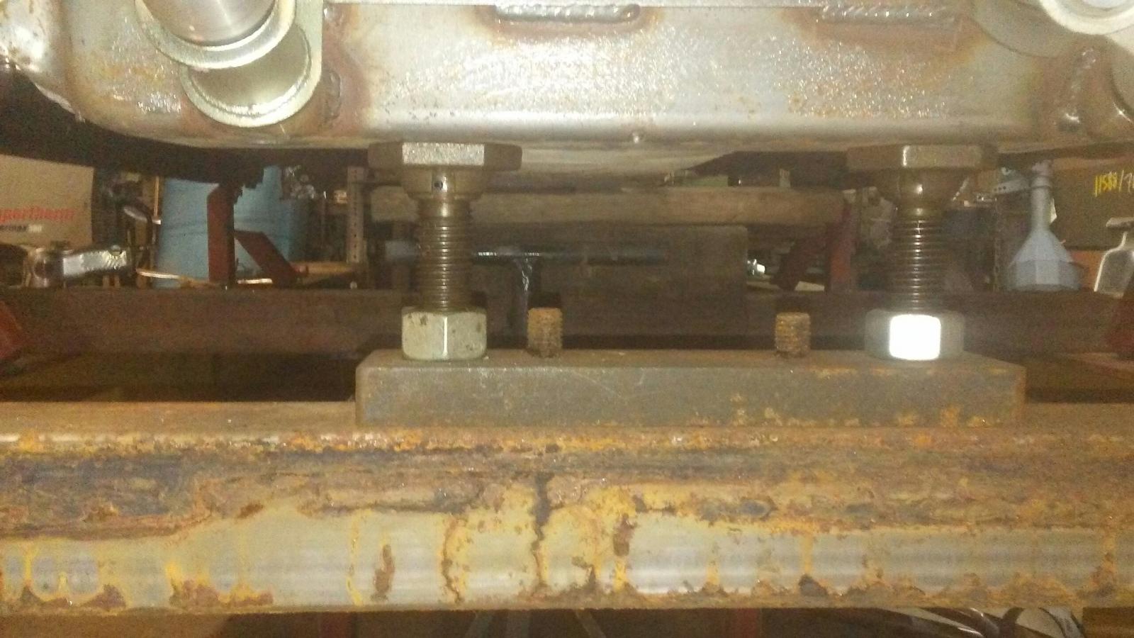

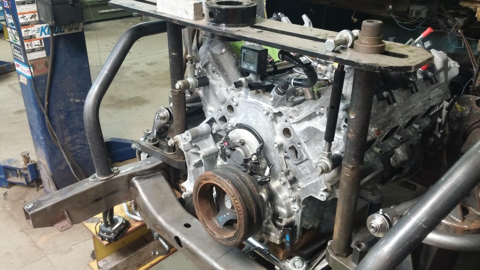

      Mike's tramming, squaring and positioning engine this afternoon and tonight:
      Name:  Port Side Fore Quartering View.jpg

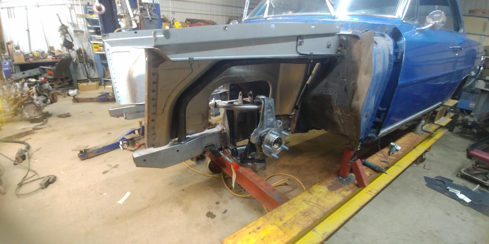

      More Pictures:
      Woo Hoo!
      Name:  Starboard  Front Detroit Speed Suspension.jpg
      Name:  Core Support Aft View.jpg
      Hold on to Your Scrotum! The CUT!!!

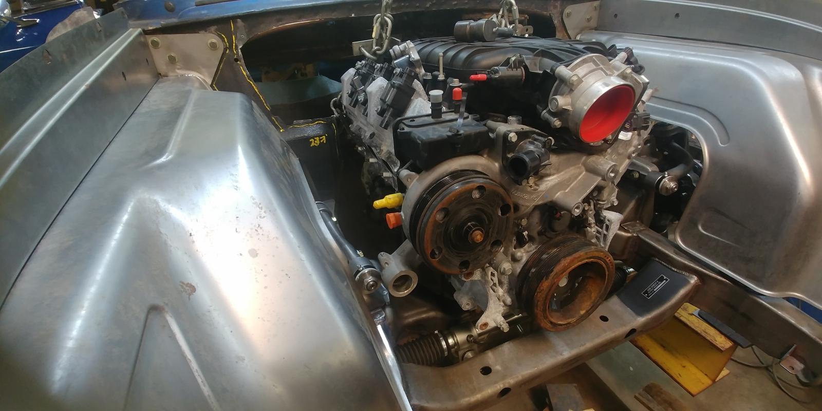

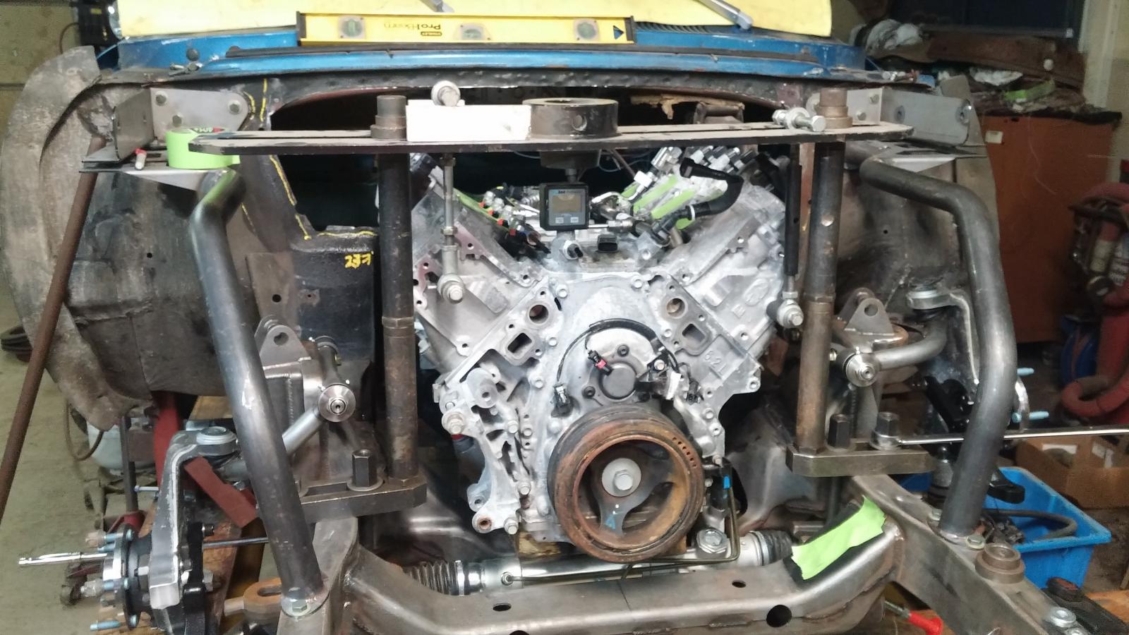

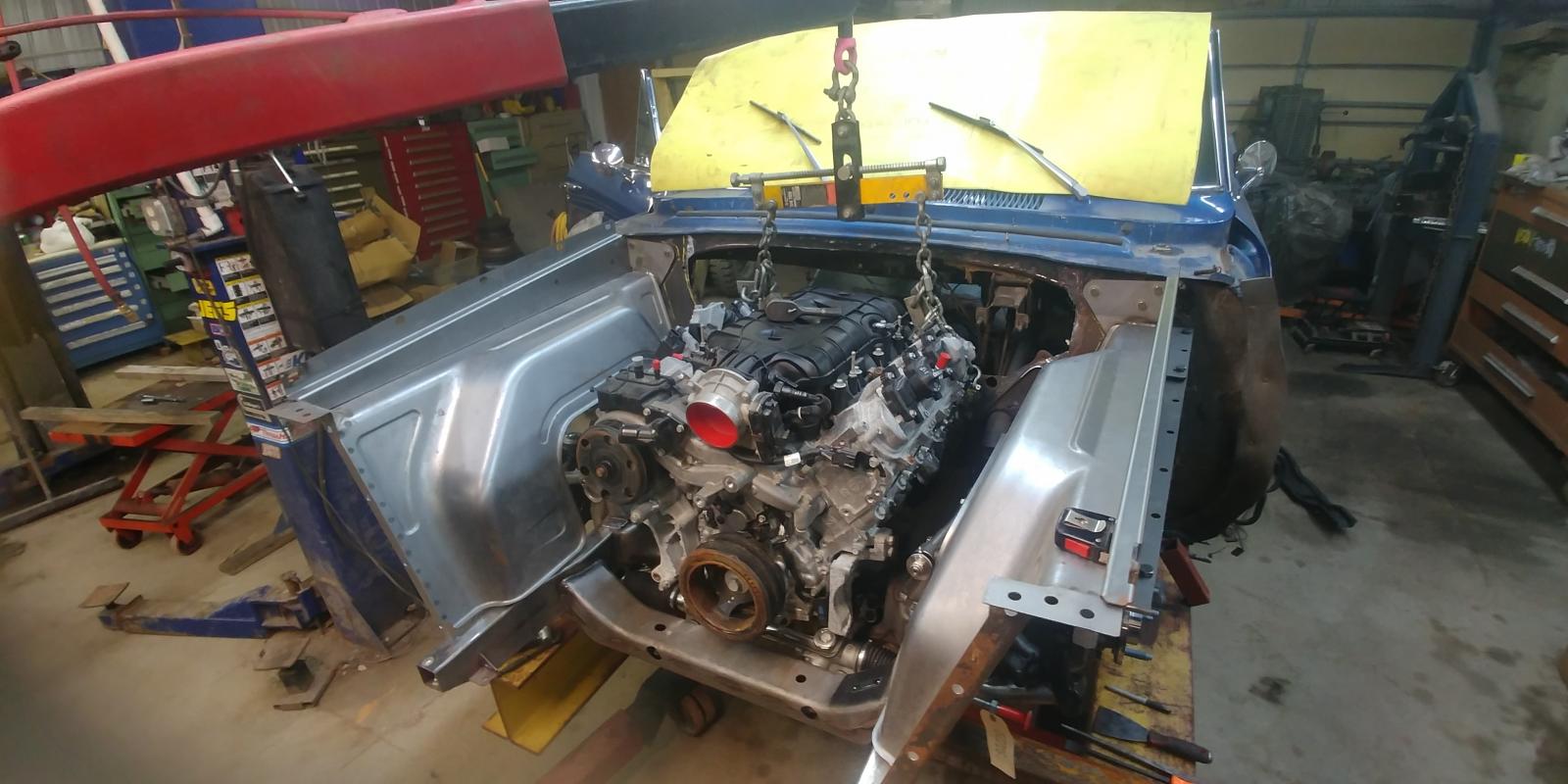

      Playing with engine locations:
      Name:  Port Front Side Engine View.jpg
      Name:  Port Front Side Quarter Engine View.jpg
      Name:  Port Side Tranny View.jpg
      Name:  Starboard Engine View.jpg

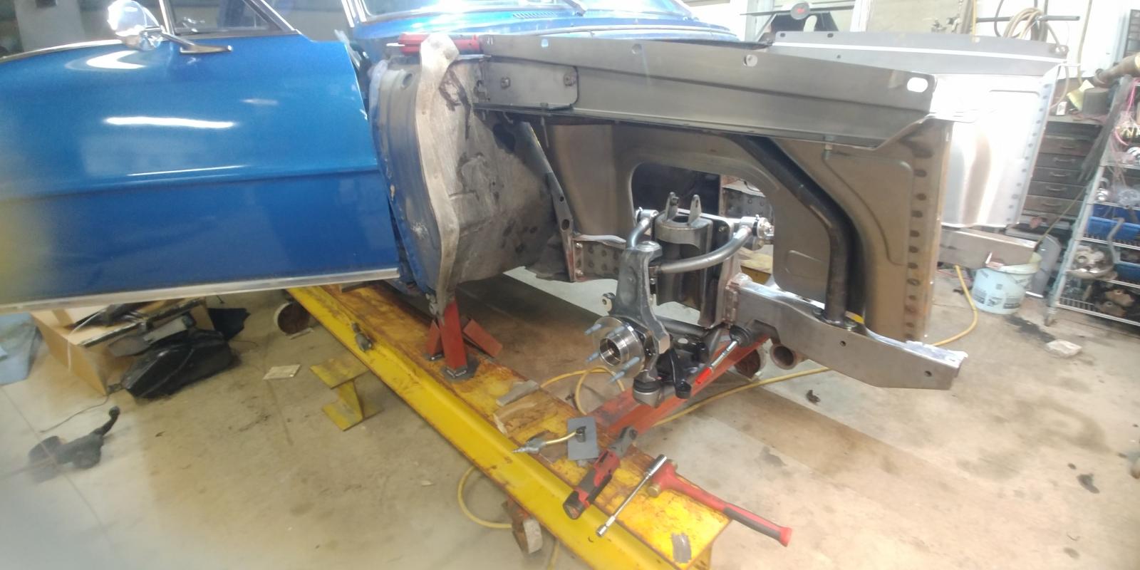

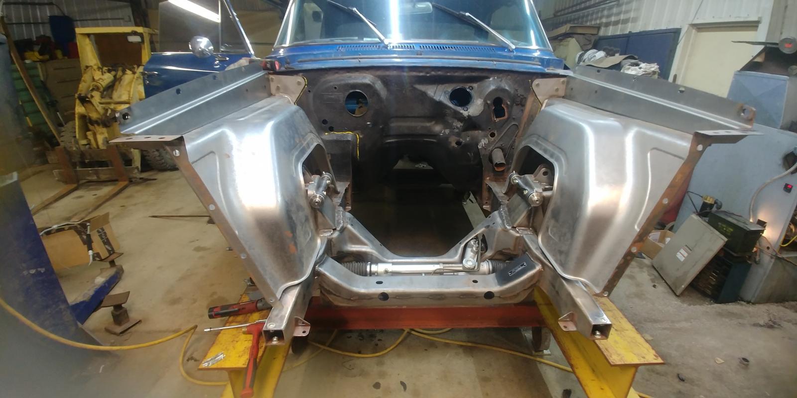

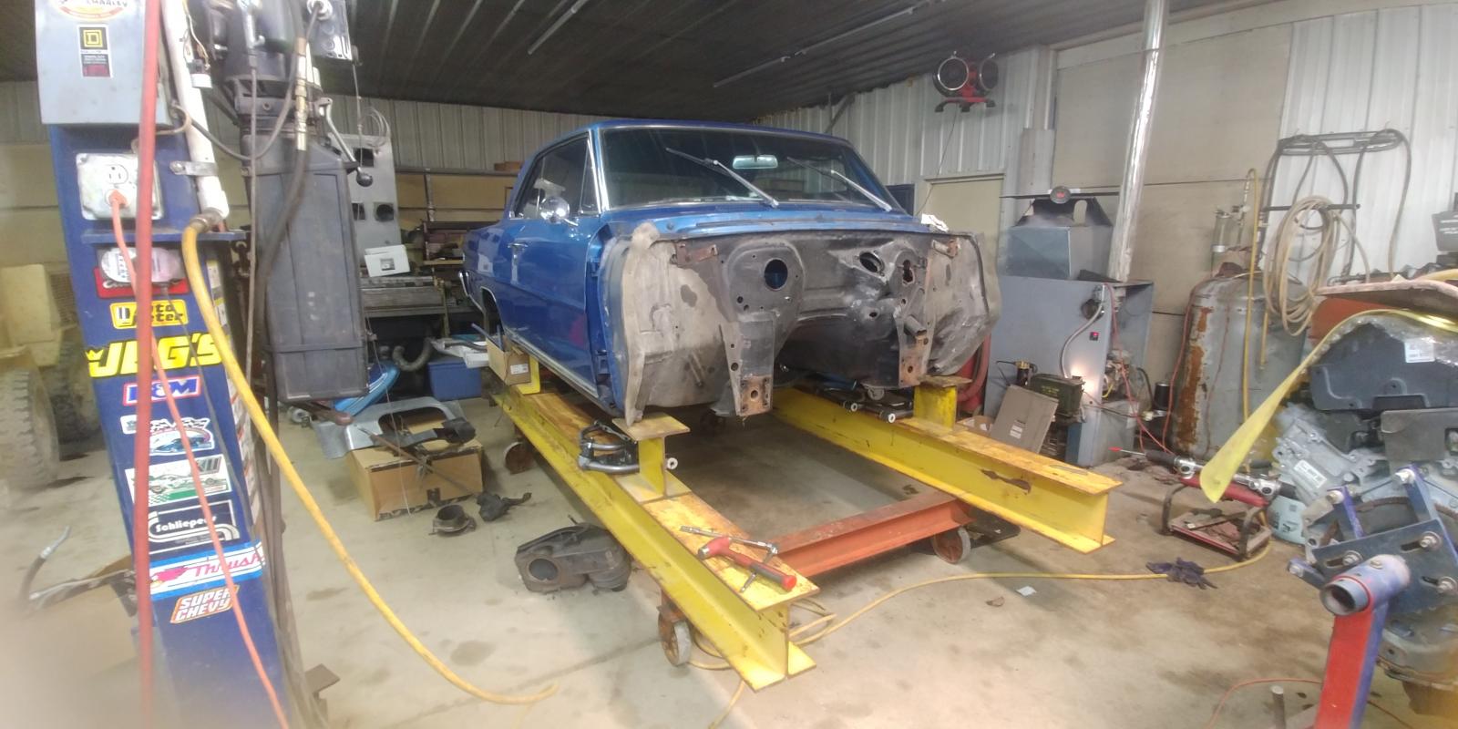

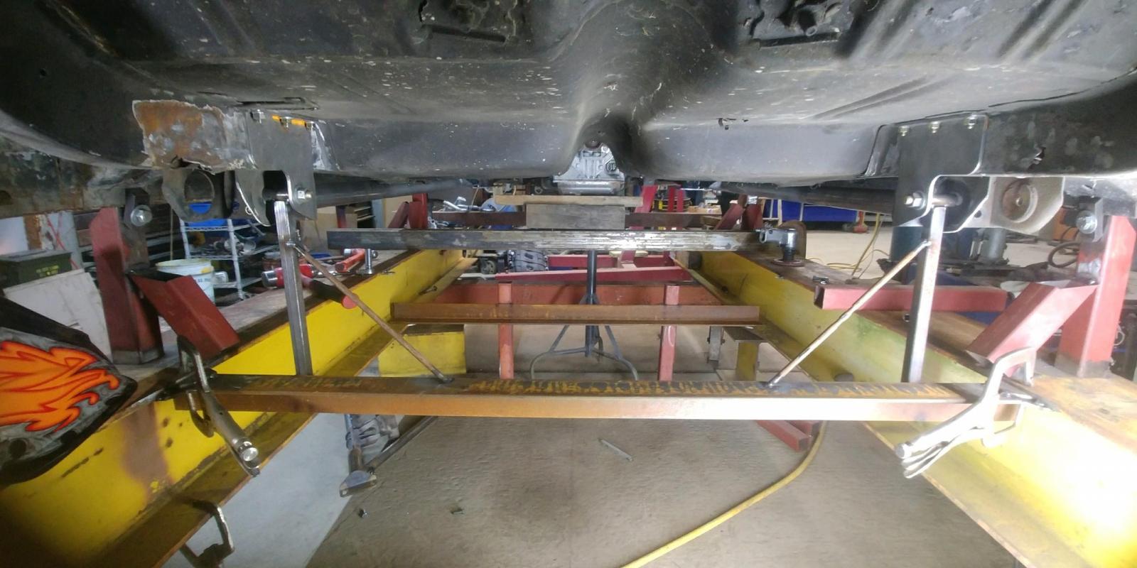

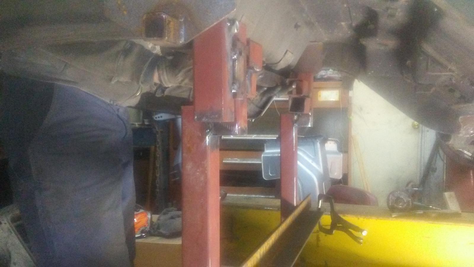

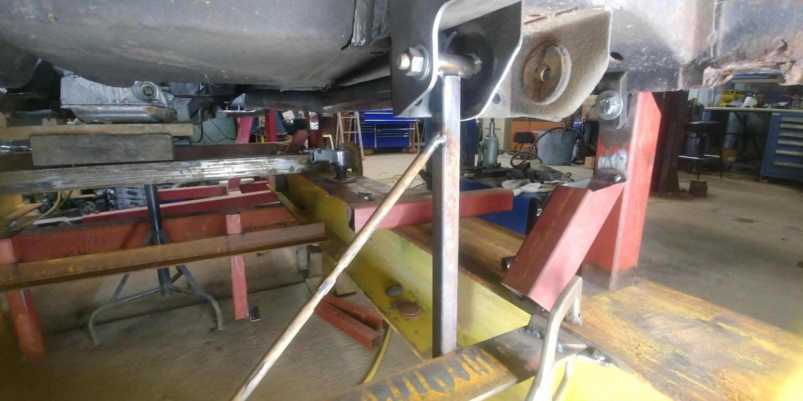

      Working on securing rear of car to frame table to install tube frame from front frame box to rear bumper mount.
      Rear suspension is TCI 2 link torque arm suspension.
      We are installing own 2 x 3 tube chassis rail from front to back and creating mounting points upon floor and frame rails.
      Working on frame jigs. Front is done for front 3 link crosmember mount. Can be seen hanging upside down.
      Name:  Working on frame jigs.jpg
      Creating jig for suspension mounting points:
      Name:  jig for the outer 3 link.jpg

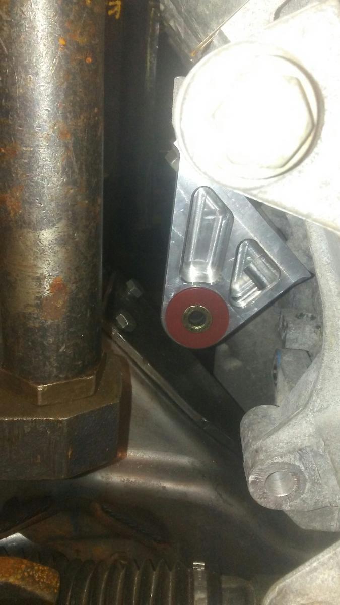

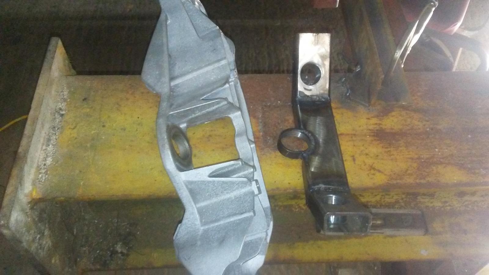

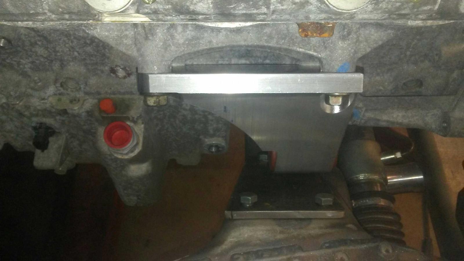

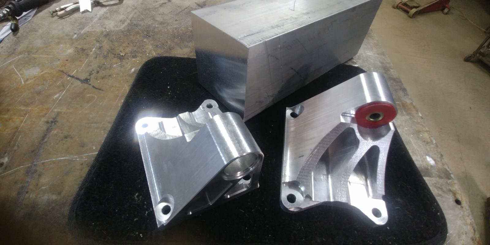

      Passenger side motor mount is machined! One more to go!
      Name:  Fore Motor Mount and Bushing View.jpg
      Name:  Aft Motor Mount and Bushing View.jpg

      Motor Mount Progress:
      Name:  Motor Mount Fore View.jpg
      From the Starboard side looking down.
      Name:  Motor Mount Top View.jpg
      The altitude of the engine and tranny in relation to the ride height and DSE front cross member:
      Name:  Oil Pan And Tranny Just Above Front Cross DSE Member.jpg
      Now Mike will Machine the Port side mount this week and likely make tabs to weld to frame mount plates on subframe.
      Cheers!

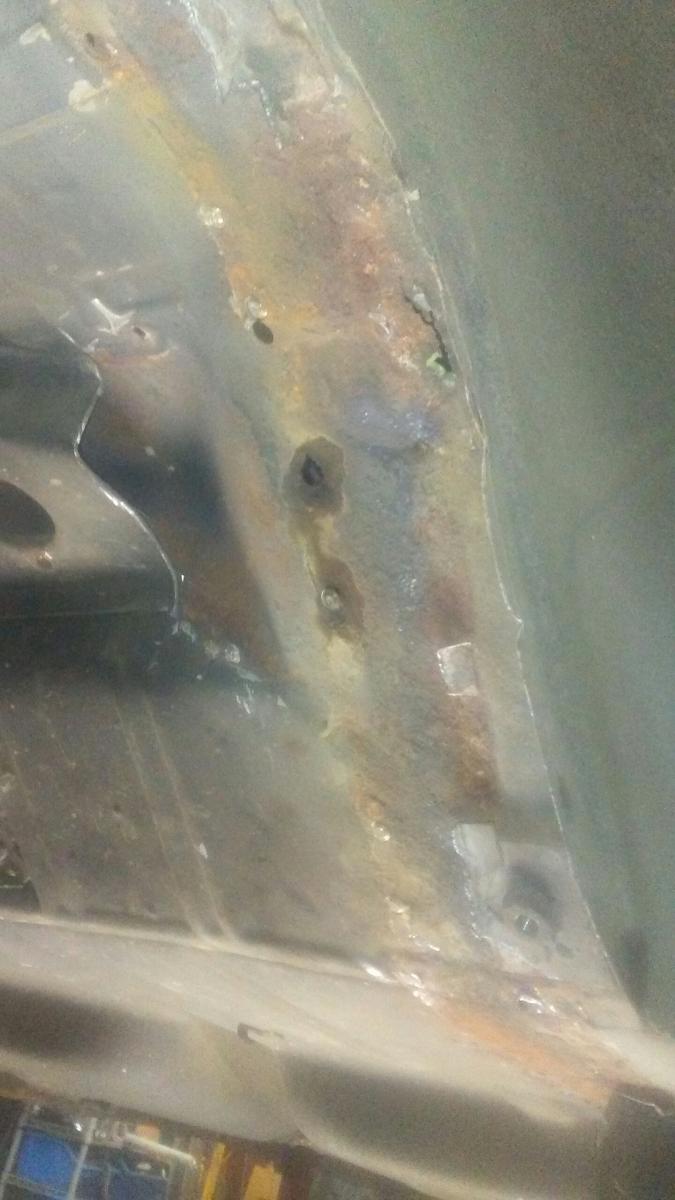

      Nice Clean metal to work with.
      Name:  Third Nice Clean Front Floor Metal Under Rear Frame Rails Close Up.jpg
      Name:  Nice Clean Front Floor Metal Under Rear Frame Rails.jpg
      Name:  Nice Clean Rear Trunk Floor Metal Under Rear Frame Rails.jpg

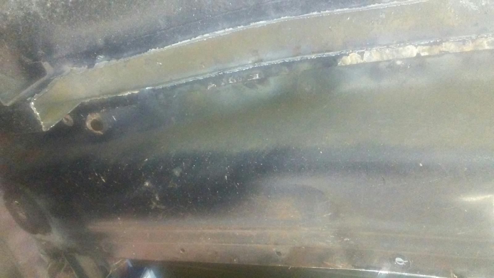

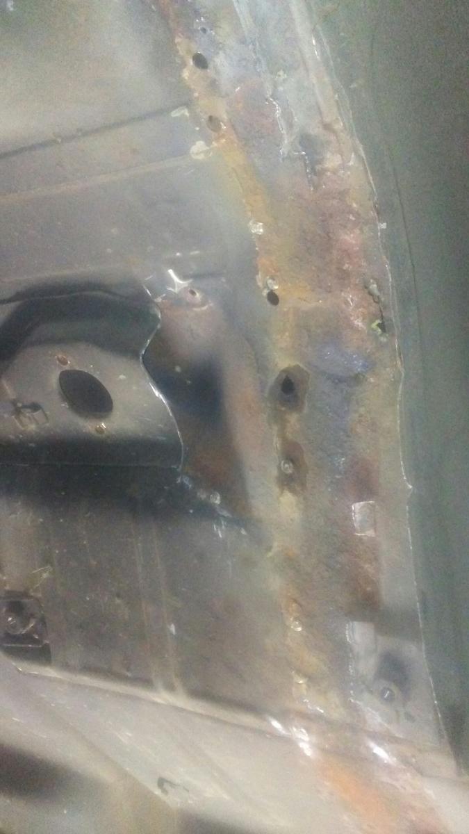

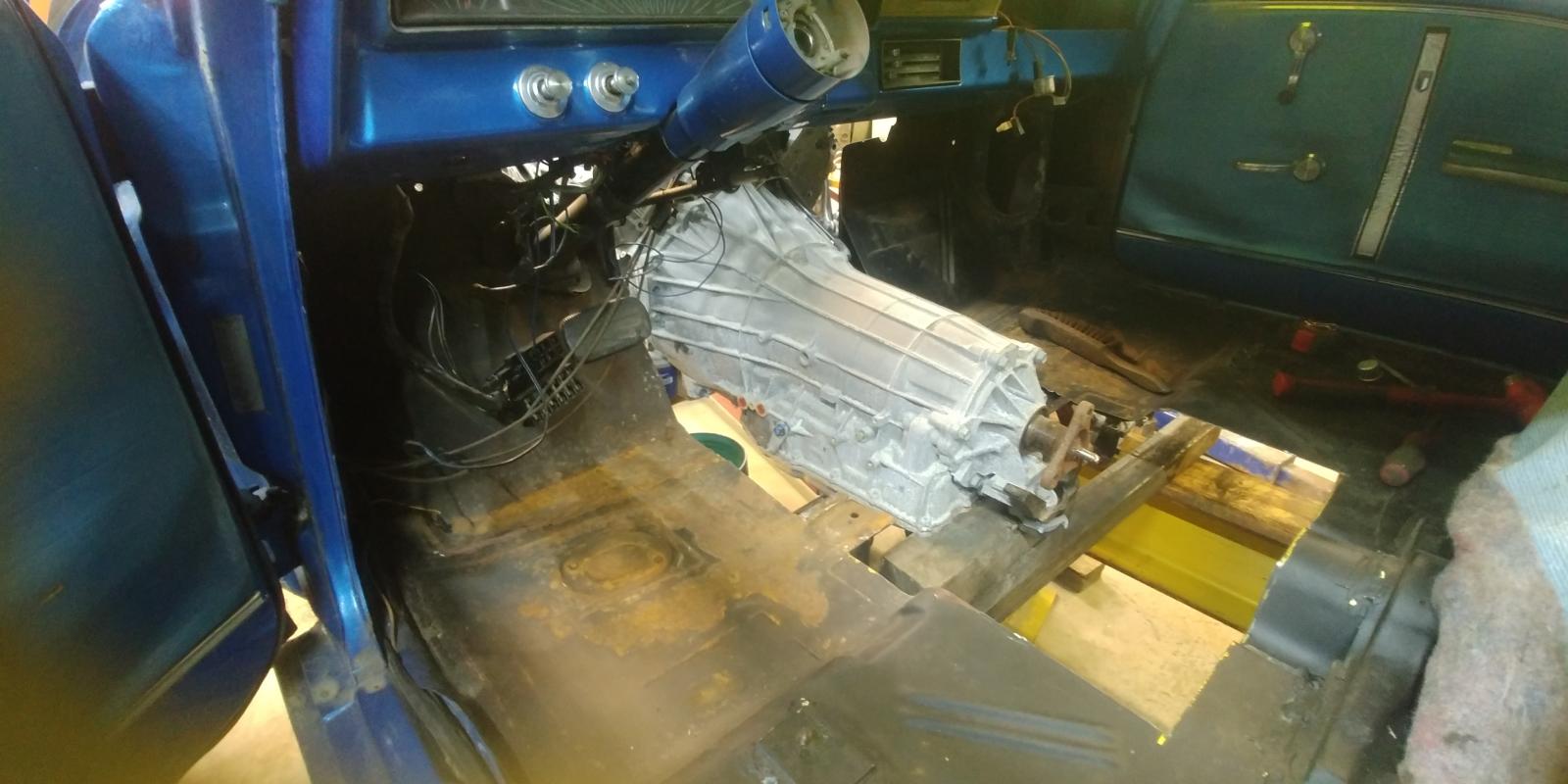

      Interior or car floor metal.
      [ATTACH=CONFIG]160239].

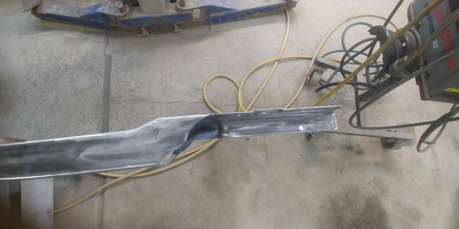

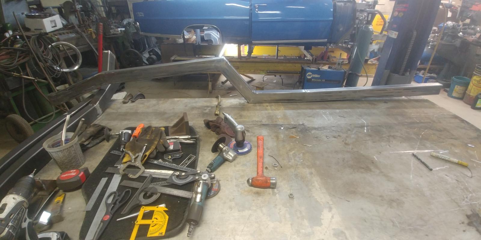

      Mike put a few hours in on the port side engine mount Monday and Tuesday. Pictures to come soon.

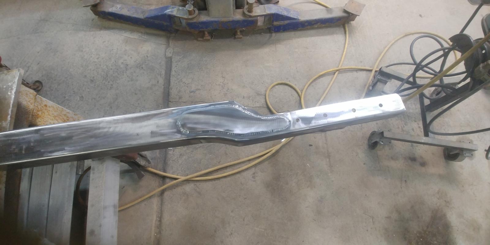

      Progress on the frame rails Monday and Tuesday.
      The frame rails get tied into the front stub mounts, perimeter welded and rail heads that extend into the stubs get plug welded.
      The rails at the rear extend straight to the rear frame member and near the end pickle fork of to the remnants of the factory bumper mount-frame rail.
      These rails should really stiffen up the chassis.
      Goal is to have cross member in with tabs for coil overs and panhard bar in by end of week.
      Name:  Finished frame Rail.jpg
      Name:  Fitting and tacking front of frame rail.jpg
      Name:  Fitting and tacking rear of frame rail.jpg

      Woo WHOO!
      Motor Mounts are DONE!
      For now, will smooth them up and anodize them but use them for now to build the car!
      The block in the background is what each of these mounts are whittled from.
      Name:  Pair of Motor Mounts.jpg
