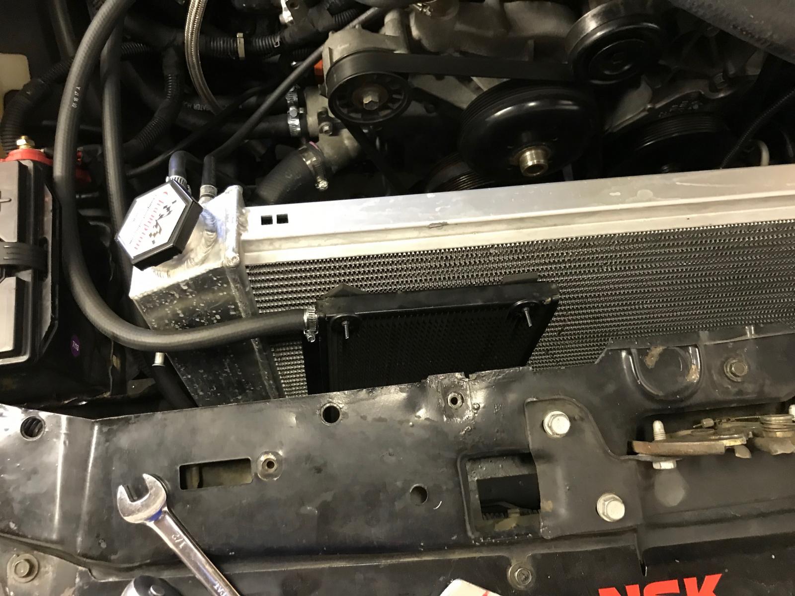

      Power Steering Cooler and Trans Cooler installed.
Size:  237.8 KBName:  IMG-2255.jpg
      Installed a plate and fin style trans cooler inline with the cooler in the radiator, fluid will go to radiator then to the external cooler. Also installed a rather large power steering cooler i had laying around.
      still room for an oil cooler down the road if i so choose.

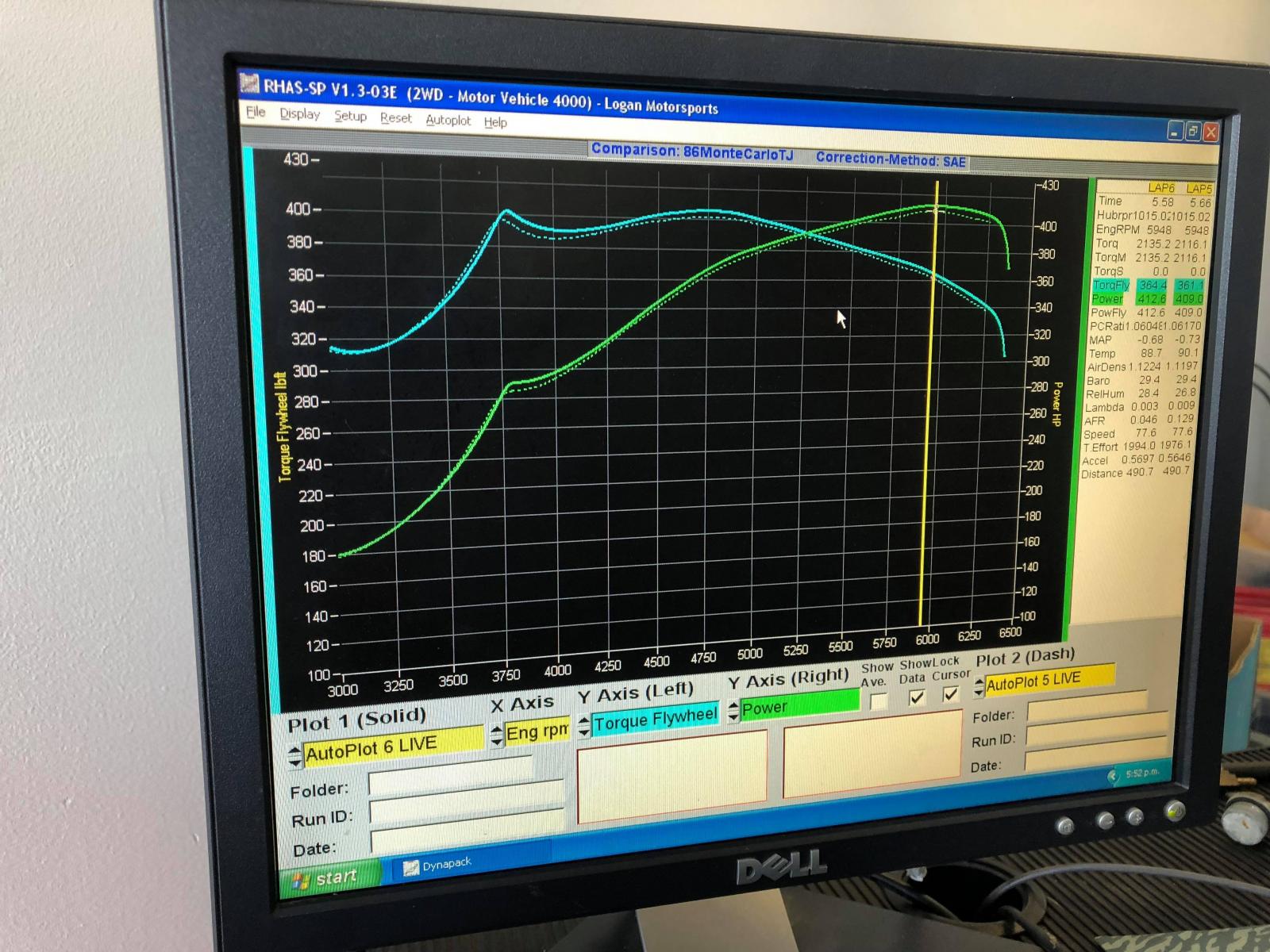

      New exhaust and cam
      Installed the summit stage III na cam
      231/242 .600/.600 113+3 LSA
      Then installed a 3 inch stainless exhaust
      Tuned it up and tossed it on the Dyno
      412 horsepower and 408 ft/lbs at the tire on a dynapack Dyno, with 185 degree water. No cooled down glory pulls here, hot right off the street.
      I'm really happy with it considering I only have about $2k in the whole motor. I know people who have spent a lot more to make a lot less power.
