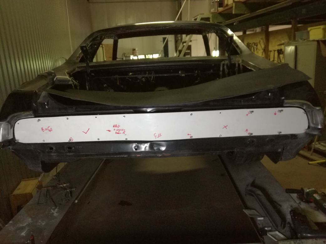

      Small stuff over the past weeks
      Made a template for the plate i am going to place over the lights in the back.
      In the middle a black mustang fuel cap from scott drake will be placed.
      Removed the drip rail today,still need to work on it for a smooth transition,but i already love the look on the car without them!

      Quick peek at the layout and style of the plate i made to cover the lights to give it a 'cooler and darker' look. (dark see trough plate).
      Need so finish some small details and then its done.
      Tested a few lights yesterday and it looks good!
      Mustang fuel cap for styling in the middle and offcourse to fill it up...
