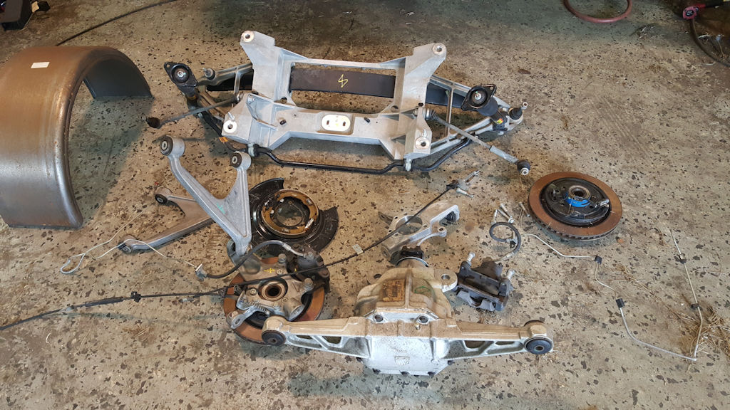

      · A complete front and rear C5 suspension with brakes. These were originally planned for my 70 Camaro but now I want to make them work in this car, if possible. I have literally had these for 15 years...

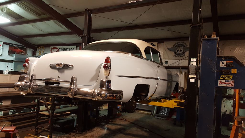

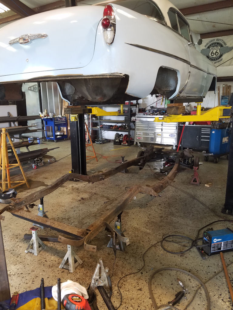

      So I got the car up on the lift to look it over. Very solid car except for rot out at the rockers and the lower quarters. I can fix that later. Doors open nice, windows work perfectly, hood, trunk, and door lines are pretty good. All good news. On with the plan. The first thing I did was pull the gas tank, wheels/tires, rear axle, and leaf springs off the car. These are all things I don't care about but might be worth something to someone else. I also unbolted the entire front suspension. I had no clue these cars had a removable subframe up front, separate from the frame. It made it really easy to drop out as an assembly.

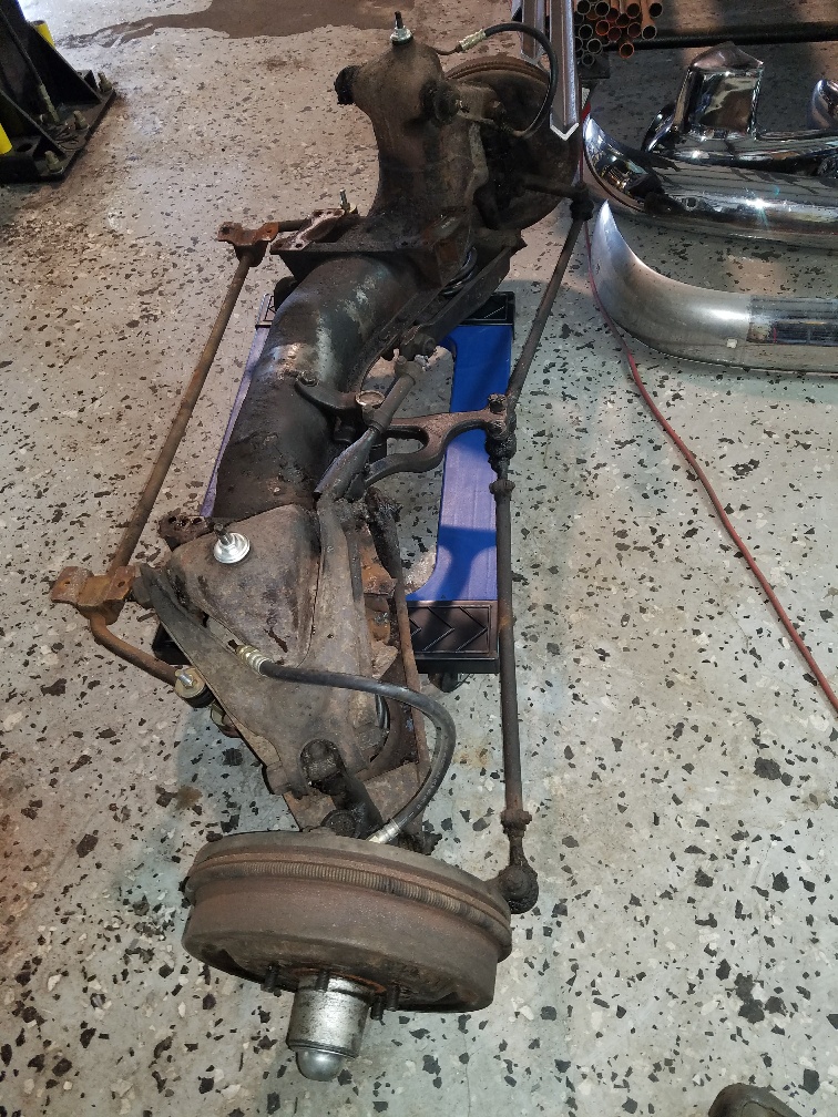

      I began looking over the rear end and it was actually pretty nice. Somebody had put a 55-57 rear in the car which back in the day was a major upgrade. They also spent time sand blasting and painting it with some real deal paint, not just a rattle can job. It had new brakes and what looked like a new yoke as well. Not a posi though. Listed this on Craigslist and got $200 for it 3 days later.
      No luck selling the other parts yet...

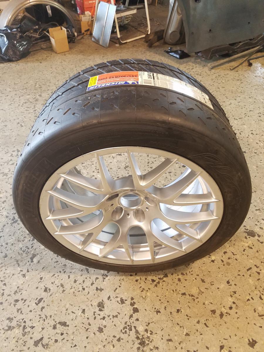

      One of the first things I really need to start mocking up the rear suspension is wheels and tires so I can establish my overall track width. I really didn't want to spend $1500 each for high end wheels if possible. So I started looking at BMW wheels (they share the same bolt pattern as GM) because they are very inexpensive and have a lot of design options. I knew I wanted 19" wheels for a specific tire I wanted to run and 9.5" wide wheels are pretty common in the BMW world. I settled on the wheels below for $680 shipped, you just can't beat the price with any other option. This wheel choice may polarize my followers because it is not a nostalgic type wheel but I am hoping they will look good on the car and if not, for the price, I can always change them later if I don't like them. I got the idea from a car Mark Stielow did a while back using very similar wheels on a 69 Camaro build.

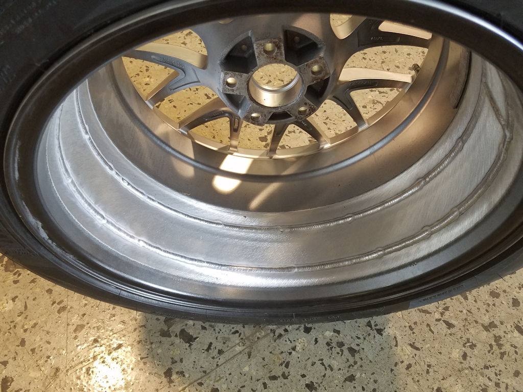

      Once they came in I immediately shipped two of them out to Weldcraft for widening. And they did an awesome job. For $250/wheel I now have 12.5" wide wheels for the rear. Weldcraft splits the wheel, machines the face, welds a widening band then measures and adjust for runout. Being in the fabrication industry myself, $250 per wheel is a bargain for the amount of work that goes into them.

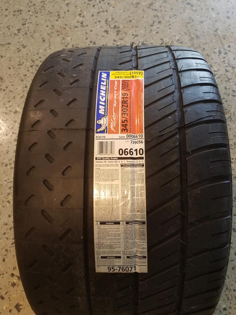

      One of the reasons I really wanted to run 19" wheels is so I could use readily available Dodge Viper spec tires. There are a lot of guys road racing Vipers so many of the manufacturers offer competition tires in these sizes. Michelin recently changed their tread pattern on the Pilot Sport Cup so a lot of tire warehouses have the older tread pattern in 345/30ZR19 discounted. I picked up two brand new tires on Ebay for $500, almost half price from what they would normally cost.
      The fact that these large wheel and tire combos only required less than 2oz. to balance is a testament to Weldcraft's quality.

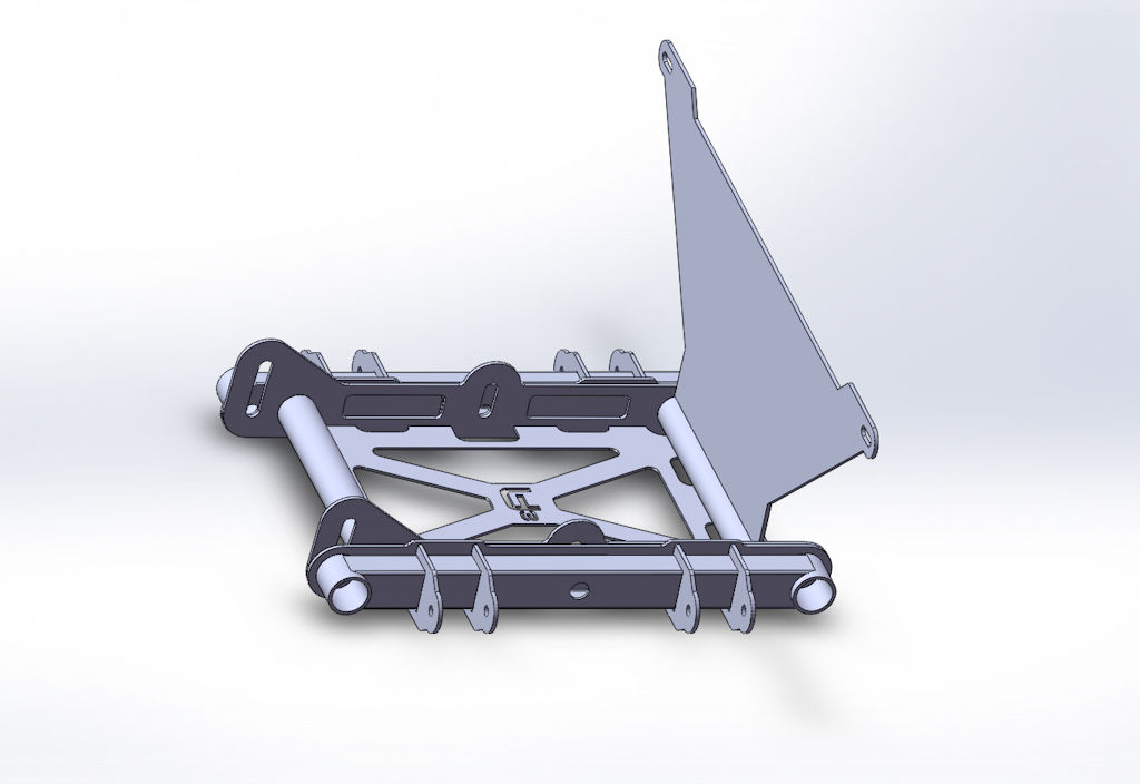

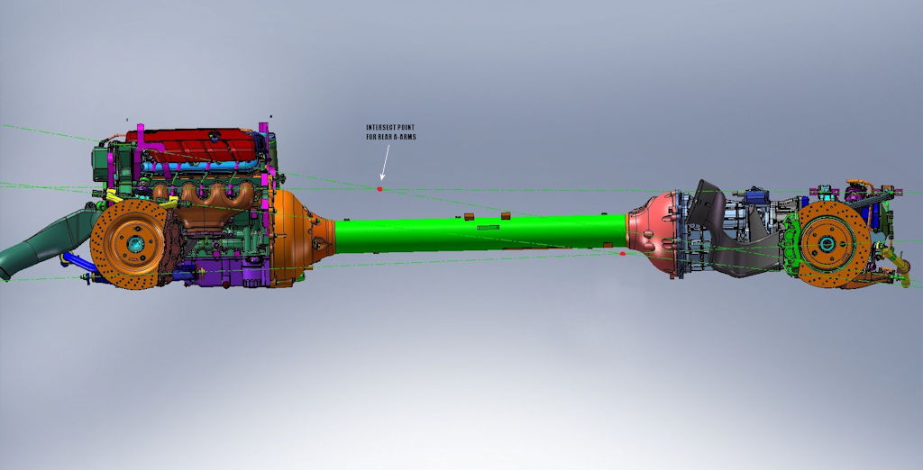

      My plan for the rear suspension is to design a removable cradle that will attach to full length frame rails. I am hoping this will allow me to design and plot out the suspension mounting points on the computer before even building anything. After a lot of research I obtained mounting point locations for the C5 A-arms and toe rods and just had to adjust them inward to compensate for the narrower track width of the 53 Bel Air (vs. C5 Corvette). To tuck my tires the track width had to be narrowed 4.5" overall. With my X, Y, and Z A-arm mounting locations plotted for the lower A-arms, I drew up the lower part of the cradle where the A-arms would attach. Rather than just assume that the OE designed "instant center" for a C5 Corvette would work for this application, I made the lower A-arm mounting points adjustable. When viewed from the side of the car, the imaginary triangulated intersect point of the upper and lower A-arms create the "instant center". This is essentially the lift point of the rear suspension which dictates how well the car transfers weight during acceleration. Since at this stage of the build I can't really know the "sweet spot" for this car, I am just making the lower A-arm mounts with adjustability for instant center.
      I found an image online showing the intersect points of all 8 A-arms. This gives a good visual of how A-arm angles effect these points.
      The picture below shows the beginnings of a rear cradle. Three 5/8" bolts will locate the lower A-arm mounts and I have adjustability from horizontal up to 6 degrees of angle. The large rear plate in this image won't be used, I was just using it as a reference to locate the upper A-arms.

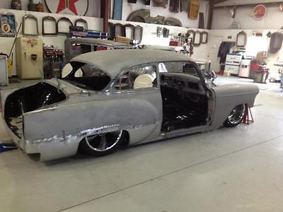

      I was playing around with Photoshop (not very good at it, btw) to see what the car would look like at the height I want, with the wheels I chose. It's not the greatest chop and I probably have it a little too low for realistic driveability but I am kind of liking how it looks. I think I would want a little bit of a rake to it too...

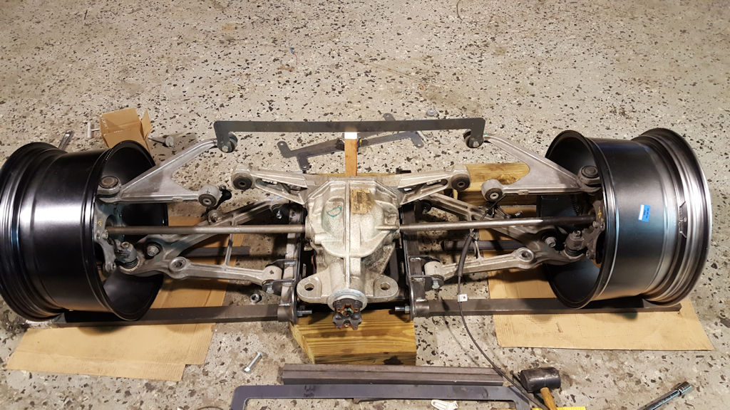

      Well, this is what I have to work with. The Viper diff is much bigger than the C5 diff that normally occupies the cradle. Upon first observation, the large mounting ears on the Viper diff look like they might possibly interfere with the upper A-arm mounting points but it's hard to tell at this point until I get everything mocked up.
      I started by fabricating the base of the cradle from the Solidworks model. I have a small CNC plasma cutter that allows me to make all of my plates. It is a huge timesaver as opposed to cutting, drilling, grinding, etc. Once I had the base of the cradle fabbed, it gave me mounting points for the lower A-arms so I could begin mocking up the rest of the rear suspension. I don't have solid models of the suspension components or Viper differential or I might have been able to design the whole cradle virtually. Sometimes I find it easier to design with parts laid out in front of me in the "real world" anyway. I am using the front wheels (they have the same backspacing as the rear) to hold the spindles into position which also lets me establish toe by simply using square tubing on the floor to "parallel" the rear wheels.
      Once everything was assembled there was nothing to hold the upper A-arms and spindles upright so I made a couple of temporary floating mounts to hold them up with a 2"x4". By rotating the spindles to zero caster and shimming the 2" x 4" I was able to get the arms positioned close enough to where they need to be so that I can start figuring out the upper part of the rear cradle and locate the differential. I also made some "fake" axles to give me a visual when positioning the differential.
      If at all possible I do not want to intrude into the rear seat area. From what I can tell so far I should be able to make a cradle that will clear the rear seat but it will definitely be close...
