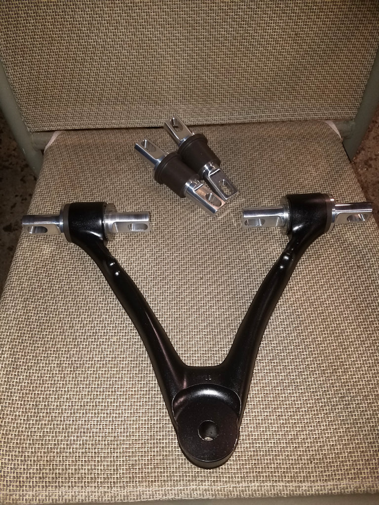

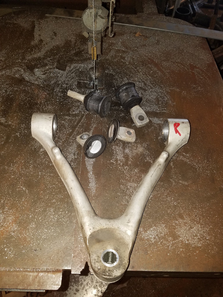

      Well, I started to design the lower control arm mounts but it was pretty much a fail. I thought I could build a cage to tie all four mounts together then connect them to the frame rails with two vertical uprights on each side. While I did get a few measurements wrong (holes don't quite line up and rear bushings contact the main tube of the cage), the main problem is oil pan clearance. Most subframes I see do not connect the rear of the A-arm mounts together with any type of crossmember, to allow room for the sump of the pan. I really wanted to do this for strength but it would force me to move the motor back like 8" (more than I want to) so back to the drawing board...
      My next plans will be to make a 2" x 4" main dropped crossmember, biased towards the front, and tie my inner A-arm mounts to it then run some low-profile gusseted plate brackets down from the frame to catch the outermost A-arm bushings. This will be plenty strong and may even allow me to run the 8 quart LS3 pan I have...fingers crossed.

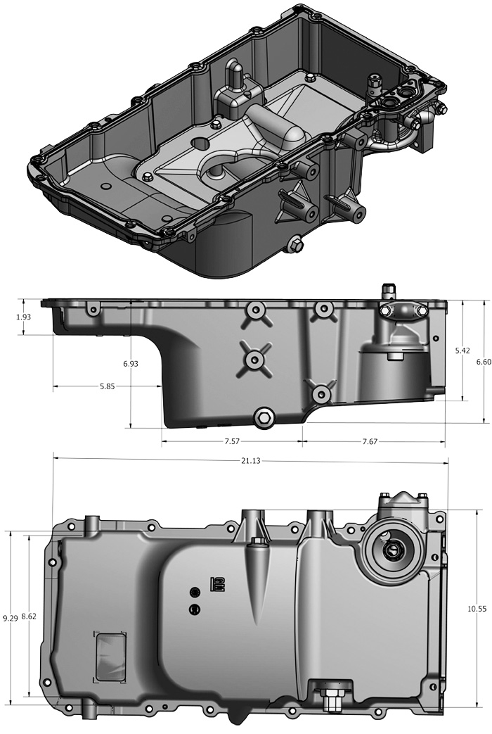

      Looking good. I used the Holley oil pan which gives more clearance, but only holds 6 quarts. As far as the front wheels, I'm running 275's on corveete 18 x 9.5 on front with a stock front end width + 3/4" for the C5 brakes. I don't contact the fenders, but I rolled them out slightly. Added about `1/2 " or more per side and you no one has noticed the fenders being rolled. Soon I will see how it works with the C5 front suspension. I believe the stock front width to the back of the wheels is 56" but I never measured it.
      That's good to hear. If you have 275's on yours as is and are at 56" I should be looking good at 54" for possible 315's...maybe. Fingers crossed.

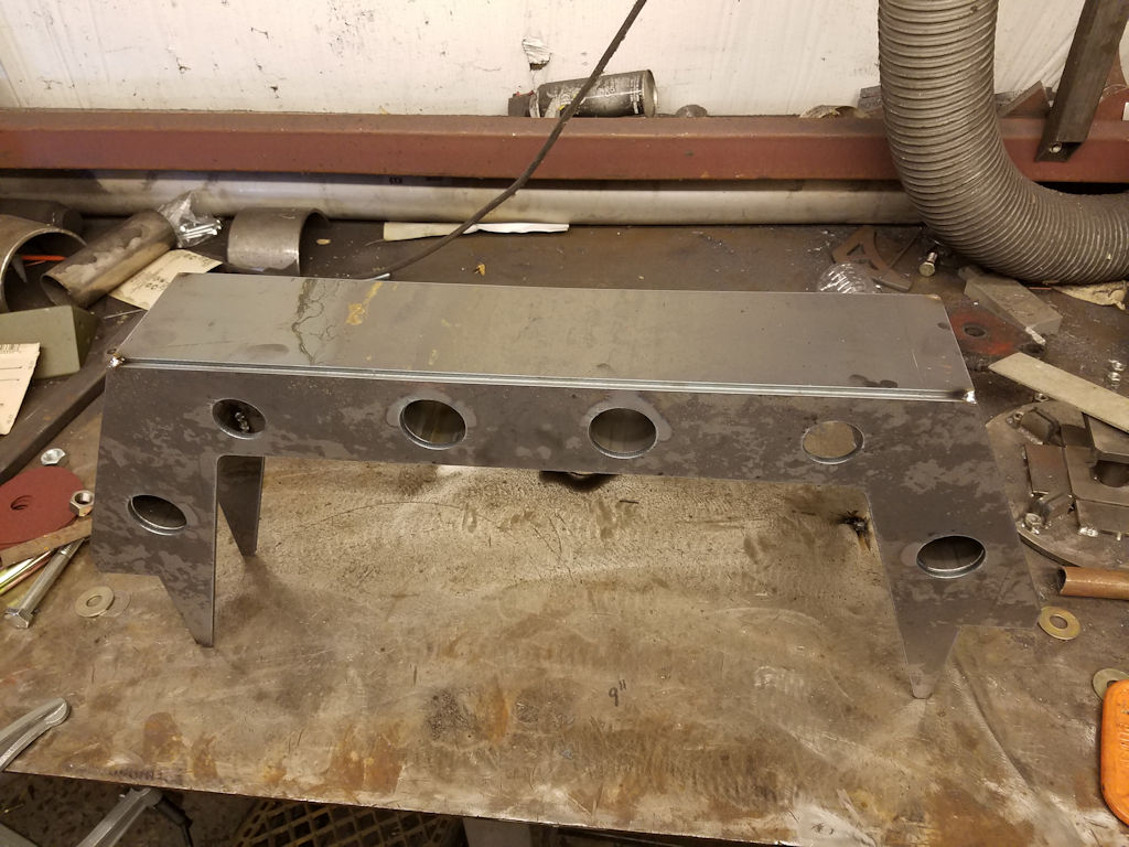

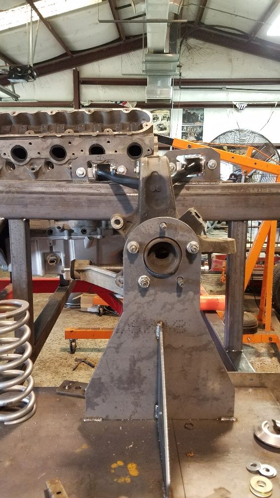

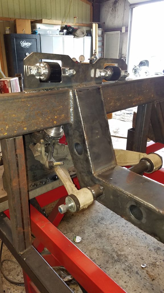

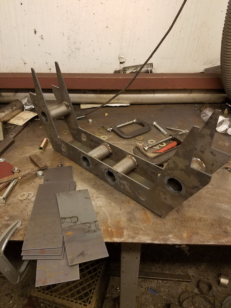

      Not much of an update but here are some pics of the new crossmember I am building. This will have two heavy wall tubes that go through it to capture the inner sides of the lower A-arm bushings. Since it is a structural member that will see most of the A-arm load, mount the rack and support the motor I am putting internal gussets inside. 3/16" vertical plate with 1/8" cap plates.

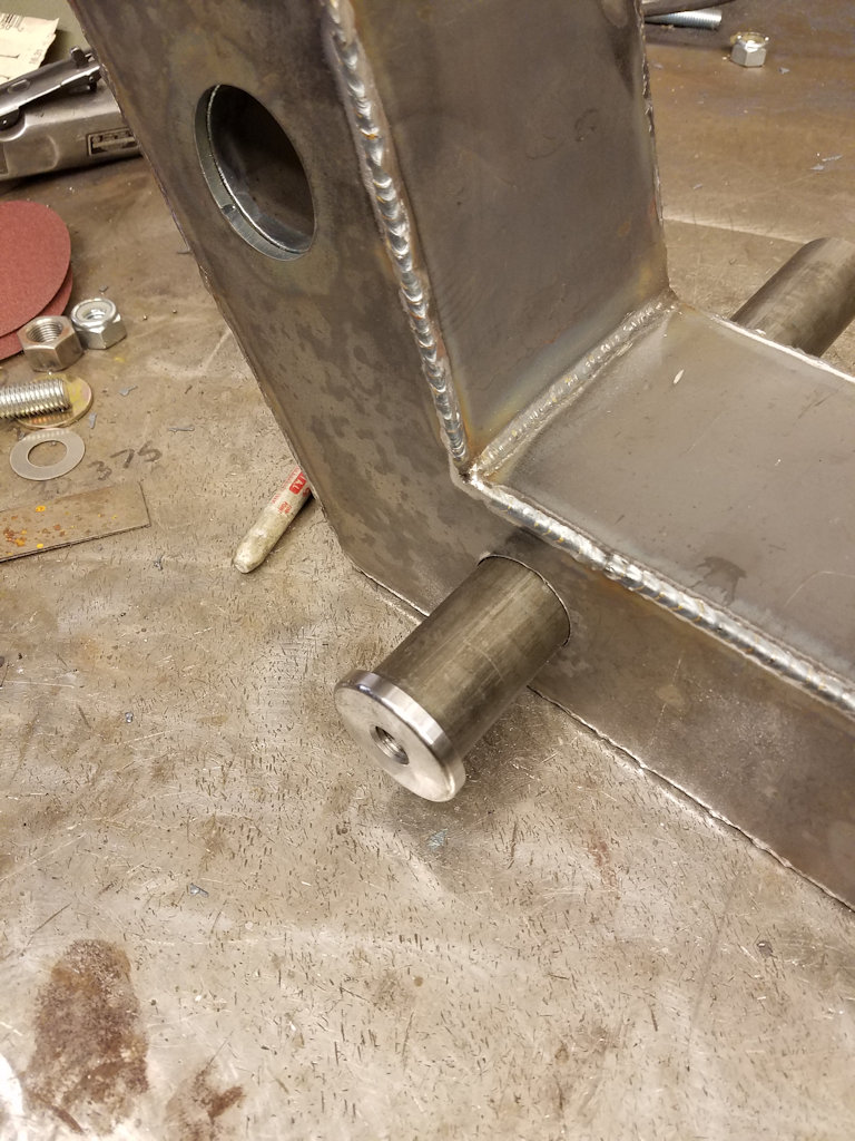

      I got a little more time to work on the front crossmember and suspension this past weekend and it is finally starting to look like something. After using what felt like half a roll of welding wire I got the front crossmember welded up and tacked into position on the frame rails. Since my wheel position is fixed, the lower control arm mounts pretty much "self-position" front-to-back once my target caster setting is established.

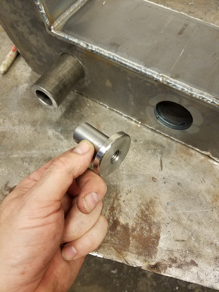

      Then I took some 1-3/8" x 1/4" wall DOM tubing for the lower A-arm mounts. I had these 14mm threaded inserts that just so happened to fit snugly into the tube which worked out nicely as they have a large thrust flange for the bushings.

      With the lower A-arm positioned I started figuring out how to mount the upper A-arm and coil-over. The upper arm mounts at an angle tilting upward back-to-front, around 6-7 degrees. This matches the OE caster angles of the spindle which is where I am setting the center of my caster adjustment. I designed an upper A-arm mount with slotted holes to allow extra caster adjustment. Once I cut out the plate and put it in place I realized that I was going to have a problem getting negative camber. The C5 suspension forced the frame rails to be narrower than I was expecting so I cheated it a little by offsetting the A-arm mounts inward to keep my frame rails as wide as possible. It was easy to do on the lower A-arm mounts but the uppers are hanging the mounts off the frame rail on the inboard side of the rail. After spending too much time trying to figure out how to make an offset upper mount I came up with an easier solution. If I mount the arms on the inside of the mounts instead of the outside I have all the camber adjustment I need. The only problem was the mounting shafts in the bushings. I would have to slide them through the mount then weld the mount in place which would make the arms unserviceable and "locked" onto the frame. The easy solution to this was to order a set of Delrin upper bushings. Companies like ridetech, Van Steel, and Pfadts make them so the inner mounting shaft easily comes out by removing a C-clip. This will allow me to slide the arm through the mount and then install the mounting shafts. And of course it will also eliminate the deflection in the upper A-arms by removing the soft rubber bushings. I will probably upgrade all of the bushings to Delrin eventually.

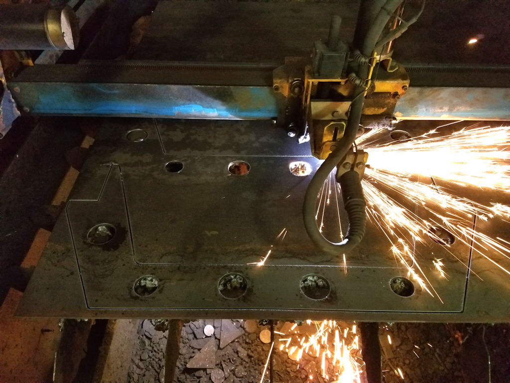

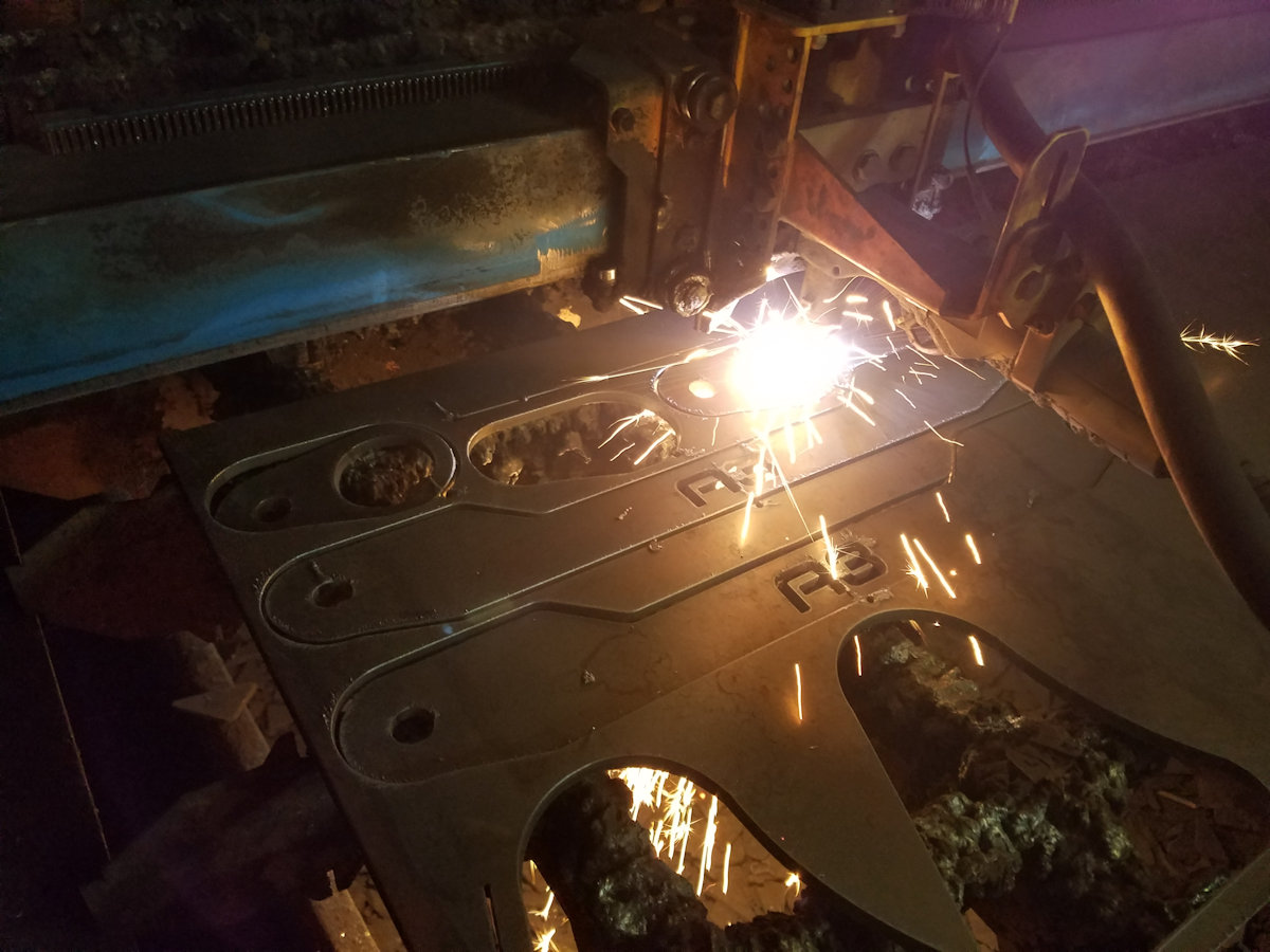

      Looking geat. Got to say, I'm jealous seeing the plasma table going. I have to get one, some day. What size is your table? Back to your project, front suspension looks great, it will work great!
      I honestly don't know what I would do without the plasma table. I can't even remember what it was like sawing, drilling, and grinding everything. It's just a 4' x 4' table but it has more than paid for itself over the 10 years I have had it.

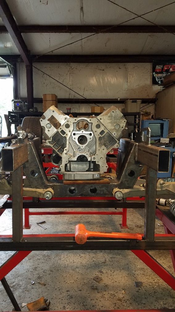

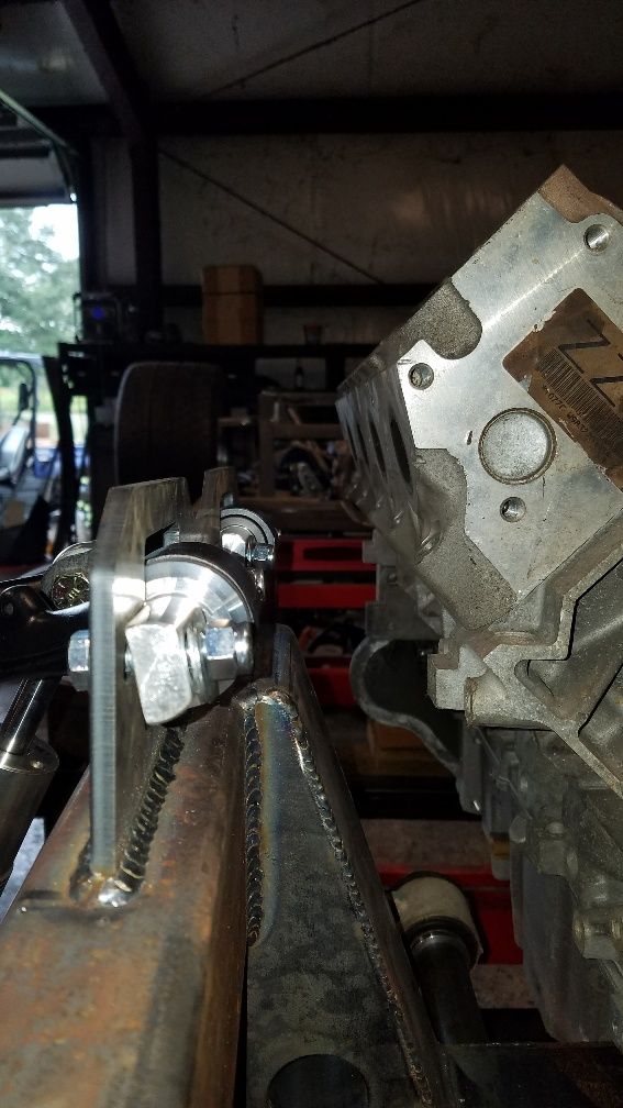

      Ok. I knew things were going to be tight using long Corvette A-arms in such a narrow chassis but I think I just ran into my biggest challenge yet. I put the LS3 pan on my mockup block, bolted the 6 speed to it and lowered it into the chassis to begin making motor mounts. I am really happy with the fore/aft position of the motor in relation to the suspension and I like where it sits heightwise once I got my driveline angles established. But what I immediately realized is the lack of exhaust clearance between the head and frame rail. This is going to be fun.
      Just for the heck of it I tried every manifold and header I had to see if they would work but nothing is even close to fitting in such a narrow area. I don't want to raise the motor so it's looking like I will be building custom headers.
      Also, I was planning to run a stock accessory drive with A/C but there is not enough room for the compressor on the passenger side. Again, I am not compromising the low center of gravity and raising the motor just to accommodate an A/C compressor. And I really don't want to spend money on an aftermarket accessory drive so I will probably be notching my newly finished crossmember to make the compressor fit where it is supposed to go.
      Fortunately none of these are impossible problems to overcome and I am really happy to finally see a motor sitting between the frame rails.

      This is almost exactly where the motor sits on a C5/C6 Corvette in relation to the front suspension. I can't wait to see how much this interferes with the firewall
