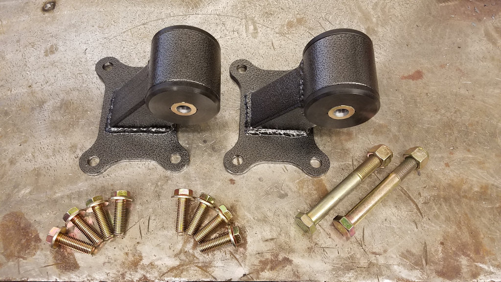

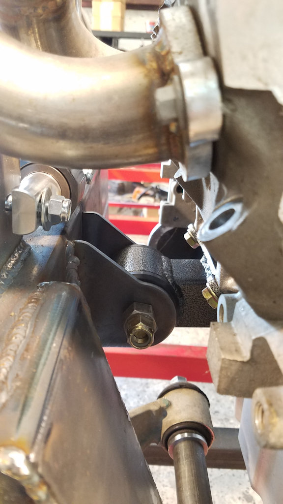

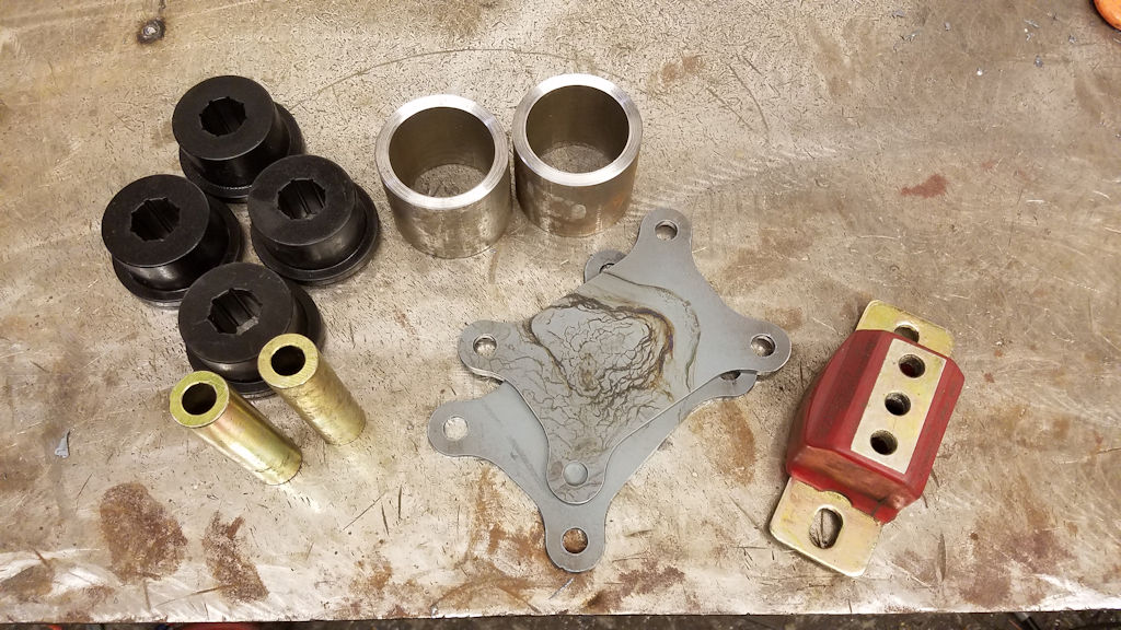

      I like the motor right where it is, despite my header problems, so I double-checked all of my measurements and then made motor mounts. These were some 2.25" polyurethane bushings I had lying around from some project years ago. Transmission cross-member next!
