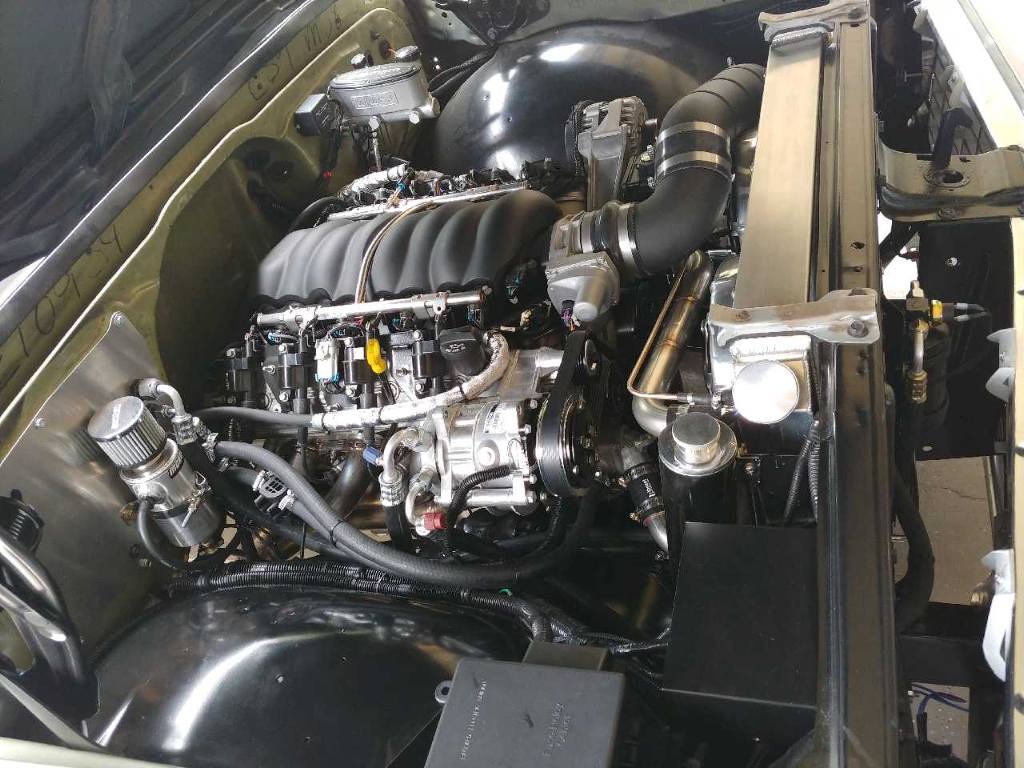

      For the engine i have a 5.3 i picked up with 70k miles on it out of a 2008 suburban, it has 243 heads and a trailblazer ss intake so im hoping i can use those with the set up i want. My plan is to get a rebuild with a good cam and some head work and run it. For the transmission i am looking towards a 4l80e. But before i start that i have to finish the suspension, get the brakes lines done, do some frame work, mount the fuel cell and get the wiring done. I will keep you guys updated as i go, if you have any questions feel free to ask thanks!
