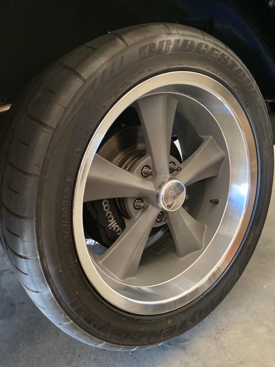

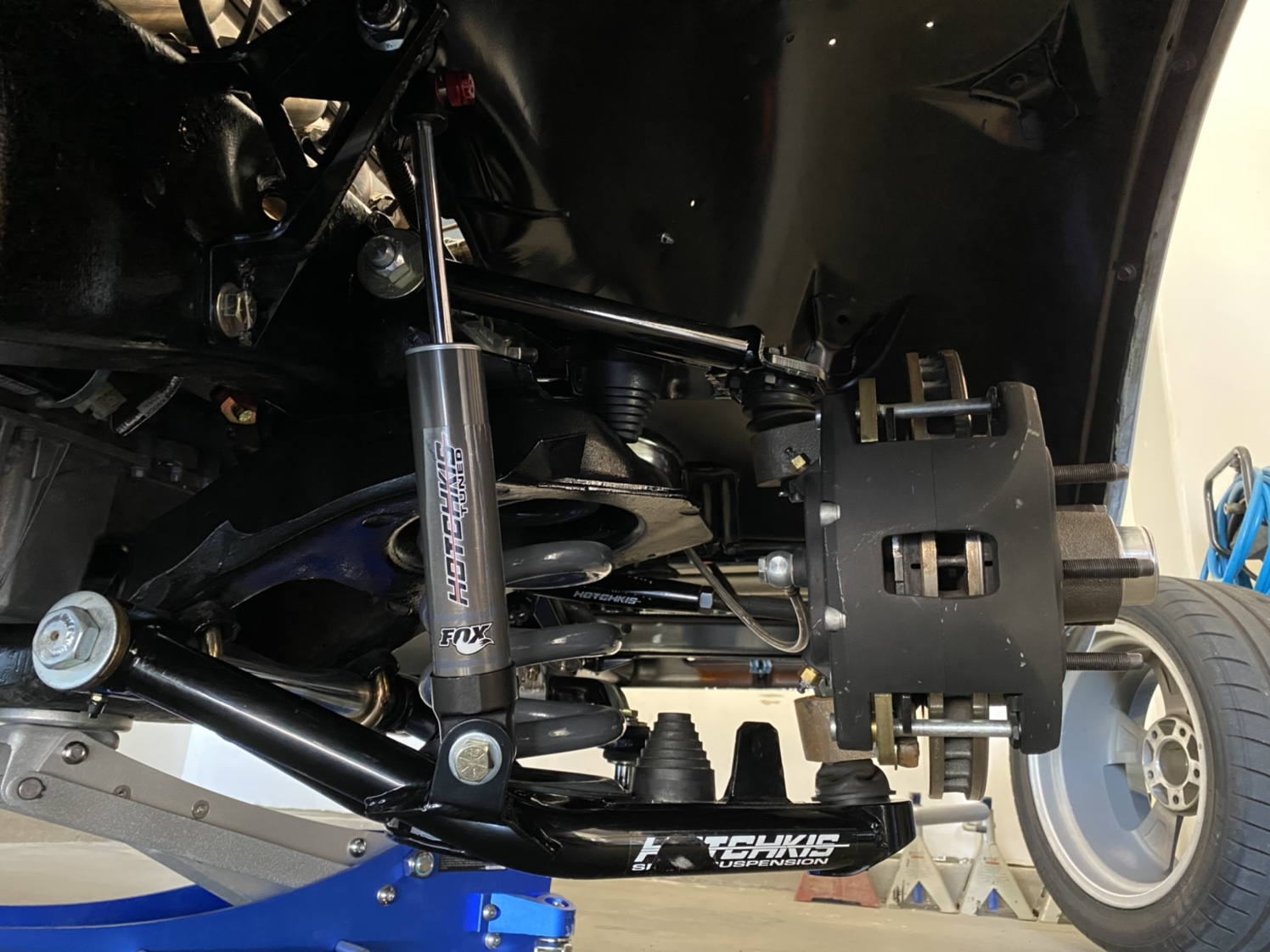

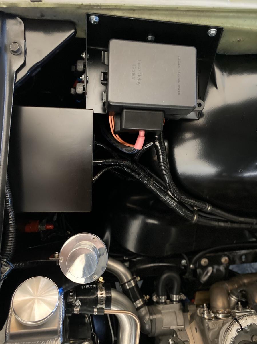

      Haven’t posted in awhile. Got a bunch done
      -Motor and trans installed and tuned. It’s a Ls376/480 with a bowler t56. Everything is wired.
      -Everything except the exterior is painted or powder coated.
      -interior done (seat, gauges, stereo, carpet, dynamat)
      -suspension done (hotchkis tvs)
      -exhaust done
      -bed painted under neath and tubbed.
      Almost done! Just have to get the bed bedlined, some small stuff buttoned up and it’s getting painted then it’s finished.
      Thanks guys

      This is looking awesome. I thought you had finished the truck by now and forgot to update. Question: What is that below your dash, below the heater control? I think it says battery on it?
      Jan 2016
      Arizona
      169
      Quote Originally Posted by kmc3420 View Post
      I wish, I don’t always have the funds so I do what I can when I can. It’s about there. And that’s a battery cut off switch. And thank you!

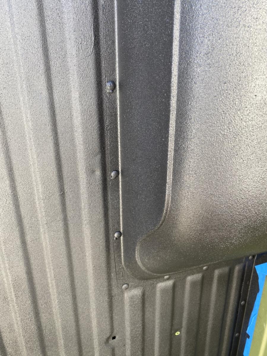

      1972 C10 Build
      After putting it off as long as I could before summer, I got my Bedliner done. It was a 2 day affair just getting the stuff on evenly everywhere, just have some small areas to clean up but over all not bad looking for roll on and aerosol. Now I have to undercoat the wheel wells next weekend and the bed goes on. (Ignore the black on the sides where it looks like bad over spray. That’s where I was covering bare metal with some paint during prep.) Name:  IMG_1473.jpg

      Did you use stock oem trailing arms? If not, will they work with the hotchkis tvs system?
      Jan 2016
      Arizona
      169
      Quote Originally Posted by Fastlife831 View Post
      No I used the ECE trailing arms. I had new sleeves welded into them because the ece arms use different size bushings than stock arms do and wouldn’t work. But now they do work after they were modified.

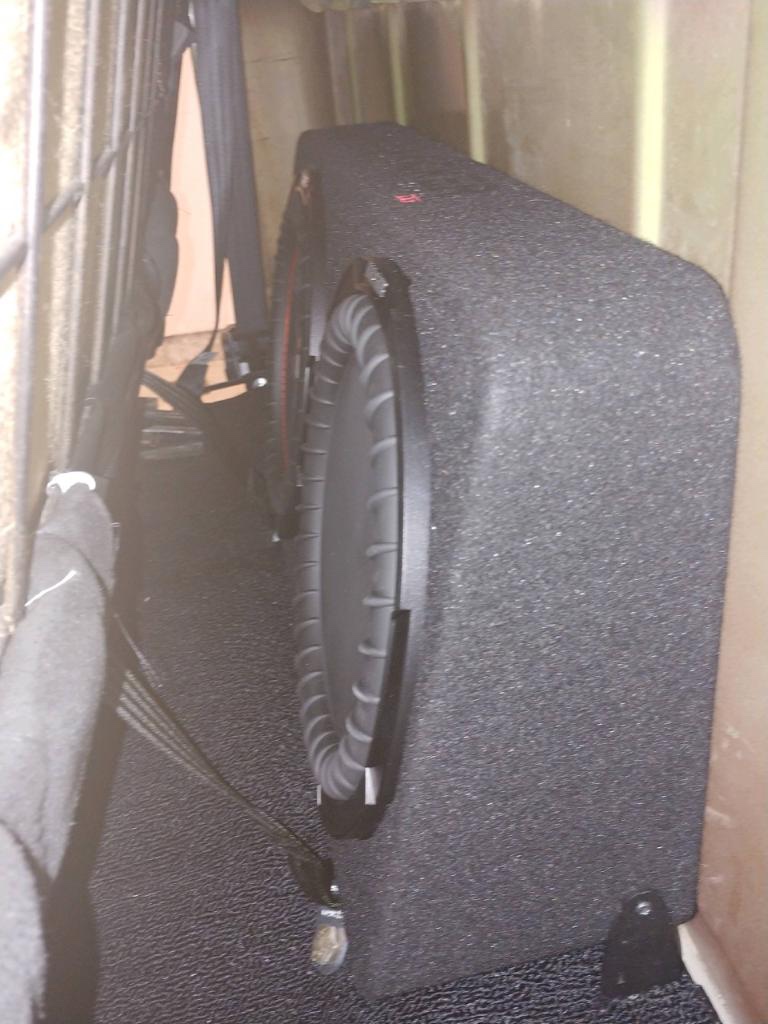

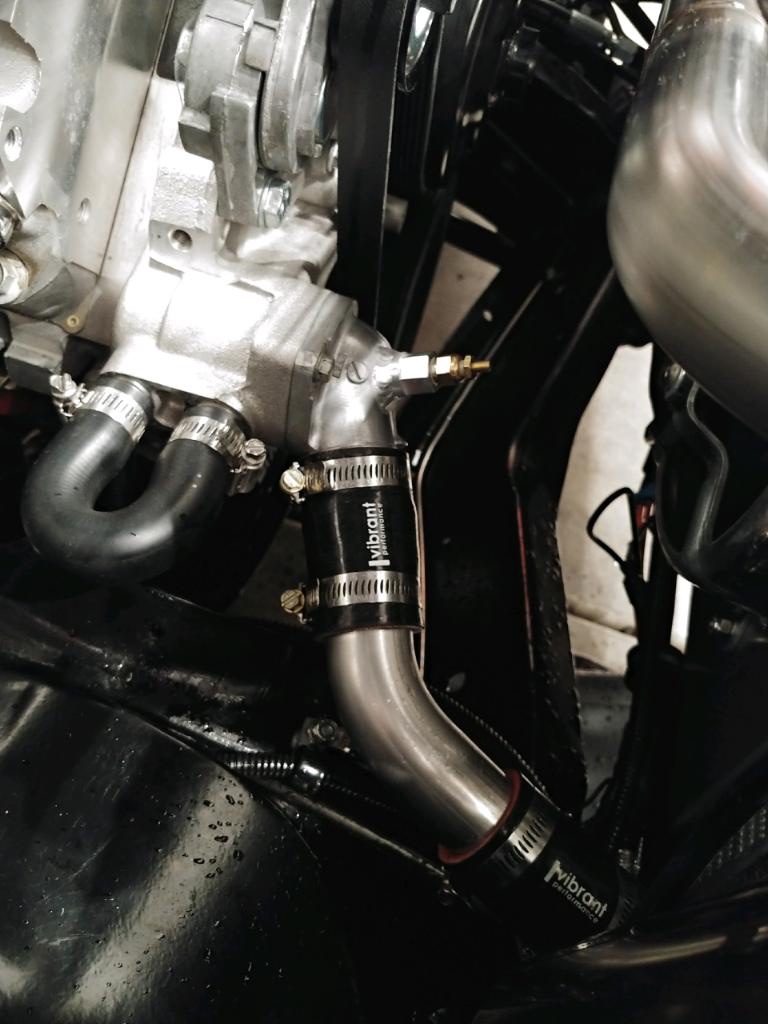

      So I dropped it off to get the final stuff done.
      He fixed my exhaust. So it didn’t hit the driveshaft
      Fixed my temp gauge so it reads correct.
      (There was no more ports in the heads for a temp sensor and the other shop I took it to put it in the radiator. It was 80* off)
      Got a complete kicker stereo installed. With a retro sound head unit.
      Next up getting installed is a vintage air kit and the bed goes on and I can finally take it on the road.

      What bedliner product did you use? I'm considering Upol Raptor Liner for the underside of my S-10 cab, but I don't know if it's worth it. It won't have loads slid on it, maybe just get dirt and rocks thrown at it. Looks like that turned out well.
      Jay
      Jan 2016
      Arizona
      169
      Quote Originally Posted by JayinMI View Post
      Jay
      I used raptor liner as well. Prep it good and take your time.
      Aug 2014
      435
      The kit I'm looking at is 4L and comes with a spray gun. Hope it will be enough. Thanks.
      Jan 2016
      Arizona
      169
      If your doing just the top side of the bed that’ll be enough. If it’s not they have rattle cans at most orielly auto parts stores that are great for finishing it up.
      Good luck
