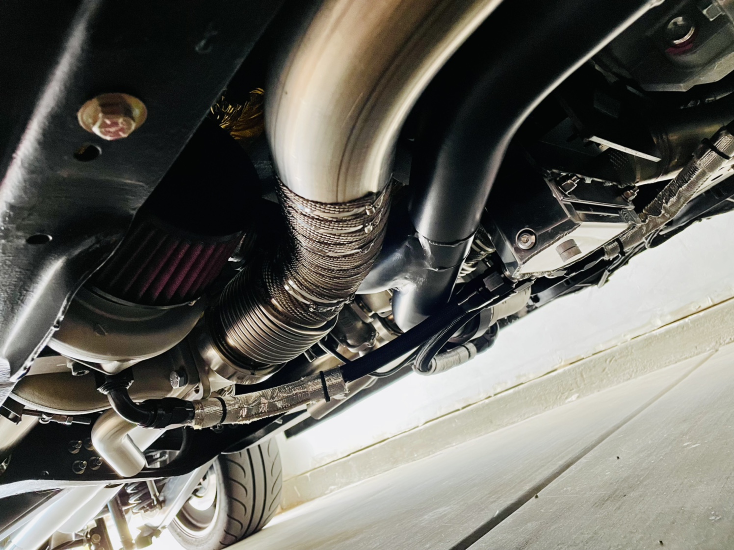

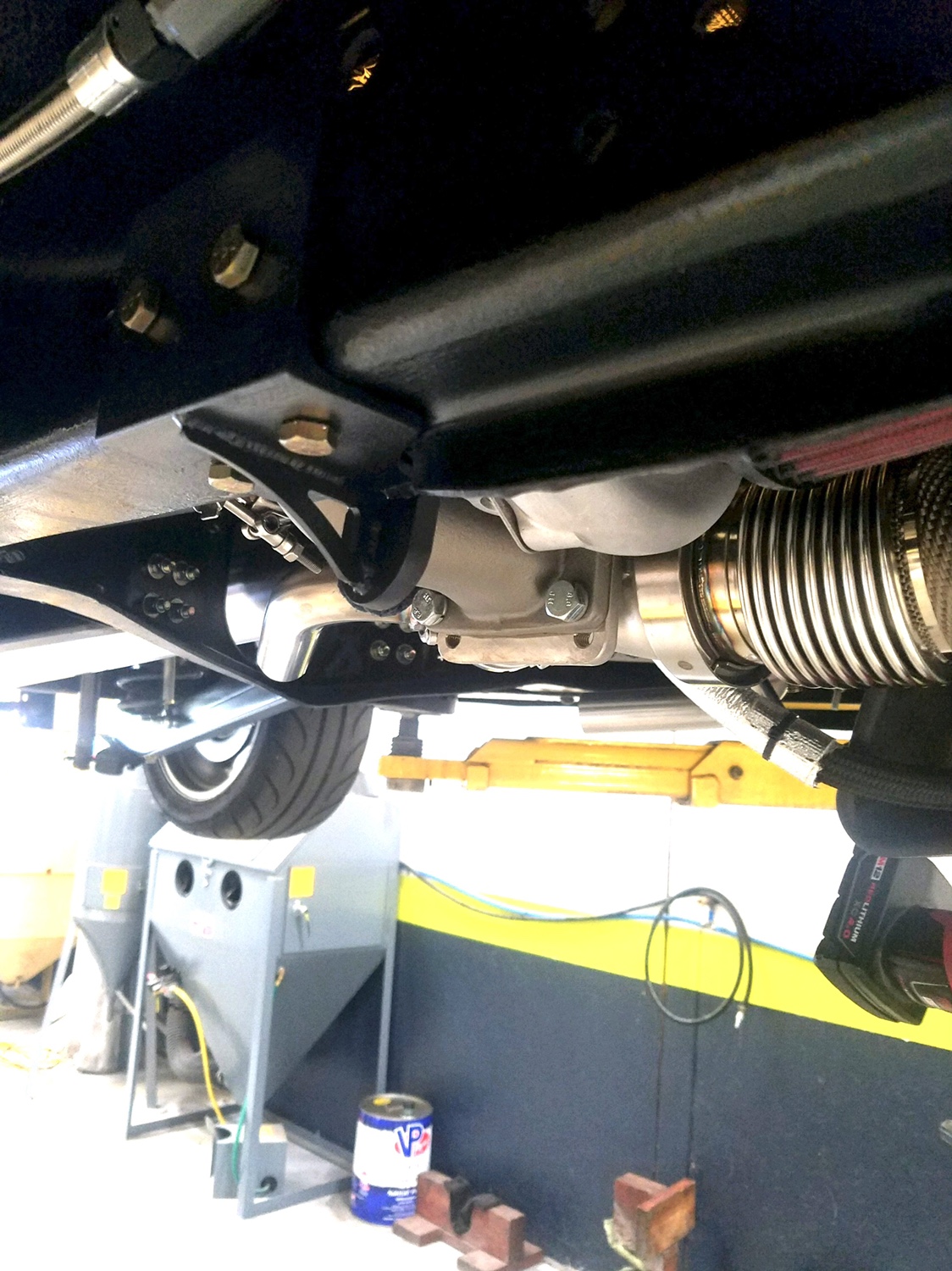

      So after brainstorming with these guys we came up with the solution to control the oil problem
      We put a check valve in the oil return line after the scavenge pump, put in a sump tank, made new return lines , and also put check valves in the oil feed lines. So far no oil issues. Put some miles on it today and no smoke or oil seepage. And to help control the heat I got the exhaust housings ceramic coated. Name:  IMG_8646.JPG

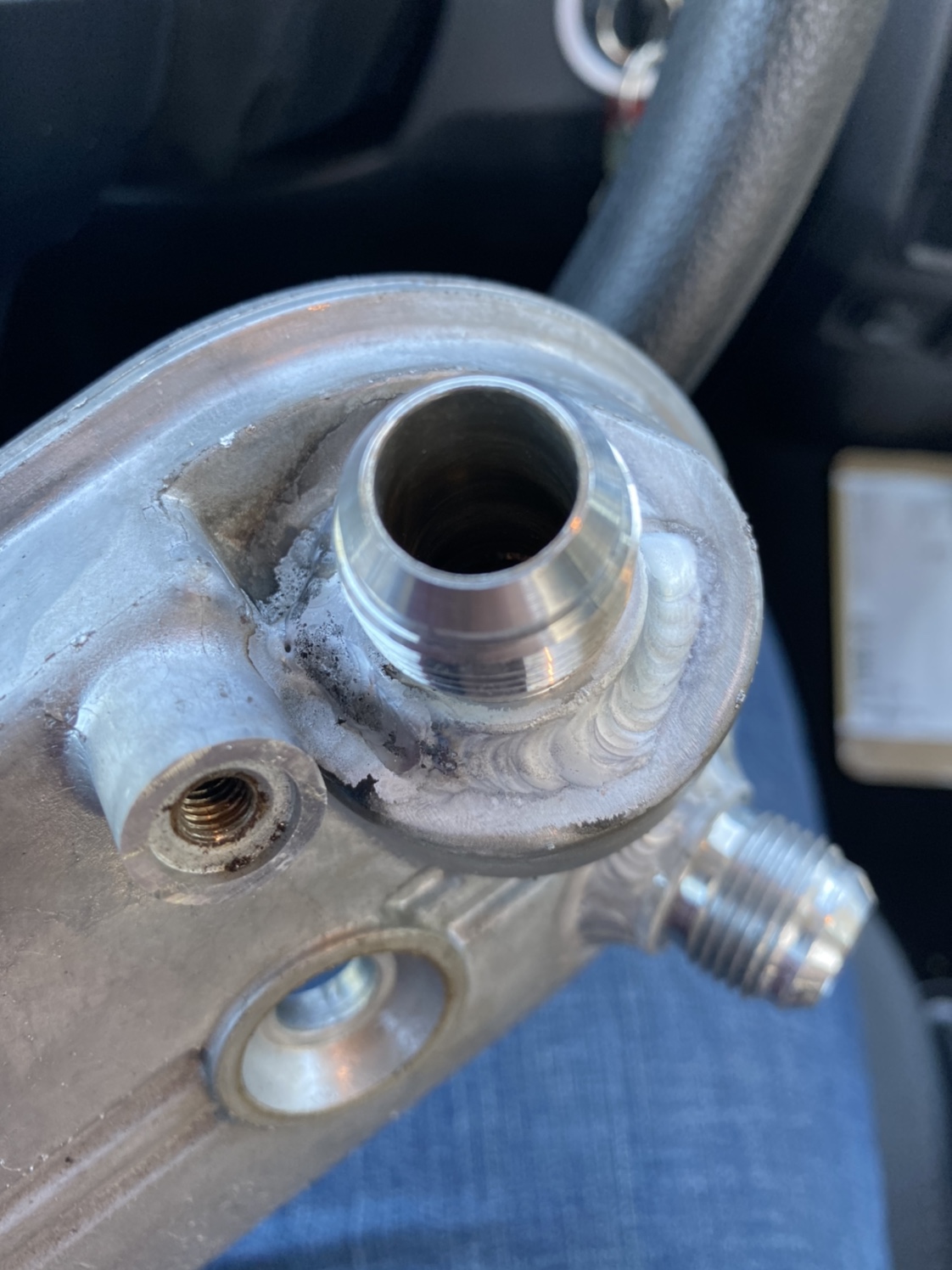

      Now I am working on venting the crankcase. The single catch can I have with the little lines aren’t going to work, it was good enough for the stock engine but not now. So I am now running two moroso catch cans with a -10 to each valve cover. I’m getting the fitting welded this week and will make the other line. Just trying to perfect it as I drive it more.Name:  IMG_9118.JPG

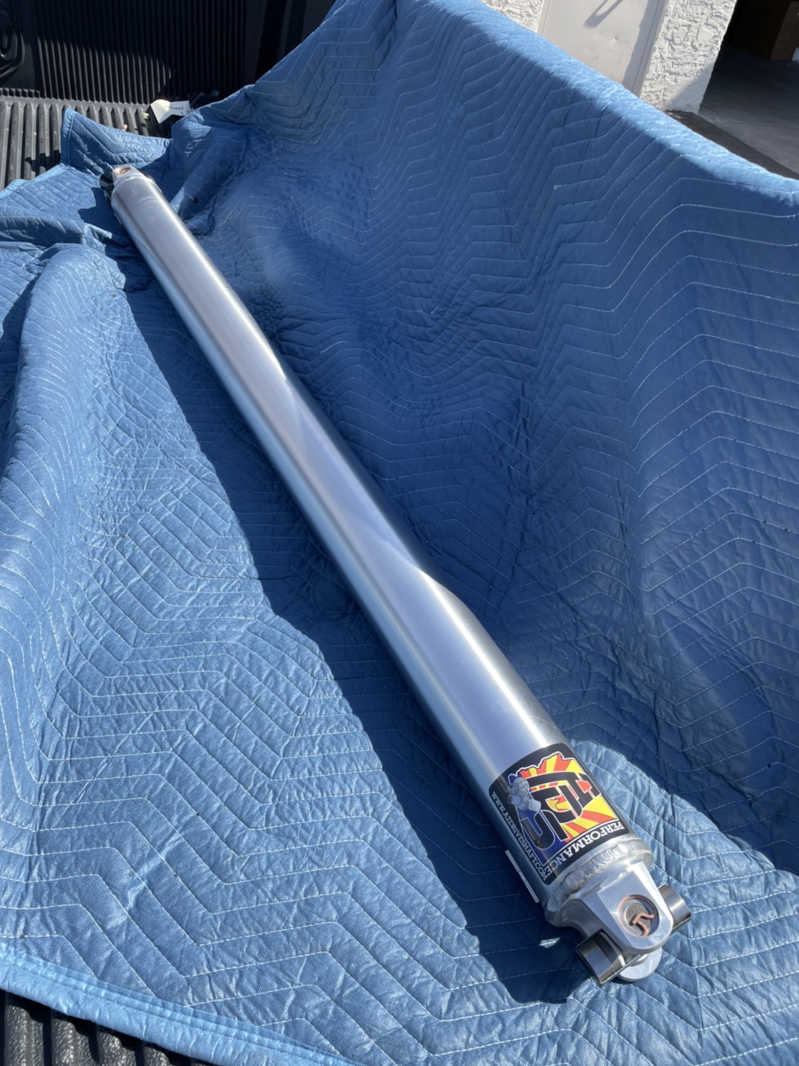

Size:  596.1 KB New 4” aluminum driveshaft, my old one had a bunch of run out and vibration. So hopefully this will help.

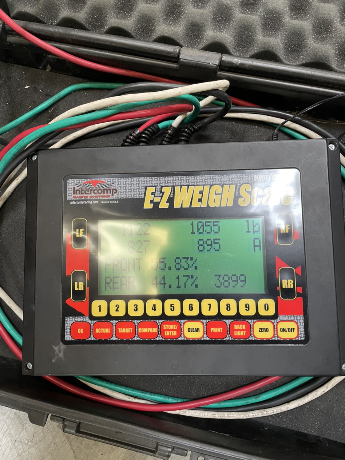

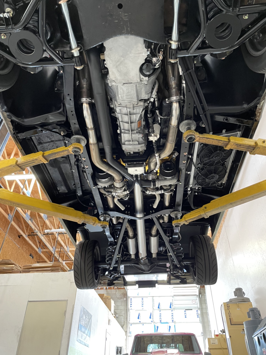

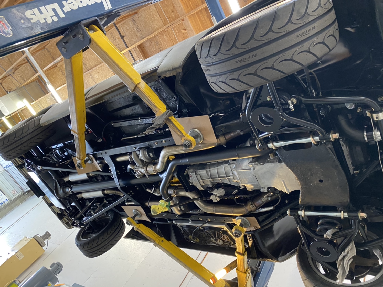

      Put V bands on the headers to stop the exhaust leaks, they were driving me nuts. Weighed the truck too.
      Big stereo with 2 12’s and an amp
      Twin turbo LS3
      T56
      AC
      Air to water with ice tank
      Longbed
      Hotchkis suspension
      Full interior
      ECE truck arms
      Full tank of gas
      3900lbs 55/45

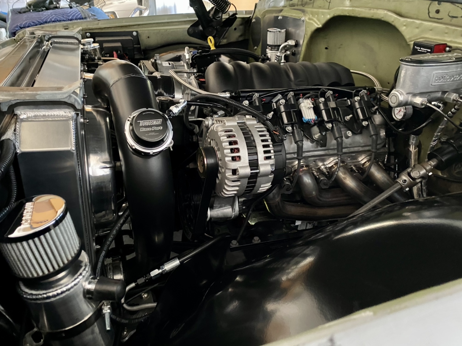

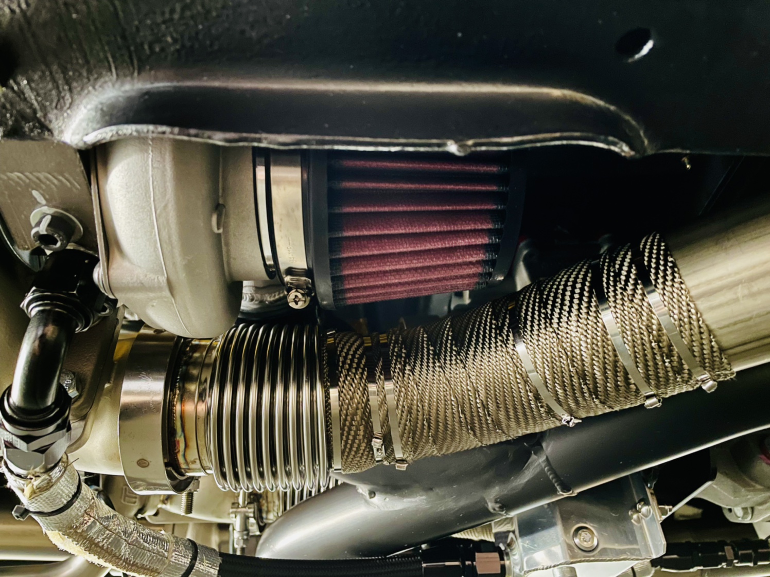

      Other air cleaners were super restrictive and had the little metal insert in the end of it that I guess comes off and usually trashes the compressor wheel on the turbo. So I got rid of those. Since I am a little cramped for space I picked up these “shorty turbo” K&N filters and it definitely is breathing way better. The Turbo needs 1000cfm of air flow and in most cases the only way to do that is to run a turbo guard or a HUGE air filter. These aren’t flowing that much. But they’re much better than the others. Heat wrapped the pipes too.

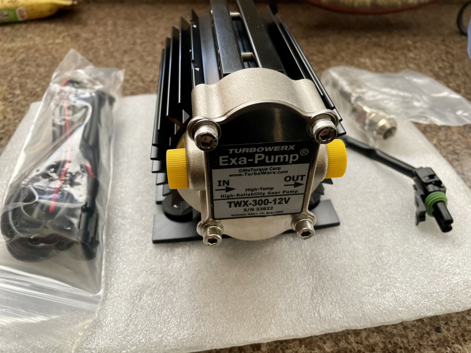

      Turbowerx Exa Pump
      Maven turbo mounts

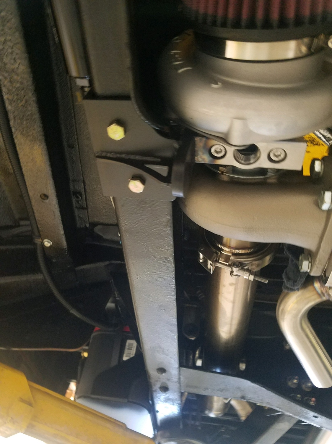

      New turbo mounts

      Exa pump mounted
