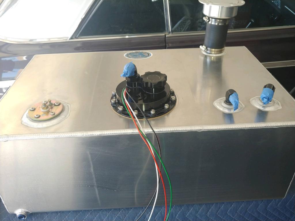

      Stopped by and got a few more pics. Upgrading the fuel system as well.

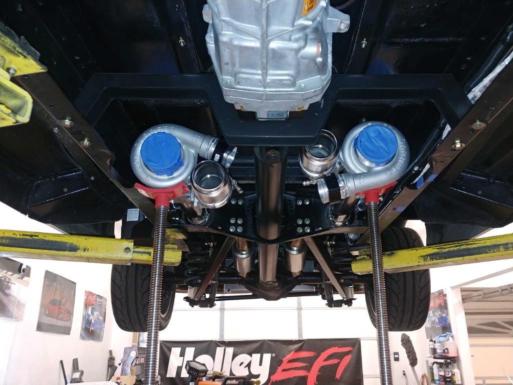

Size:  454.7 KBName:  IMG_7703.JPG
      Air to water plumbed except for ice tank, wired everything with weather pack connectors, gates installed, everything is welded. Getting there

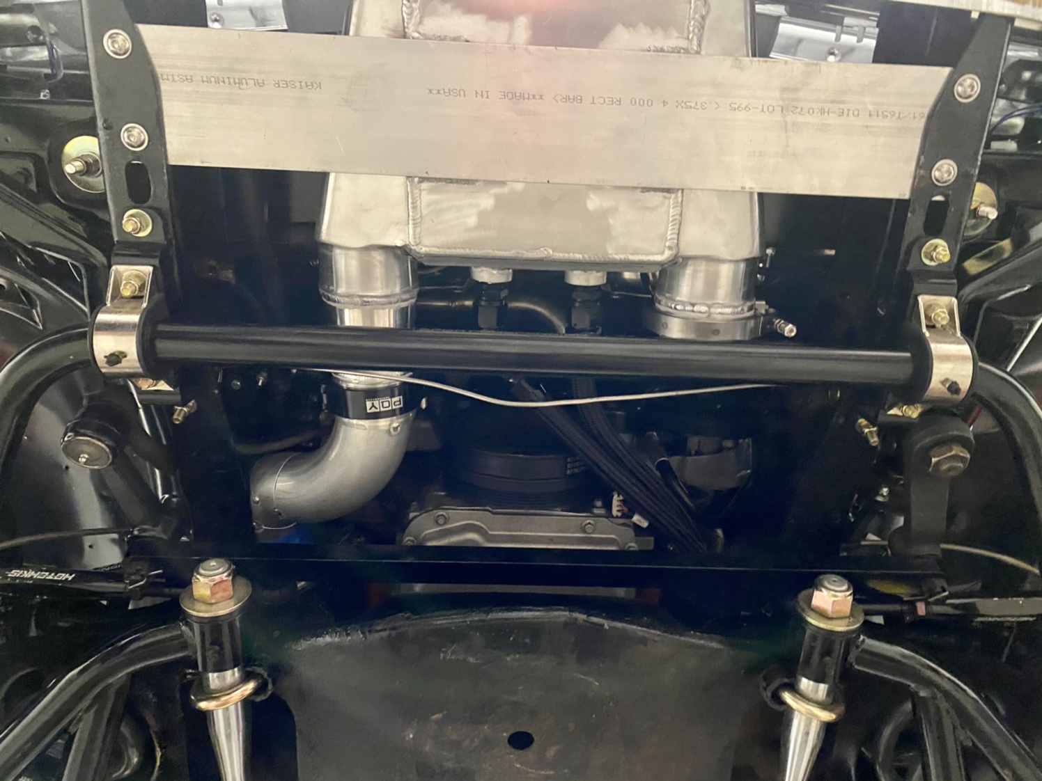

      Dual Holley 450’s installed with the aeromotive regulator, 850cc Bosch injectors, Holley rails, I believe -10 feed with -8 return. We did all PhenIx crimp fittings as well. Just waiting on the flex fuel sensor and the fuel system will be done.

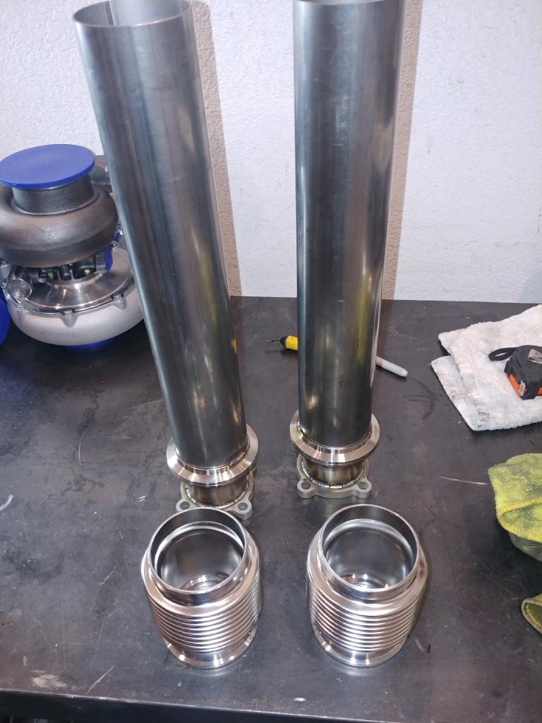

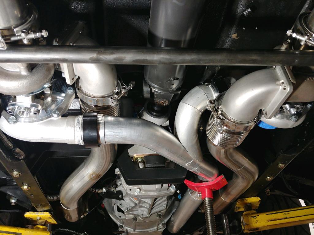

Size:  245.1 KBName:  IMG_7800.JPG
      Intake tube almost done

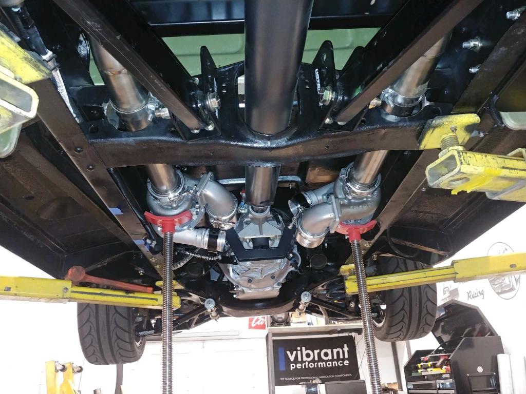

      just wondering what your plans for oil and return for the turbos ?
      I'm doing a single turbo in the smugglers box on a 1970 Elcamino,
      I would like to mount it low but was considering mounting it higher for oil return lines to motor.
      Thanks for sharing.
      David Sloan
      Jan 2016
      Arizona
      169
      Quote Originally Posted by David Sloan View Post
      Cool project!
      Thanks for sharing.
      We are running the oil feed off the little block above the oil filter and the return will T off into a scavenge pump and will return to the valve cover. Thanks man
      Aug 2002
      Waleska Ga.
      2,722
      Quote Originally Posted by Cshenker1121 View Post
      Thank you sir!
      I had thought about running a scavenge pump, I'm a little ways from worrying about it yet but may do that as well to keep the turbo lower.

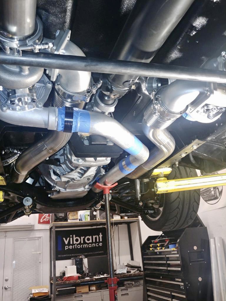

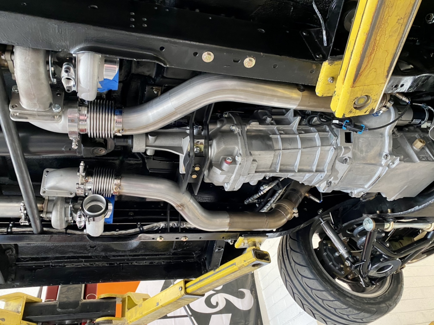

      Coated the charge pipes
      Oil lines ran and scavenge pump done
      Wastegate plumbing done
      Heat barrier on the floor

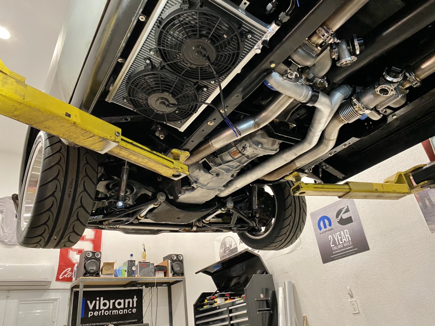

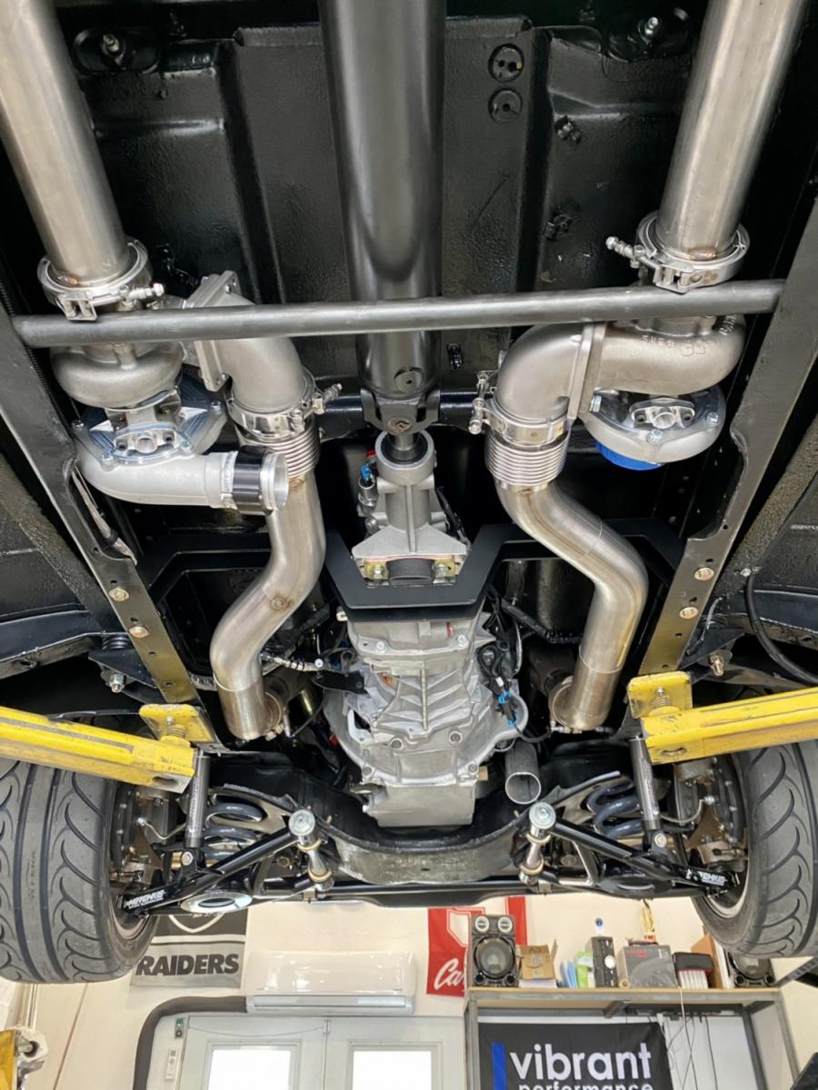

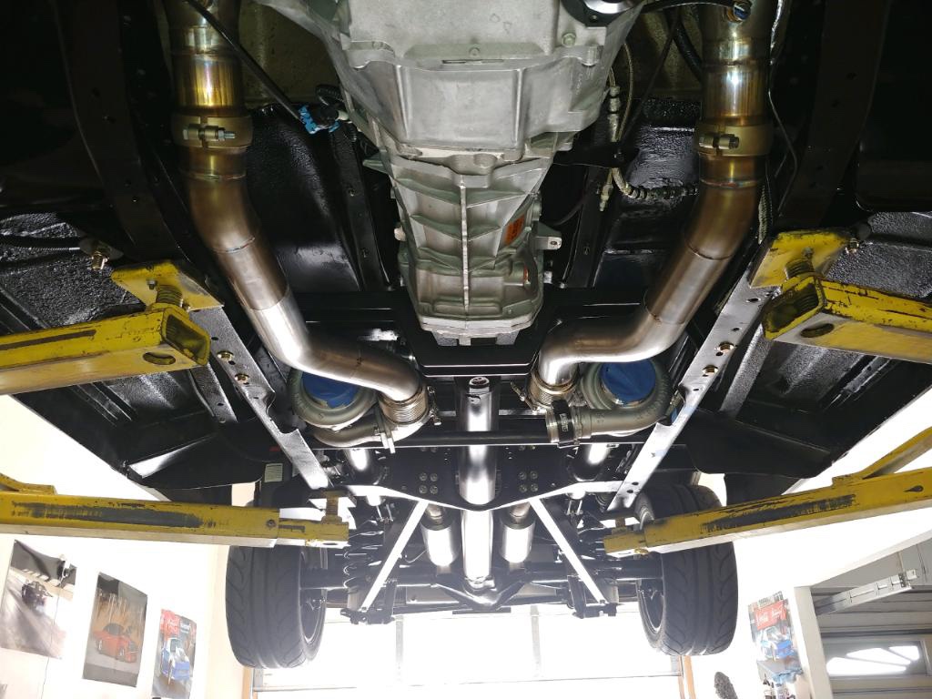

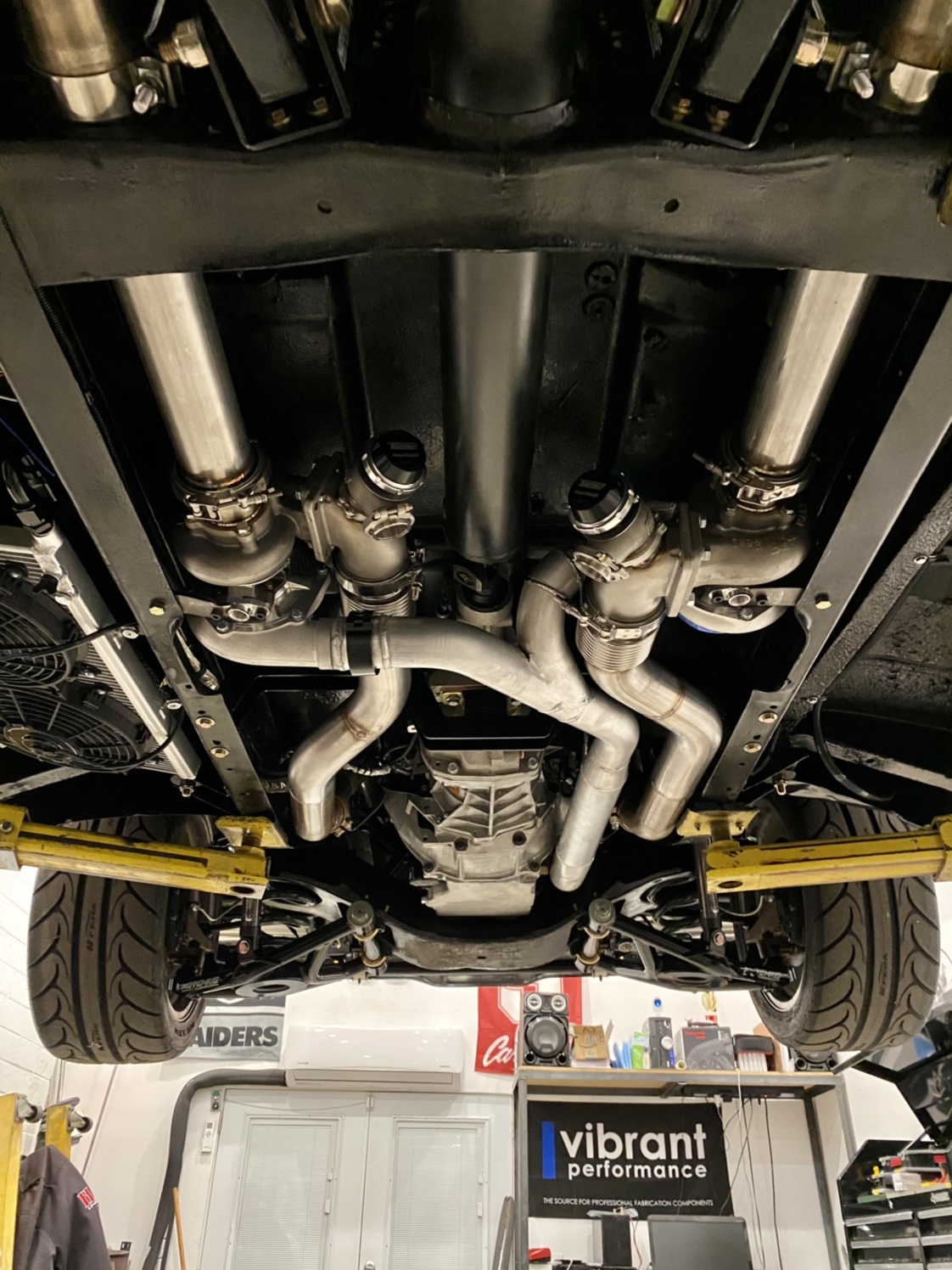

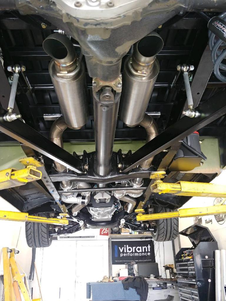

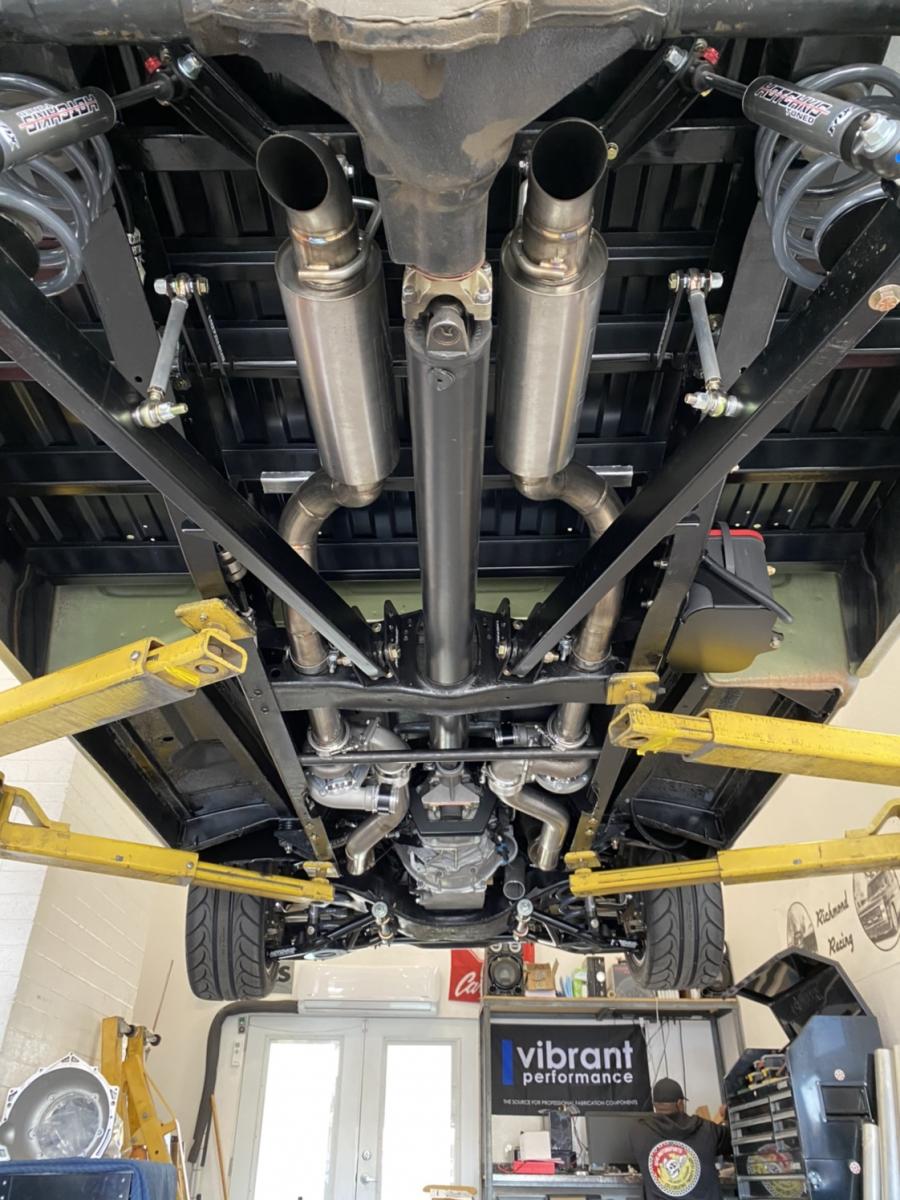

Size:  538.9 KBName:  IMG_7893.JPG
Size:  531.2 KBName:  IMG_7897.JPG
Size:  579.1 KBName:  IMG_7890.JPG
Size:  431.8 KBName:  IMG_7884.JPG
Size:  511.8 KBName:  IMG_7885.JPG
Size:  486.4 KBName:  IMG_7881.JPG
Size:  590.4 KBName:  IMG_7879.JPG
Size:  556.3 KBName:  IMG_7896.JPG
Size:  435.7 KBName:  IMG_7864.JPG
Size:  580.4 KBName:  IMG_7869.JPG
      Truck is finally finished and waiting to go to get dyno tuned. Couldn’t be happier.
