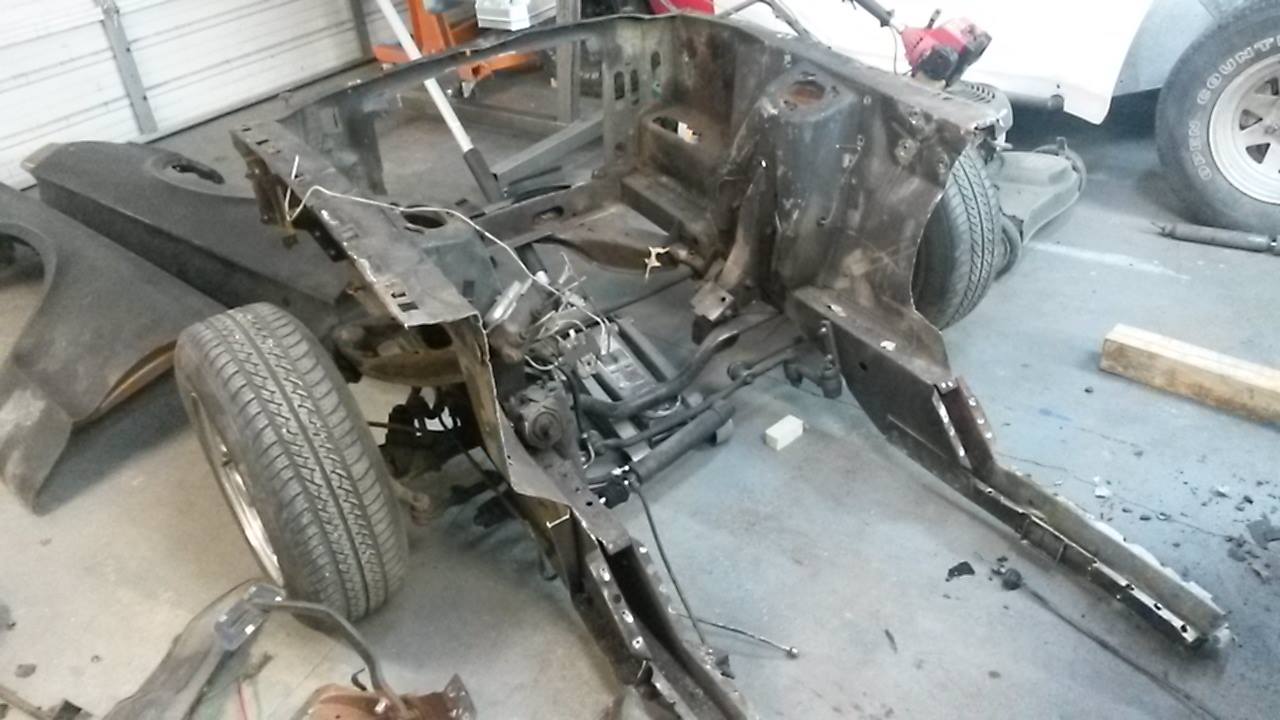

      Front end cut off.
      Name:  Front Clip Removed.jpg
      Name:  Front End Cut Off.jpg

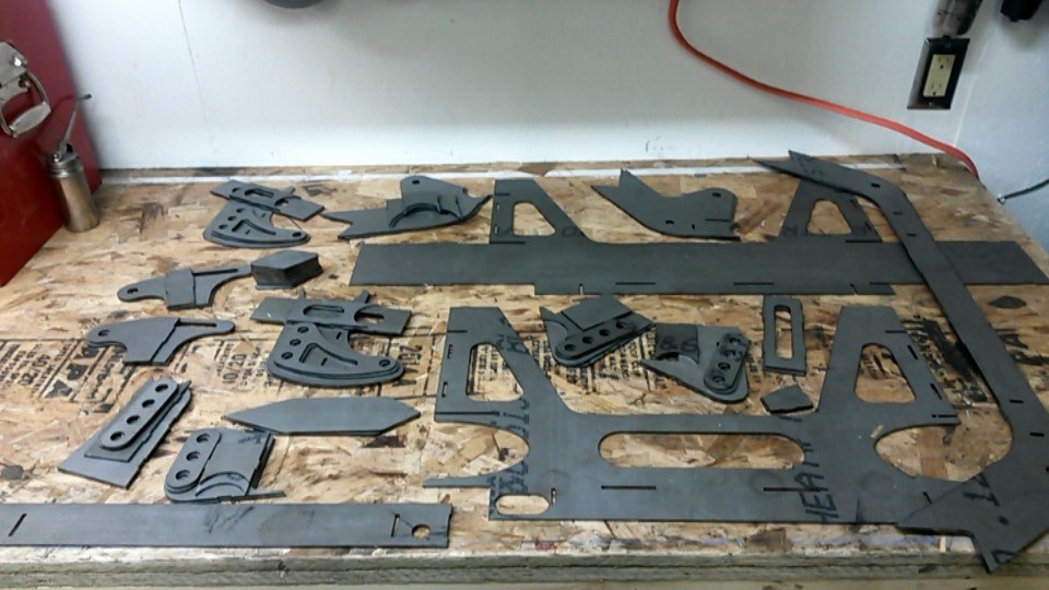

      Chromoly, fresh off the laser!

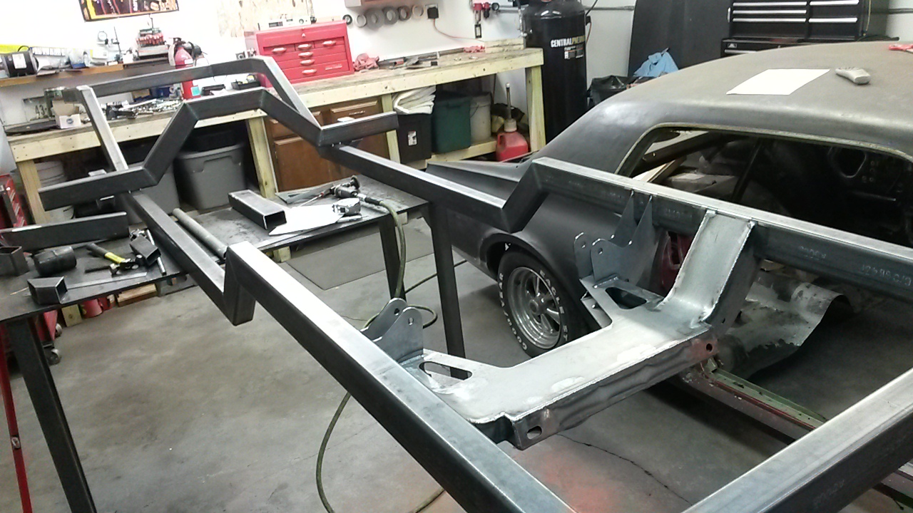

      Front crossmember tacked in place.

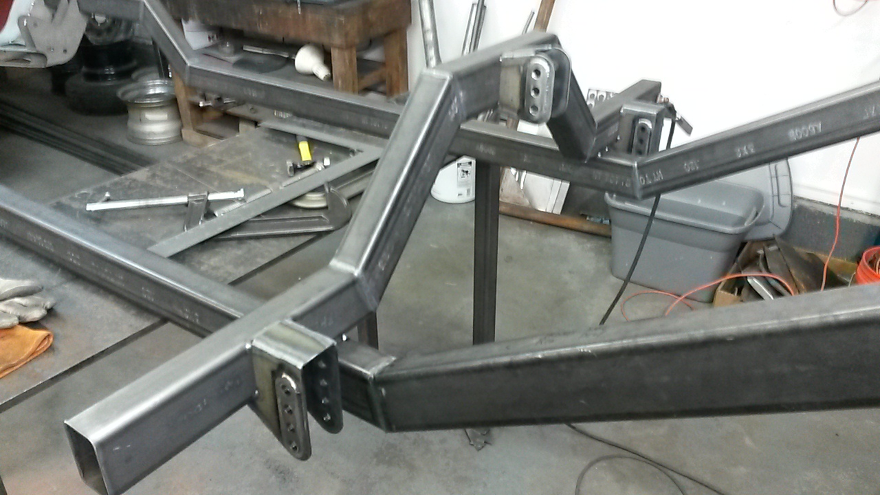

      Rear link brackets tacked in place.
      Name:  Rear Link Brackets.jpg

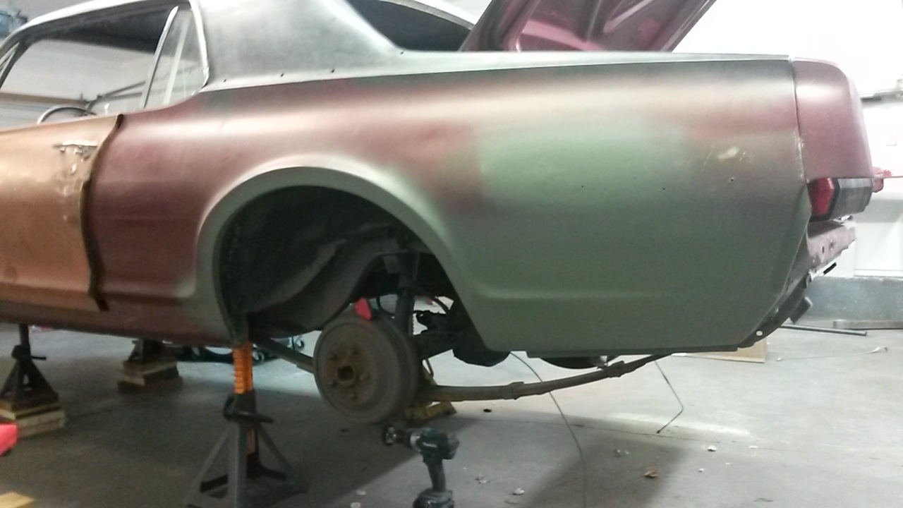

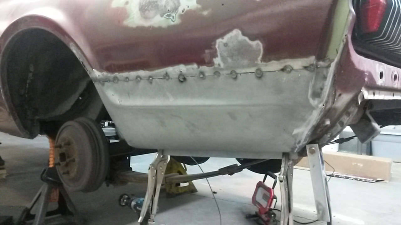

      Iv'e started some of the patch work. The rear quarter patches are roughed in. They turned out pretty good for a desk jockey

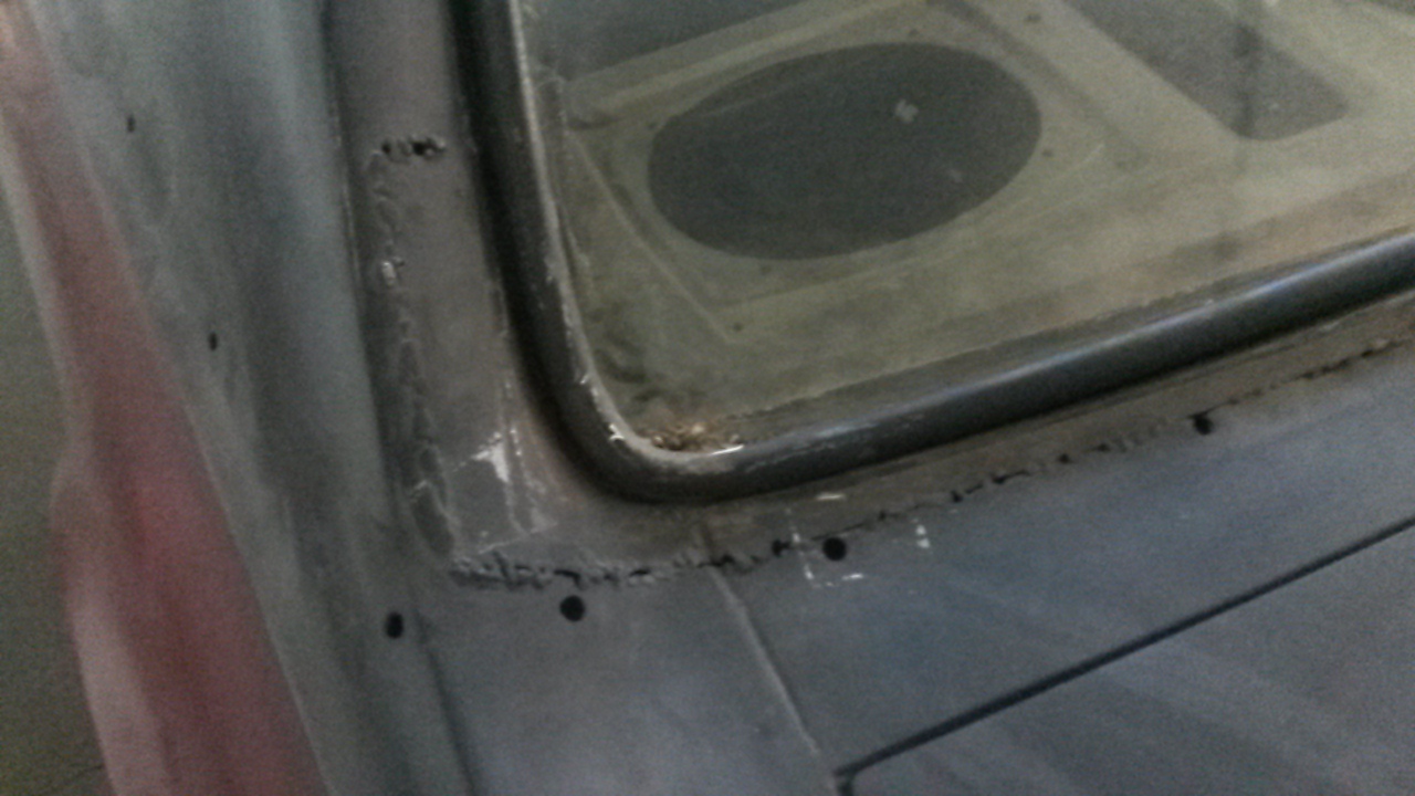

      The previous owner attempted to start patching the rear window area. I have a replacement panel ordered.

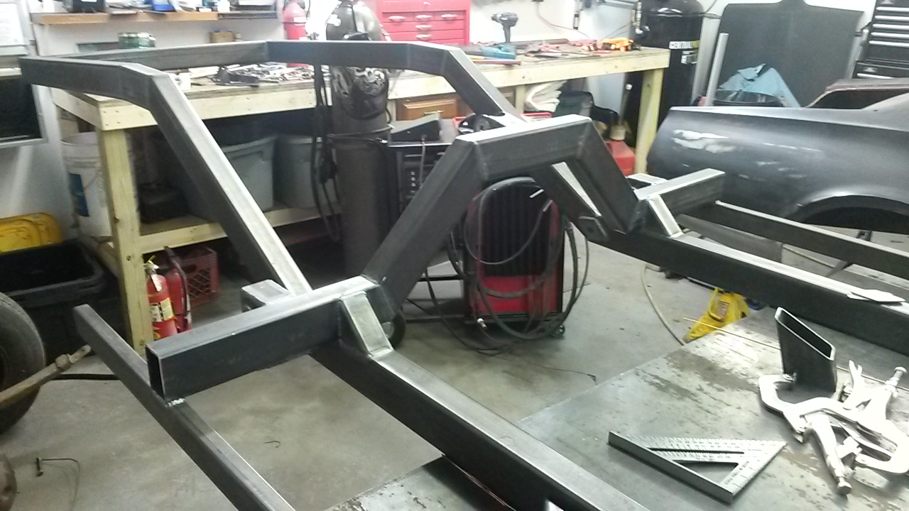

      Motor will be a Coyote with plans for a supercharger down the road. I'm not sure if it will be the F150 version or a Mustang motor. If I can get a good deal on a wrecked mustang I'll use the motor and 6 Speed from the mustang. If I go the F150 route the money saved on the motor can go towards a T56 Magnum. The motor will also be set back quite a bit!
      I got the rest of the front crossmember tacked in place today.
      I also got some bracing welded in to keep this thing square. I still need a little more bracing before I cut the rest of the floor and rear frame rails out.

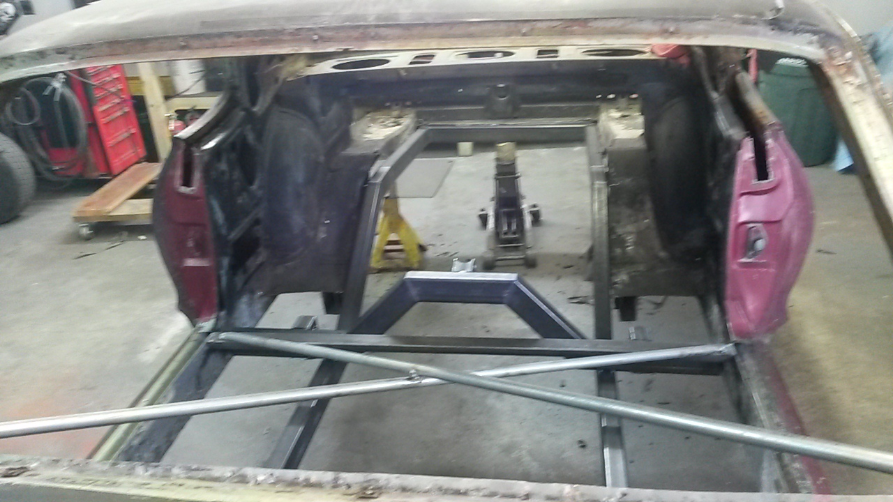

      I made a little progress over the weekend. I started by cutting out enough sheet metal to be able to roughly test fit the new frame in it's future home. With the width of the frame I was able to leave the factory rear frame rails in place. They will get cut out later but for now it should help keep everything nice and square

      I added a few gussets here and there and got the front and rear crossmembers fully welded.

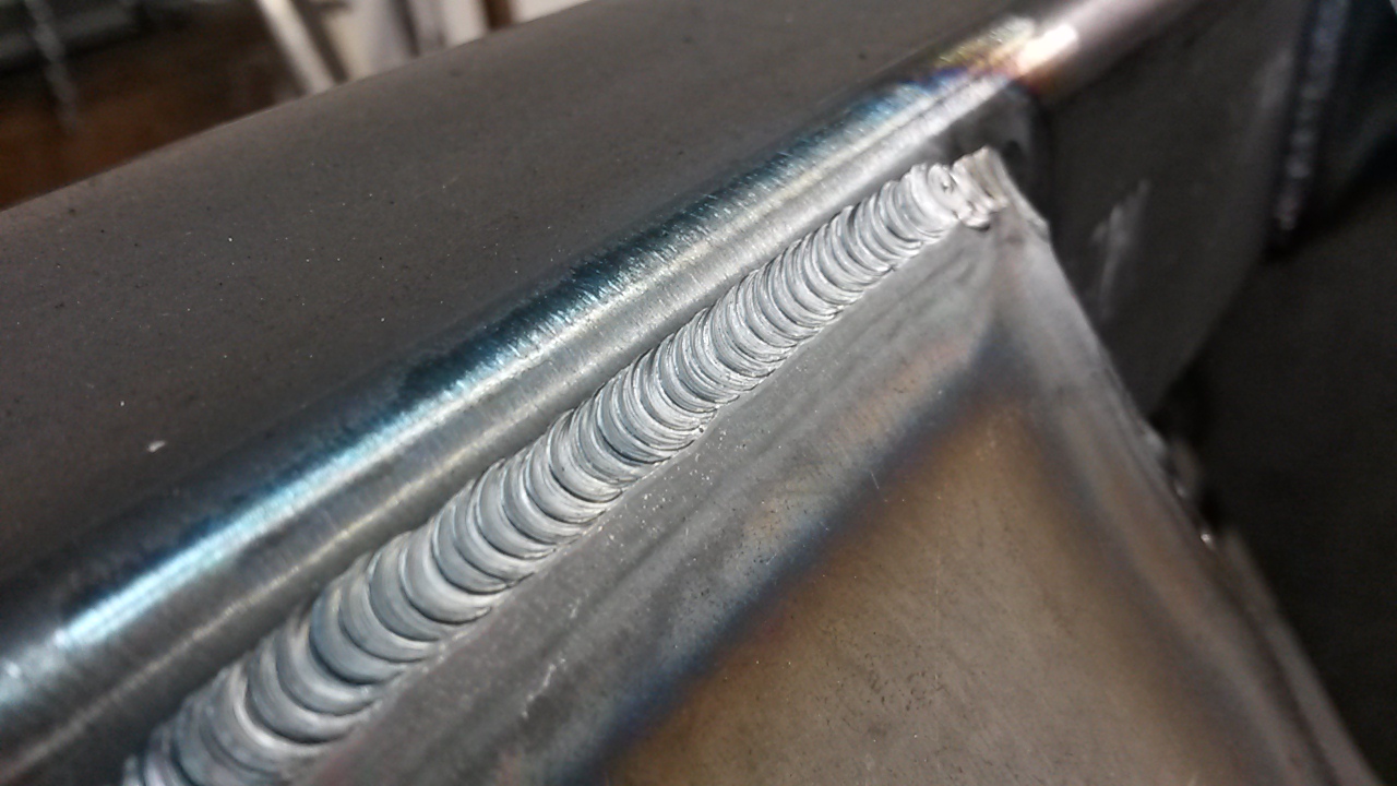

      Every now and then you lay down a bead that you just have to take a picture of!

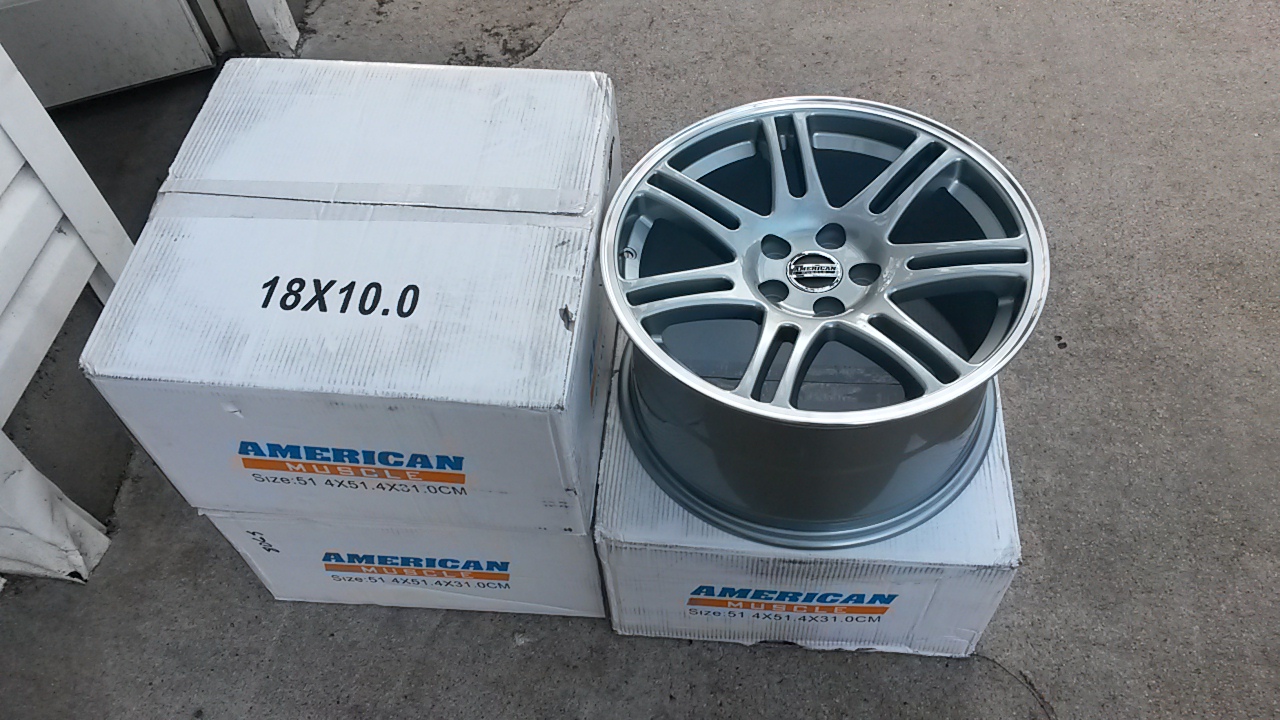

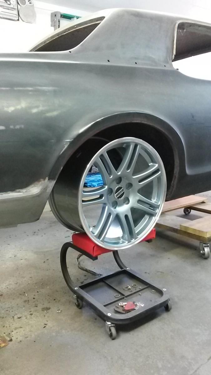

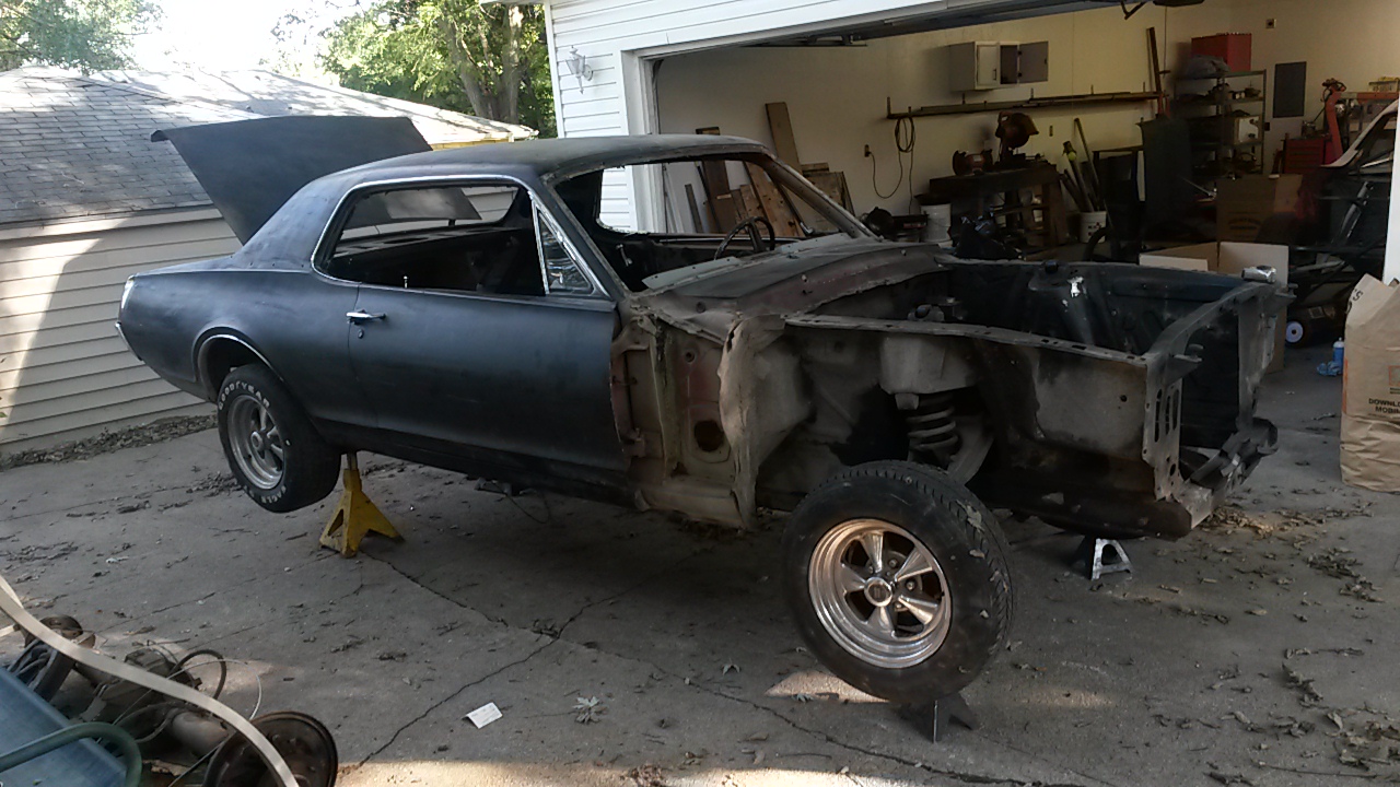

      These weren't my first choice of wheel and I'll probably get a little flack for them but they'll get me by for a while. I just couldn't pass up the deal when I found 18" x 10" wheels with the proper backspacing for $59.99 a piece and free shipping!!!!!!!
      They won't look too bad!

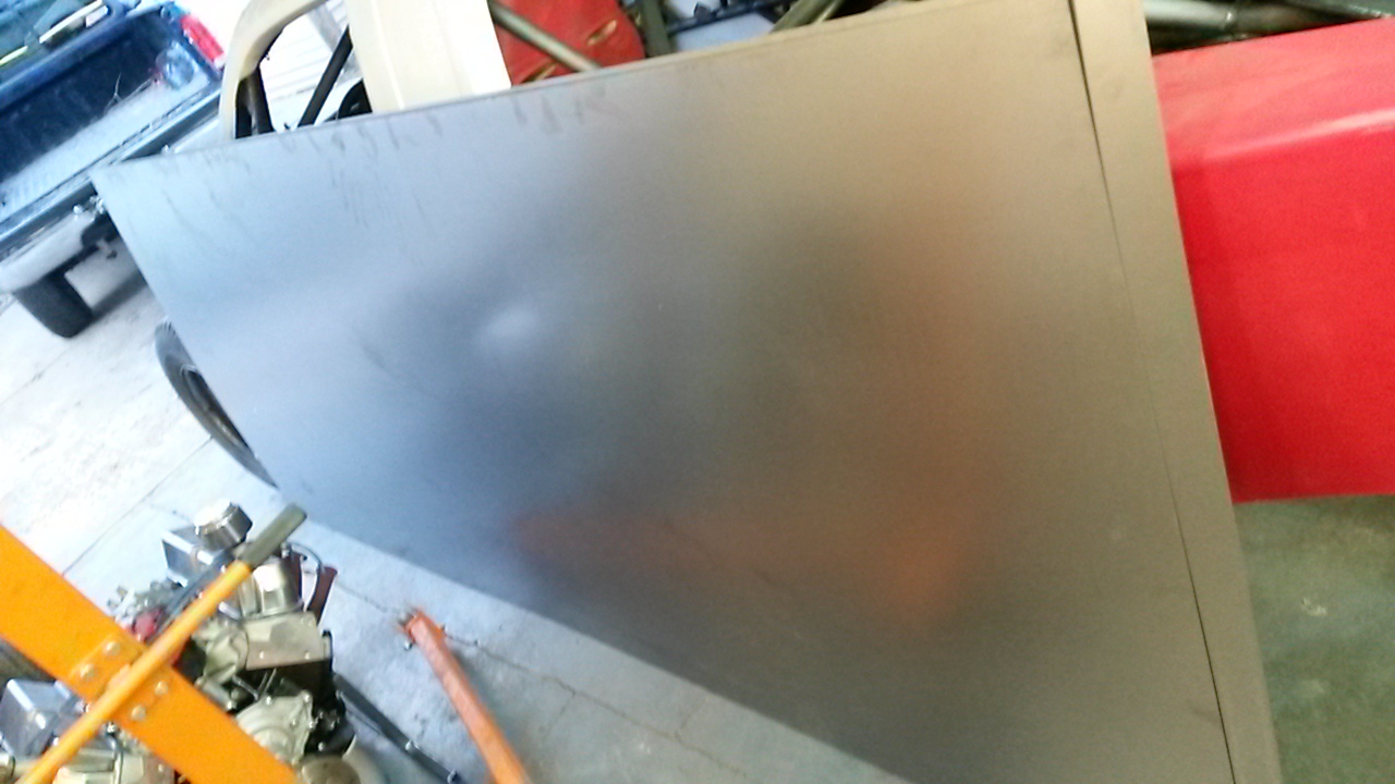

      Also picked up a bit of sheet metal.... lots of sheet metal work in my future!

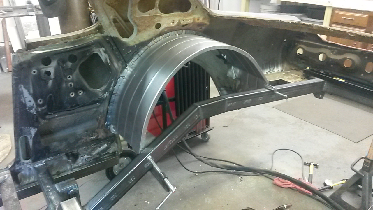

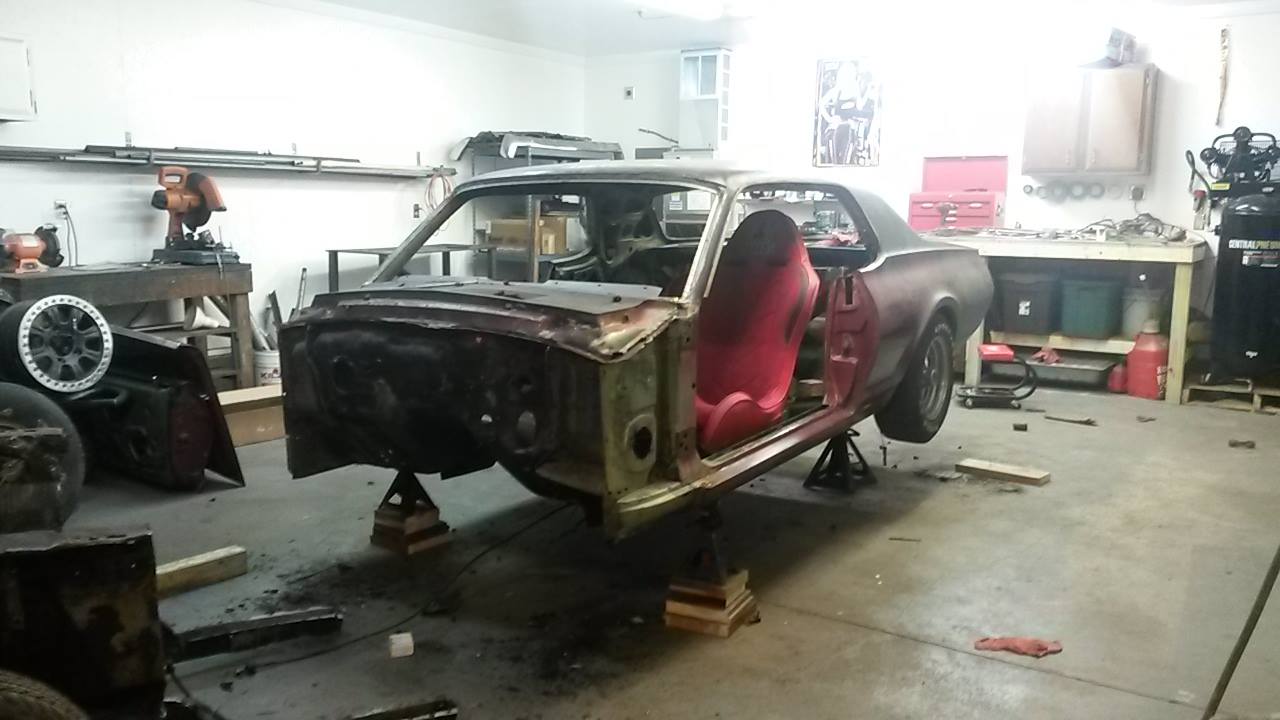

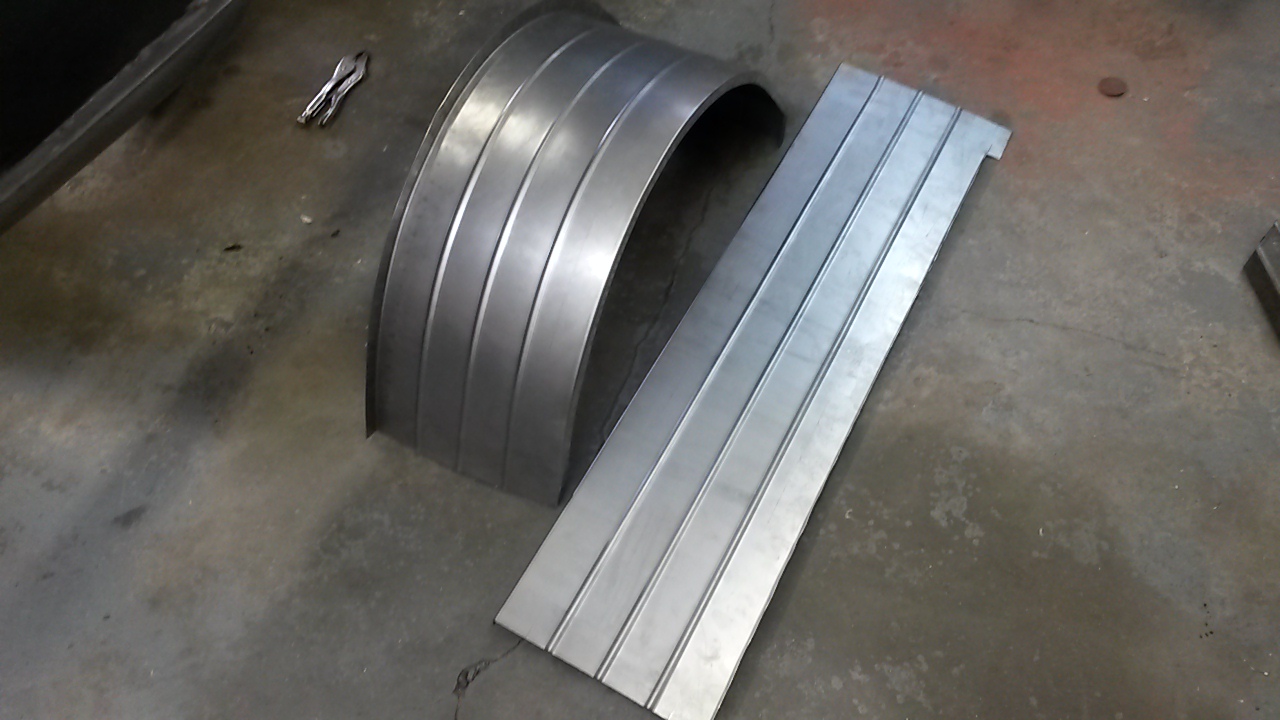

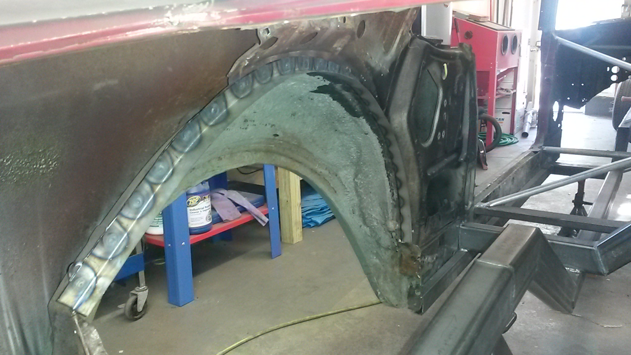

      The wife and I spent a week in Mexico and I am still waiting for payment for my truck so I haven't started ordering drivetrain parts yet. But I did manage to spend some time working on my inner wheel tubs. I contemplated buying some but in the end I decided to buy the tools and build my own. I've got a bead roller already, so I picked up a Woodward Fab Shrinker/Stretcher from work (part #4192500 if anybody is curious). I had never used one before, but I must say I was actually quite impressed at how well it worked.
      If anybody is looking to get away, I highly recommend The Royal in Playa Del Carmen The service is top notch, the resort is amazing and the prices are pretty reasonable. They had a last minute cancellation and we were upgraded to a beach front room, no charge!
      Here's a shot showing what 30 minutes on the shrinker can do to a flat piece of 18 Ga.
      I built a 90 flange and spot welded it to the factory outer wheel tub.
      Test fitting
      Complete except for welding. I'll weld them in after I get the cage and rear suspension brackets welded in.
