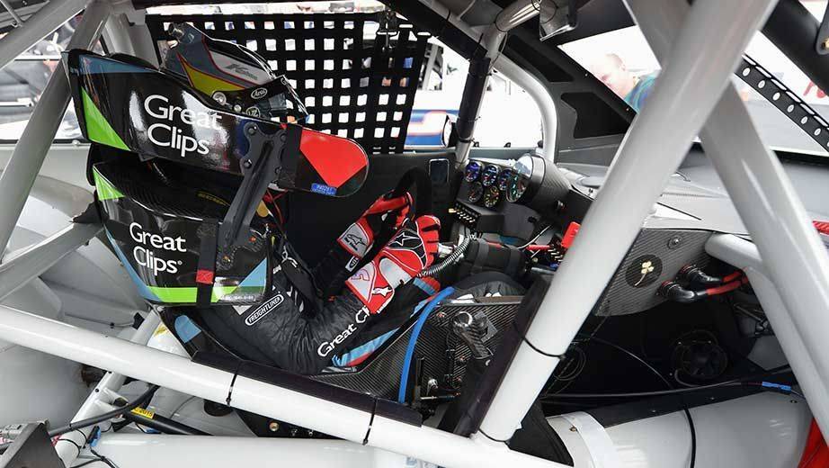

      Better at what? Getting T boned at 100, NAPCAR bars. For a wheel to wheel car, these would be my choice. The nascar bars are out of plane and will require a double S bend or notching the B pillar and gutting the doors. You also don't get the torsional rigidity or the support at the A pillar bar like you do with a double x.
      The double X is better from structural point of view. For a track day/HPDE car I would go this way.
      Don't forget the FIA bar.

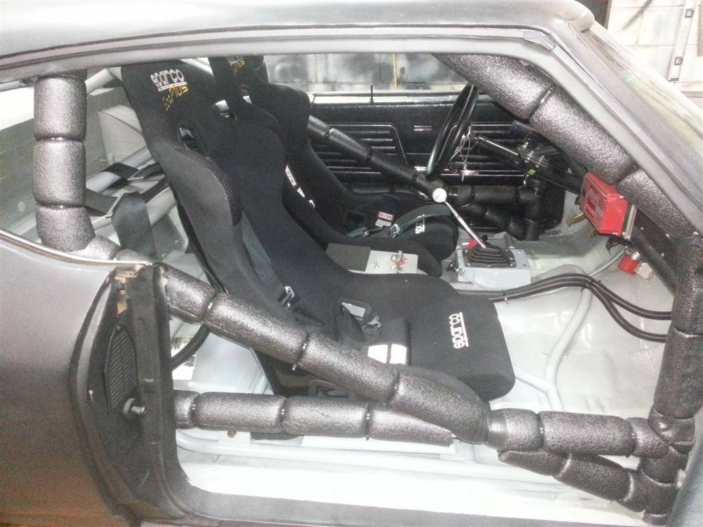

      Heres my set up. They sit up higher than it looks as the camera is pointed downwards. Not too hard to get out.

      that setup right there looks great for what I would like to do for safety and making the whole chassis stiffer

      If you look at the drivers door you can see there's some real protection there.
      What did you do with the door pamnels and arm rests? Did you cover the holes or put a strap or just leave it?
      oshawa ontario
      1,607
      You open and close the door with the door handle, theyre plenty stout to do it. The armrests are no longer there. I dabbed some black paint on the metal that showed through the holes (my car has never been called "pretty" lol) You could probably make something to plug up the hole in the door panel. When youre going slow you can rest your arm on the downbar its pretty comfortable actually.

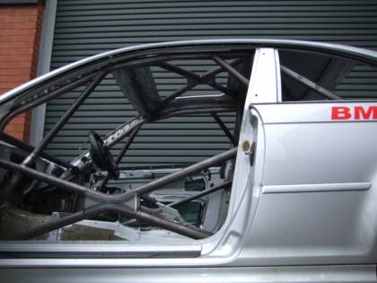

      ANY X-bar should be built as two V shaped bars tied together. Anything else is prone to fracture in an accident and could cause serious injury or death to the driver.
      Like this
      Also you never want any "S" bends in any part of any roll cage, they are weak and will buckle.
      You need to get some sfi padding in there, that pipe insulation is virtually useless in a crash.
      oshawa ontario
      1,607
      Quote Originally Posted by 71RS/SS396 View Post
      It isnt "Pipe insulation" it is purpose built Moroso roll bar padding with the roll bar cut out offset. It was installed in tens of thousands of race cars up until a few yrs ago but I do hear ya'. I like the old school look and will likely replace it with some SFI stuff in key areas. While researching the SFI stuff Im amazed at its lack of bar coverage in Nascar. It seems they just put it on here and there...I have EVERYTHING covered

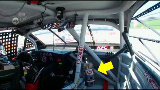

      The current seats & harnesses hold those guys so fixed into place that they couldn't reach most of the tubing inside the car.
      I think even their "loose" arms are semi-limited with nylon straps now.
