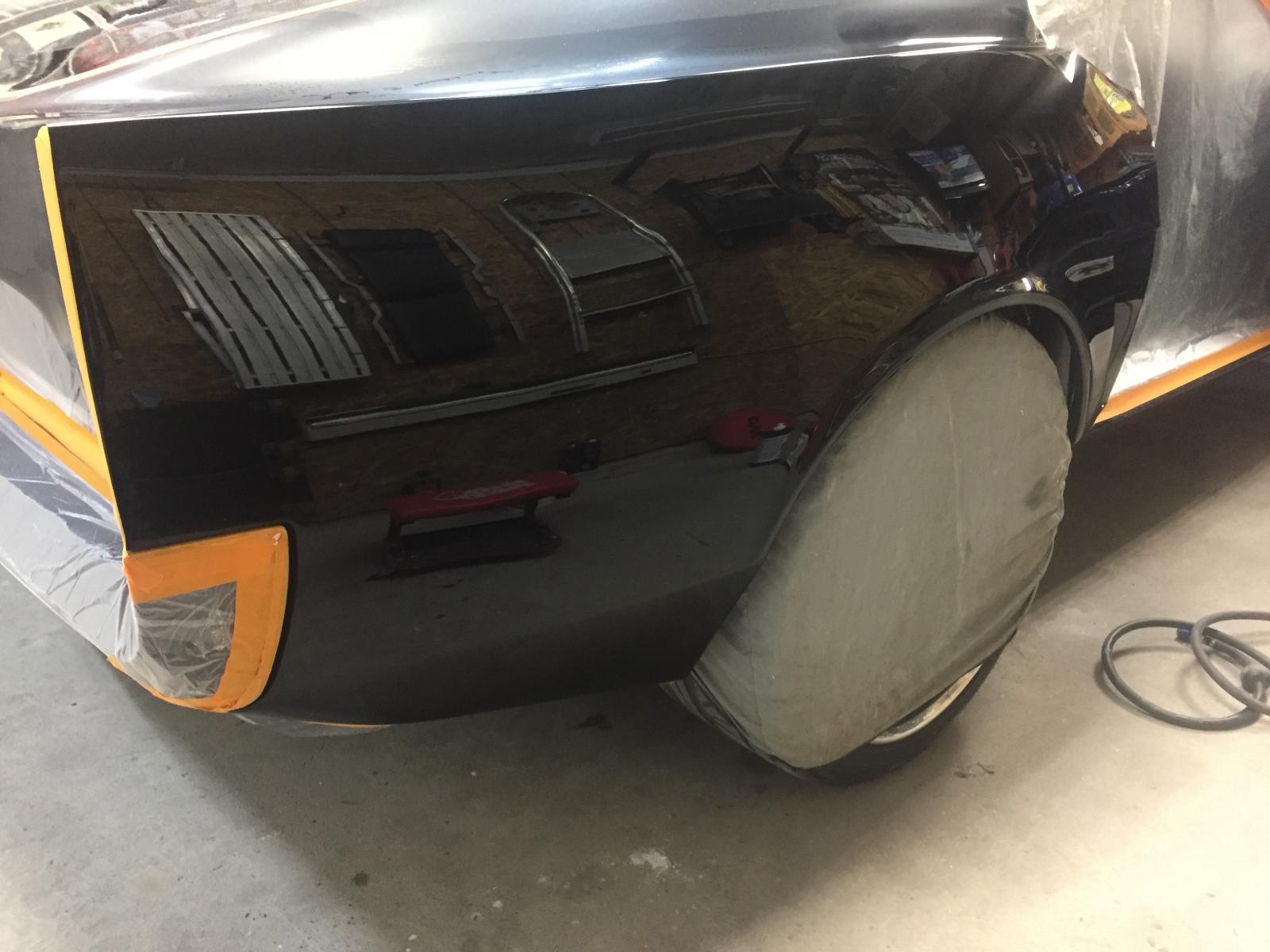

    1. #221
      5,560
      It's looking SWEET!! Nice job.
    2. #222
      Jonesboro, Arkansas
      2,506
      This is when it becomes eye popping!

    3. #223
      May 2012
      412
      He’s very fussy. What you want in a cut and polish guy.
    4. #224
      Jonesboro, Arkansas
      2,506
      I'm patiently waiting on the buffing to start. I know it's going to be nice!
      Carl Wilson
    5. #225
      May 2012
      412
      He’s doing a killer job for me.
    6. #226
      McKinney, TX
      1,623
      I can almost see myself in it!
