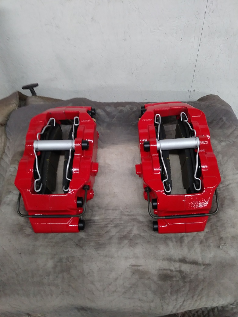

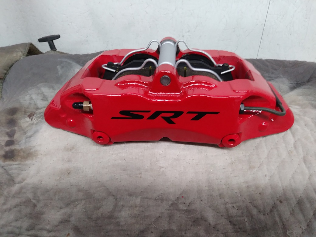

      Front calipers are done, these babies are monsters. The pistons are 2 1/4" in dia. That makes 4 square inches per piston, 16 square inches per caliper, times 1200psi line pressure equals 19,200lbs of force per caliper, times 2. That should be enough to stop on a dime, and leave 5 cents change.....Name:  20191207_162525.jpg

      They came out great! Did you have any trouble getting the powder in the tight corners, or did you try preheating them a little?
    6. #326
      Nov 2010
      579
      No preheating necessary, just very low air pressure. Thanks Wayne..

      I am no expert, but I believe you only calculate piston size on one side of the caliper, so 2 1/4" X 2 for area. That Cerakote looks awesome!

      Don't know how that works...

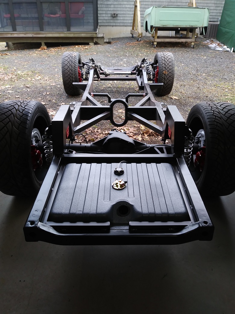

      Chassis is complete, next is getting the engine and trans ready for paint...
