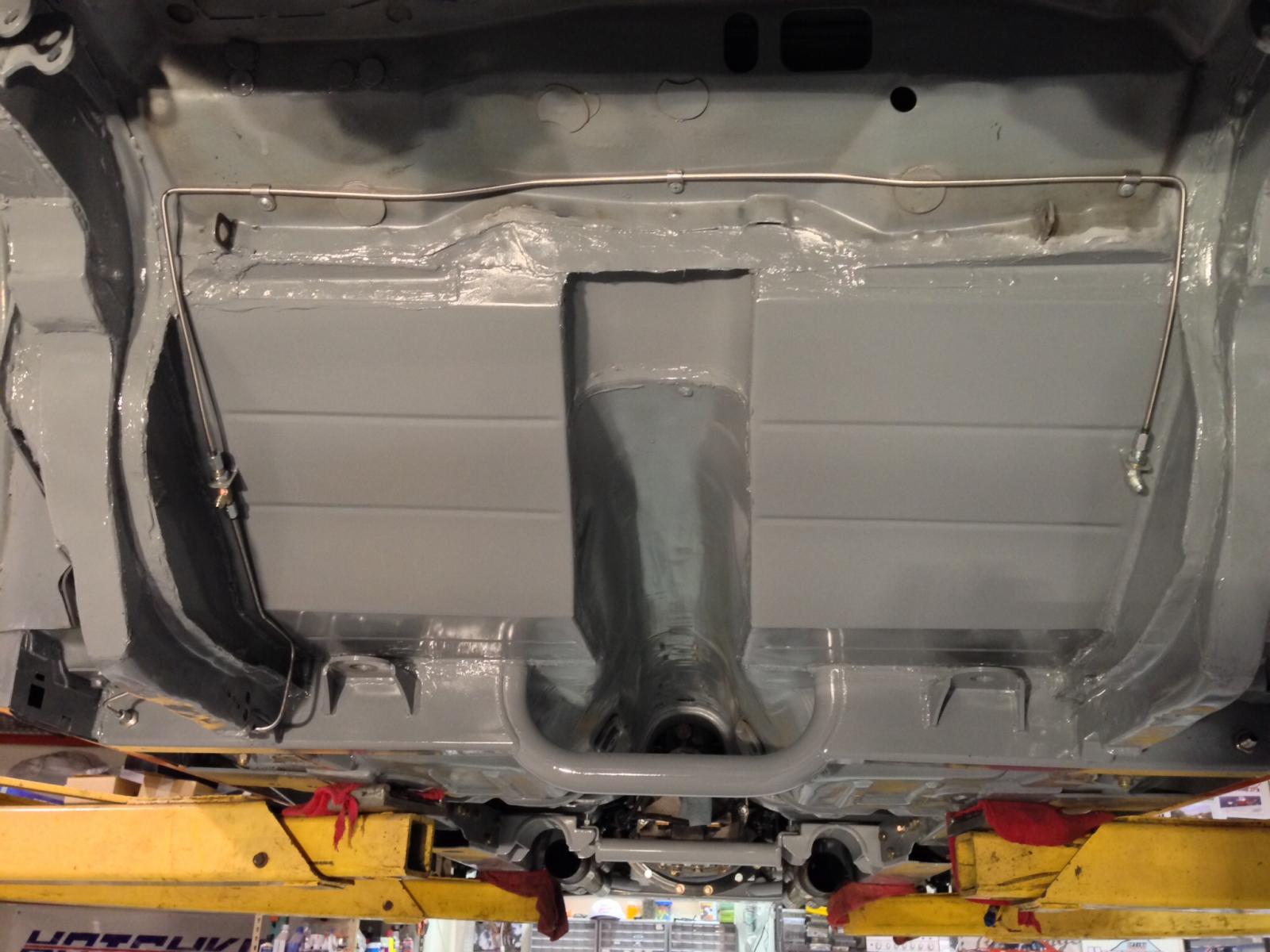

      Nearly done with the install, I'll post some details once I'm finished. It's been way more cutting & welding than a first gen, but turned out pretty nice.
      Frame supports are 2" wide on each side of the flat panels. I put some bead rolls into them to stiffen them up.
      I raised the floor placing it on top of the new crossmember. The raised floor allows space for the mufflers, there is around 1/2" clearance. There is a factory kickup in the area of the crossmember, so the forward edge of the stock floor lays on top of it.
      Below, you can see the edges of the old floor along the edges of the frame rails. I think it may have worked better to have placed the frame braces farther inward closer to the edge. It would look cleaner.
      Thermo Tec insulation added.
      I cut the corners off the trunk which gained a lot of access room to get at the subframe bolts and upper shock mounts.
      I still need to cut holes for the shock reservoirs to pass through.

      That is beautiful. Nice job.

      Nice work David. So its a bolt in cradle? Can't wait to hear some feedback on the new set up.

      6,114
      It goes in & out pretty easily with just 4 bolts.
