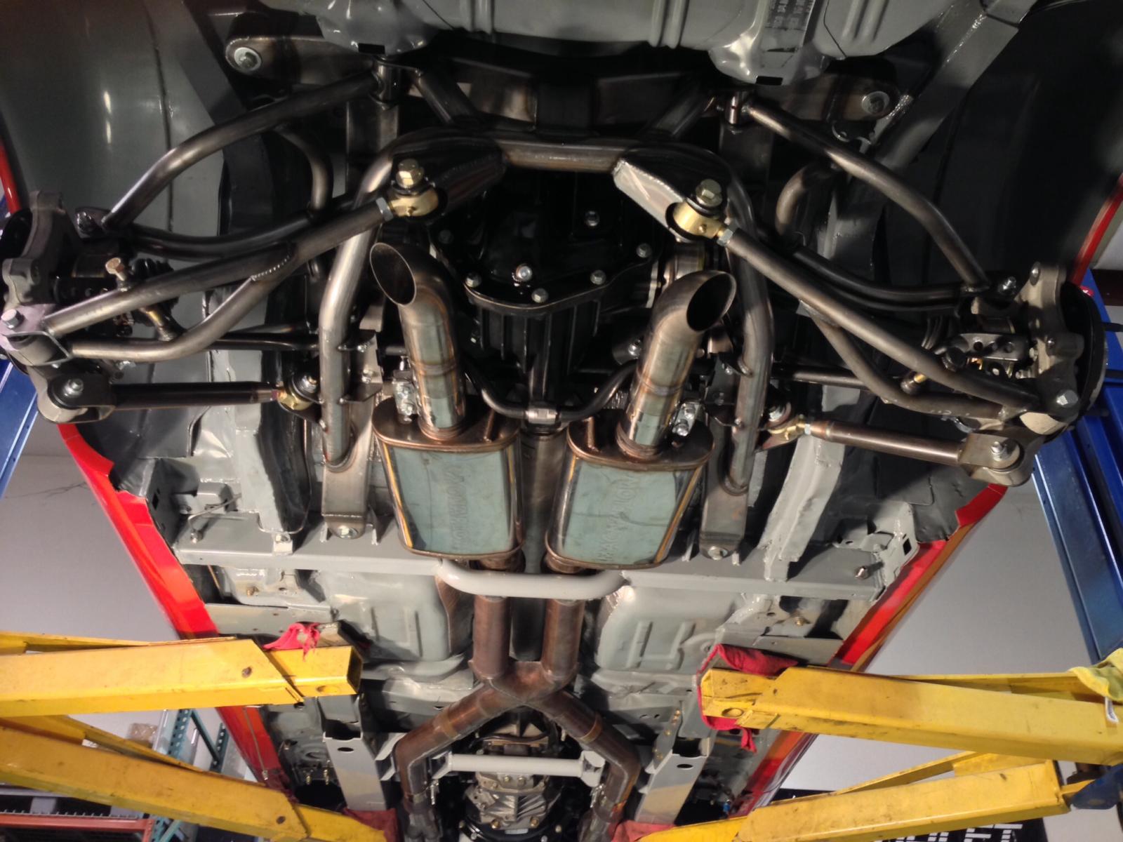

      Perhaps I missed it earlier in the thread, but can either of you comment of exhaust routing? Did you go under, did either of you take pipes all the way to the rear of the car?

      Matt has full tail pipes. Ours kick down at the rear of the cradle.

      You can go under like how David did (and then go up and out the rear, or terminate it at the diff), and we snaked it under the CV then routed beside the fuel tank.

      Thanx Matt... Those look to be 2.5" pipes, is that correct? Is there room for 3" through there?
      2.5". 3" could be done, but I'd route it under the diff like how David did. If a person were to order the cradle with the OEM 5th Gen diff, it allows much more room for larger exhaust. The Strange diff is large in comparison.
