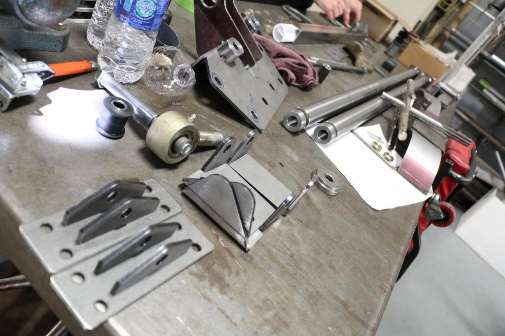

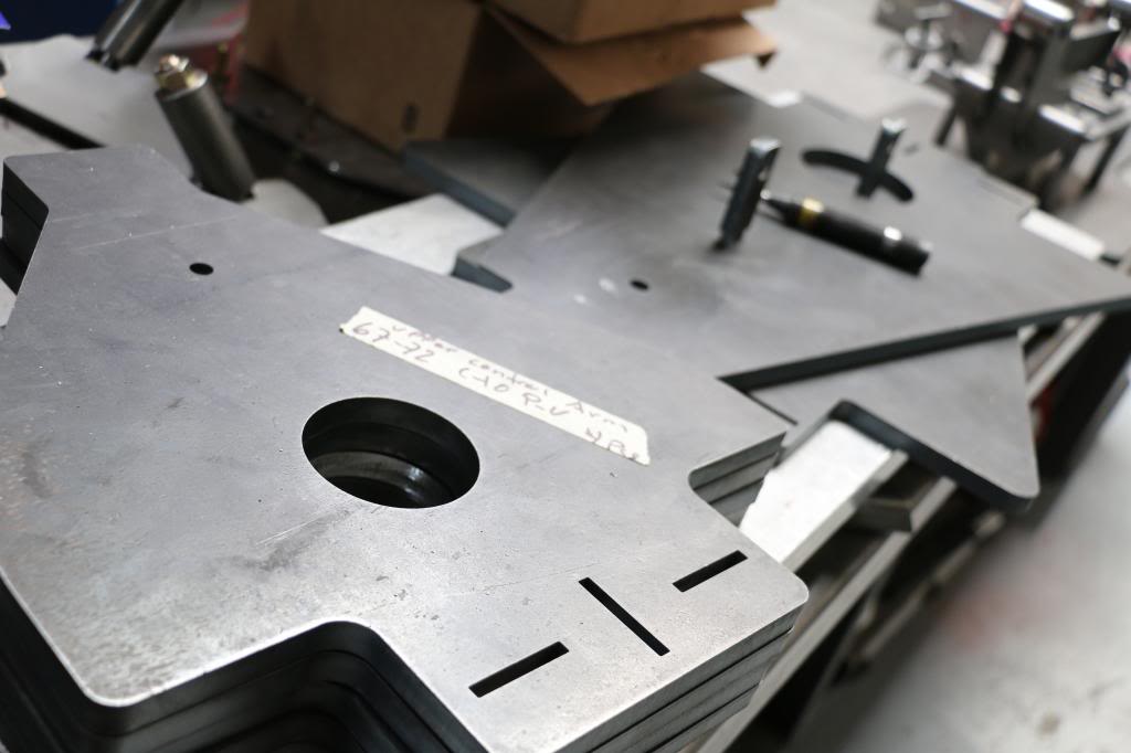

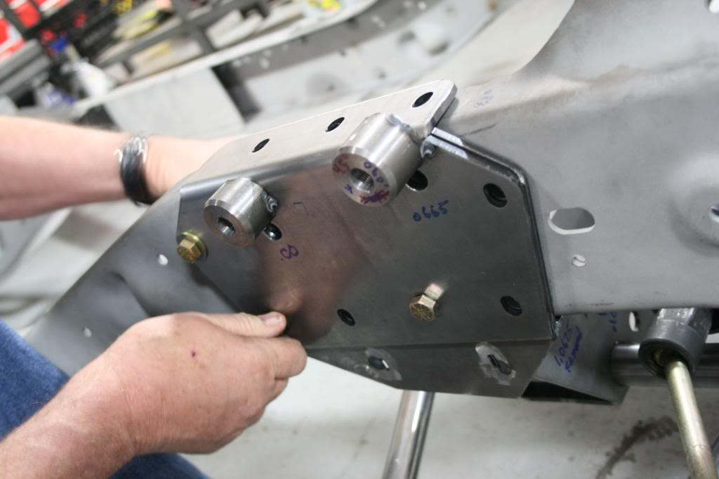

      Here are the plates that will be used to make the upper control arm fixtures.
      Rear shock mount fixtures
      Panhard bar installed
      -J
