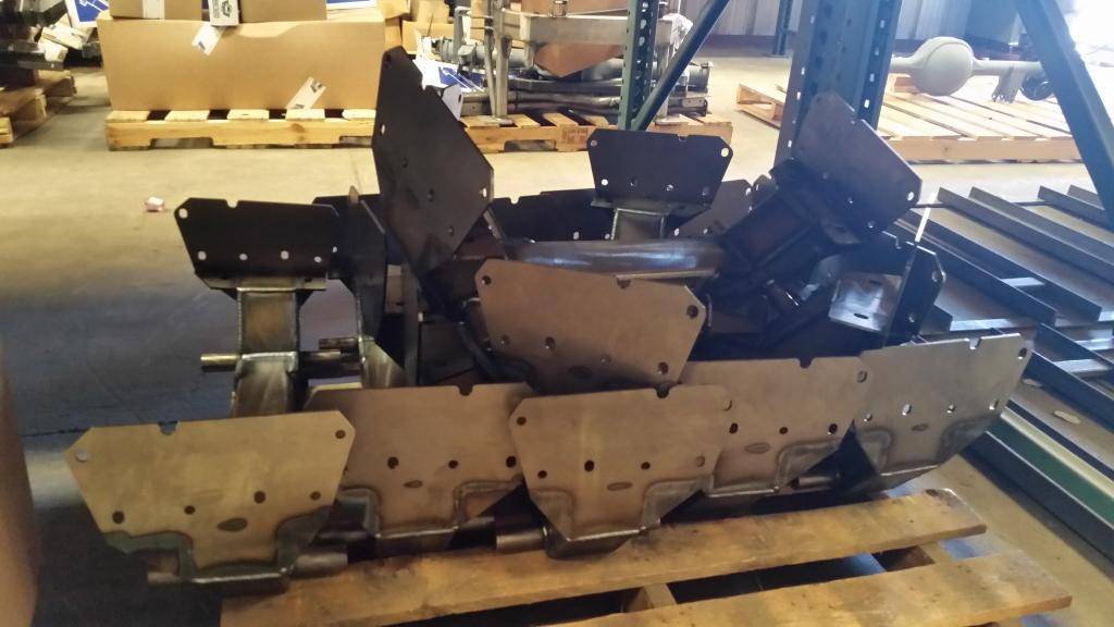

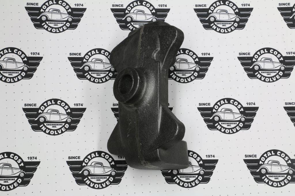

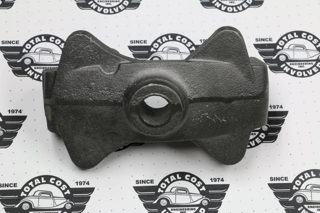

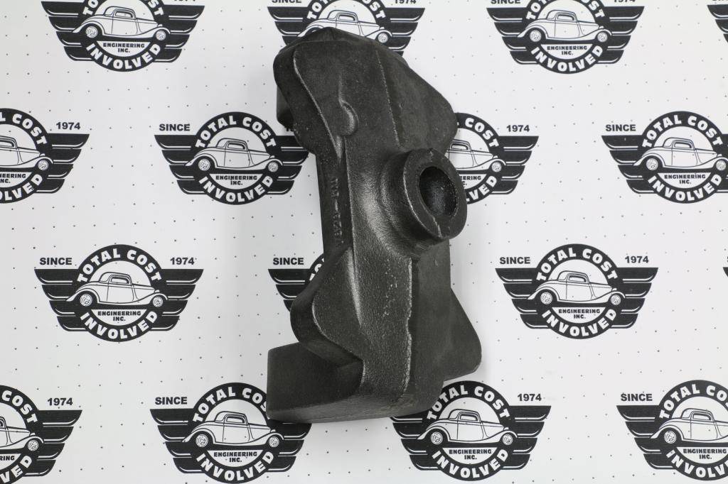

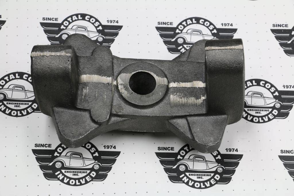

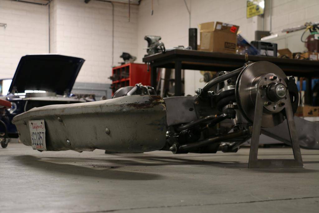

      We just received our first article spindles yesterday. This was one of the most important pieces to the puzzle. We still have a lot of time studies to accomplish but we're moving very quickly, so quickly that many of the R&D projects are finished and have moved into the production department.
      -J

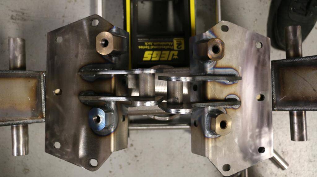

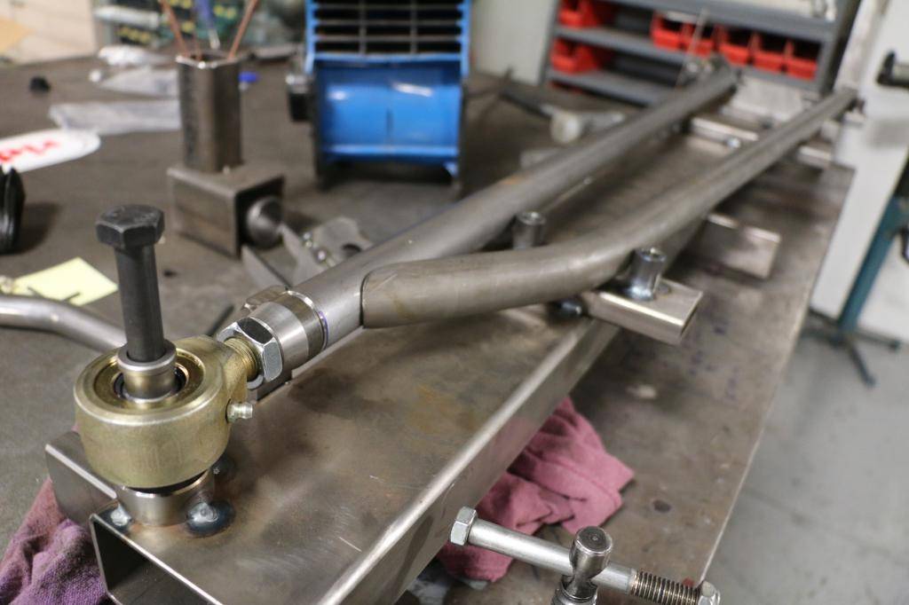

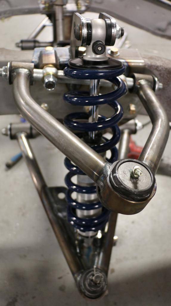

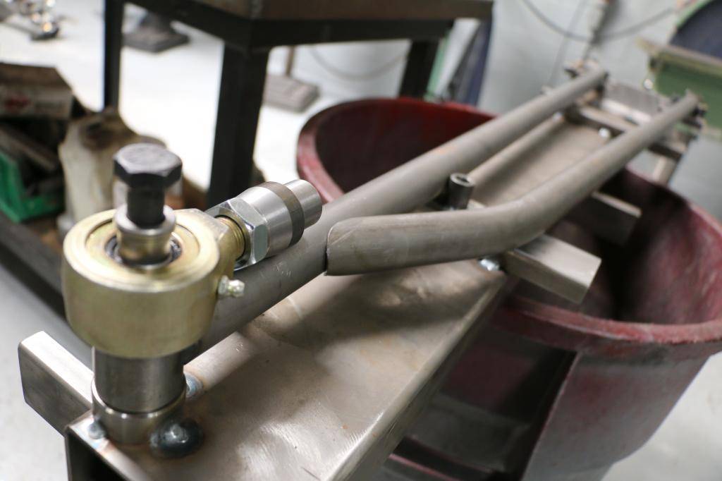

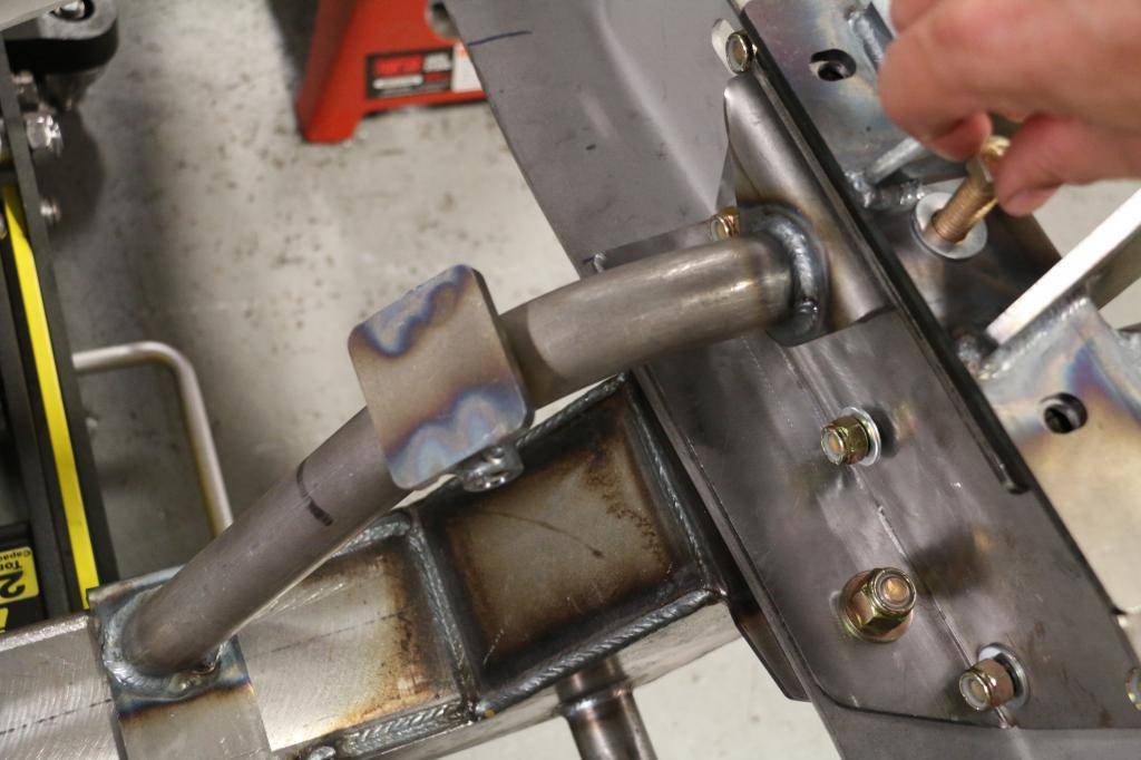

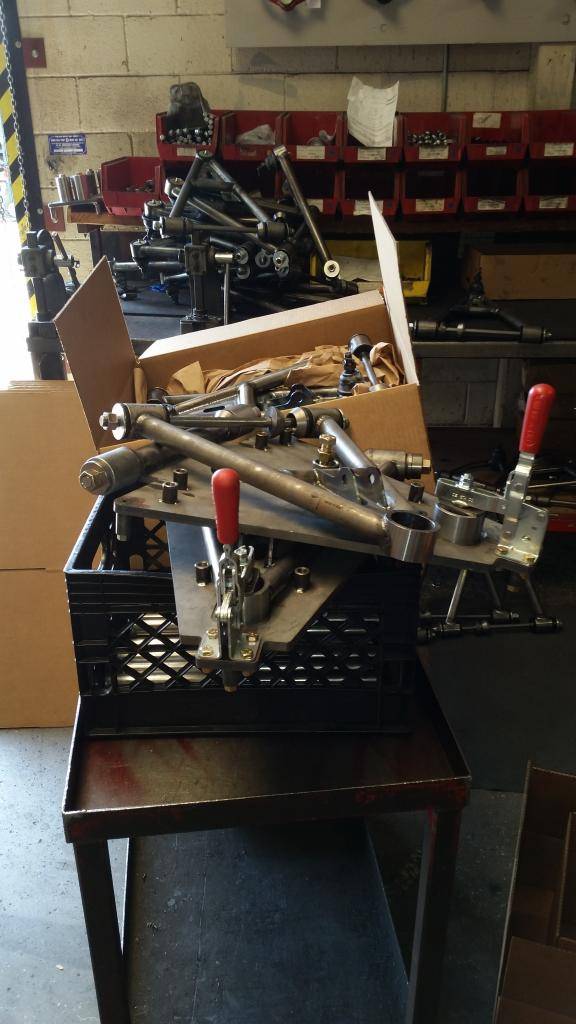

      We're a couple days behind schedule but here are a couple updates.
      The time studies for the crossmember and lower control arms are complete after 10 sets were finish welded.
      A small but significant change to the Torque Arm.
      -J
      www.totalcostinvolved.com

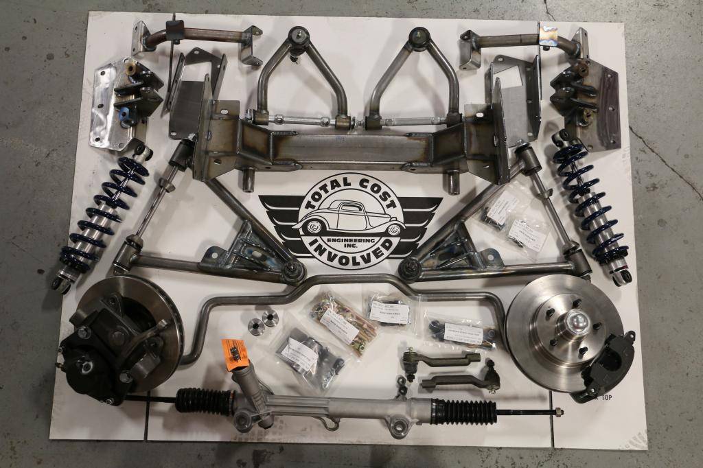

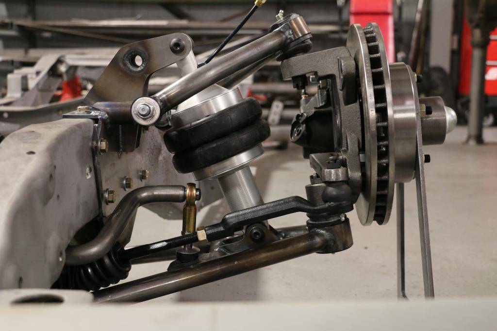

      The release of the front end is official, parts will begin shipping in two weeks.
      -J

      Very nice set up you guys have come up with. What did the alignment specs come out to and how much adjustment is there?
    16. #76
      Aug 2014
      1
      Do you have a similar flyer for the rear end? If not what does the pricing look like?

      Sorry for the delayed responses, it's been a crazy couple weeks here at the shop.
      Quote Originally Posted by 4WardInv View Post
      + 6 degrees caster(+/- 2 degrees)
      +.5 to - 3 degrees camber
      1/16" toe in for street use
      Quote Originally Posted by Dmooreco View Post
      Not yet, but we are very close to releasing the rear suspension kit.

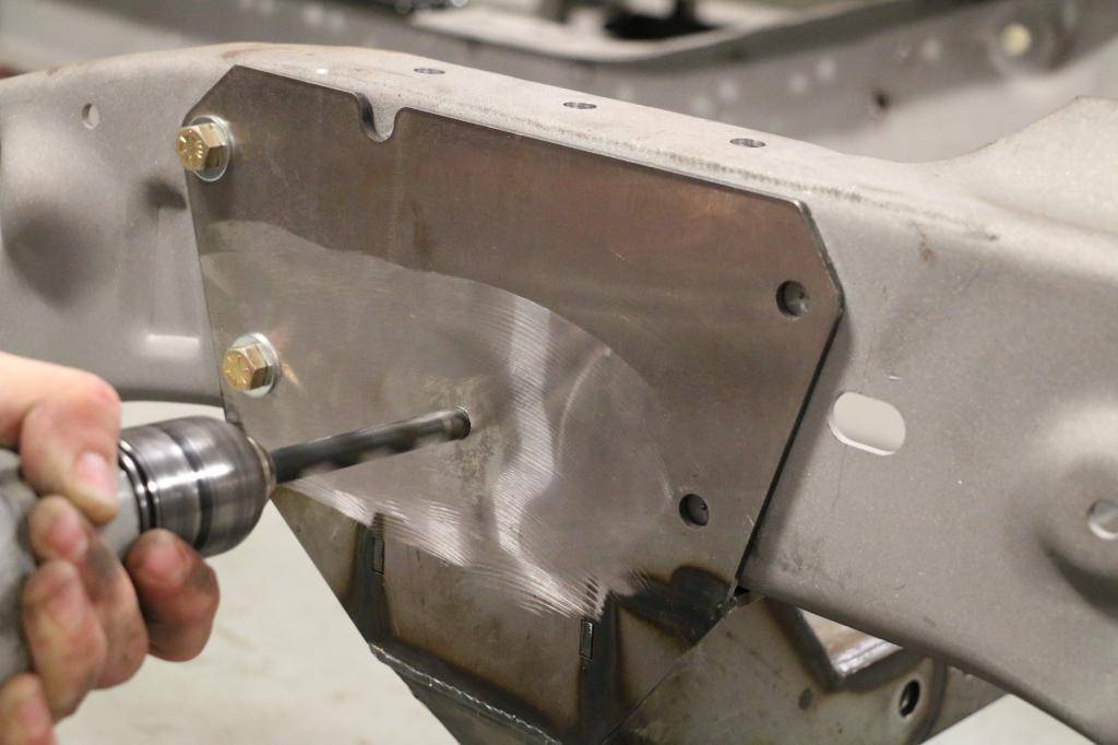

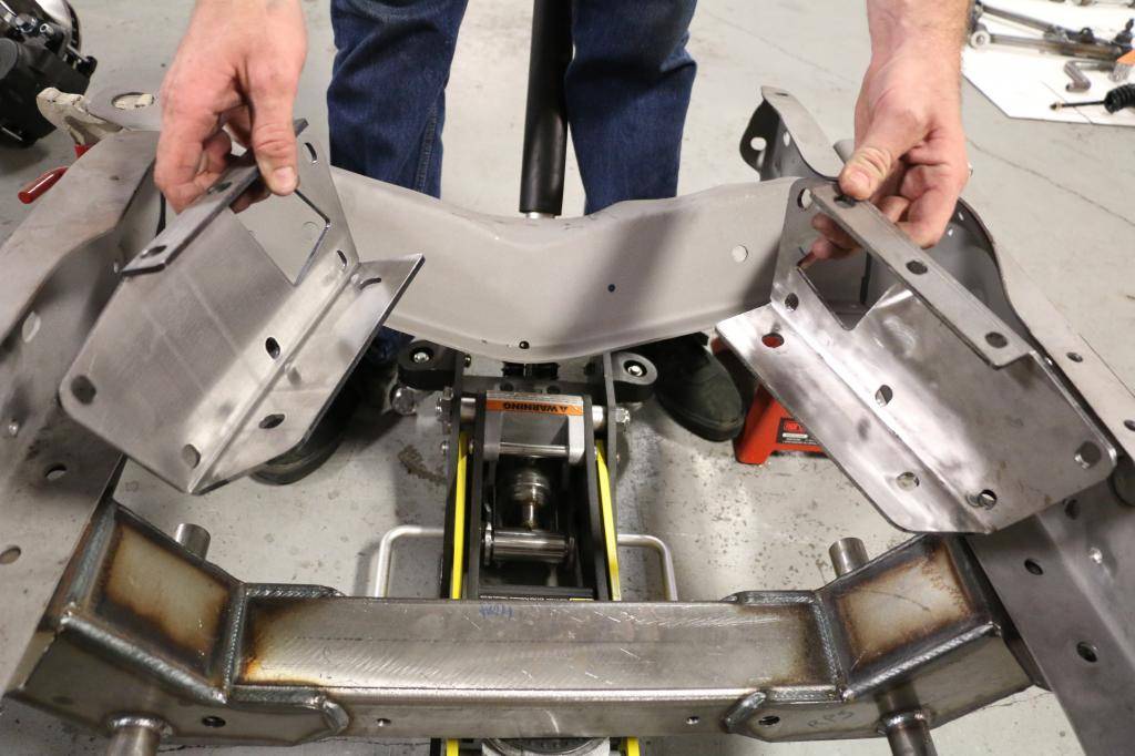

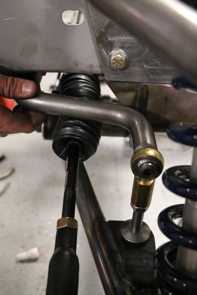

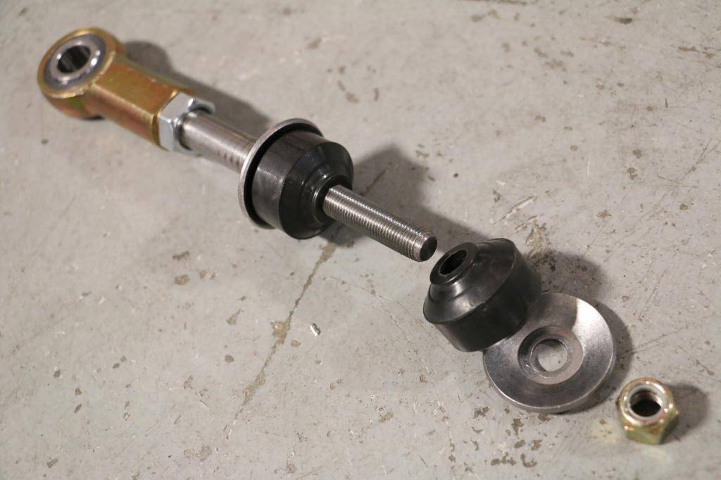

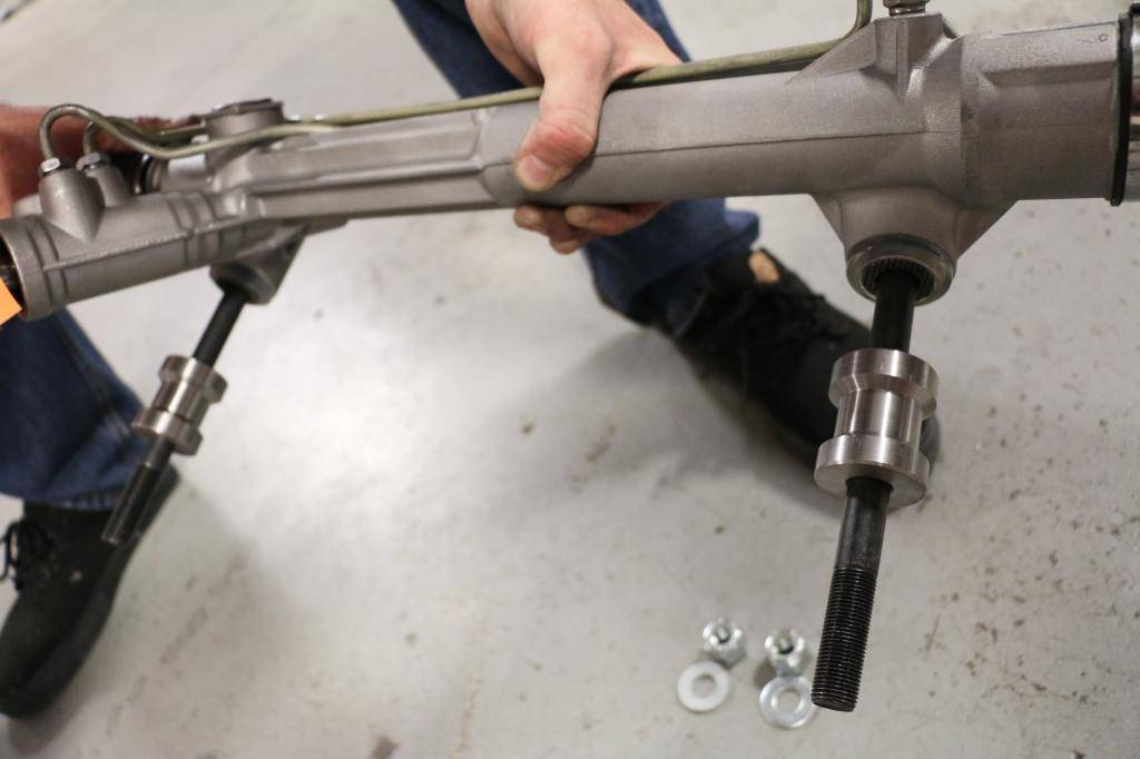

      I've been working on the Install Manual. Here are a couple teaser shots.
      -J

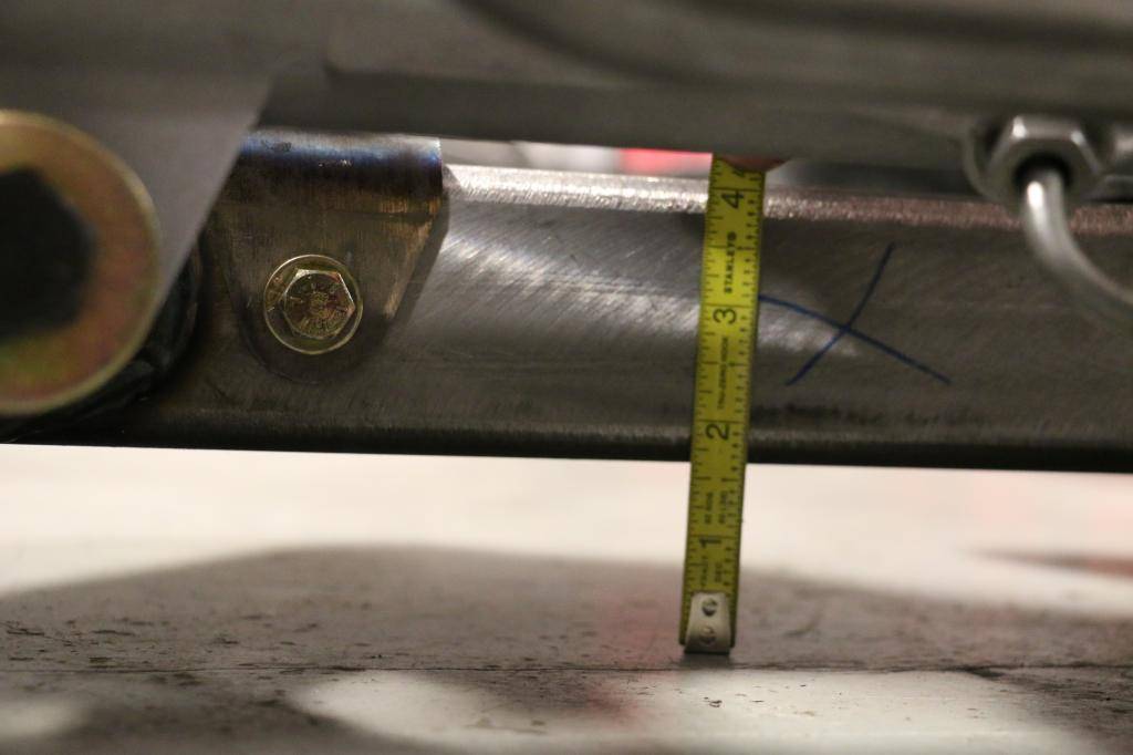

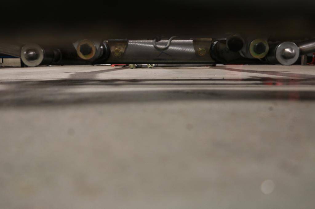

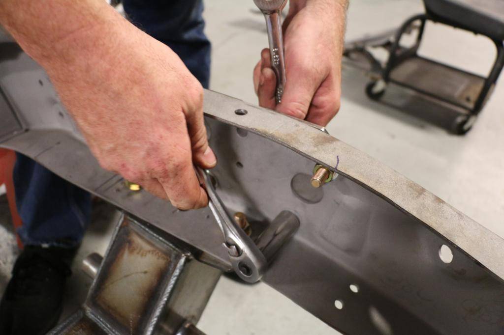

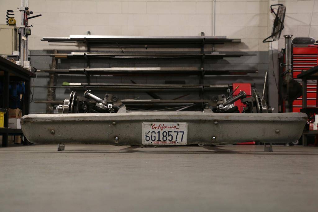

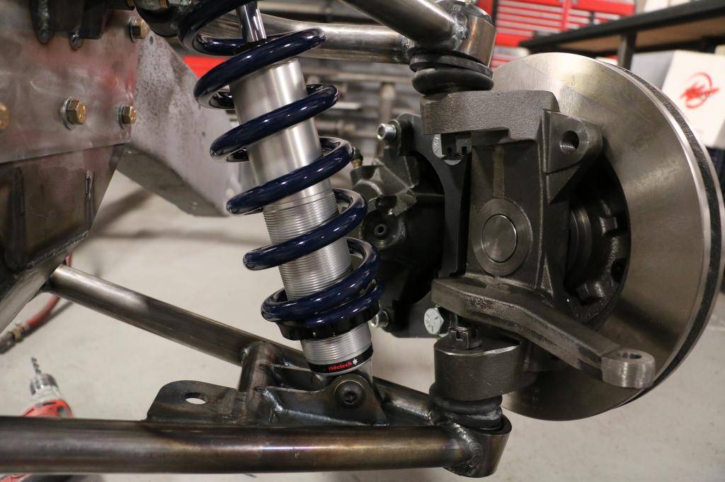

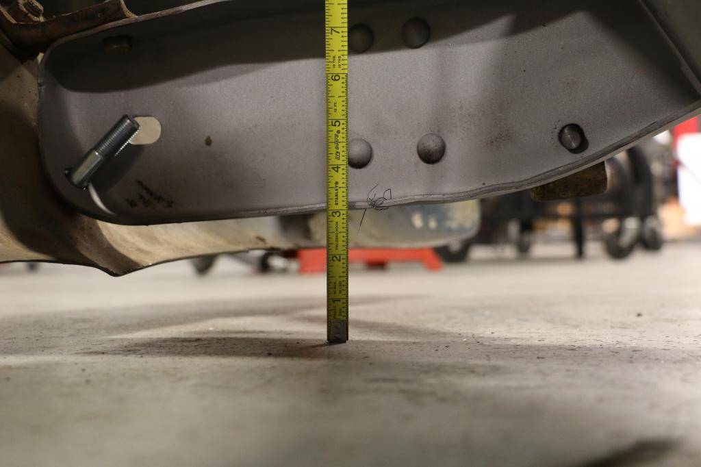

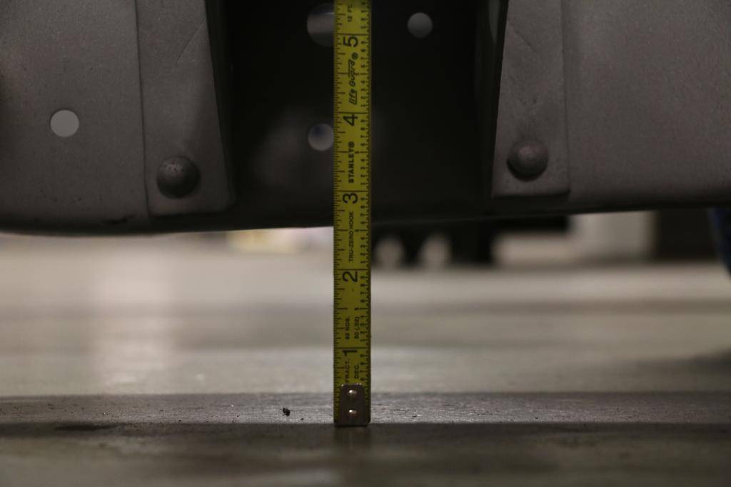

      Here are some of the pics from the shockwave mock up yesterday (based on a 26" tall tire). This is with the 2" ridetech shock extension, I am hopeful the 1" top will clear the control arm cross shaft. This will give another 1.125"-1.25" of compressed travel but will keep the suspension below its designed operating range. I will mock these up today sometime just to know.
      Our bumper is bent up on the driver side so the frontal view looks a little off. The driver side is roughly an inch higher than the passenger.
      Looking underneath the bumper at the crossmember.
      This picture is a little deceiving because I couldn't get the camera low enough to get the true height. The crossmember is closer to 1.5".

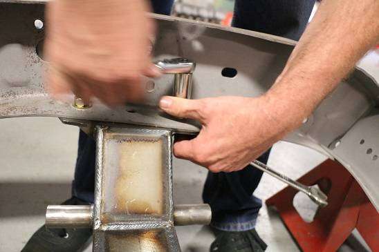

      The front frame head just behind the front bumper. Keep in mind that the rear suspension is still at ride height so once it is aired down this height will actually go up.
      This is the front cab mount. Keep in mind that the rear suspension is still at ride height so once it is aired down this height will go down.
