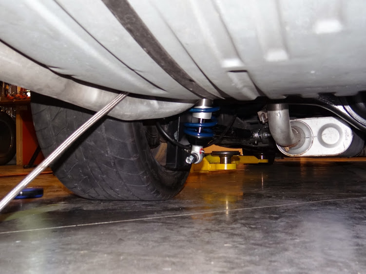

      Here are some pictures of my "Made by Lance" Lower shock mount brackets for my Quick Performance 9" rear axle housing.
      These were taken with the shocks at full compression, no springs installed yet.
      Probably about at ride height
      With springs on sitting at ride height.
      Fully extended with springs
      The shock travel with the mounts in this manner basically mimic the shock travel I had with my stock style shocks. Full compression is about 13" center to center, ride height is about 15.5" and fully extended is 20". The bump stop on the shock contacts the shock body just before the bump stop on my axle contacts the frame.

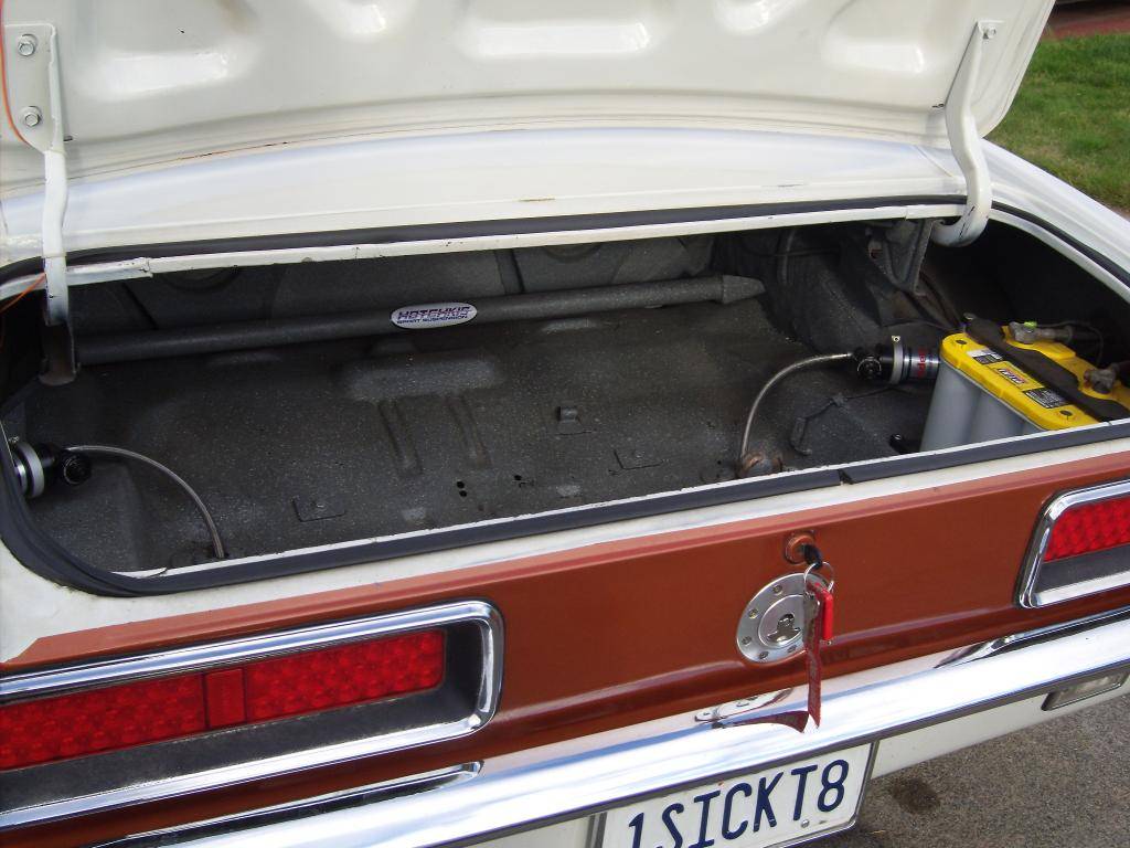

      Still trying to find a good spot to put the reservoirs, welcome any suggestions in this matter.

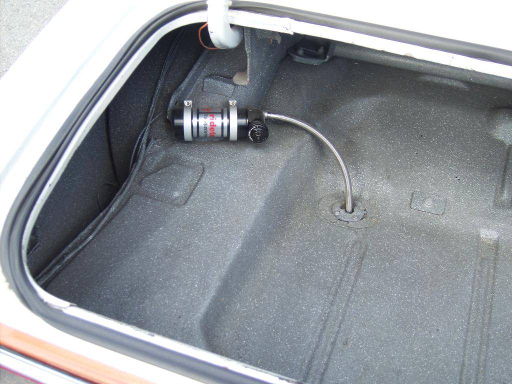

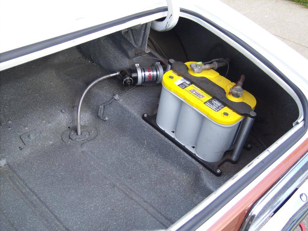

      I'm leaning that way Rod, thanks for posting the pictures. Just hate to have to cut that big of a hole in the trunk. Also trying to figure out how to plug the hole up afterward, in a manner that is removable in case the shocks ever have to come out again (likely)
      Lance
      Lawrenceburg, TN
      4,098

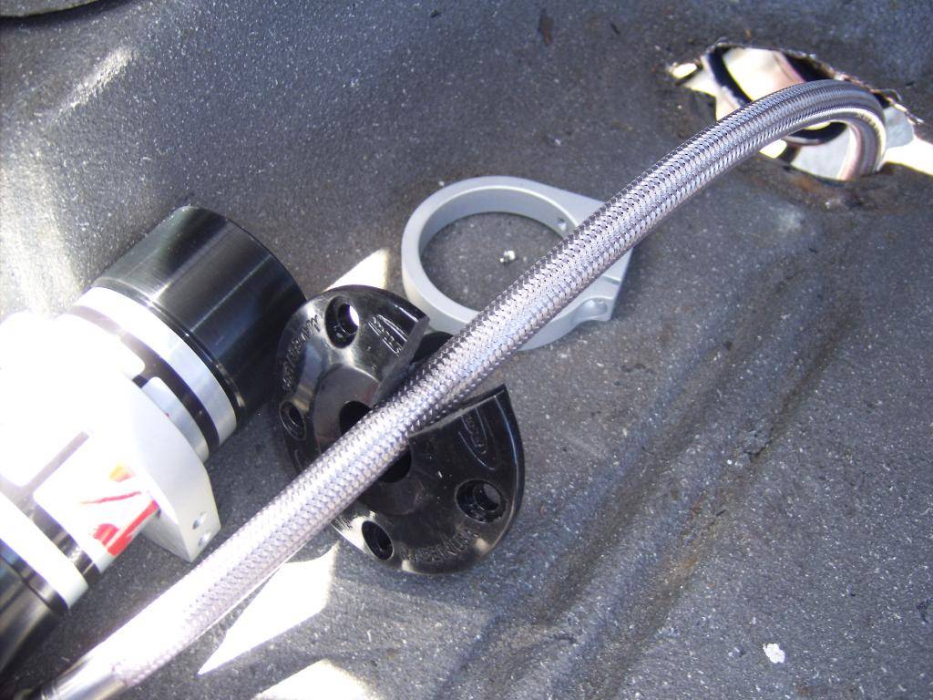

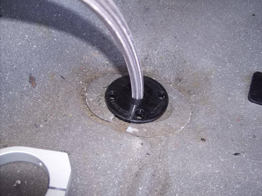

      I used hood pin mounts that are made of urethane, as a buffer between the hose and body and came up thru the trunk drain holes
      I cut the side open
      then screwed it back to the drain plate

      My drain hole is in the spare tire well...that ain't gonna work. Looks like my hoses are long enough though that I can cut one hole in the center of the trunk over my rear axle, put both of the reservoirs through it and then point them back to their respective sides and attach the mounts. Then put some type of a plate back over the one hole with something on it to seal the lines up. Have to look at one of those poly hood pin plates to see if there is room for two lines to go through it.

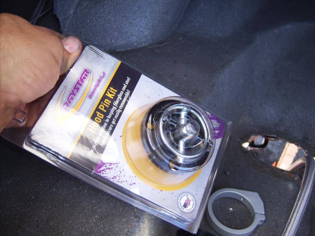

      I just ordered some Daystar Hoodpin grommets on Amazon. You can order the grommets only. 8$ each.

      http://www.sealsit.com/grommet_split.asp .....also works for the big hole in the trunk. Seals tight.

      Nice... I just cut a 3" diameter round hole in a piece of cardboard and the resi will fit through it if you tilt the part where the knobs go through the hole first.
      Now I just need to decide if I want 1 or 2 holes in my trunk floor. If I put the holes near the shock itself I may be able to keep the hose away from the tail pipes a bit better than if I put just one hole near the center of the trunk.

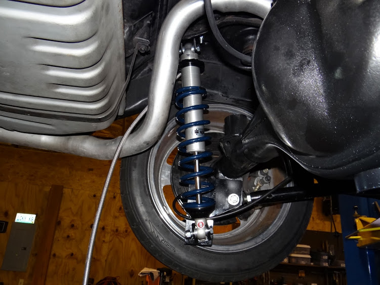

      Here is one of my rear shocks, spring installed, and retainers set at ride height fully extended.
      I believe that is an 8" spring, I'll measure again tonight, but I doubt even a 10" spring would stay loaded at full extension with the cups where they are currently at.
      Fully compressed, center to center shock is 13", ride height is about 15.5", and fully extended is 20"

      The spring is a 12" unit.
      you will not be able to preload the spring when fully extended as you have a very long shock in the rear (to replicate what you had previously).
      If this were an "off the shelf" kit you would have a 5.2" shock, which would allow the spring to have a slight preload on it when at full droop.
      The shock you have is the same as what our kit offers except for length.

      I got you now Britt, thanks. I will just make sure that the spring is seated in the retainer cup correctly each time it's let down off of a jack. I've done it several times now and it seats right every time. I might take the delrin washer out of that end of the spring though just to keep it from getting tangled up as I can see that happening.

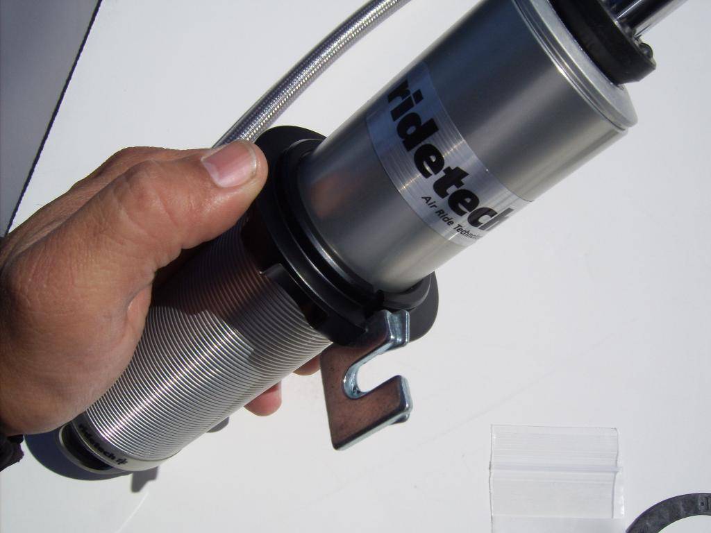

      Quote Originally Posted by SSLance View Post
      I had a bit of trouble getting the upper spring retainer cup over the ridetech logo sticker on the shock body and part of the sticker got caught in the threads and freaked me out a bit when putting one of them together. Hate to say it but if I ever have to do that again, I'll remove the sticker and clean the body real well before putting the retainer cup on to prevent this from happening.
      ok. not to hijack this but since many are watching the thread heres a tip on shock assembly to help others,
      use a screw driver to spread the collar and insert some body shims to hold it open it will also tread on to the shock body with more ease, then simply wiggle the shims out of the collar when done and keep building
