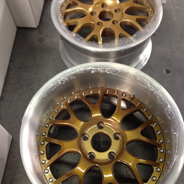

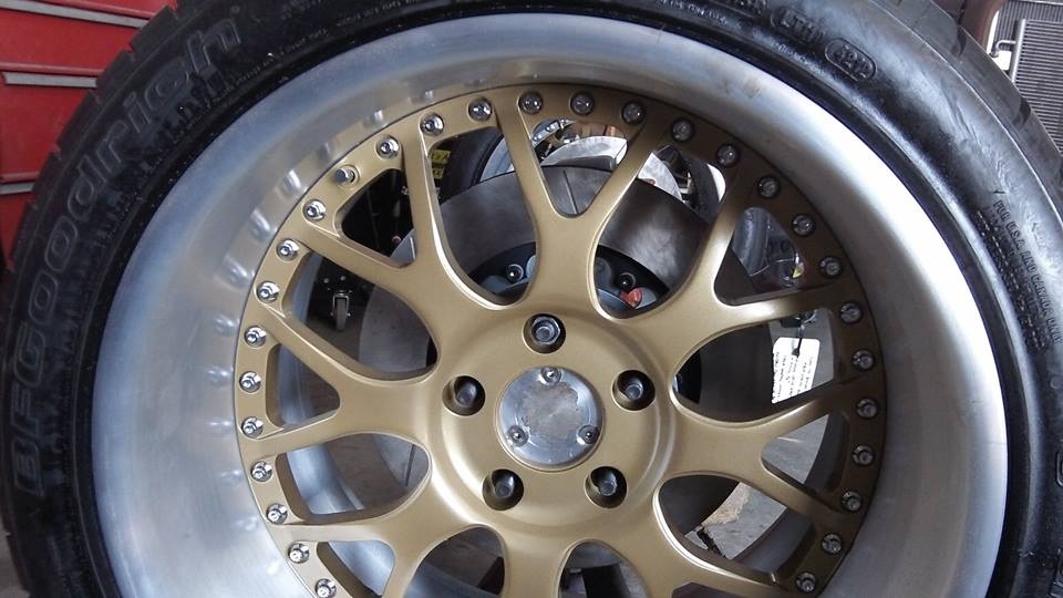

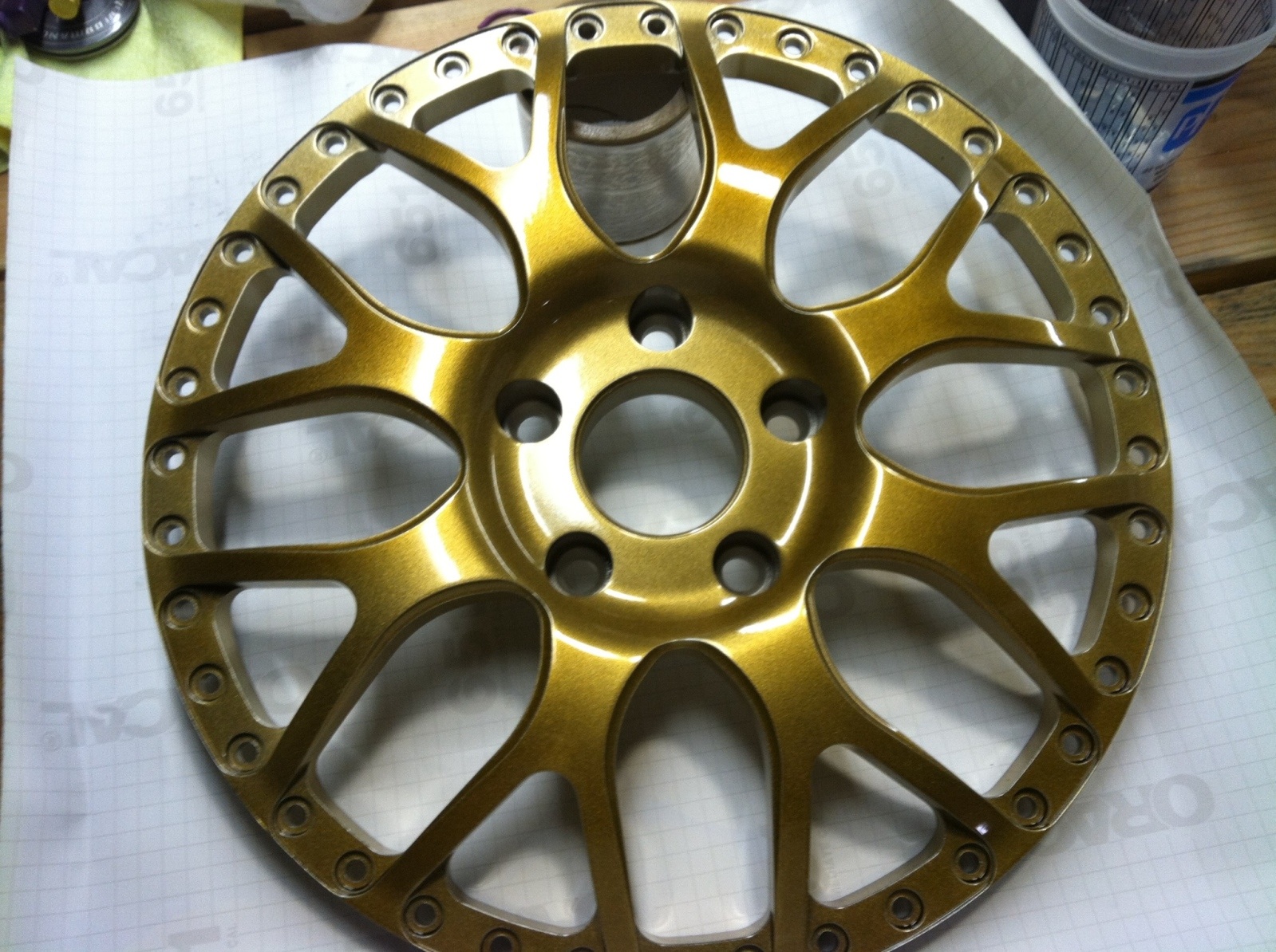

      And some pictures of the wheels from True Forged. The gold center was the first stab at bronze. The first picture is exactly what I was shooting for. It was Monaco Copper over silver. Gave it a bronze look. Brian at The Powder House stuck with it and got it right. Wheels are True Forged Competitions in 18x9.5s and 18x12s. Name:  image.jpg

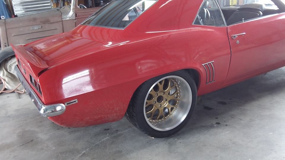

      Soon they'll be in my garage. Name:  image.jpg

      Harrison, AR
      78

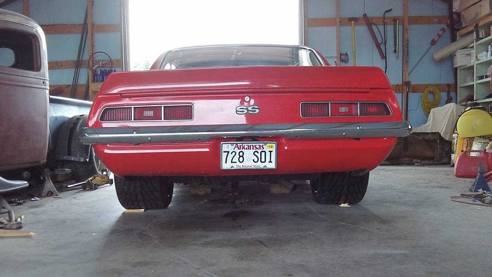

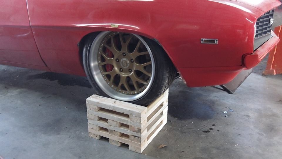

      The 18x12 rears were a 6" bs. I wanted the calipers and floating hub assembly inside the wheel since 335's will be tight anyway.

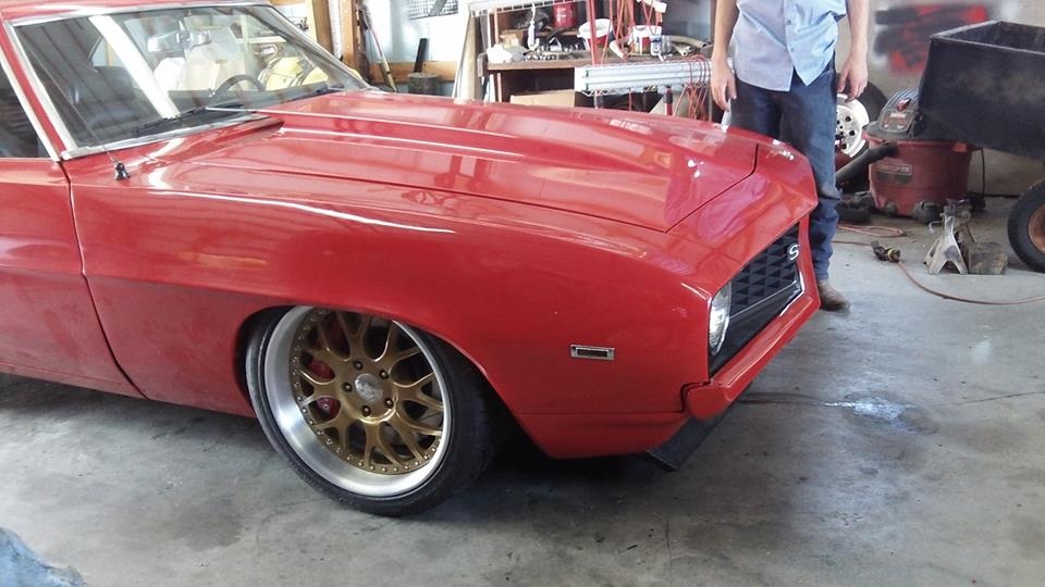

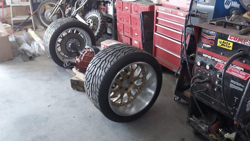

      Harrison, AR
      78
Size:  111.8 KBName:  image.jpg
Size:  111.5 KBTesting wheel fitment. Plenty of room to spare.

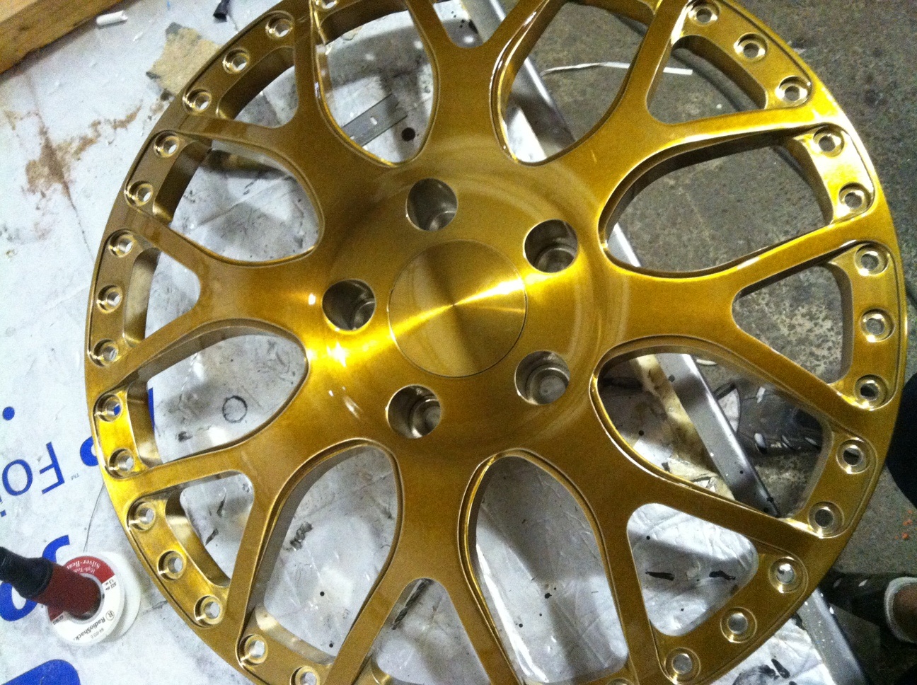

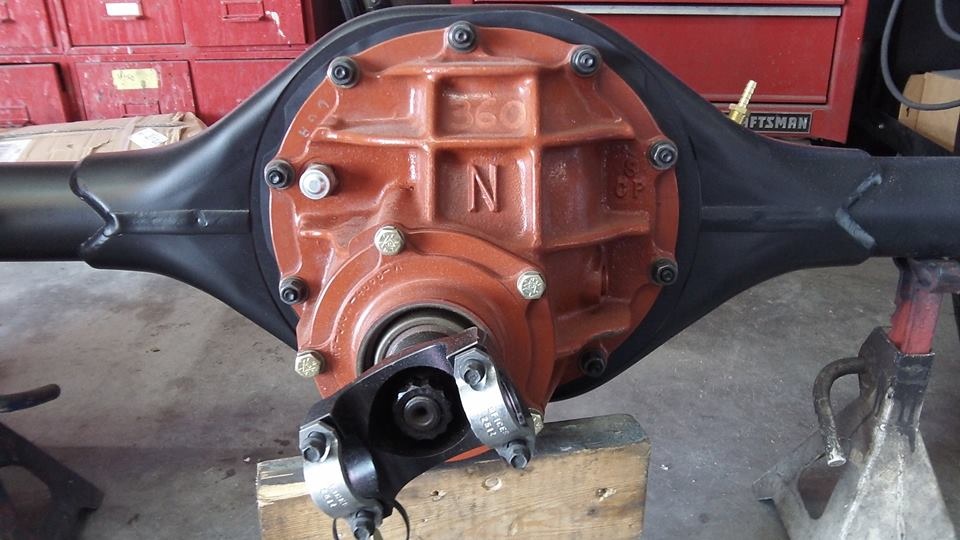

      It's been a slow go but I finally have an entire, properly machined, clean finished set of wheels as of February 2014Name:  image.jpg
Size:  139.7 KBName:  image.jpg
Size:  103.2 KBName:  image.jpg
Size:  102.1 KBName:  image.jpg
Size:  77.2 KBName:  image.jpg
Size:  144.0 KBName:  image.jpg
Size:  162.8 KBName:  image.jpg
Size:  141.6 KBName:  image.jpg
Size:  111.1 KBName:  image.jpg
Size:  135.6 KB. I have installed the True Turn system and made a quick test trip on the front wheels. Man I love this set up. Amazing difference in handling. I'm still working on the 9" floater. I have it mocked up on make shift stands so I can emulate the car at ride height. Working on making my lower links thanks to Ballistic Fabrication and Spohn Performance. I'll be updating now more often. Lol.

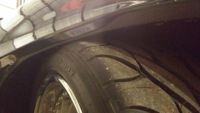

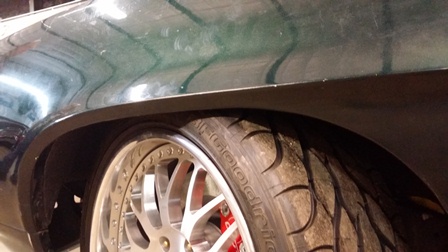

      i have what sounds like the exact same setup including kore3 brakes. only difference being tire size 265s and BS - I went with 6.25.
      My car rubs on the frame and the fender when i turn.

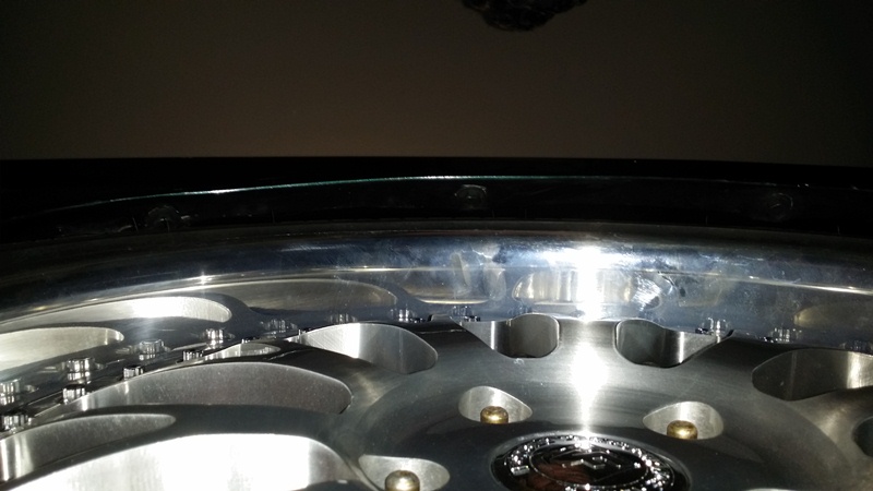

      Houston
      93

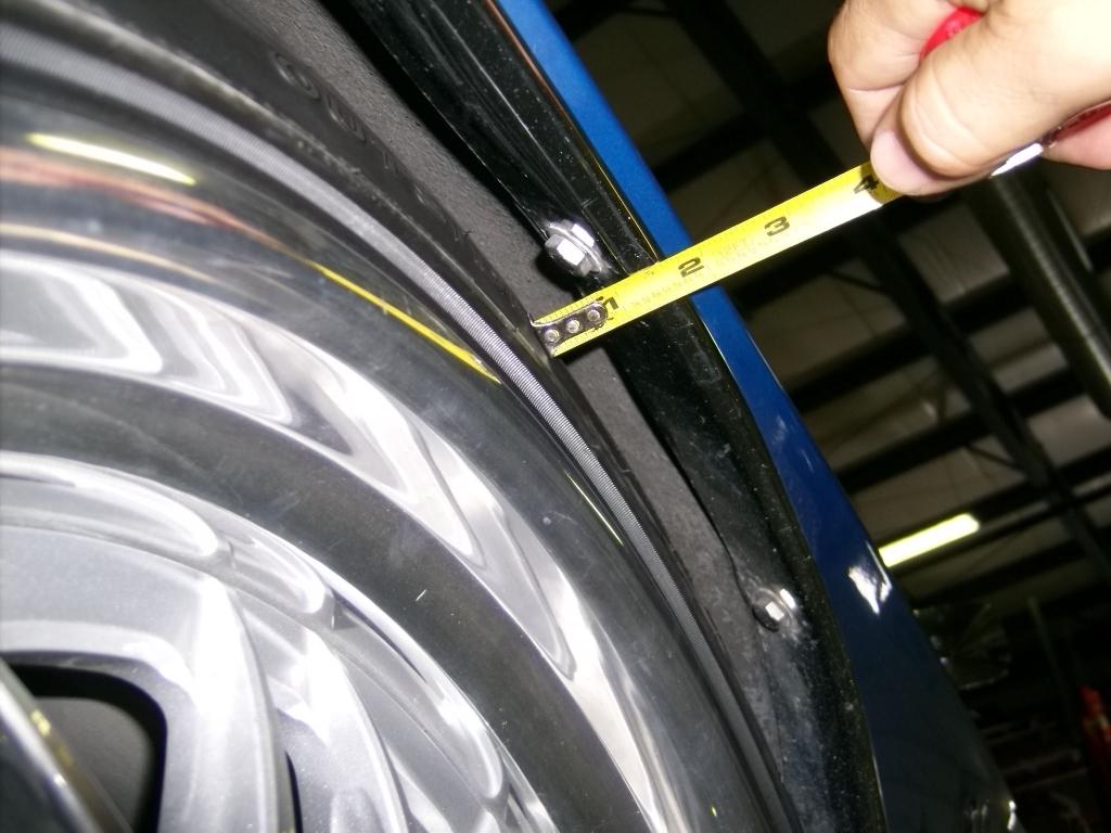

      My camber is at -0.44 currently. My rideheight is around 22.5'
      ridetech has ride height at 23 - 3/8" to the fender on a quick test fit up they did on the other thread.
      I don't understand why my tire sits so close to the fender. Clearly I need to take the bolts out but why is the tire so close to the fender even with my extra 1/2" of BS??
      What do you think?
      From ridetech's fit up
