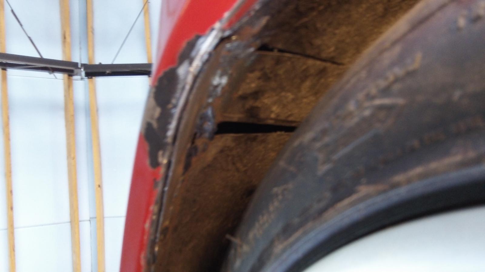

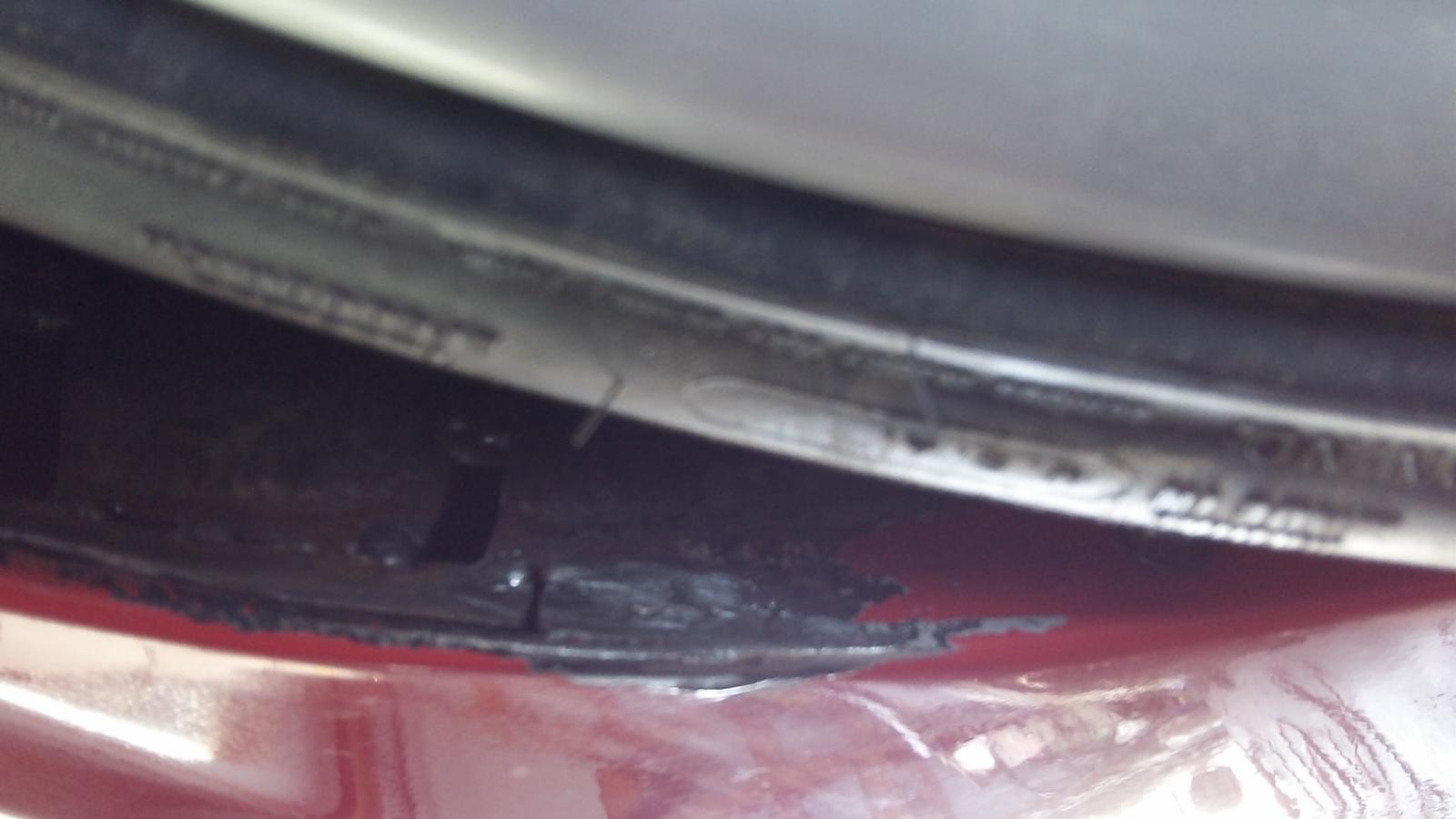

      Is this your actual ride height or has it moved up since this picture was taken?
      It looks like the tire would hit the bottom of the outer fender when you turn the wheel. (similar to mine in the above pics)

      No. That was with the air springs completely deflated. At ride height all of the wheel is exposed and about 1/2" of tire at top. Sorry. I didn't notice that the pictures I posted was not at ride height.

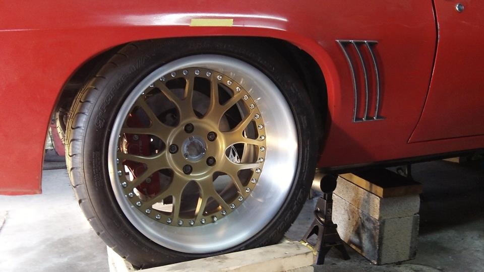

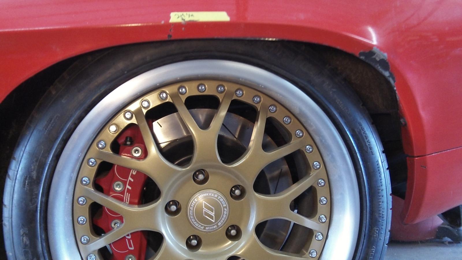

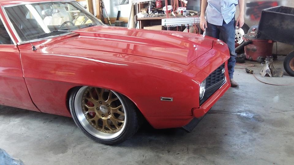

      Thought I'd post a few pictures of the clearance I have with the 18X9.5 front wheels with the 5.75" bs. I am not completely finished with the inners. Just for the guys that are curious.

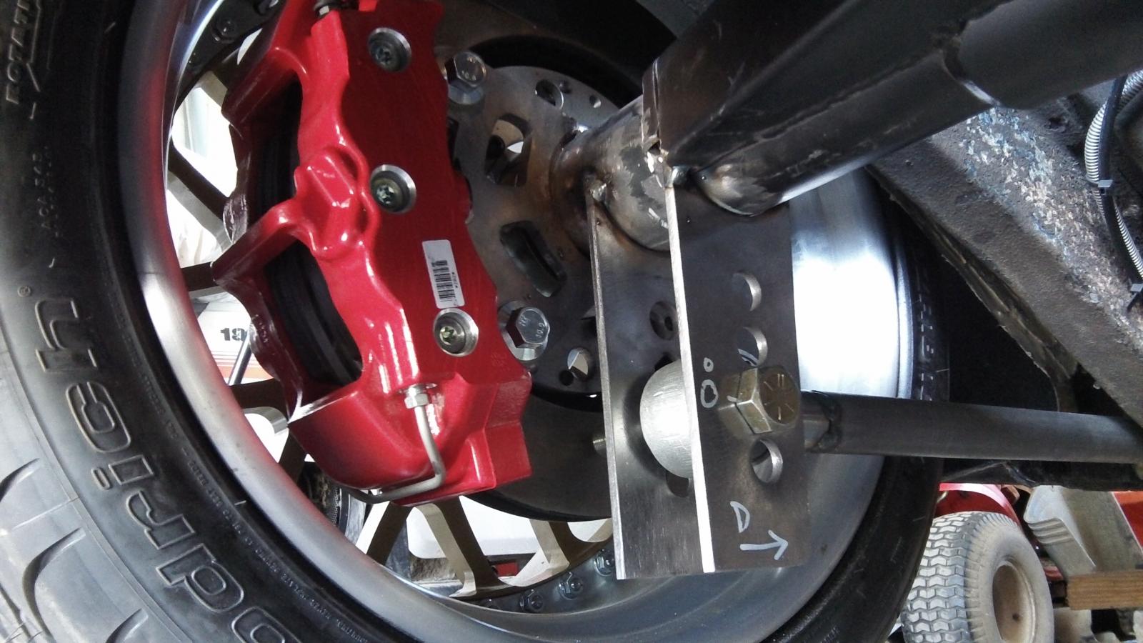

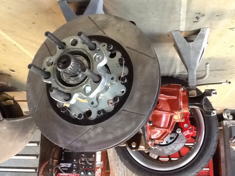

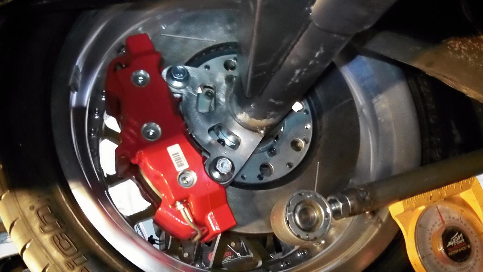

      78

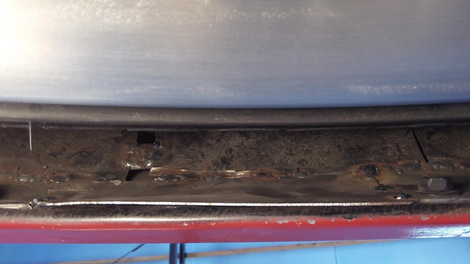

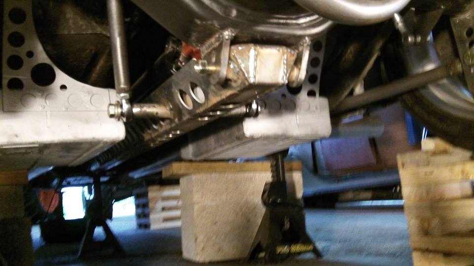

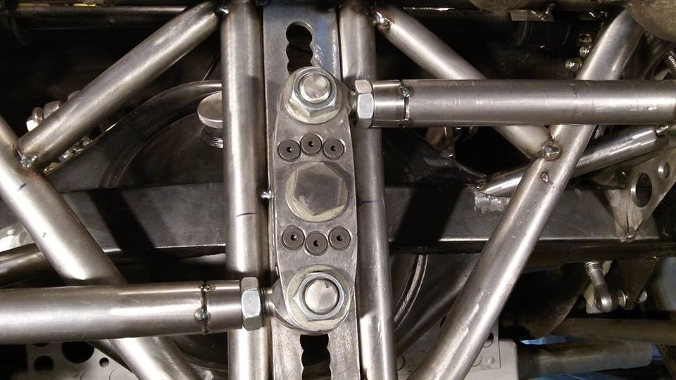

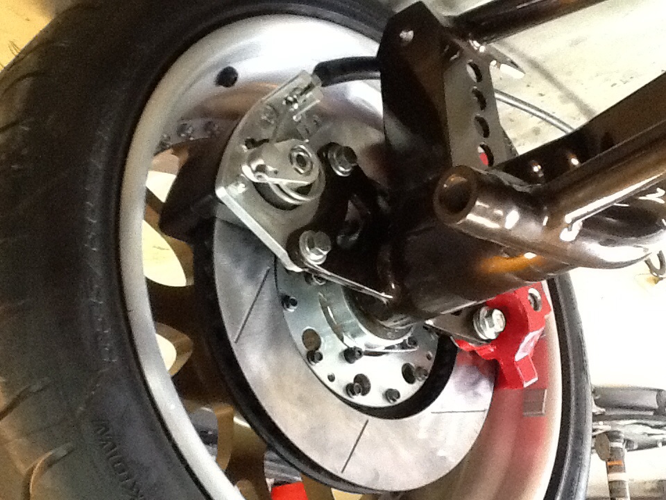

      A little more progress this weekend. Got the LCA's set in stone....or steel. Ha ha. Brake caliper mounts made and tacked in. Upper Airwave bar mocked up. And got started on the torque arm. I may go with 60" for ease of packaging. I will be able to mount directly to transmission mount this way. Thanks to Payton for the help!
Size:  147.5 KBName:  100_0318.jpg
Size:  170.9 KBName:  100_0313.jpg
Size:  134.1 KBName:  100_0316.jpg
Size:  107.1 KBName:  100_0317.jpg
Size:  172.9 KBName:  100_0328.jpg
      David G

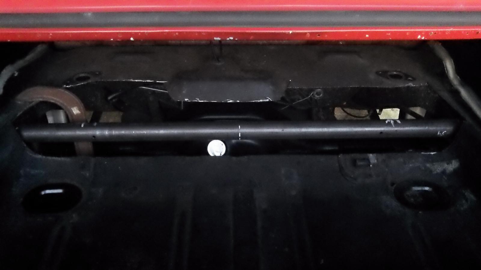

      Got the torque arm mocked up and lightened.

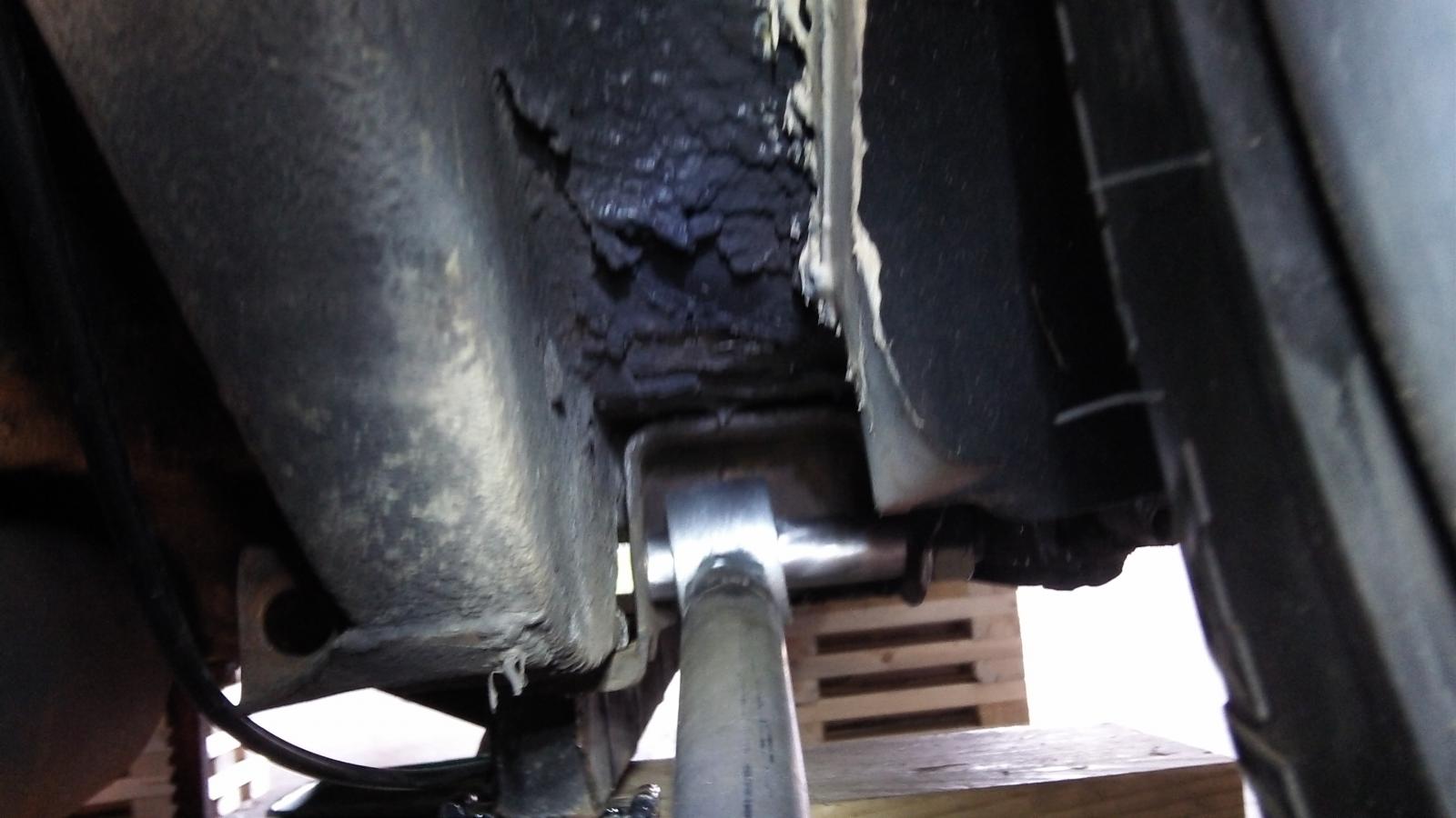

      Somehow I found room for the sway bar. What a conglomeration of things. Lol.

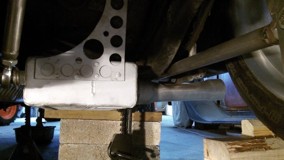

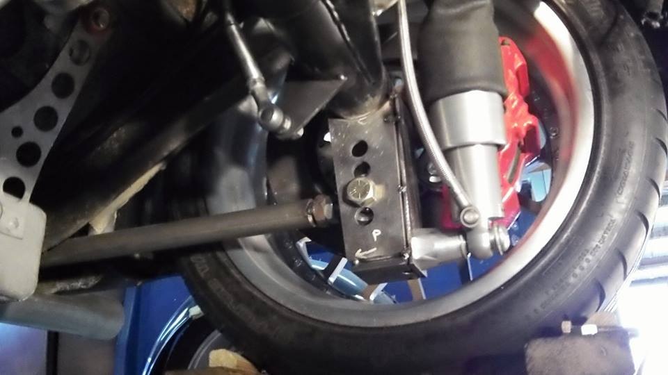

      And the Watts link mock up is finished.

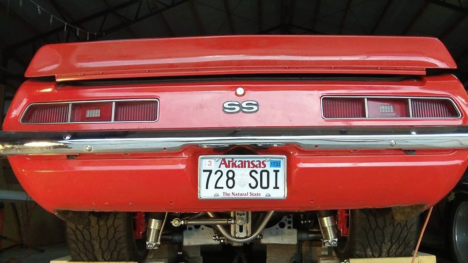

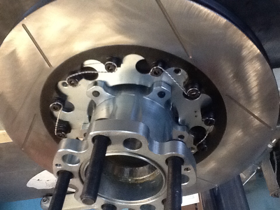

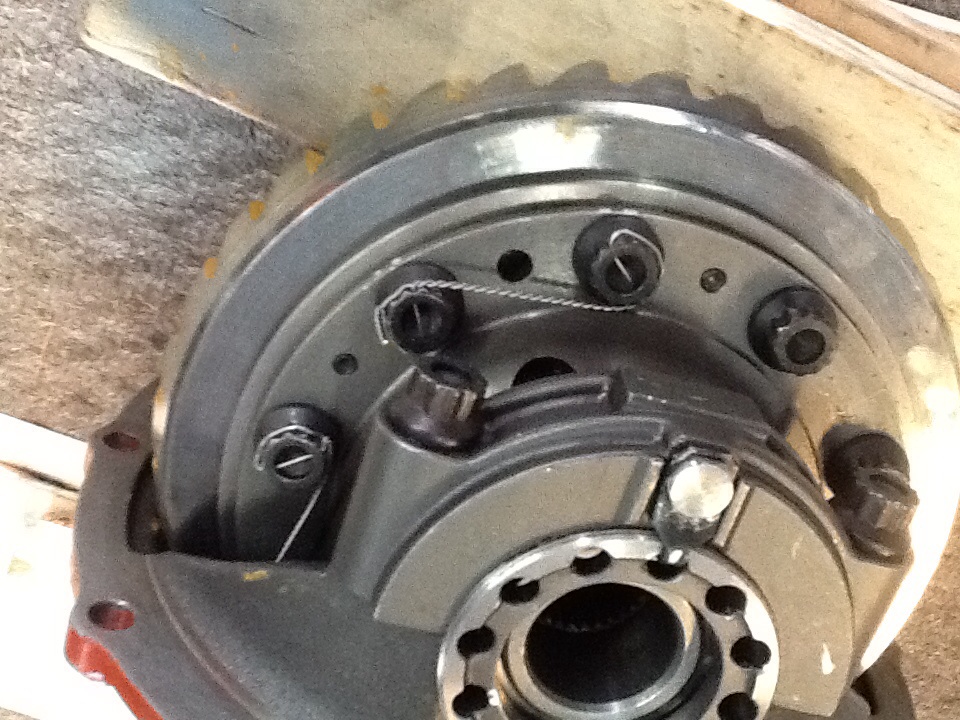

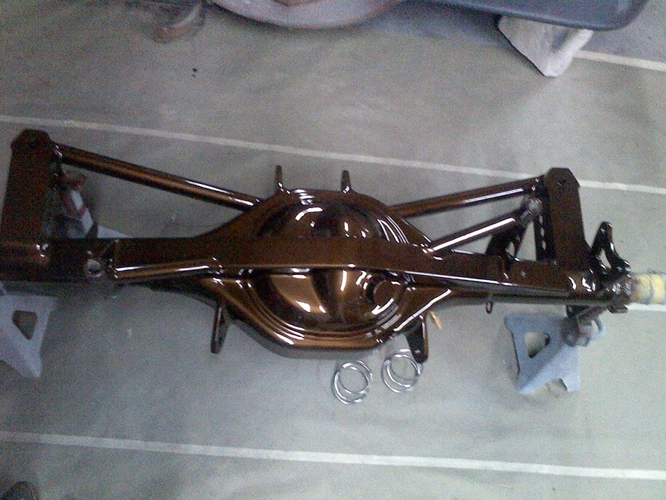

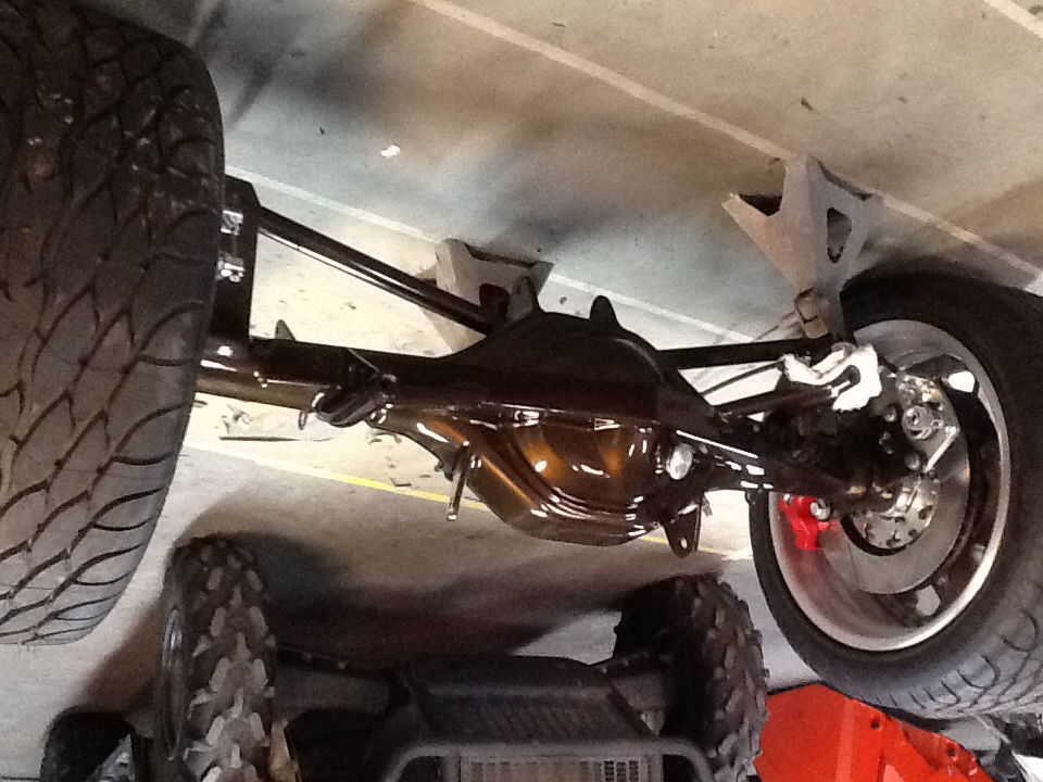

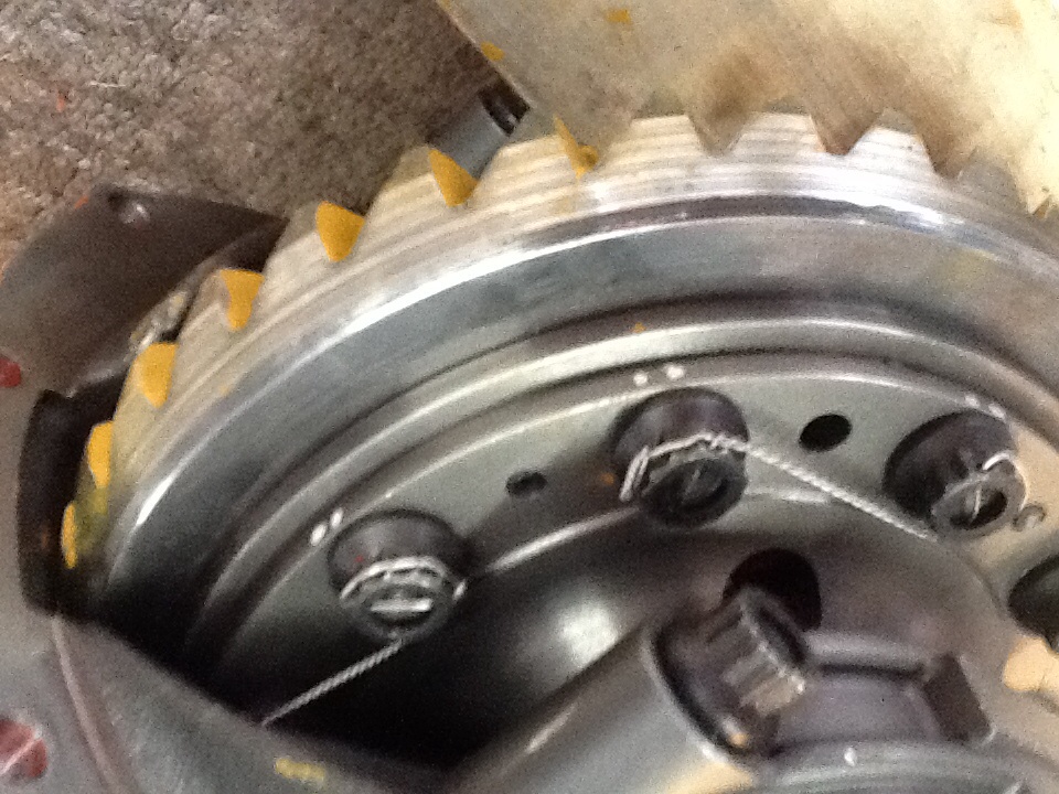

      It's been a while. Just a few mild updates. Got the rear painted, put back together, and saftey wired. What started out as an attempt to pick a color for the bottom side of the car has turned into a mind changer for me. I may now paint the entire car bronze. This color really pops in the sun.
      David G
    18. #38
      Harrison, AR
      78
      A few more....Name:  image.jpg
Size:  275.2 KBName:  image.jpg
Size:  262.6 KBName:  image.jpg
Size:  182.4 KBName:  image.jpg
      David G

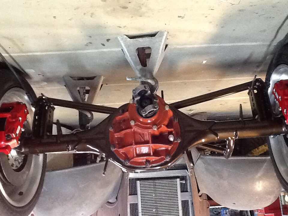

      And the completed rear.....
Size:  267.5 KBName:  image.jpg
Size:  237.5 KBName:  image.jpg
Size:  251.9 KBName:  image.jpg
Size:  293.4 KBName:  image.jpg
      David G

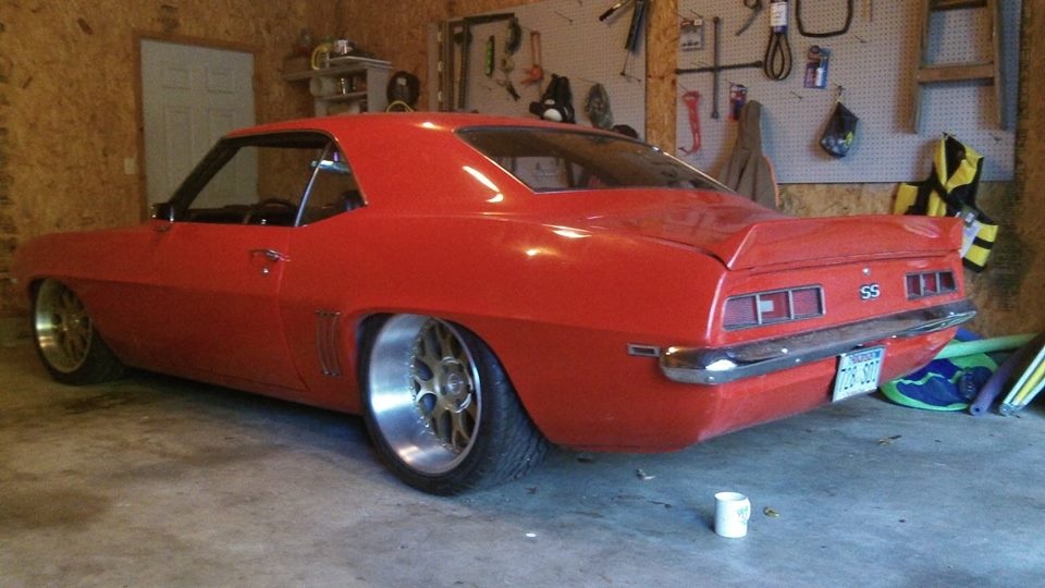

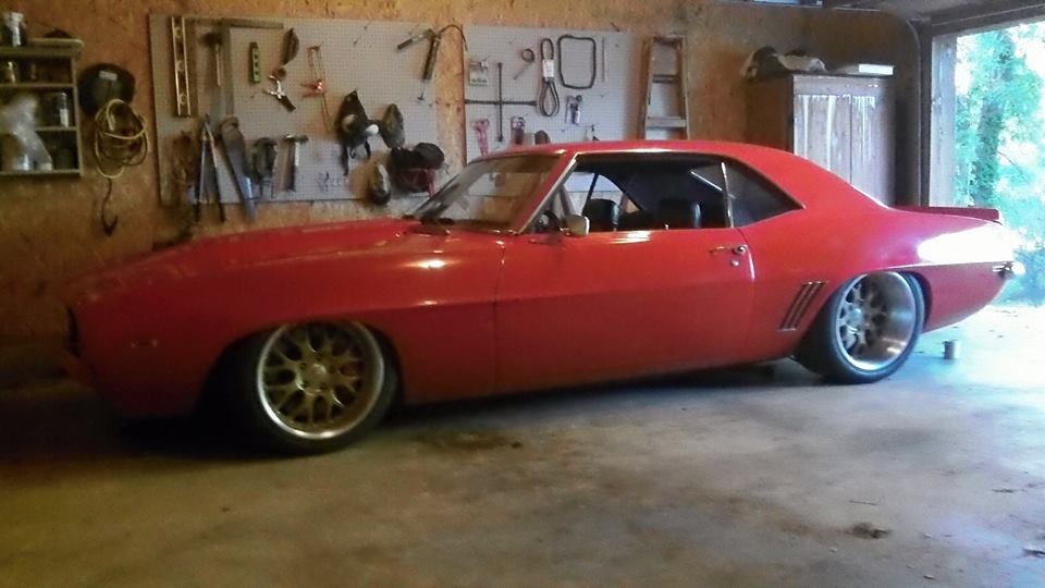

      78
      We'll I got the car back in one piece and have been enjoying it all week. I aligned the front end with camber of -1.5, caster of +6.0, and toe in of 1/8". I can say I am very impressed with the over all package. And have plenty of room in the front wheel houses now that I've adjusted camber properly. These pictures are with it laid out. I'll get some better pictures this weekend. This car is amazing. But I believe I'll ditch the Hawk HP+ pads for some ceramic. Hate the dust! And it is really eating up the rotors. I'll save them for future track day. Name:  image.jpg
