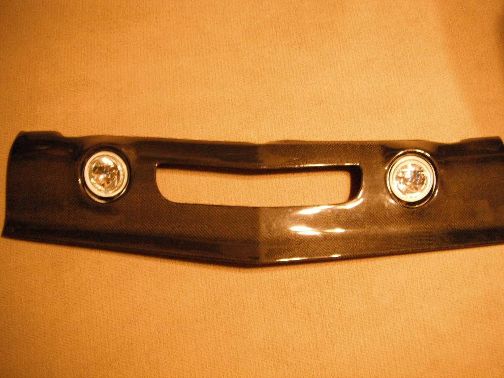

      Morris Classic Concepts lights. Had trouble fitting these. Pretty sure the valance mounting was off. Had to flip the visor for the light. Think I will powder coat the stainless visor for the lights to help them blend in. The lights are very good quality with glass lenses. The color of the led halo ring can be controlled from inside the car.

      Got the PSI harness as well! Very nice. You lost me on exactly what went wrong with the morris lights? Any close up pics

      The Morris lights comewith a polished metal shroud(bracket) that surround the lights. The part of the shroud that looks like a visor (sticks out) is supposed to mount mount in the hole in the valance facing up. It stuck way out when I mounted that way,so i inverted it. I am convinced that it is the aftermarket valance mounting points causing the issue. I had to elongate the mounting holesin the valance, and sand off some material to make it work. It looks good now.I am okay with the shroud being inverted, as it is just a gap filler. I will powder coat the shroud black and be done with it.

      I've heard there was some trimming neccesary.. My bumper is already painted. Thanks for sharing your experience to help me make my decision!
