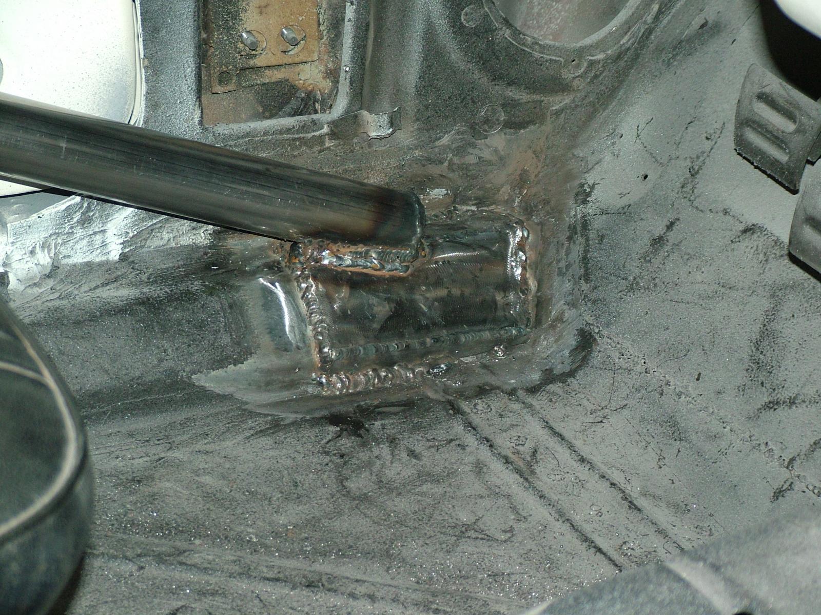

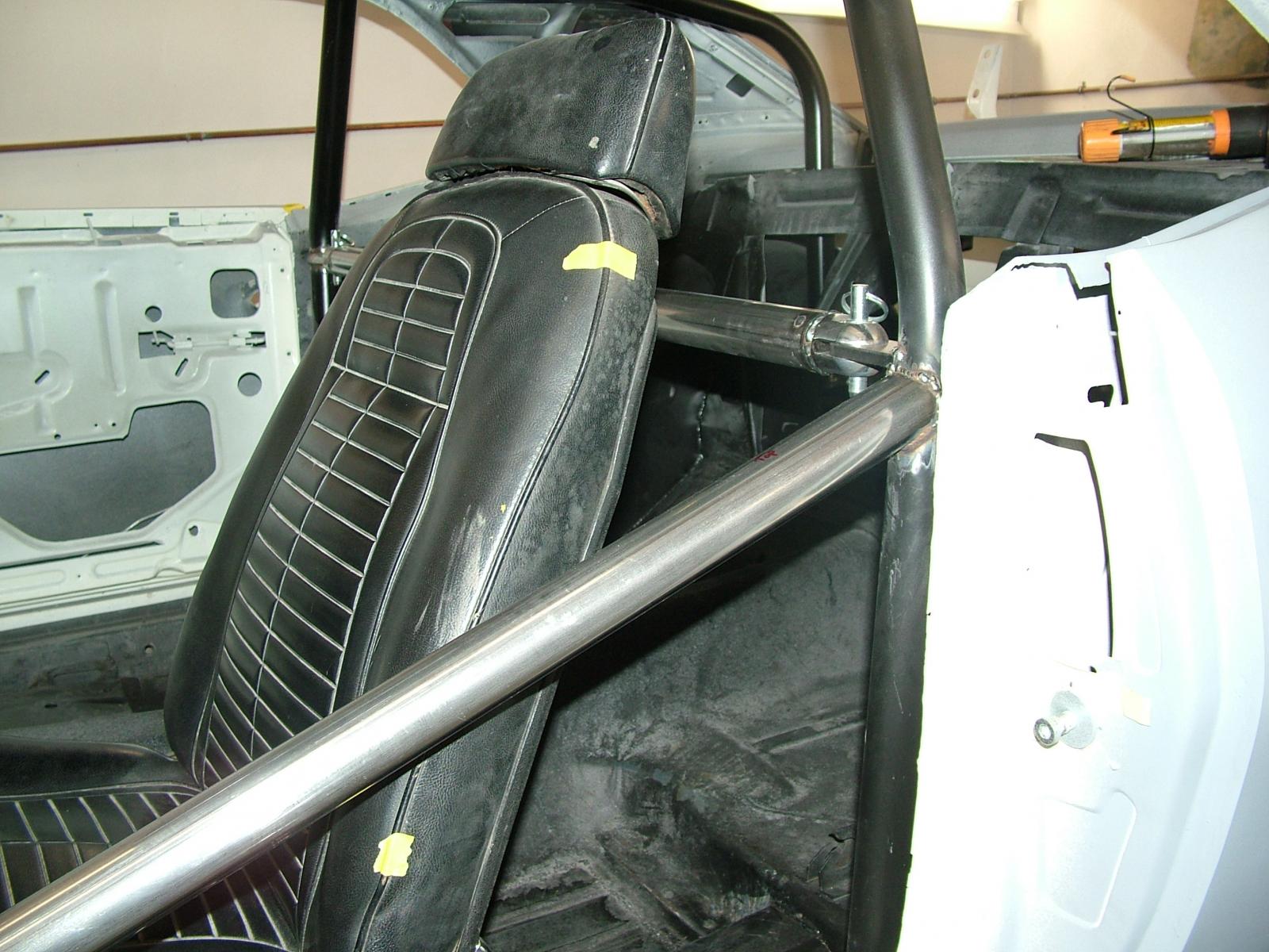

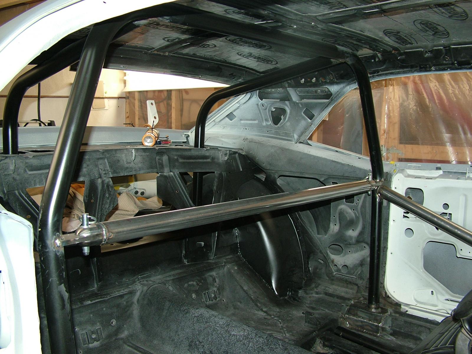

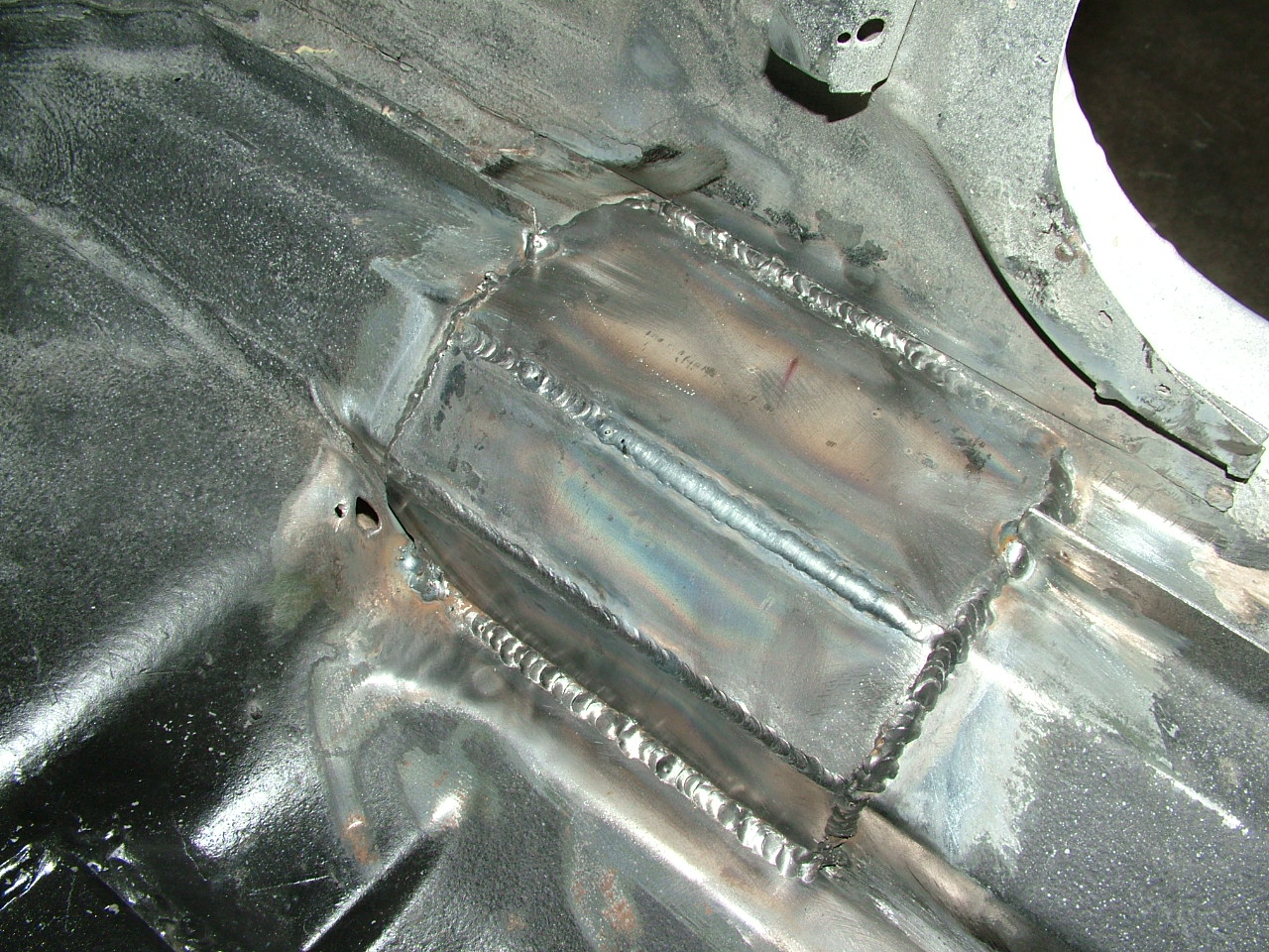

      I an finishing up installing a Chris Alliston 6-point roll bar.
      Do you happen to have pictures of the roll bar installations?

      Hope these come up:Name:  rollcage 012.jpg
Size:  265.1 KBName:  rollcage 008.jpg
Size:  232.2 KBName:  rollcage 010.jpg
Size:  346.3 KBName:  rollcage 005.jpg
      Houston, TX
      1,197
      Thanks for the pictures. Do they come pre notched? I will have to save up for the roll bar.
