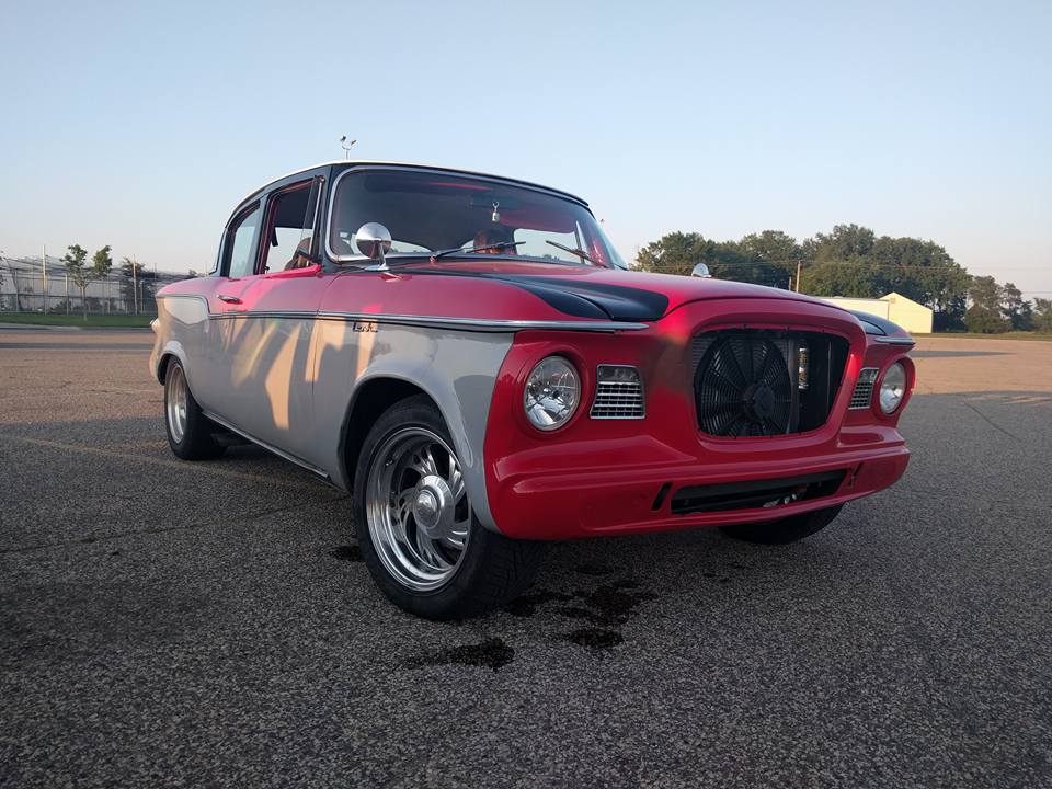

      Thanks Lance it has been I fun project. No build thread or posts...it was a bit of a lone wolf / internet stalker build. I am just now starting to meet some people with similar interests.
      Name:  first track night neal.jpg

      Did you end up using different caster/camber setting for the street vs course? I would like to find a compromise that would be ok for each.
