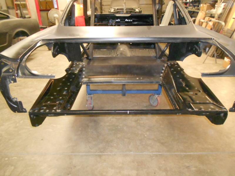

      Brian wanted to fit the mini tubs before installing the quarter panels the first thing he did was cut out the frame rail to make room for the new one that come in the kit.
      These braces come with the kit
      This is what needs to be cut out for the new mini tub. You can go in 2" or 3" we chose 2" because in you go 3" you have to narrow the supplied frame rail 1"

      I'm sorry I have forgotten to update
      Test fitting the mini tub and quarter
      Epoxy primed the inside of the quarters
      Installing the DSE mini tubs
      Roll bar installed before the quarters
      Couple of coats of SPI epoxy
      Quarters and taillight panel installed

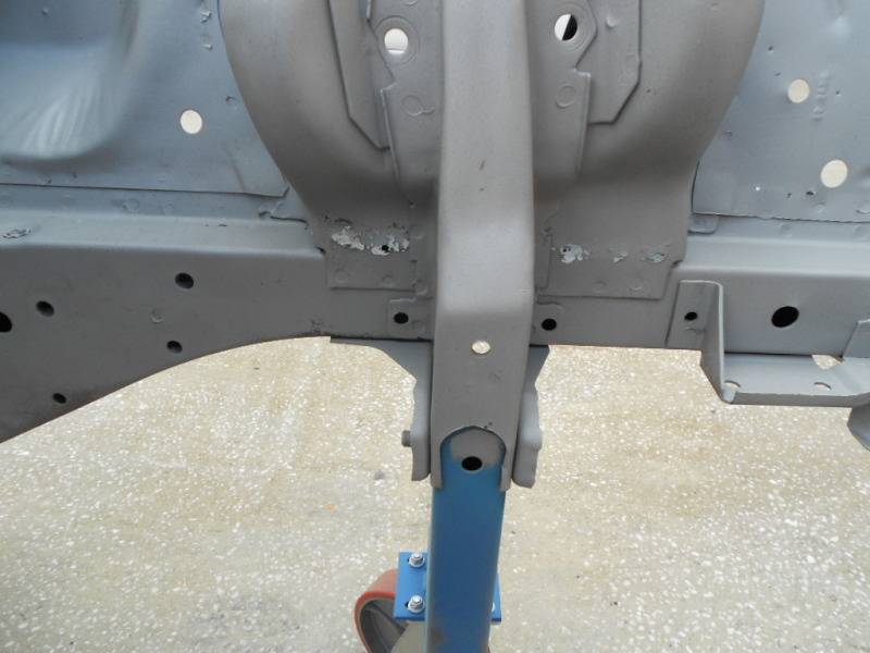

      The floor pan had to be replaced
      Brushed epoxy
      Installed torque boxes
      Test fitting
      Installing DSE subframe connectors
      Both front frame rails had a little rust
      We are waiting for the DSE rear suspension
