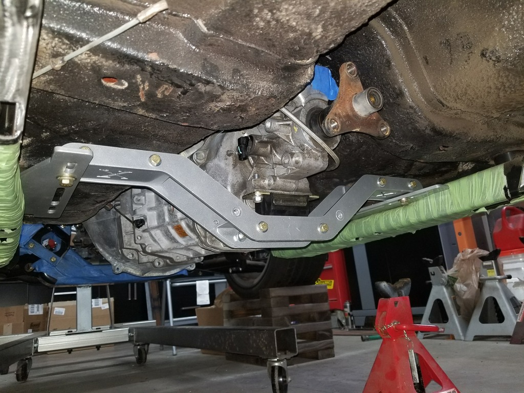

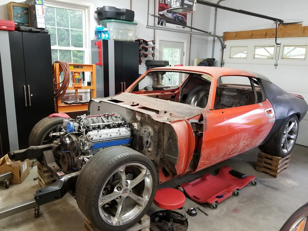

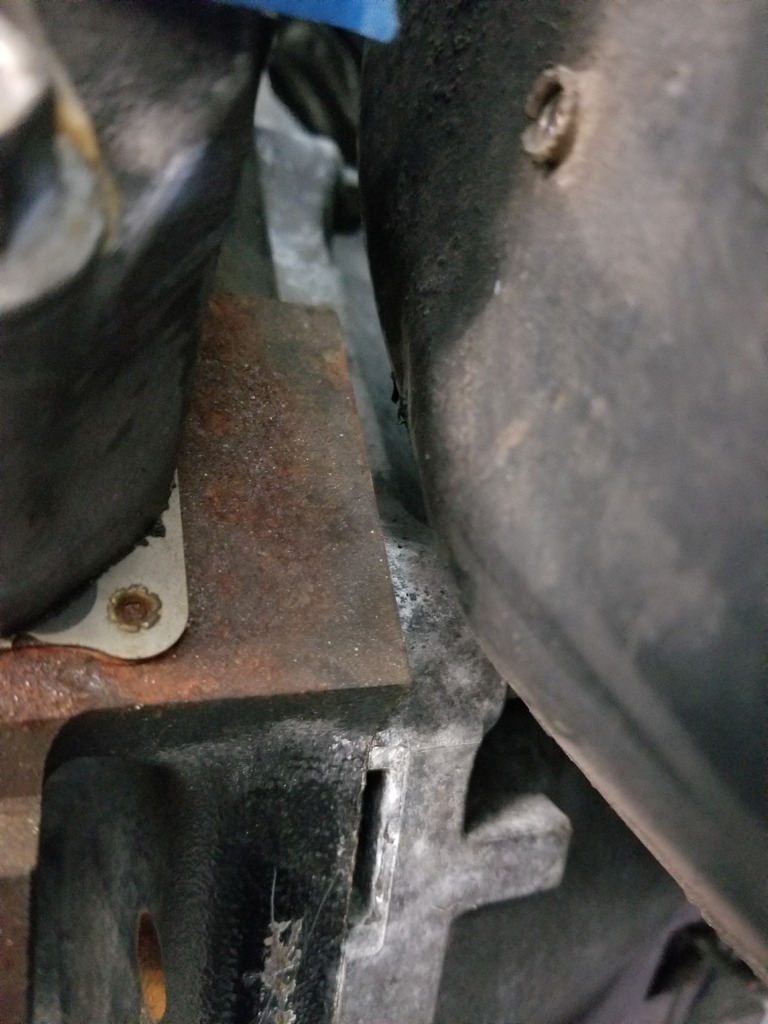

      Motor is in!
      For the first time in I don't know how many years the Camaro has a motor and trans bolted in! Had some trouble getting everything to fit, some firewall modes are required for example and had problems with the trans cross member from American Powertrain but was able to work through them. The AP cross member I used is their modular X Factor model. The 2nd gen mounting plates that bolt to the sub frame don't work with DSE motor mount and sub frame. They shipped me out the plates used for 1st gens and with minor mods I was able to get the trans bolted in. Now I have to get them pulled back out to mod the fire wall and cut the floor for the shifter.
