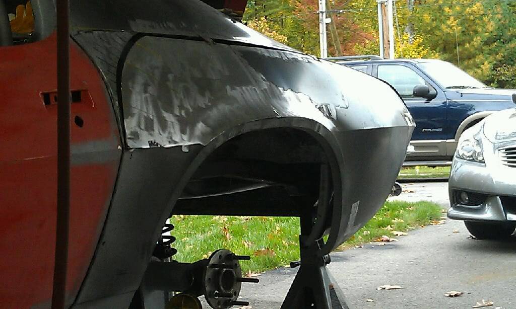

      Real subtle, looks like an inch from that angle

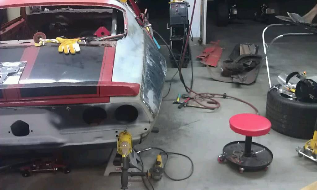

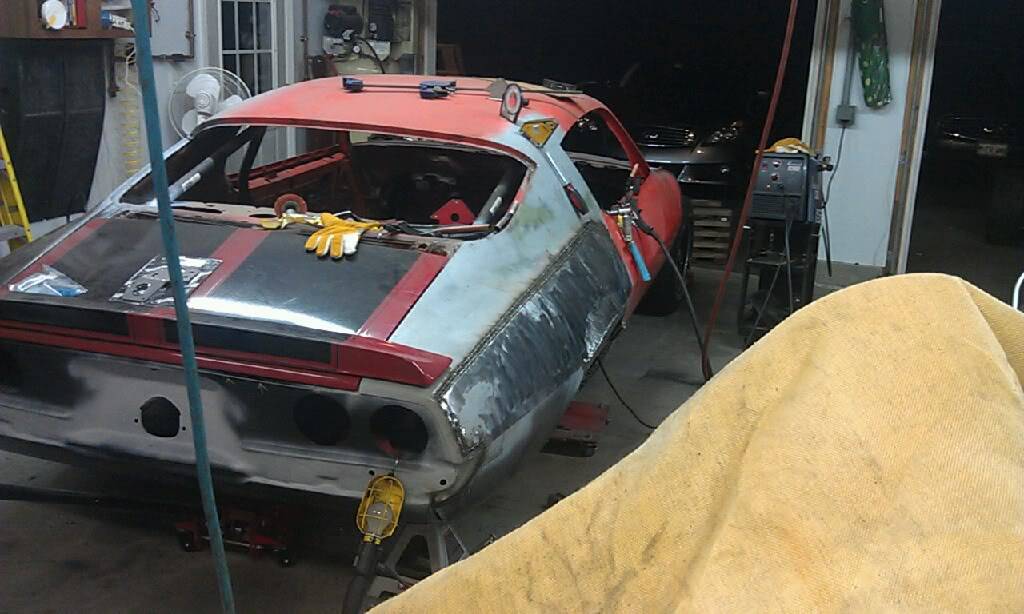

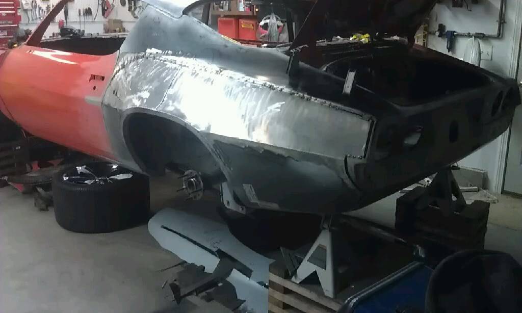

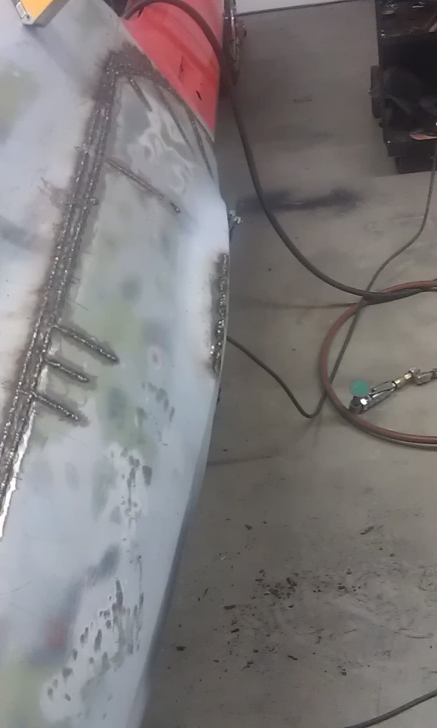

      More quarter work.
      Thanks folks. Been a while since I got out to the garage, life slows things down sometimes. Not to mention money
      Any how, got a bunch of finish welding done on the quarter the other night. Hoping to get out there again tonight to finish welding up the rear of the quarter. Then I'm gonna tackle the wheel well.
      Gonna be a lot of grinding...

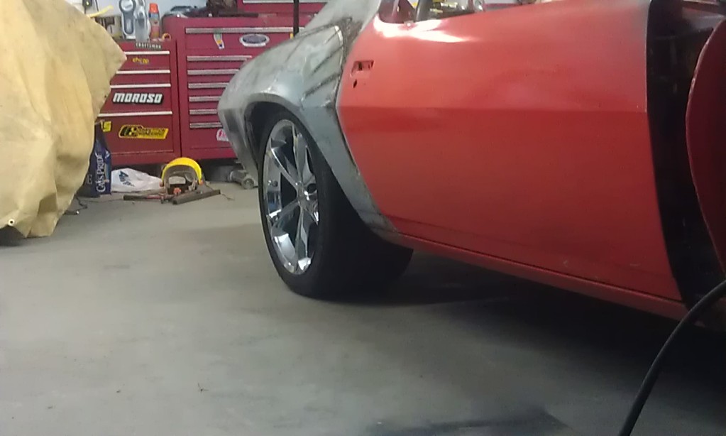

      Kind of wishing I pulled the quarter out more, maybe 1.5 rather than 1 inch. Guess we'll see what it looks like on the ground with a wheel under it.
      I'll post picks if I make any progress tonight.
      Matt

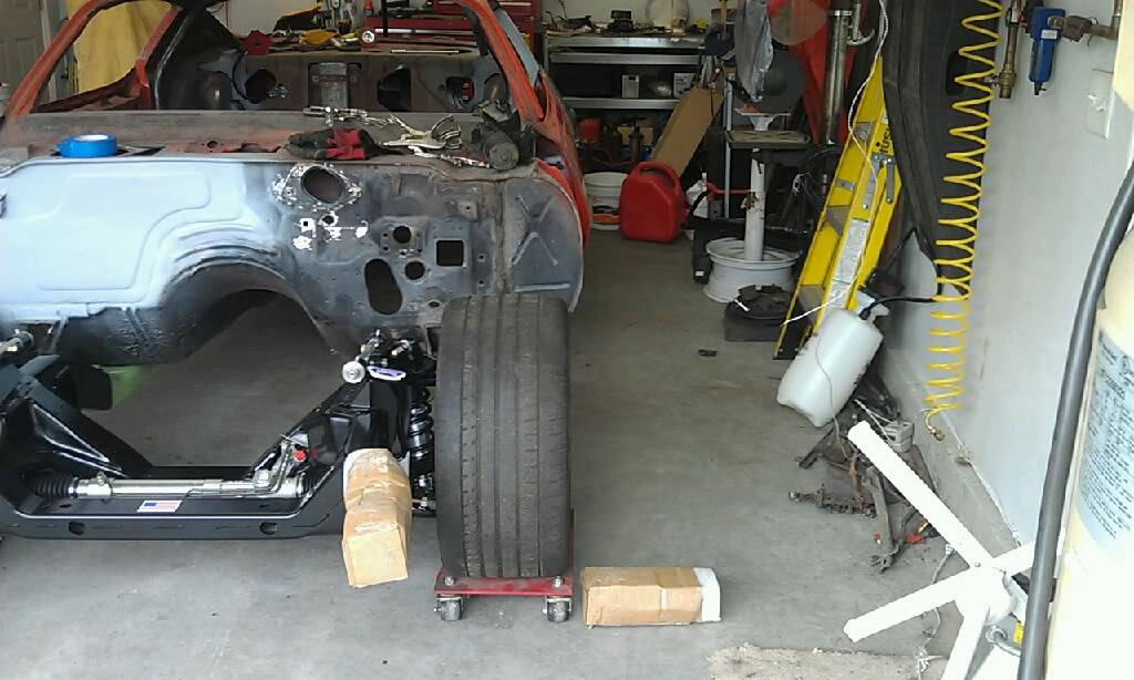

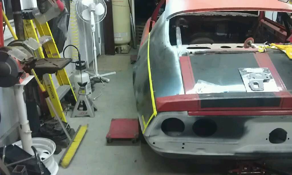

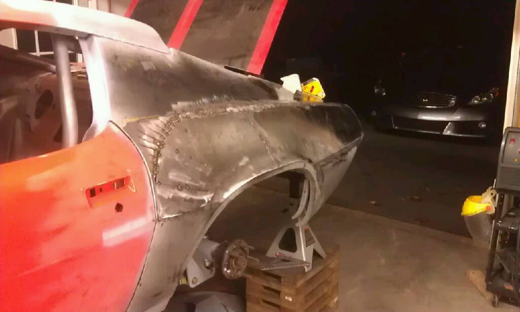

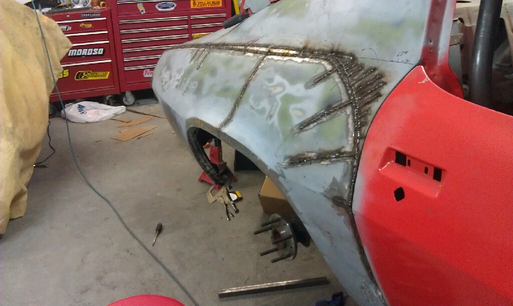

      Got out to the garage last night. Found that I really didn't like how the wheel opening turned out. The line got all screwed up and seemed to peek in the middle, hard to see in the pics though.
      So to solve the problem I decided to cut the quarter just inside of the wheel lip and pull the lip out. Was more finesse work than I thought it would be, which is difficult for me since I'm a smash it kinda guy. I think it is coming along pretty well. I found that I had to bang out the wheel arch to get the panel to line up with the lip once it was pulled out. This will give me more tire clearance which I needed anyway. Also means I'll have to bang the inner wheel well into shape once I get to that point. Hope to finish the front part of the lip tonight.

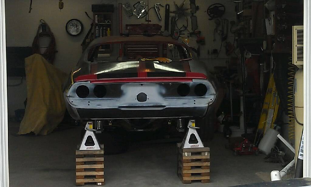

      So, the stretch looked subtle until you put the wheel under there. gives a lot more room.

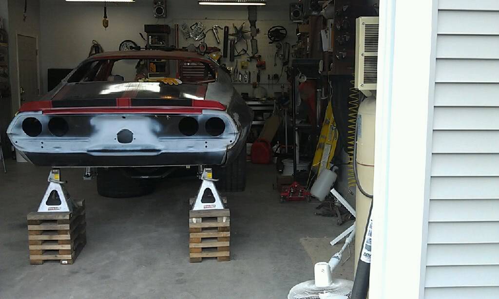

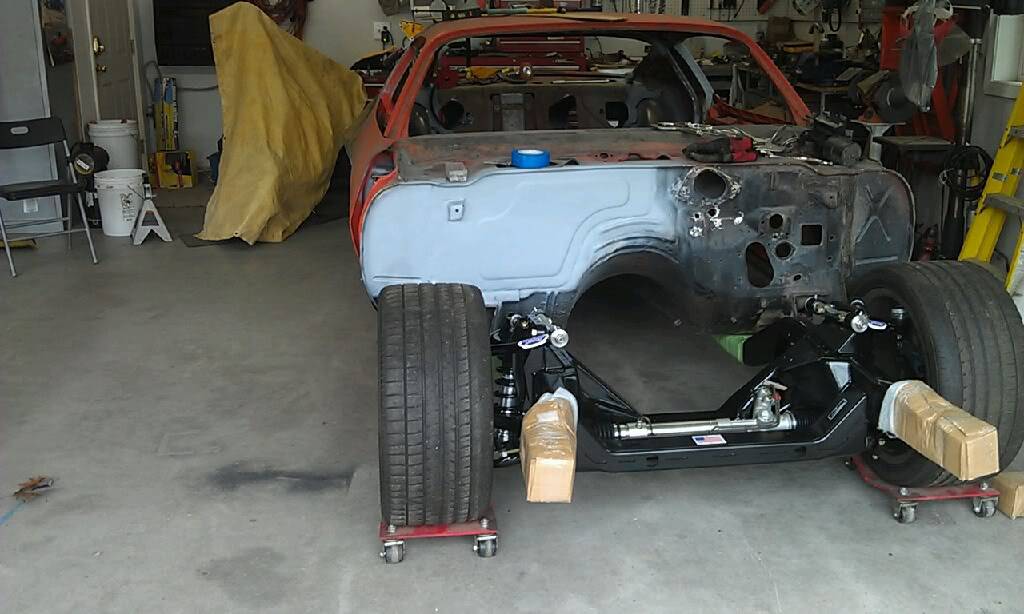

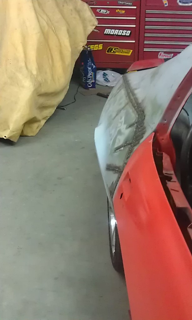

      I got more a lot more work done this weekend than I thought I would. I was able to get the sub-frame under the car, for no other reason than it looks cool as hell

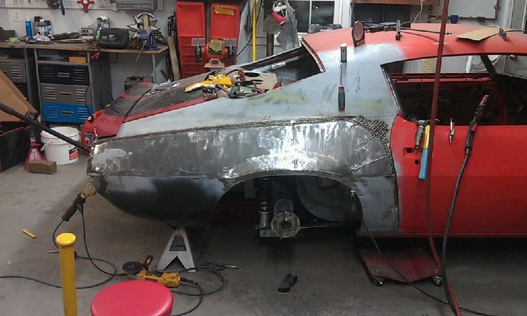

      I also got the passenger side quarter finished up. Did a lot of dolly work on the wheel arch that I honestly didn't see coming but I think it will work out better in the end.

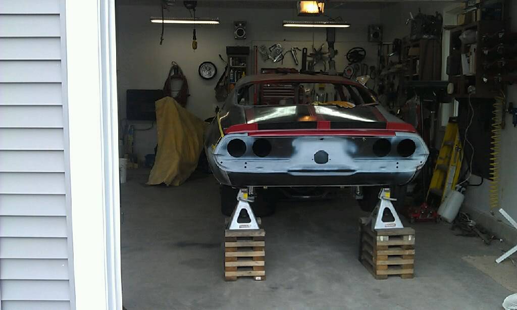

      Here's a few pictures that show the difference between the modified and unmodified quarters.

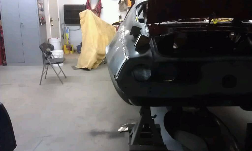

      I got real motivated and started cutting up the drivers quarter. Decided I would finish up the inner wheel wells after the quarters were finished.
      Things moved a bit quicker since I knew where I wanted the cuts, a little less trial and error. I also used the cardboard templates I used on the other side to cut my filler pieces. I wish I slowed down and traced the final filler pieces on the passenger side as the cardboard cutouts were a ruff representation of what I had trimmed to fit. I guess if I ever do this again I'll know to do these little things to make life easier.

      Are you setting up your rear end for the Corvette offset? I really like most of the C5 and C6 wheels out there, I just wish they had some lip in the back. It would be nice to have a custom wheel setup and some stock Vette wheels for track stuff. Those look nice on your car.
      Stephen
