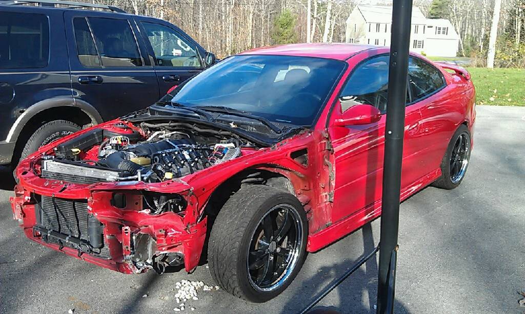

      Hey Folks, I've been slack'n big time. Haven't done much at all. Welder has been acting up which also slowed progress quite a bit. Wire keeps sticking right at the tip. I may have gotten metal dust in the line or something. I was able to get a motor and trans recently. Found a salvage 2006 GTO with an LS2, LS3 heads and intake and a 6spd manual. Runs and drives so I know things are in working order. Dropping a lot of dough this year so I better get my ass move'n... Will post updates soon. Until then here's the parts car. If anyone needs parts off this thing let me know. I only plan on using the motor and trans. I was gonna use the seats but I think I might go a different way.

      Where do people find these salvaged cars? That is a nice score.
      Stephen

      Quote Originally Posted by srh3trinity View Post
      Kept searching craigslist and ebay.
      go on copart.com theres a ton of cars there, for alot of them you need to have a dealer permit or salvage company, but they do have some cars available to the public.

      The guy I bought this from in NY actually picked it up at a copart.com auction.

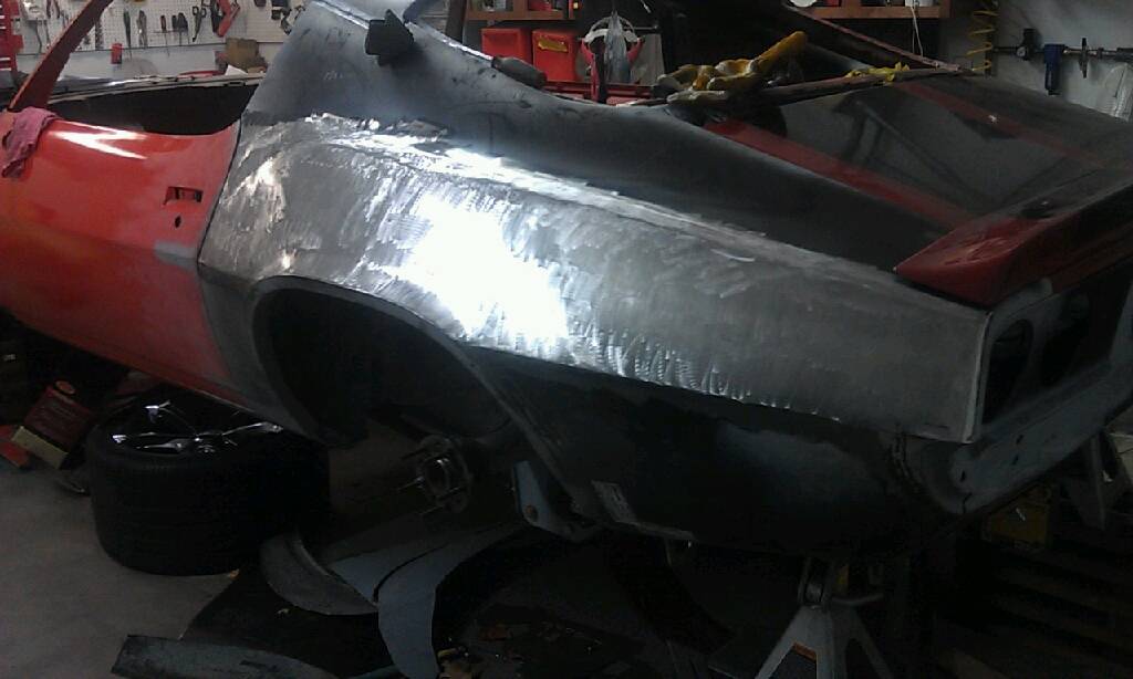

      So I've worked on the drivers side quarter quite a bit. Its all welded up and dressed. I found that there will be a lot of metal work to do before its all said and done. Not sure you'll be able to see the work complete to date from the pics but I've been doing a lot of hammer and dolly work.

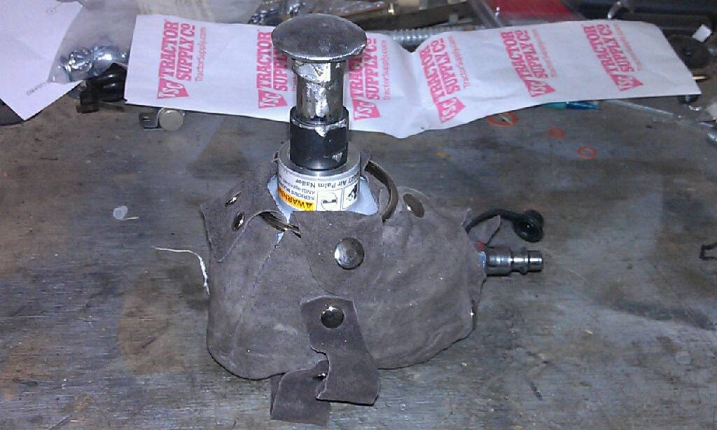

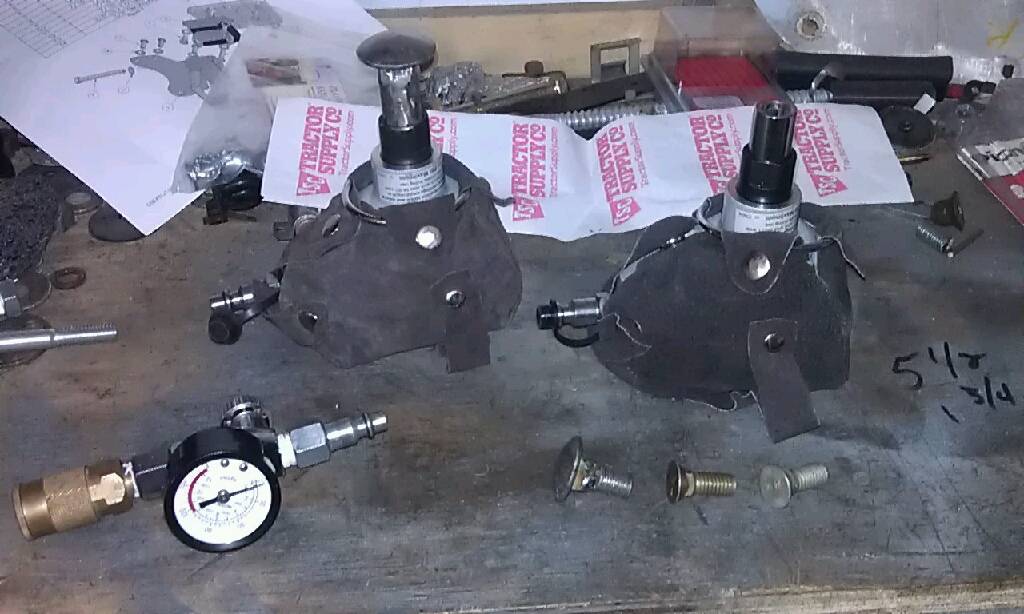

      I also created a new tool to help speed the metal work up. I found the initial idea online which was to place a 3/4 carriage bolt in a palm nailer. Well I took this to the next level so to speak. Since Harbor Freight sells palm nailers so cheap I decided it was worth hacking one up. At first I tried to tape the collar of the nailer, that didn't work out. Ended up snapping the tap and destroying the little magnet set into the collar. Rather than replacing that one I decided to get a larger carriage bolt, cut the head off and weld it to the collar. I also picked up a second nailer which I've used with smaller carriage bolts.
      If you've got any metal work to do this setup is worth the 26 bucks. Also, the guy who mentioned this idea online sells a dvd that has a bunch of good tips on metal work. If you're interested its called Custom Metal Bodywork. You should be able to find it with a google.
      Here is a few pics of the tool;
      In this one you can see the pressure regulator I got as well. Figured I would use it at the nailer on a short length of hose to keep it out of my way but closer than the main regulator I have mounted by my compressor. This is a HF pice and doesn't work worth a crap.

      Thanks for showing us the palm nailer idea! I will have to try that with mine!

      Nice sheet metal work, our cars are very similar

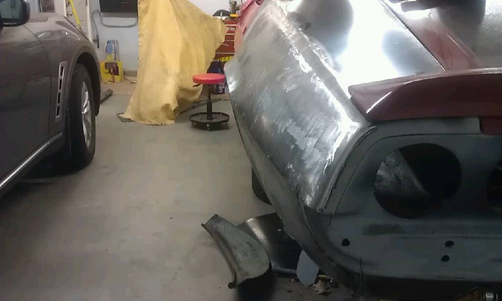

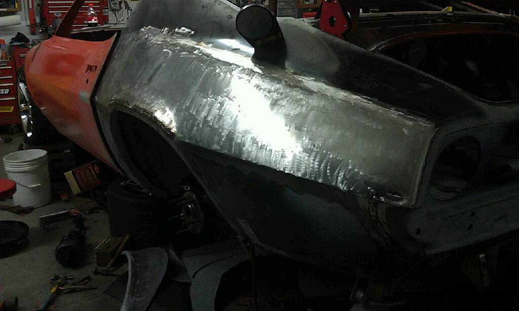

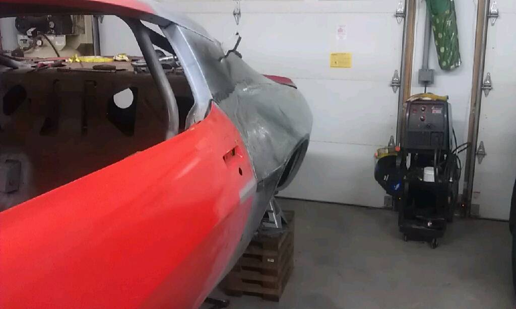

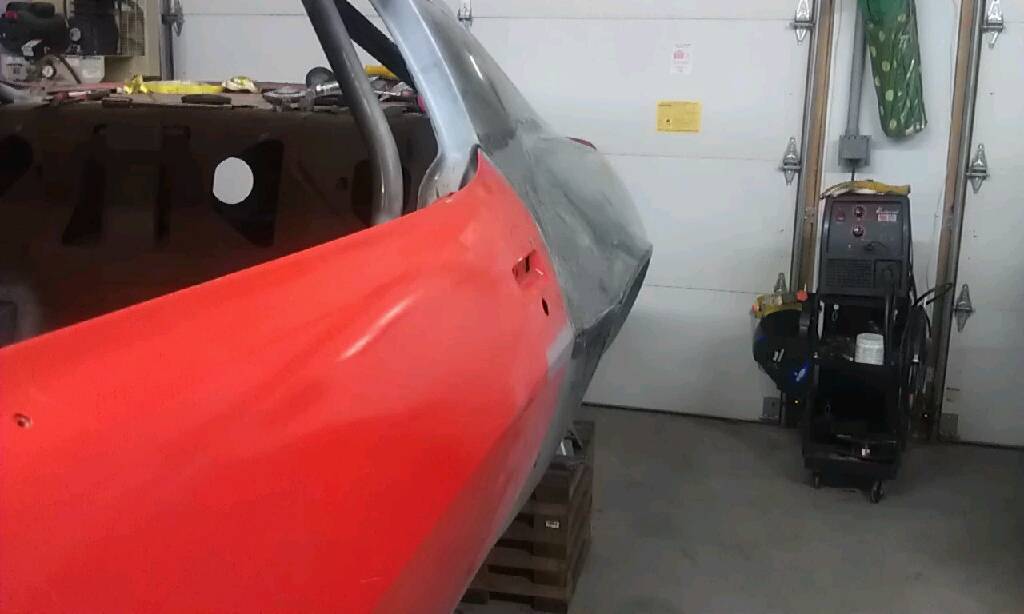

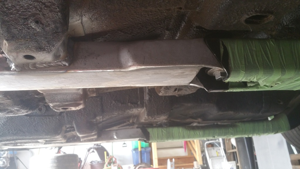

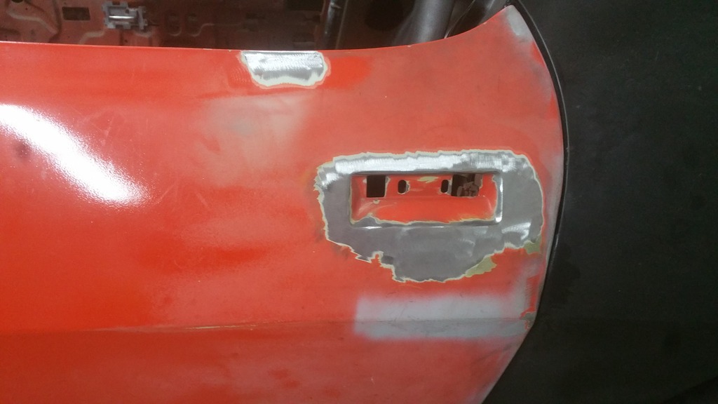

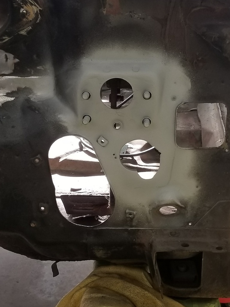

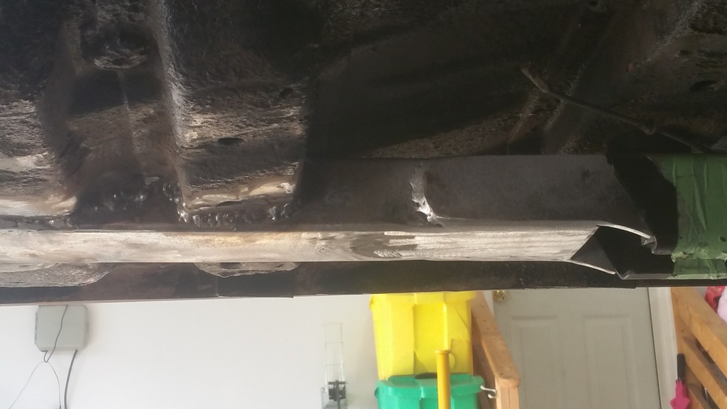

      Hey folks, believe it or not I still have the Camaro. It has come close to being an unfinished project but now I'm back at it. Finally got the rear quarters and outer wheel wells sorted out and got the Detroit Speed sub frame connectors installed. Also installed a DSE brake booster and clutch master bracket\support welded up to the firewall and closed up some unneeded holes. Put in an order for a cross member and some other items with American Powertrain earlier this week so hope to see those parts soon. As soon as I see them I'll be putting the motor and trans in and getting the shifter hole cut. Also need to order a Mast oil pan as soon as they are back in stock. After that I need to figure out what’s next... Have a 1991 Humvee for sale that I need gone to finance the Camaro, let me know if you’re interested!
