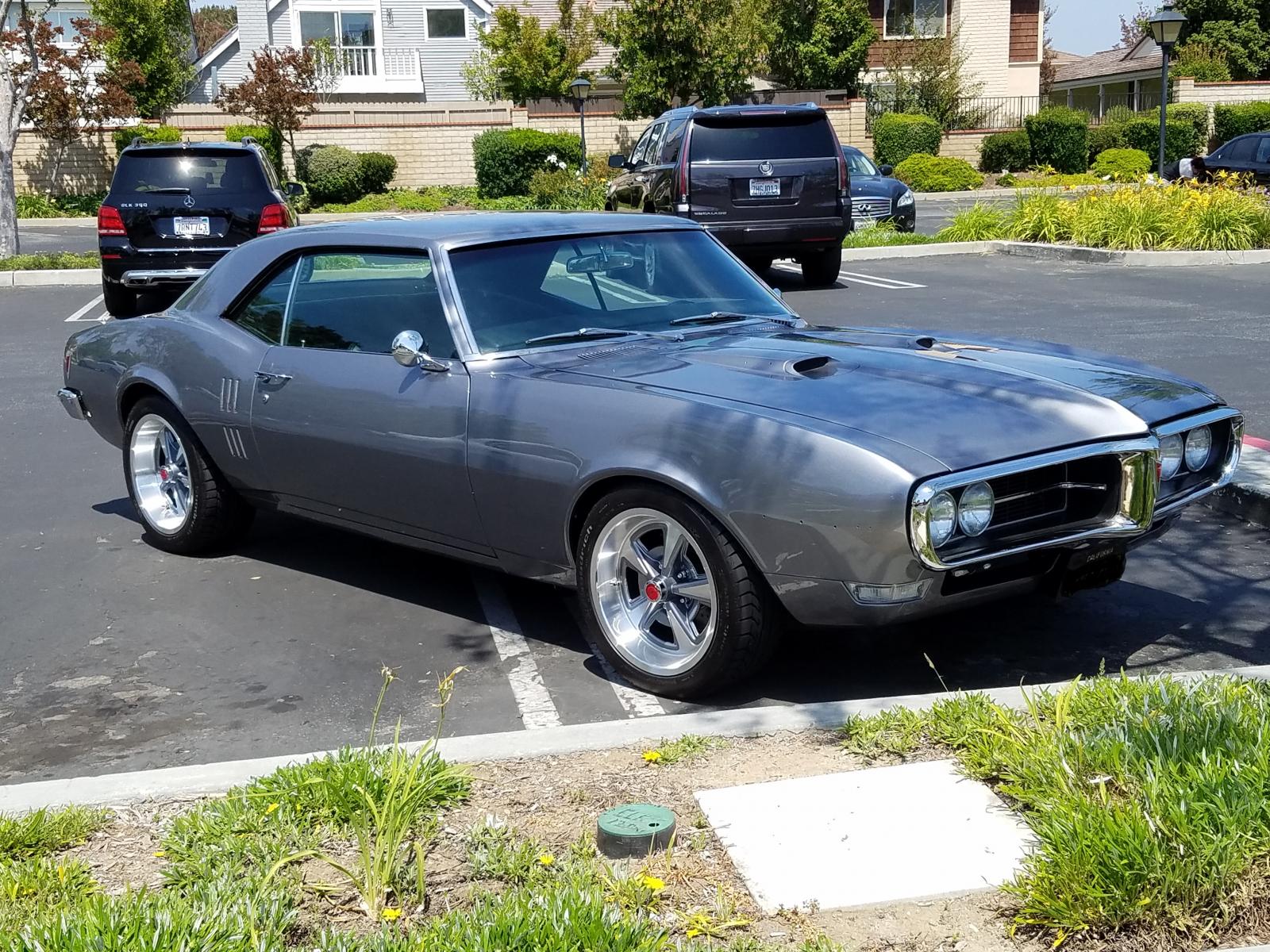

      6-30-16 Update
      Well, I've had the car back for about a month now. It's about finished except for badges, and a few small things we still need to do. Car drives great and came out better than I expected. It runs a little warm when idling at lights or in traffic, but I think we'll fix that by changing to a smaller water pump pulley. Here's a pic of the finished product (less badges of course). I'll post pics later of the engine compartment, interior, and underside of the car.
      A lot of fun to drive. Now I get to live with the constant worry of people parking too close to the car, security, etc...
