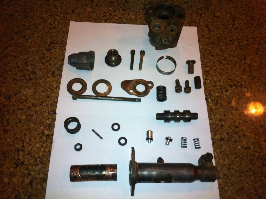

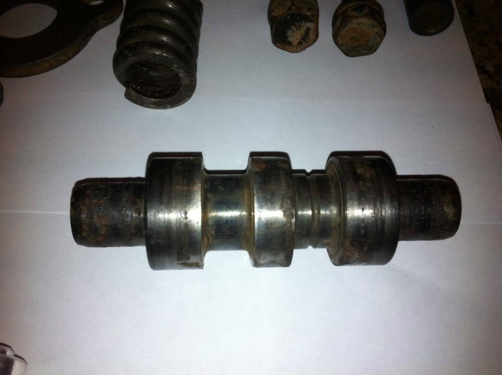

      decided to see just how bad my power steering control valve was... disassembly was a total pain in the ass. with the guidance of a youtube video i accomplished the task. i think my valve is shot! its most likely only good for parts. The previous owner really neglected the poor car. Every inch of the valve is pitted and rusty. the original seals were rock hard and everything was seized. i had to pry the bronze ball stud bushing out, it was stuck, and my spool valve needed to be tapped out with a screw driver and hammer. after a very long soak in super clean then purple power i scrubbed the hell out of everything with a wire brush only to find pitted and rusty springs, spacers, and bolts. even the aluminum flare tube seats are smashed and grooved. I can get a complete rebuild kit, new spool valve, and tube seats but then i would have over $120 invested in the damn thing. I contacted a reputable rebuilder from ebay and other mustang forums and he wanted $190 to exchange mine out, thats with the core deducted.. so a new control valve and ram less the hoses will set me back $300... or i could just bolt on that manual pitman arm and center link and call it a day!!

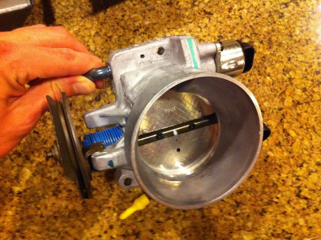

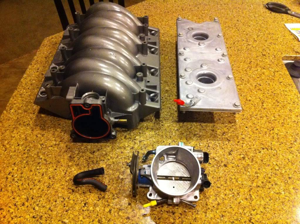

      here is some good new tho. i received my ls6 vented valley and pcv hose! it even came with a new gasket and bolts. here it is next to my ls1 intake (previous owner painted it) and my brand new fresh from the box cable operated truck throttle body. i got it super ultra dirt cheap on ebay. its the same size as a camaros.

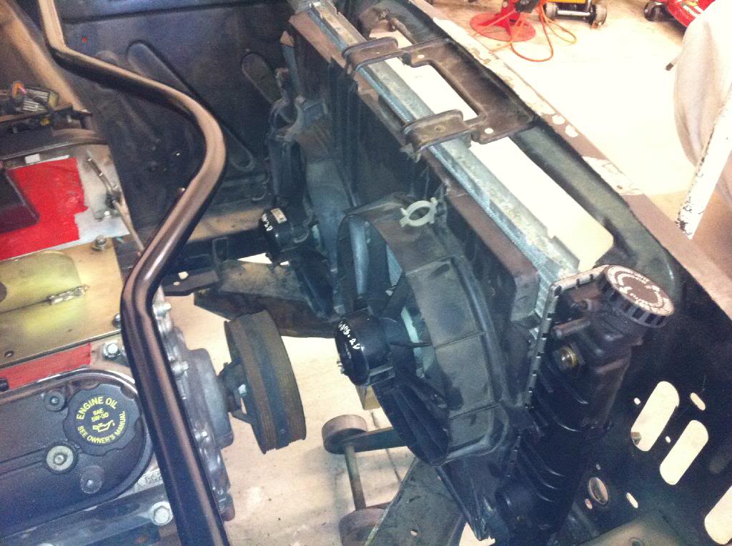

      went to my folks house on thanksgivig and laid the radiator in the car. its a tad bit too wide, i will have to cut the frame rails and weld in some angle to make it fit. i ordered a set of radiator isolators from a 93-02 camaro so hopefully i can use those to mount it.

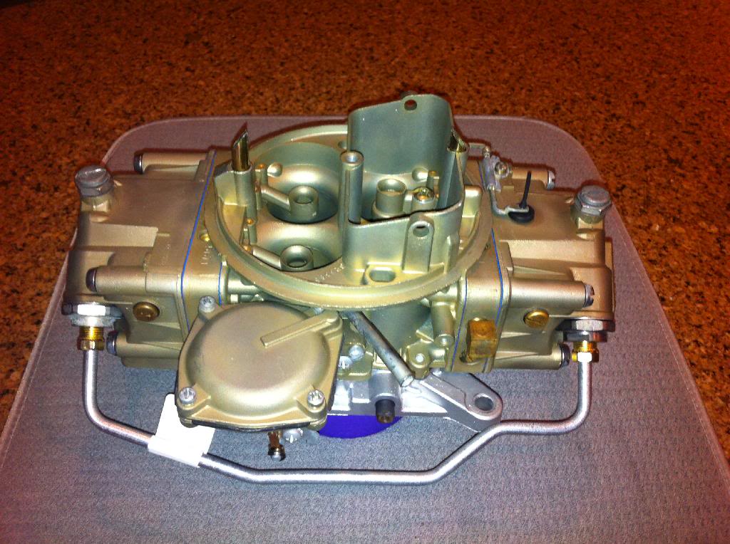

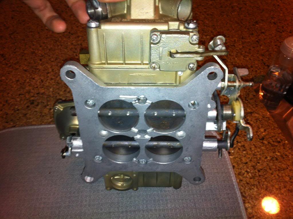

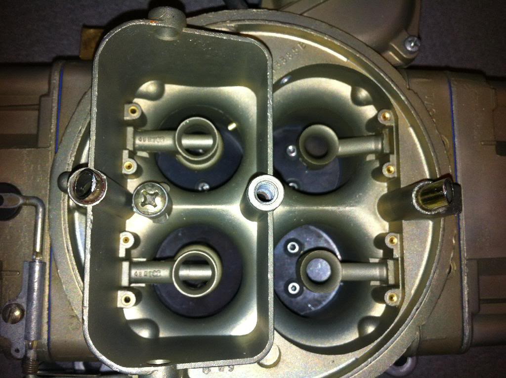

      Things have been very hectic around here! nothing to report on about the mustang but i would like to share my fathers xmas gift with you all.
      Long ago he was given a junked holley 4150 that was said to be from a big block ford. well i unearthed it from the depths of the garage and looked up its list number. turns out its a service replacement for a 1969 428 cobra jet! SCORE! i attempted to clean and rebuild the carb myself as a gift to my father but i ruined the finish of the carb using some berrymans carb dip. i thought it was a total loss. the original finish melted away and left a sticky mess inside the fuel blows an metering blocks. I ended up taking it to a local carb shop and having it re-dichromed in the original Holley finish, rebuild, base plate resurfaced, new linkage, show quality stage 1 rebuild.
      it turned out awesome!
      730cf built to stock 428 CJ specs. I opted to have the automatic choke and choke plate removed. it should run nicely on top of his aluminum head/intake 390 big block.

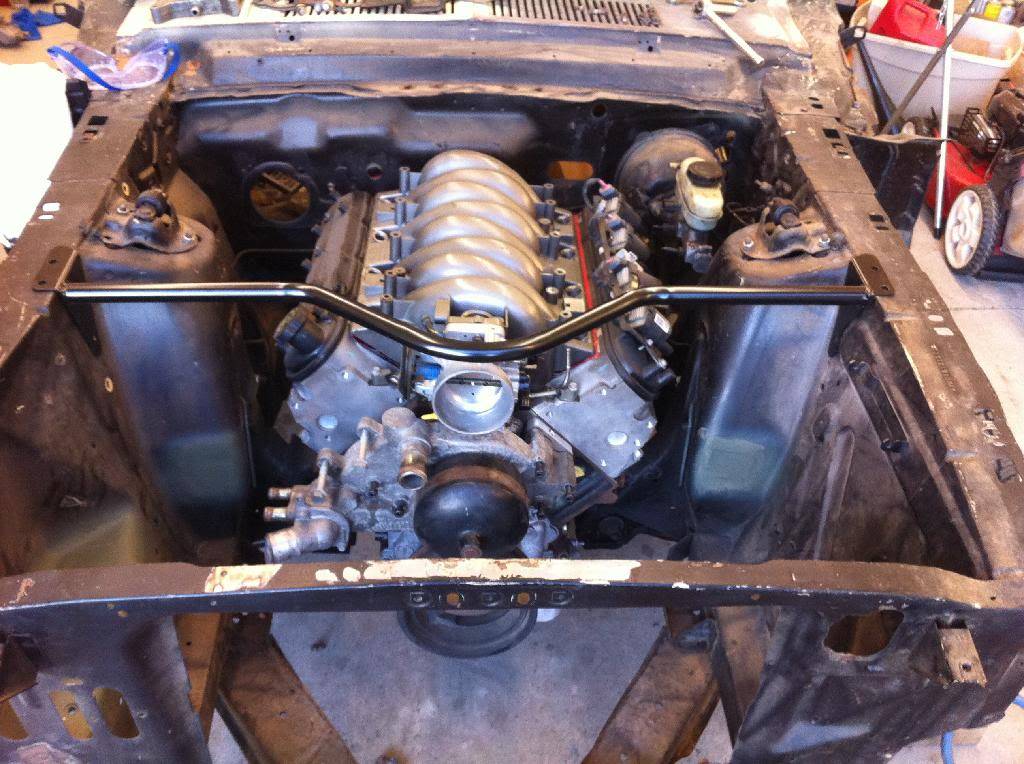

      Also found out i can run a curved montecarlo bar. I just have to install it after the throttle body is installed.

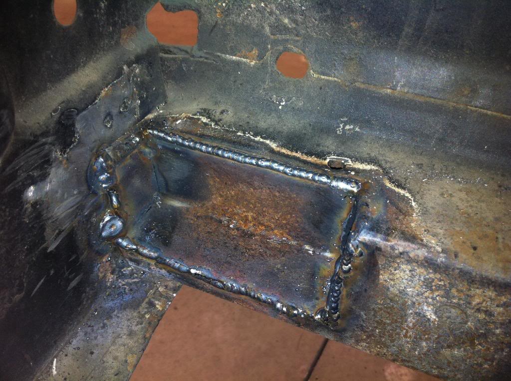

      I spent the rest of the day notching the frame rails so i could lower the F body radiator into place. what a chore that was making room for the plastic radiator tanks. getting air tools in there to make the cut was a real pain in the butt. I ended up making a rough cut with the blow torch then cleaned them up. I used an old 4x4 1/8 steel tube to box it back in.
      I still need to dress the welds a bit and box in the passenger side. after that i need to make some bent steel clamps for the top tank rubber isolators. Found out the F body fans will clear the water pump and i can also run the upper radiator hose with no issues. I need to buy a straight thermostat housing, it will allow me to run the stock F body lower hose.

      I stopped by my folks house today and quickly mocked up the radiator in the car. I have roughly 6" or so between the apron and the radiator tank. The optima yellow top (D51R) i was researching is only 9-5/16" x 5-1/16" x 8-15/16". it should work perfect for a front mount. I really don't want to trunk mount the battery because the fuel pump will be in the trunk floor. gotta love those mustang gas tanks.
      I also got the idea to use a FE big block upper radiator mount to secure the radiator. I will need to sand down some plastic fins on the radiator fans and cut and shorten the bracket but i think i can make it work. Im not going to cut up my dads original bracket, i ordered a repo along with some new rubber mounts.
      here is the rough mock up. the bracket sticks out too far. needs to be shortened by an inch or so. i will most likey cut the mounting bracket and flip the part that bolts to the core support upside down to lower the brackets clamps.
      here are a few pics of the lower mounts for the radiator. the driver side has a thick rubber pad it rests on and the passenger side has a spike with a rubber bushing. I will weld in some metal tabs drill a hole in one and box the other so the radiator is secure from the bottom.
